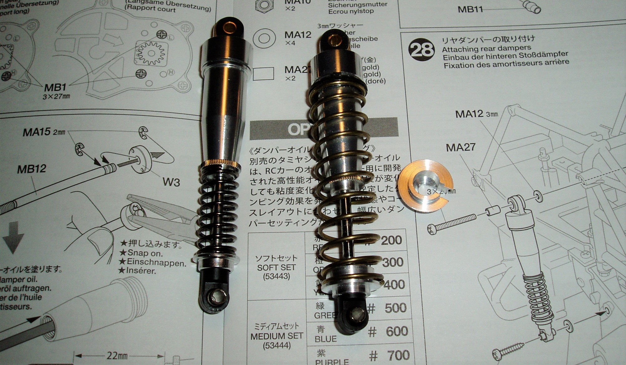

Anyway, here's what I'm doing for rear springs - FYI. I think they are RC10T fronts but not sure about that. They're not perfect but at least now I have around 4mm droop with a standard 2s lipo in the car. I think the kit springs came from a locomotive. :roll:
The spring cups are scratch made - I can provide dimensions if you're interested.

I'm always a bit reluctant to post my photos in another member's build thread. Just say the word and I'll remove it. No worries! :wink:

Interesting. I do know the dampers/springs are far from perfect from the videos and reviews I saw, but intend to do my own opinion about this before addressing this. That being said, I've saw all sort of solutions with replacement of the Tamiya dampers by crawlers' dampers which may give both a better scale effect and better dampening... But as said: each step in due time :)
And I don't mind people sharing knowledge or interesting ideas on my threads, as I believe that forums are made for this :)

Yeah, apart from having only one o-ring, I think the dampers will be fine for this car. The problem is with the springs.
I've read that CRP has offered a soft spring kit for the Frog that will also fit the WO but I prefer to use what I have on hand.
Maybe, if I were planning to race my car, I'd consider replacing the dampers. The kit dampers should be fine for my purposes.
Also, suspension travel front and rear isn't great. The rear arms interfere with the roll cage further limiting the arm's up travel so I'm planning to remove a small section of the webbing on the rear arm to regain full travel. I guess one could notch the cage and leave the arms intact but the cage a structural member supporting the motor/transmission so I'll mod the arms.
I'm also making spring cups for the front dampers that will lower the spring to gain more droop and to better retain the spring (the kit spring cups are far too small for the supplied springs). I'm omitting the G2 preload spacers; they're pointless.
I think perhaps Tamiya has adopted a function follows form approach when designing their early buggies. The suspension on their modern buggies seems to work much better.
