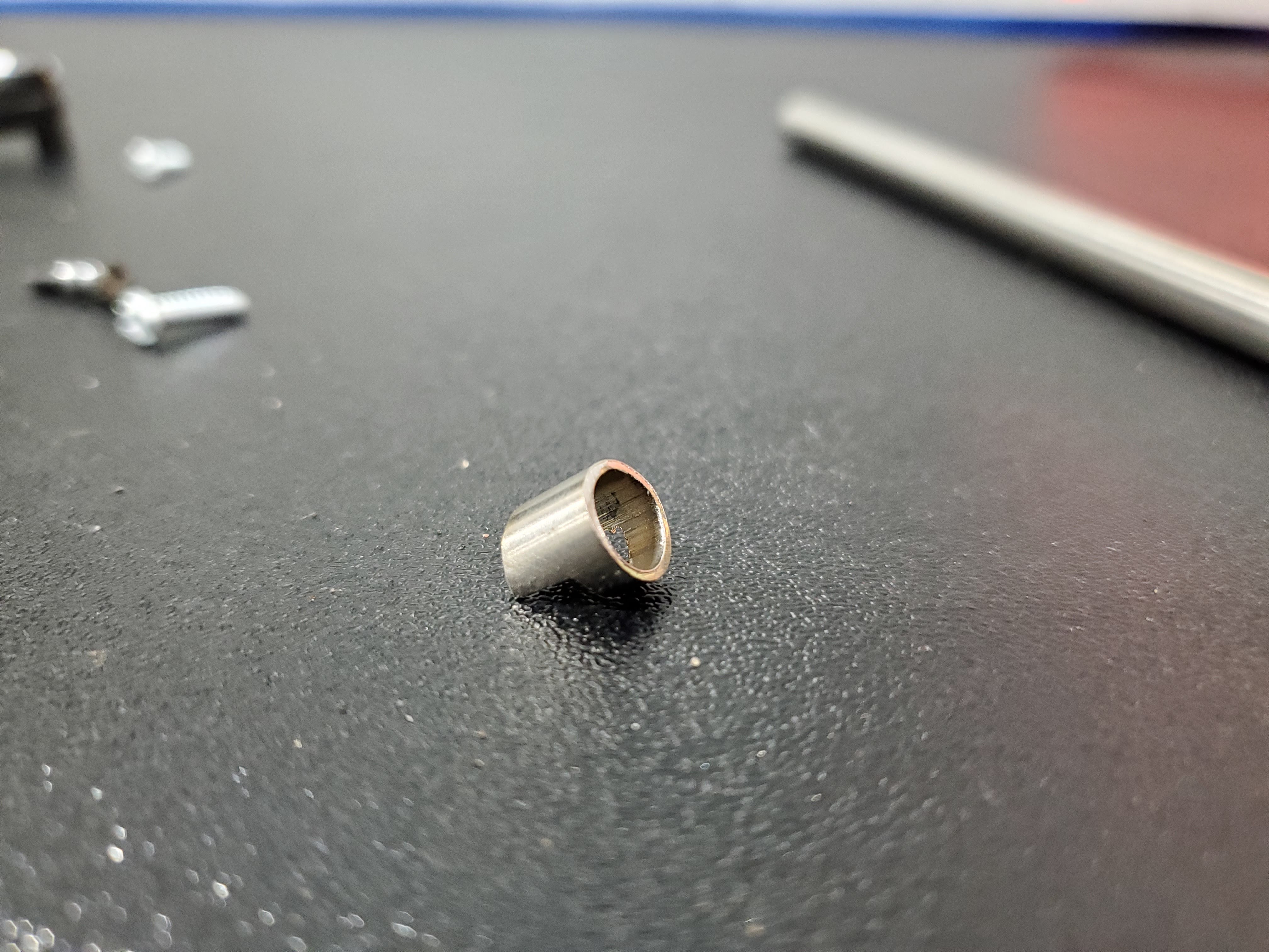

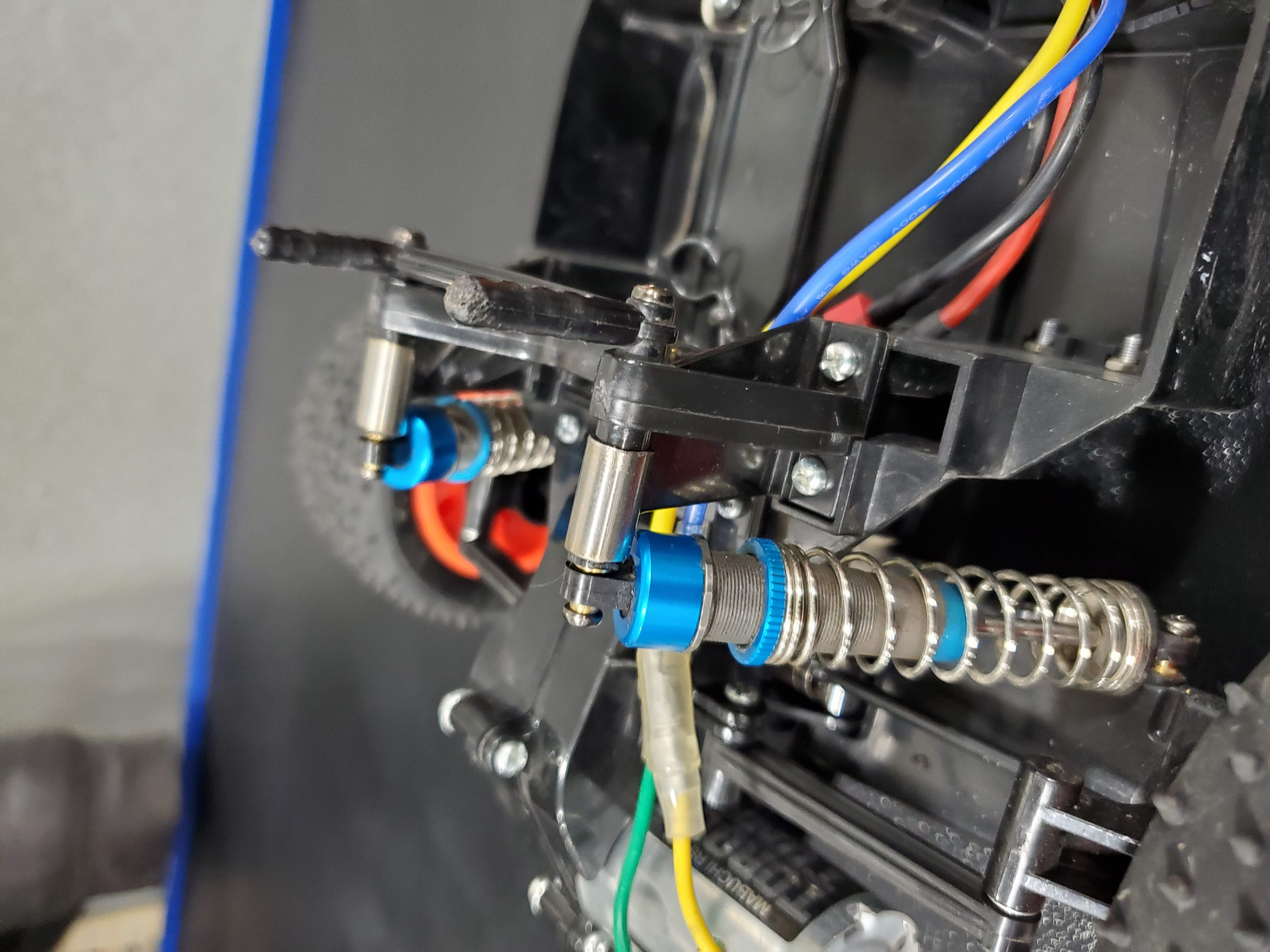

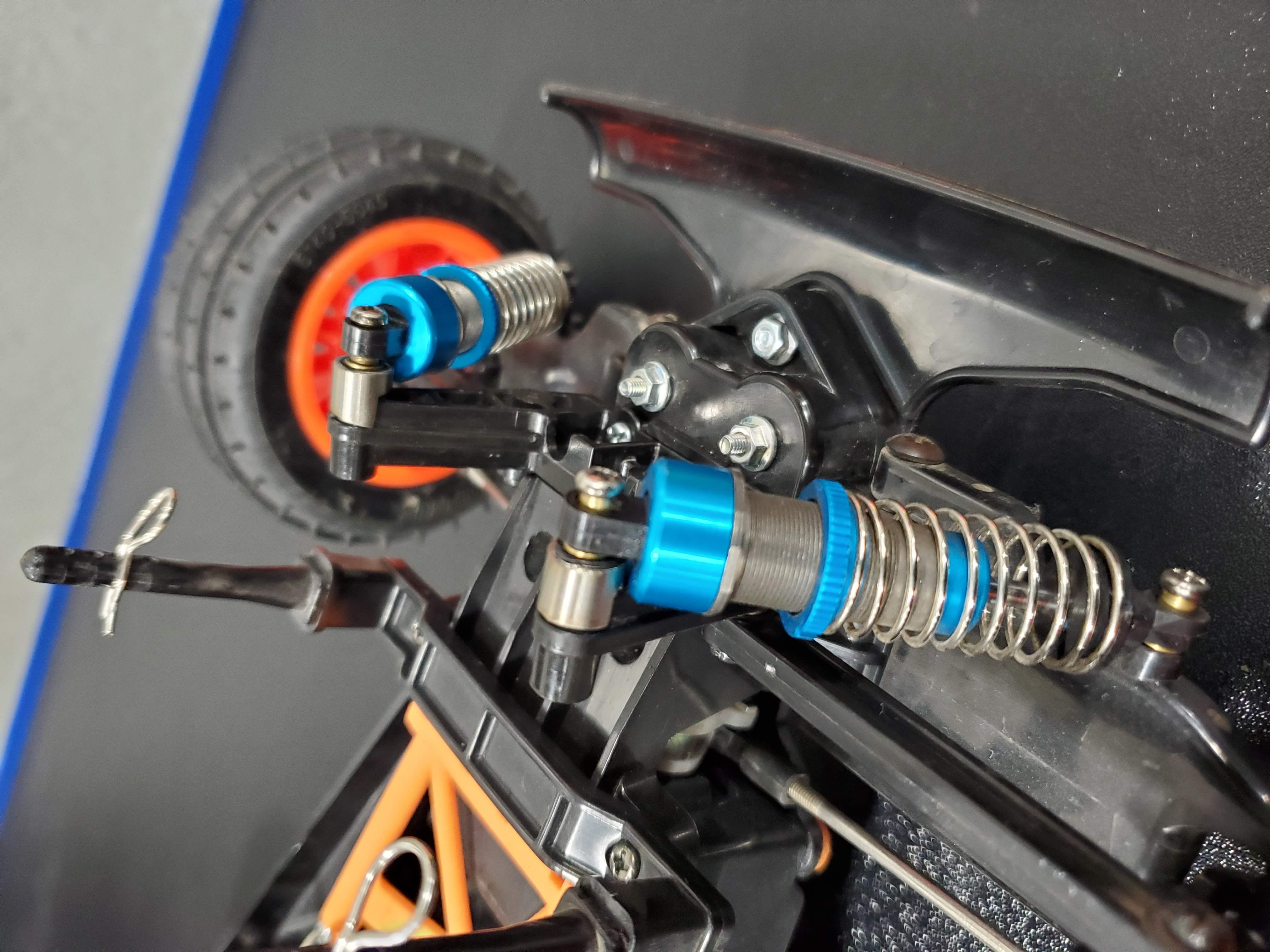

I noticed a hairline crack forming on the front shock tower (in the place they always crack). I've seen 3D towers that might be better, but thought of a different approach.
The OD of the top shock mounts is exactly 7mm, so I got some 7mm ID, 8.5mm OD stainless tube & cut them to fit the towers. In the rear it's just a slot (to slide past the lower molded brace), in the front I cut about half off the diameter to slide them all the way on.
It's a tight fit, I used a vise to install, but that's perfect!
Hopefully this cures the broken tower blues, but only time will tell! I'll report back once I get a chance to run the track a few laps

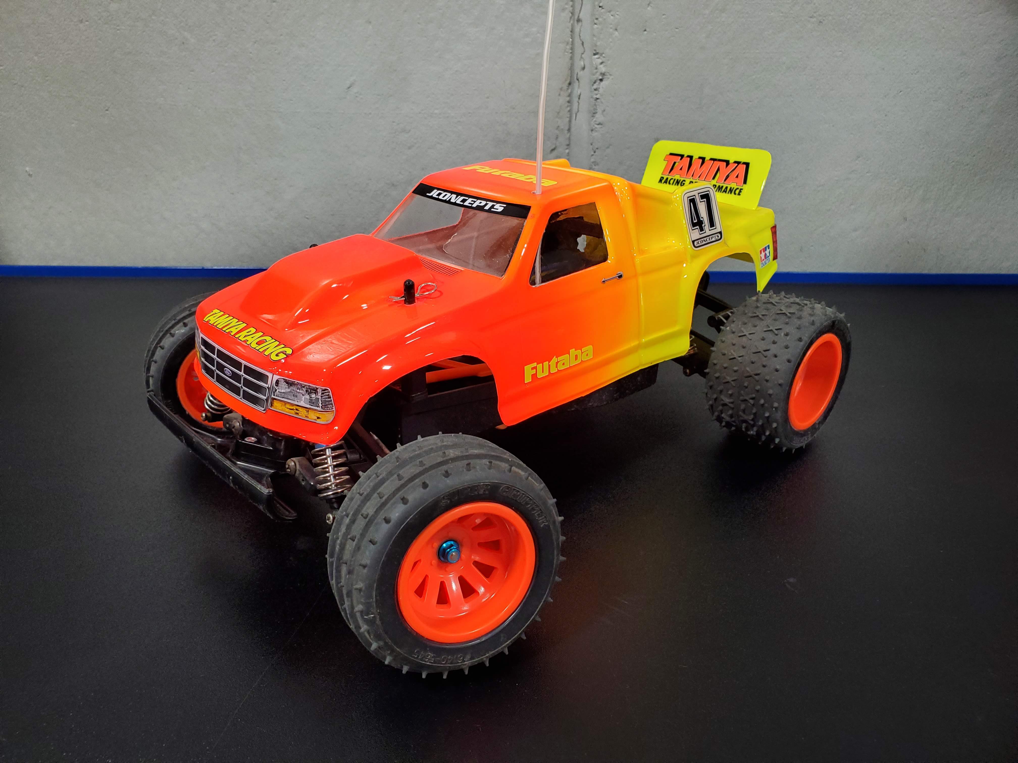

That 10T body is a pretty good fit. I like the look of the original Stadium Blitzer body so much that I couldn't bring myself to use anything else.

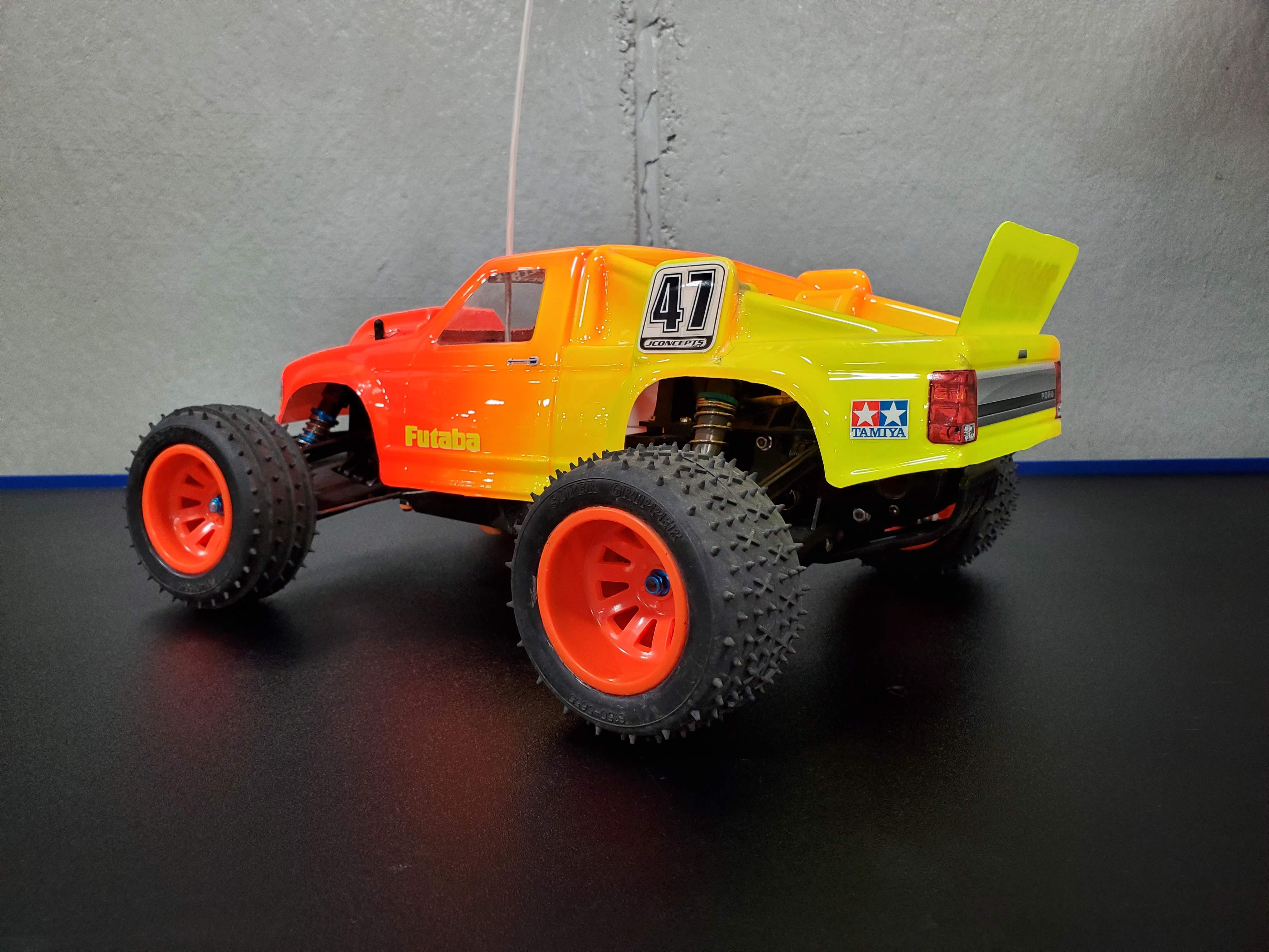

And I agree that the original body is the best, but I have a fully restored original one, so thought I'd mix it up for the runner.

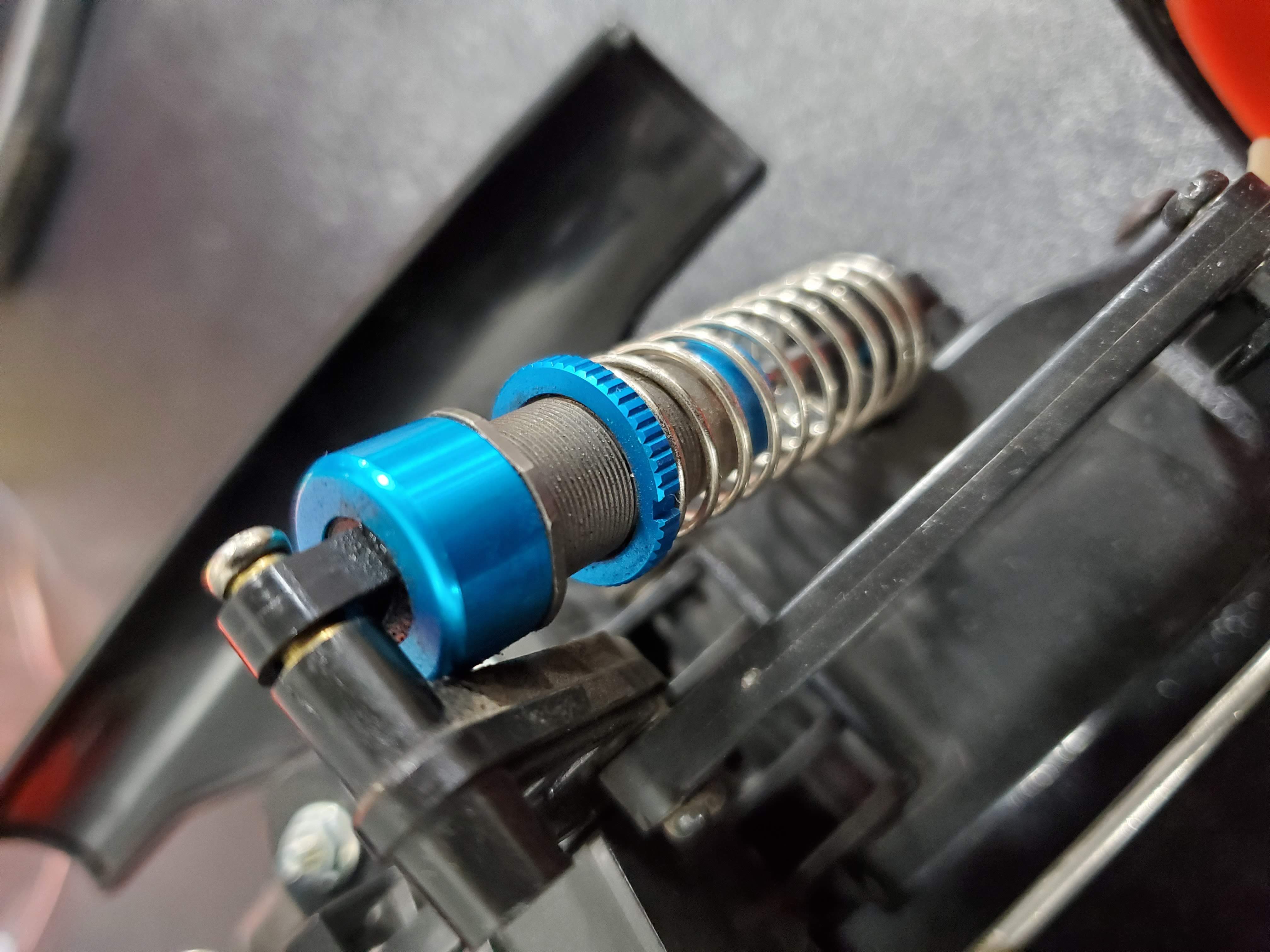

Those are nice looking shocks on there. Are those Tamiya?
- Posts: 77
- Joined: Sun Feb 07, 2021 2:14 pm
- Location: Indiana
- Has thanked: 194 times
- Been thanked: 48 times
Re: Blitzer shock tower strenthening
Thanks, and yep, 53926 DF-03 Aluminum Damper Set, they fit perfectly, I'm using the stock Blitzer springs though for proper handling.Frankentruck wrote: ↑Fri Mar 25, 2022 9:26 am Those are nice looking shocks on there. Are those Tamiya?
It has 53791 Universals too, in case you're upgrading a Blitzer.
