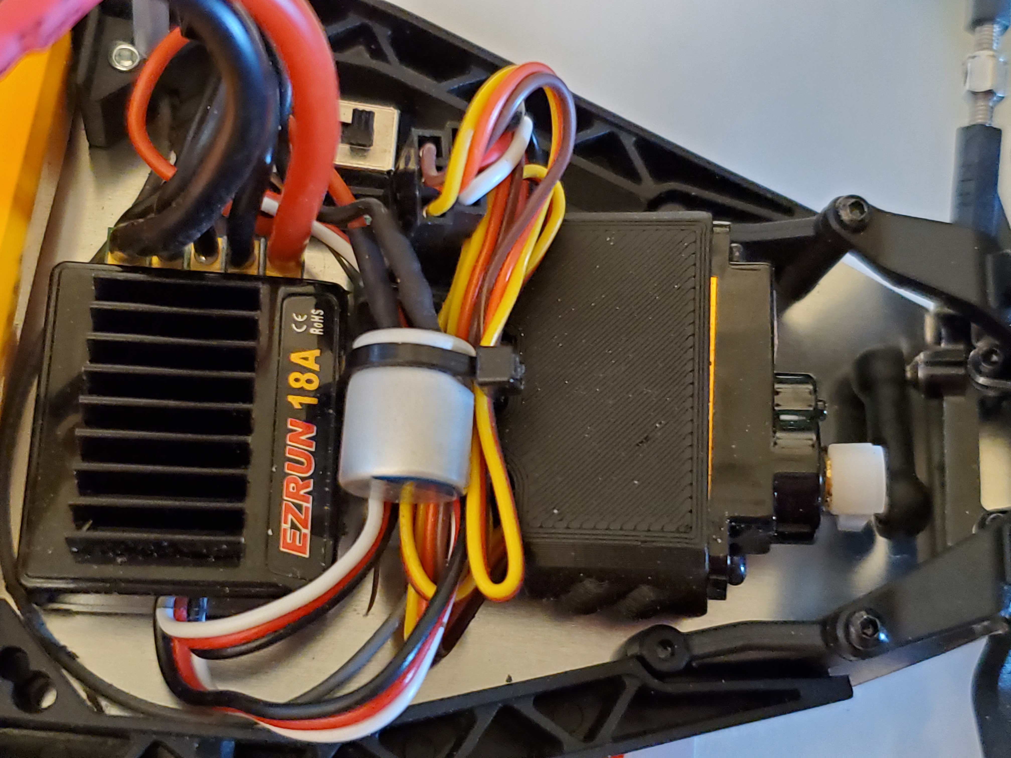

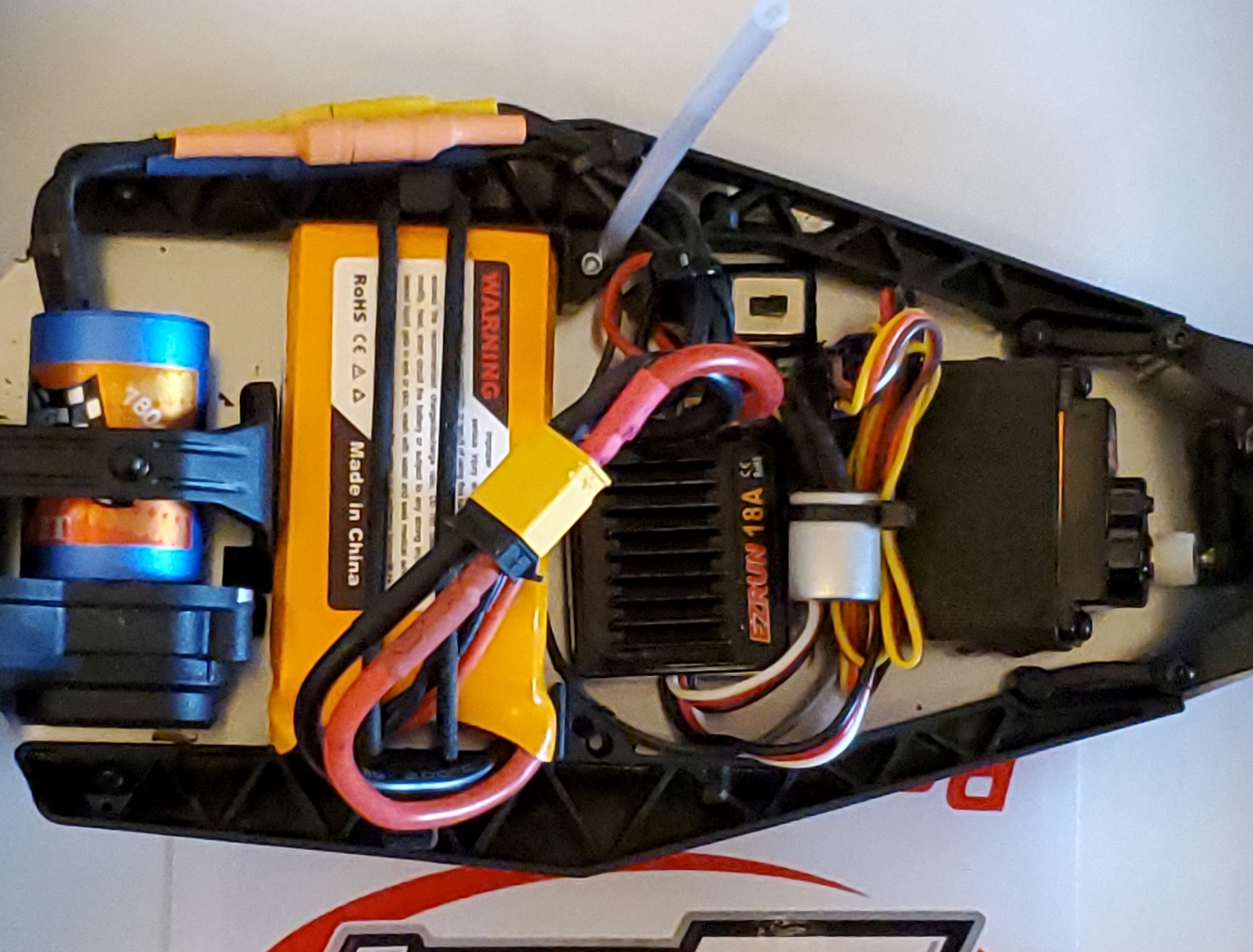

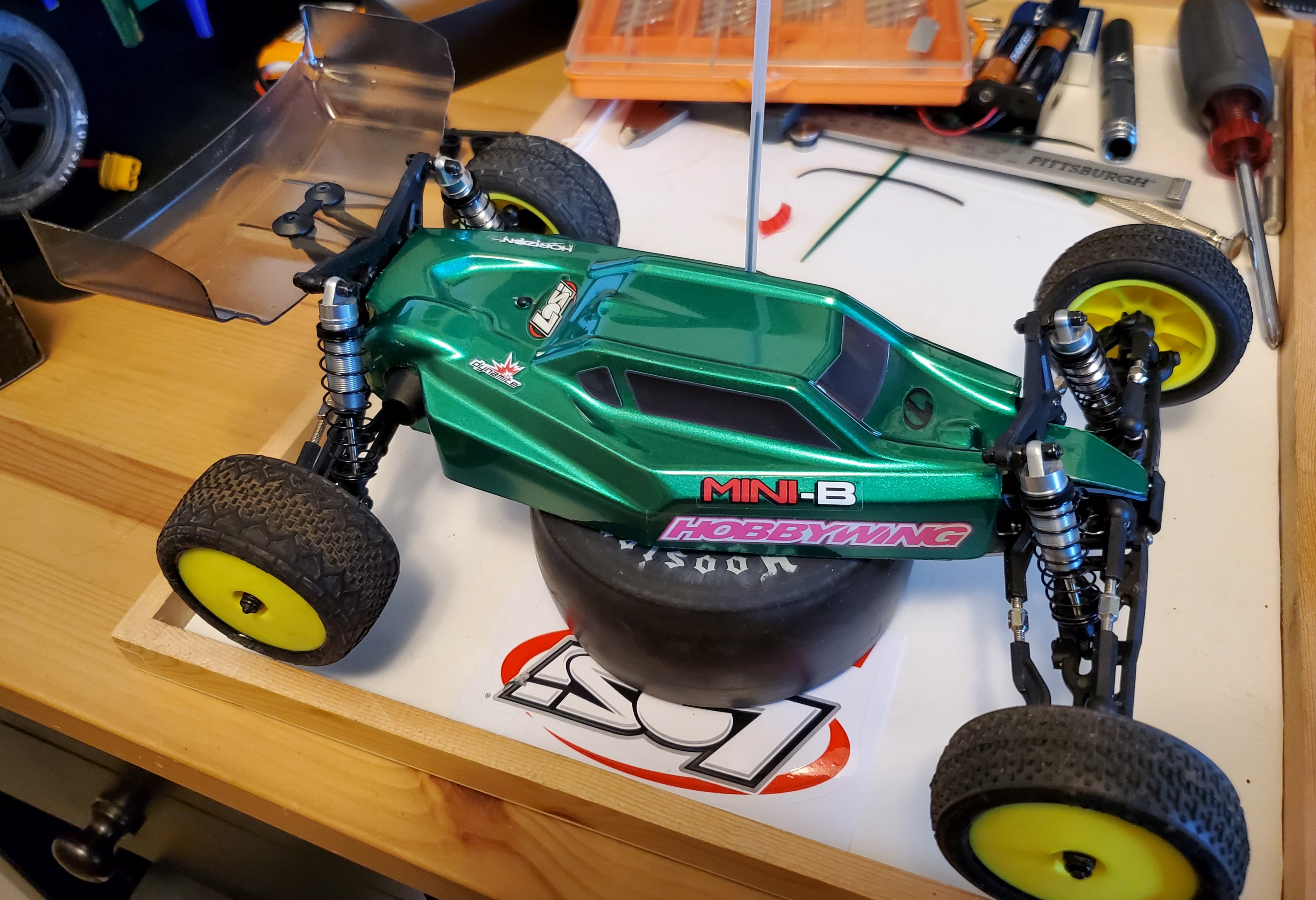

I finished my Losi mini B pro roller today.
I used the Hobbywing 18A ESC, 7800KV 2030 motor, CHNL 650 70c 2s battery, and Radiolink R4FGM receiver (buried under the wire burrito), and Emax es08md ii servo.
The servo does not work with the supplied AL servo horn. Additionally, the supplied servo mounts are spaced to use a servo saver and will place everything too far rearward. I designed and 3d printed a new servo mount which should also hold a transponder on top. I'd add the file here but it won't let me attach a .3mf extension. Message me if you want the file.
I've only put one pack through this. It's very quick and more nimble than I can keep up with. Being this tiny, bumps upset it quite a bit.
Lots of fun!

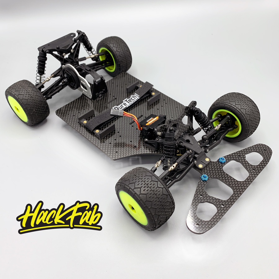

I found a company making aftermarket chassis for the mini-t.2/B
It's a touring conversion that allows for larger batter packs as well as a 4s setup.
https://www.hackfabrc.com/Losi-Mini-T-2-0-Omni-chassis-conversion-kit-p379586798
