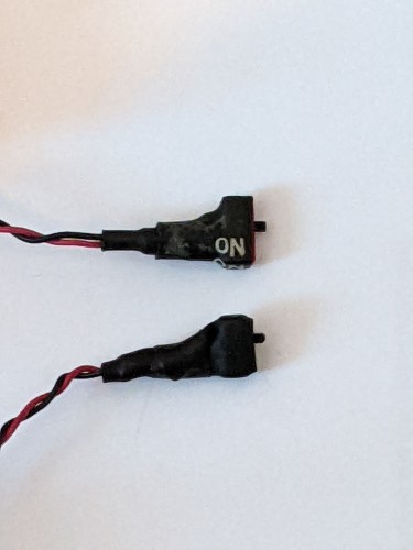

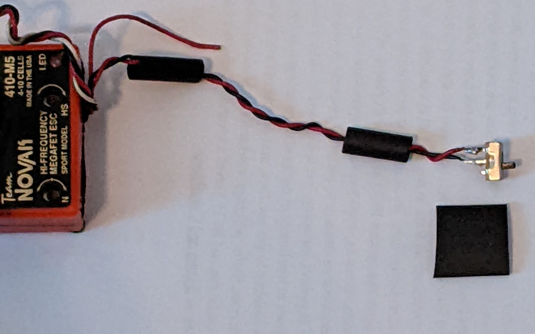

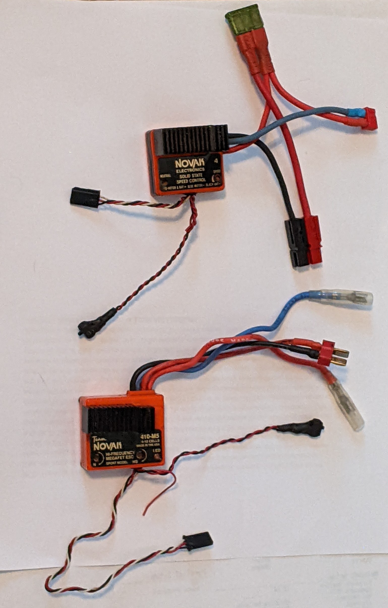

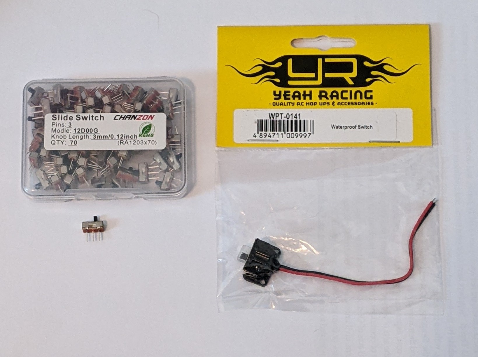

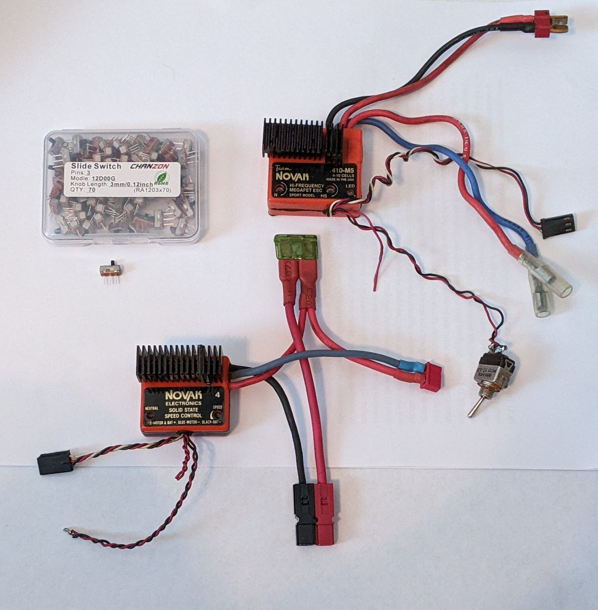

These 2 Novak ESCs needed the standard case cleanups, wiring unsnarling, receiver connector repair, and power switch replacement. For the switches I wasn't satisfied with the standard options that always seem oversized. Then while doing a micro switch search I'd done many times before, some new options actually started showing up. I settled on the smallest I could, rated 50v and 0.5A.

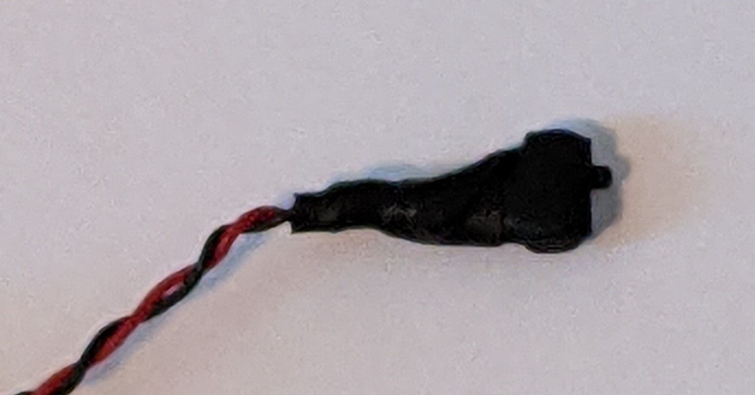

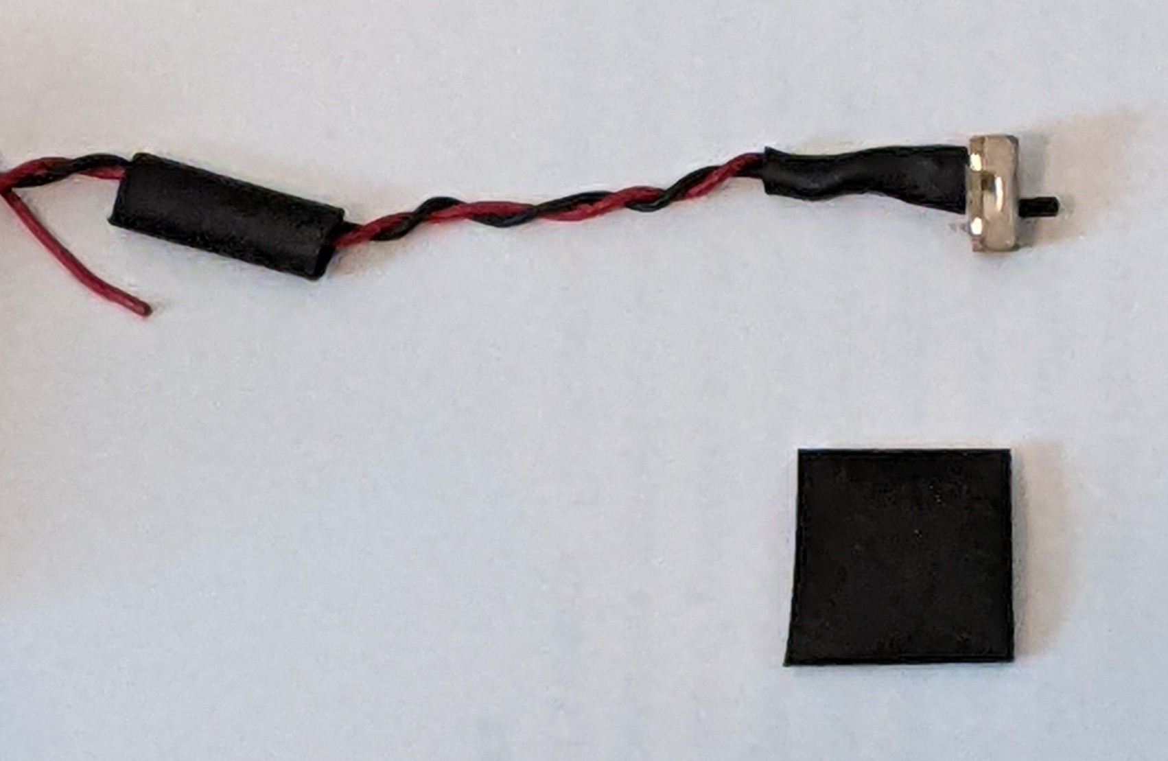

Novak used some sort of setup with shrink tubing over the body of the switch and wires. The shrink tubing I have doesn't shrink enough, so I used a couple of sizes and layered them.

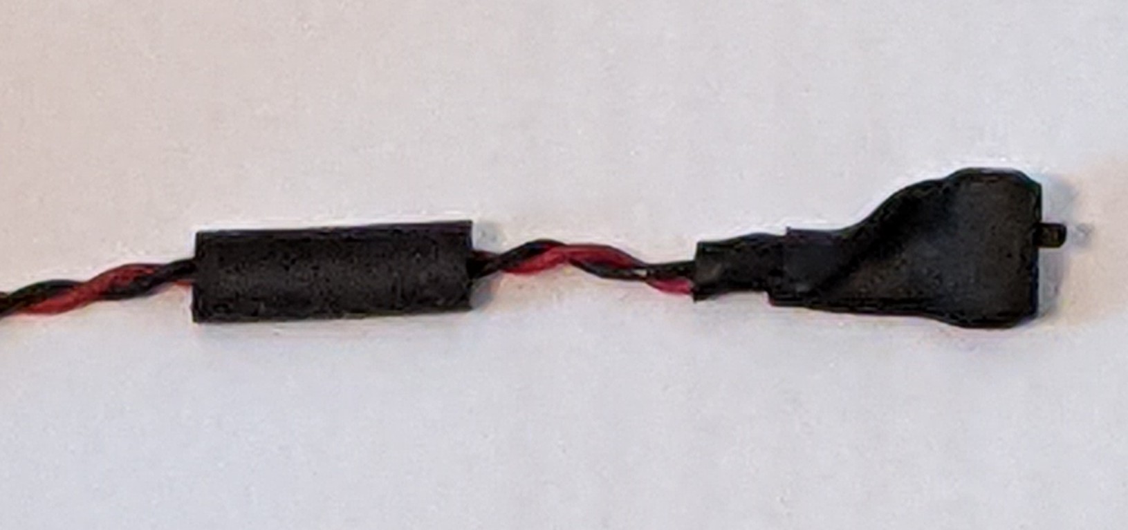

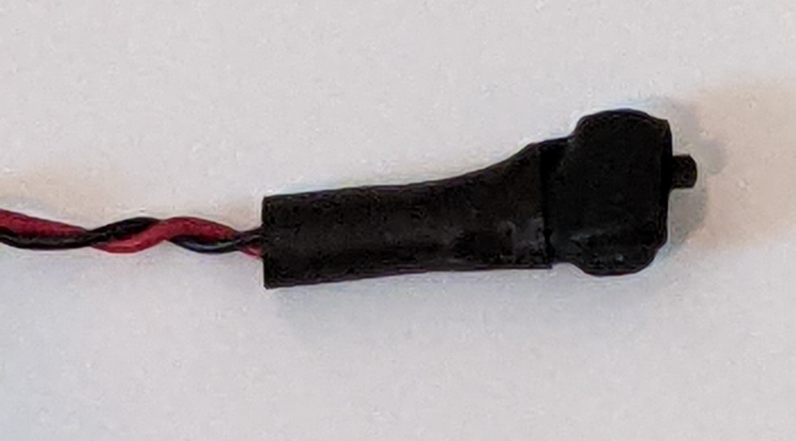

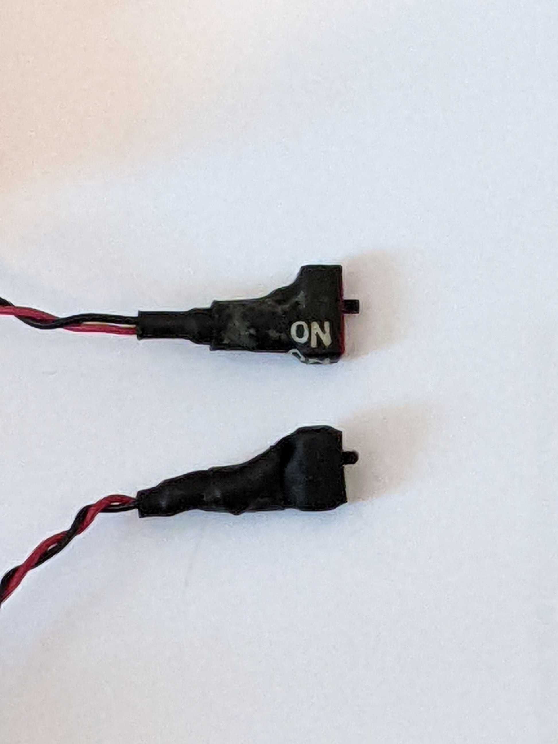

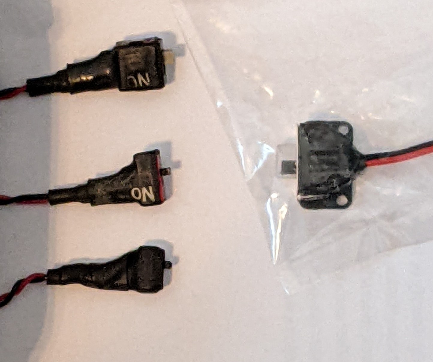

One section over the conductors, another over the switch body with a larger size and roll up the baggy end while still 'warm' (ouch!). Then after it cools off slip over a 2nd piece of the smaller size to clean it up a little.
The switch won't be confused for an OEM Novak installation, but it's satisfying to have something similar that is Novak-ish.

I like restoring the Novak 410 esc's...once you make a couple bad buys on some not working units, you have spare parts to pretty up working ones, lol.
