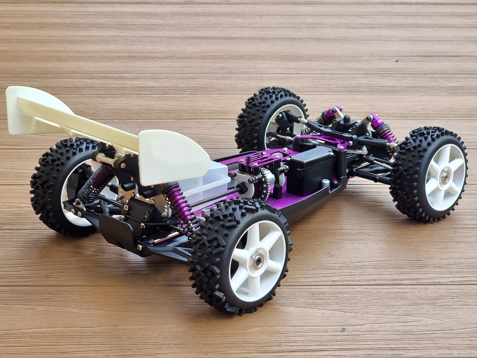

The 3 differentials come pre-built and have machined aluminum housings. Front and rear gearboxes are identical. The differentials have planetary gears rather than the ubiquitous bevel type, and overall achieve a narrower profile. All gears are metal from factory. I installed Athlete Team edition diecast aluminium suspension holders. These have a black painted finish and so are quite understated but nonetheless tougher than standard plastic ones.
The Athlete features a 4mm thickness chassis, anodized in purple. There is no front chassis kick-up; that came in the next generation Super Athlete (following that of the Kyosho Inferno MP5). The center diff mounts here are upgraded to the Athlete Team edition diecast aluminium version. Love the fact that the diff housing and spur gear are all sturdy metal as standard. Brake discs are glass fiber and hard-wearing.

The shocks of the Mugen Athlete come almost fully assembled - just add oil and springs. They are also anodized in the same purple. Both front and rear ends here completed. Front drive shafts are universals as standard. Rear wing mounts are sturdily attached; the rear wing would later be secured, rather uniquely, using C-clips.
Close-up on the Athlete Team upper A-arms option can be seen - stock Athlete would be upper links attached to the front shock tower. The ballraced version of the servo saver is also installed.

4WD drive train in place. Unlike the other 1/8 buggies at the time, the Mugen Athlete opted for a straight line configuration of the center drive shafts, presumably for lowering transmission drag/losses, but sacrificing a little the position of the engine to be further away from the chassis centerline. This is in keeping with the design of its predecessor, the Super Sport.
Another different area of the Athlete is its chassis layout - the engine would be mounted on the right side of the centerline versus practically all other buggies mounting on the left - presumably to counter the torque generated by the center drivetrain; the fuel tank too is closer to the rear than what would be usually closer to the front.

Mugen Athlete Team rolling chassis completed. Hope to source for a period correct engine and more option parts in the future. The body shell will be next.
