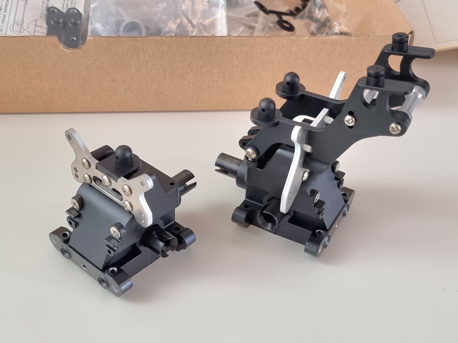

The 3 differentials come pre-built and have machined aluminum housings. Front and rear gearboxes are identical. The differentials have planetary gears rather than the ubiquitous bevel type, and overall achieve a narrower profile. All gears are metal from factory. I installed Athlete Team edition diecast aluminium suspension holders. These have a black painted finish and so are quite understated but nonetheless tougher than standard plastic ones.

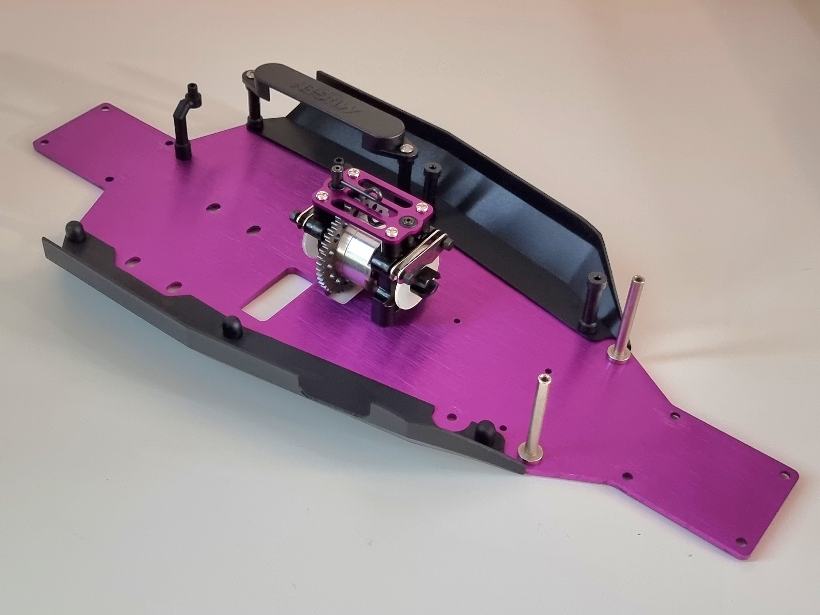

The Athlete features a 4mm thickness chassis, anodized in purple. There is no front chassis kick-up; that came in the next generation Super Athlete (following that of the Kyosho Inferno MP5). The center diff mounts here are upgraded to the Athlete Team edition diecast aluminium version. Love the fact that the diff housing and spur gear are all sturdy metal as standard. Brake discs are glass fiber and hard-wearing.

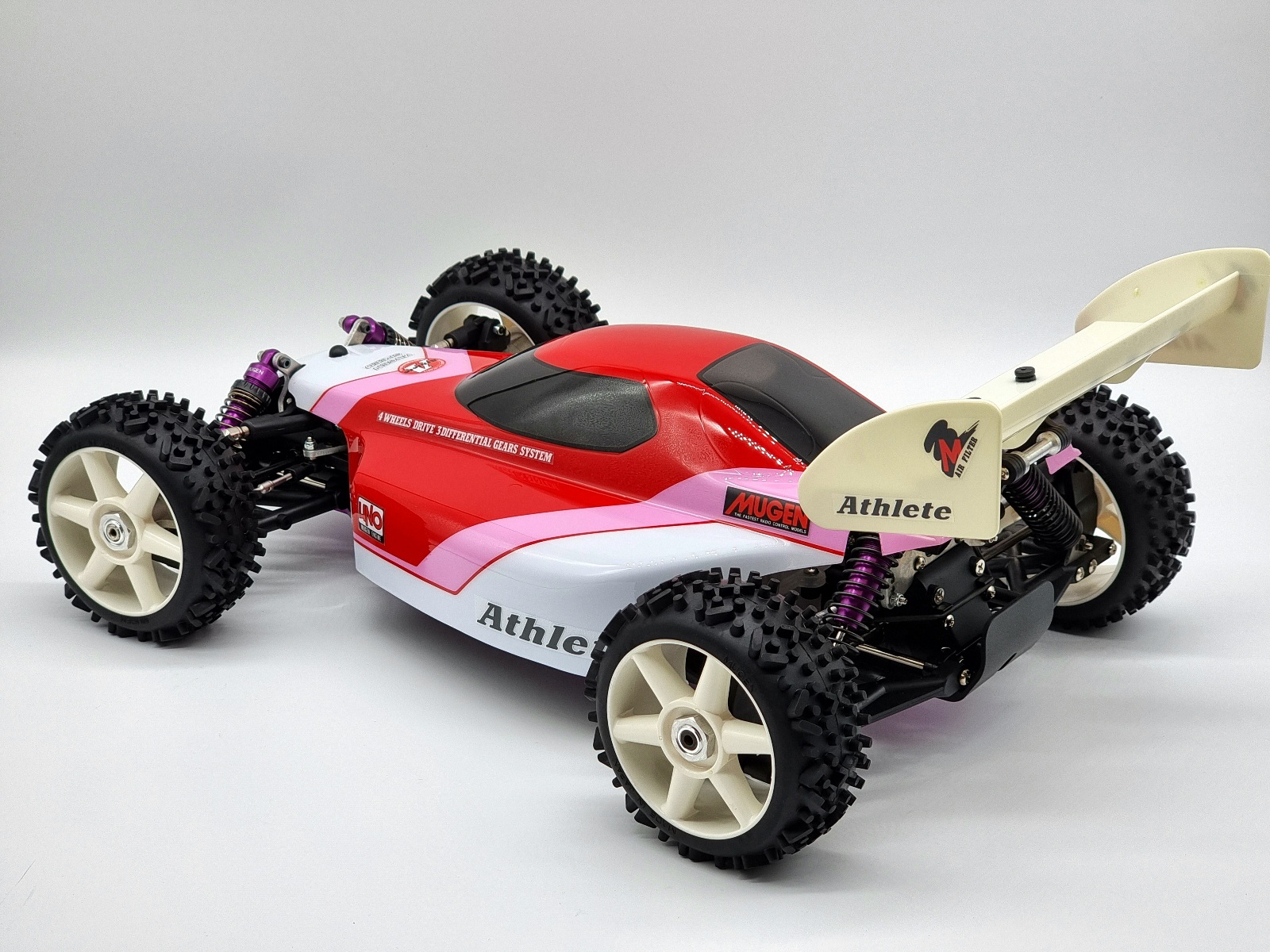

Bodyshell is completed with designer Koji Sanada's paint scheme:
