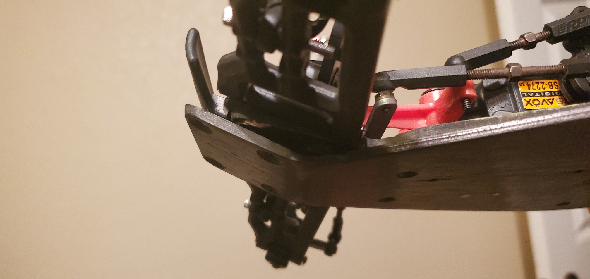

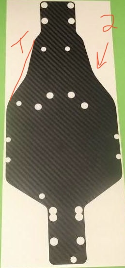

Not trying to thread jack but what is the difference in length of the JRX2 and JRX-T chassis? I'm starting to get a feeling that this 5 link chassis I have may be a Truck chassis and not a Buggy.

Looks like about 1/2-5/8 of an inch, JRXT has more kickup and is shaped a bit differently:

Easiest way to know without measuring, JRX-2 has the curvy side chassis, the pro and jrxt always had the straight sides.

Welp looks like I have a JRXT chassis, Guess I'm making a long JRX2 in my future.
