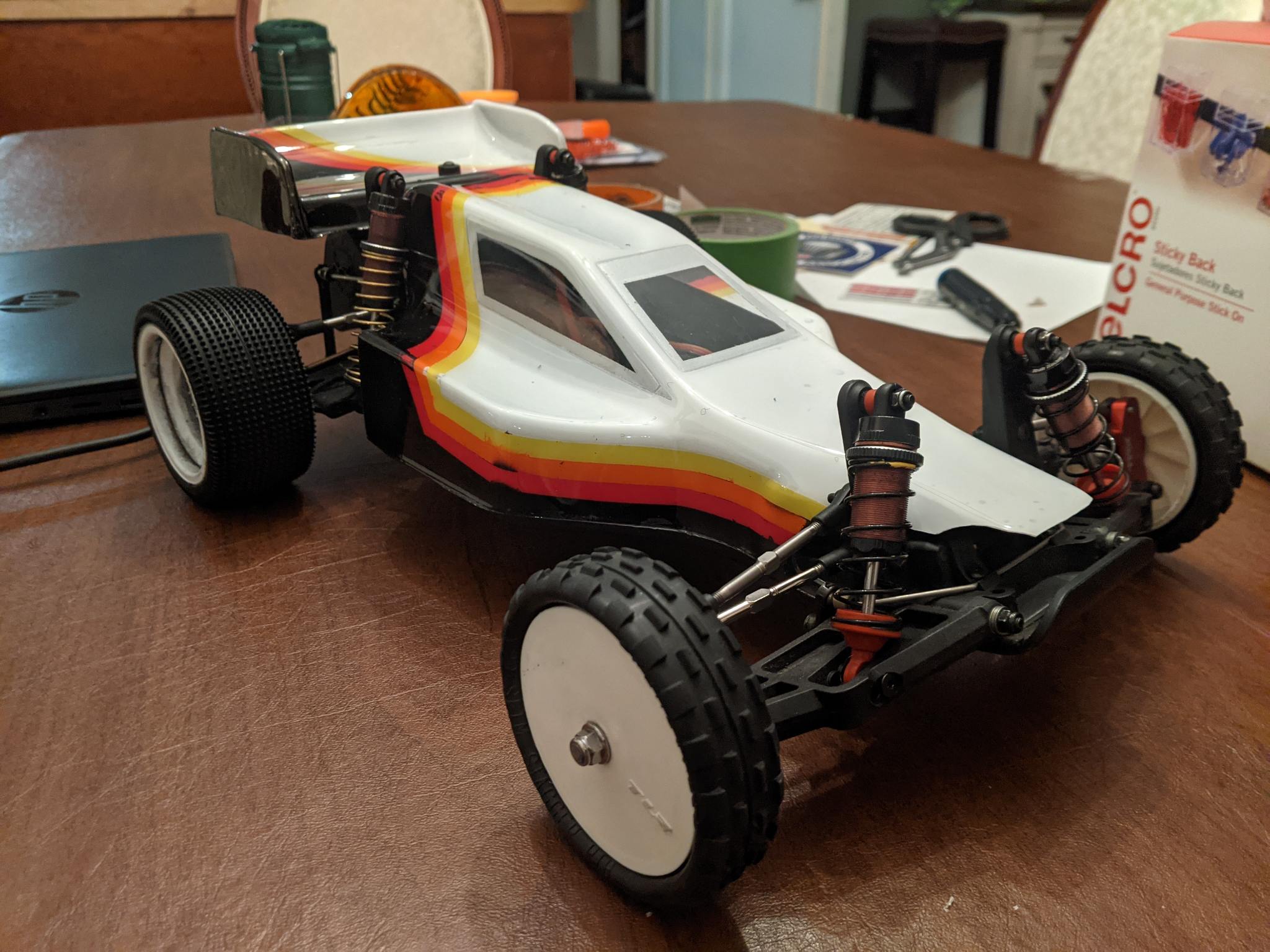

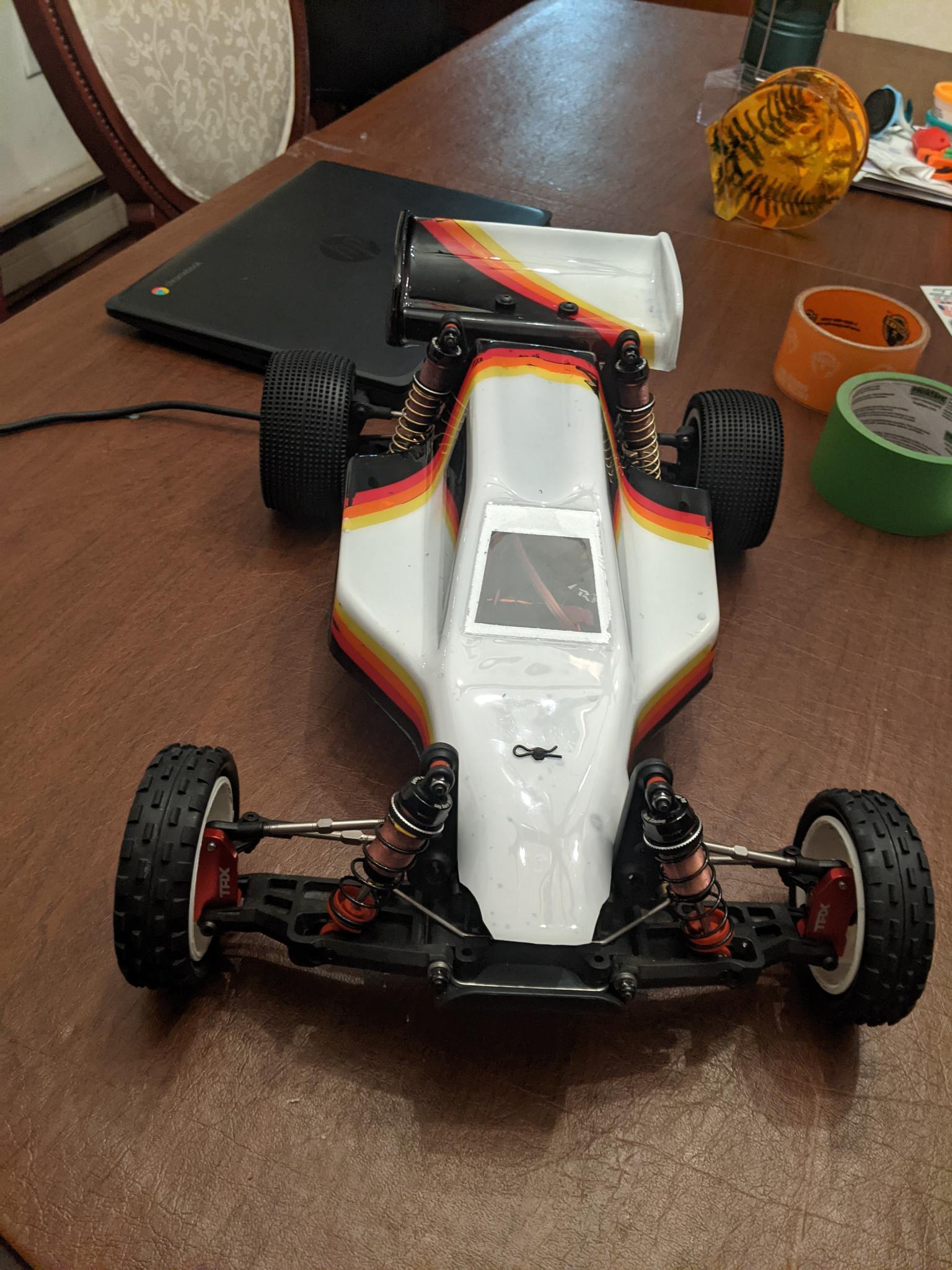

So this is the mod so far. I used a Traxxas Bandit front end and losi wheels to get the front end wider. Also raised the camber link to match the taller front end caster blocks. The shocks are 70mm yeah racing big bores to get the front lower down for the smooth surface of carpet racing. had to use longer links to make it all work out. 58mm for the tie rods and 55mm for the camber links. the back end is mostly stock but the 90mm yeah racing big bore shocks. The car runs unbelievably well for such an old design. This buggy has my complete attention right now I'll be working on it a bit more.

nice one mate, i commented in the other thread about how to fit 2.2 inch wheels to an ultima, I have done a very similar thing as you, but i used Optima parts, which adds 5 degrees of caster which i found helped the buggy turn a lot better and widens the front end and i had to do the same as you and raise the inner camber link point on the shock tower. I race on outdoor dirt tracks and i didn't like the difficult access to electronics etc so i ended up fitting it all to an ultima ii chassis which adds 13mm in wheelbase as well which made the car more stable, but looking at the way yours goes on the tight carpet track, i wouldn't change it

I wasn't wheeling the Ultima in the video. It was a younger more capable A driver. I'd call myself a b average and equal to the guy running the 22-4. It really is on rails. The back end wags the tail a bit haven't gotten to sorting that out. Using the stock gold spring in the back. Could go a tad stiffer but not much. The grip is perfect in the corner don't want to unbalance the car.
Ultima 2 chassis has my head going towards a mid motor mod with an optima mid rear trans setup. But maybe it's just fine the way it is.

i agree, the rear end setup is excellent with the gold springs, once i added the front caster, i had way too much turn using the standard black springs so went to the golds on the front end which balanced it up nicely

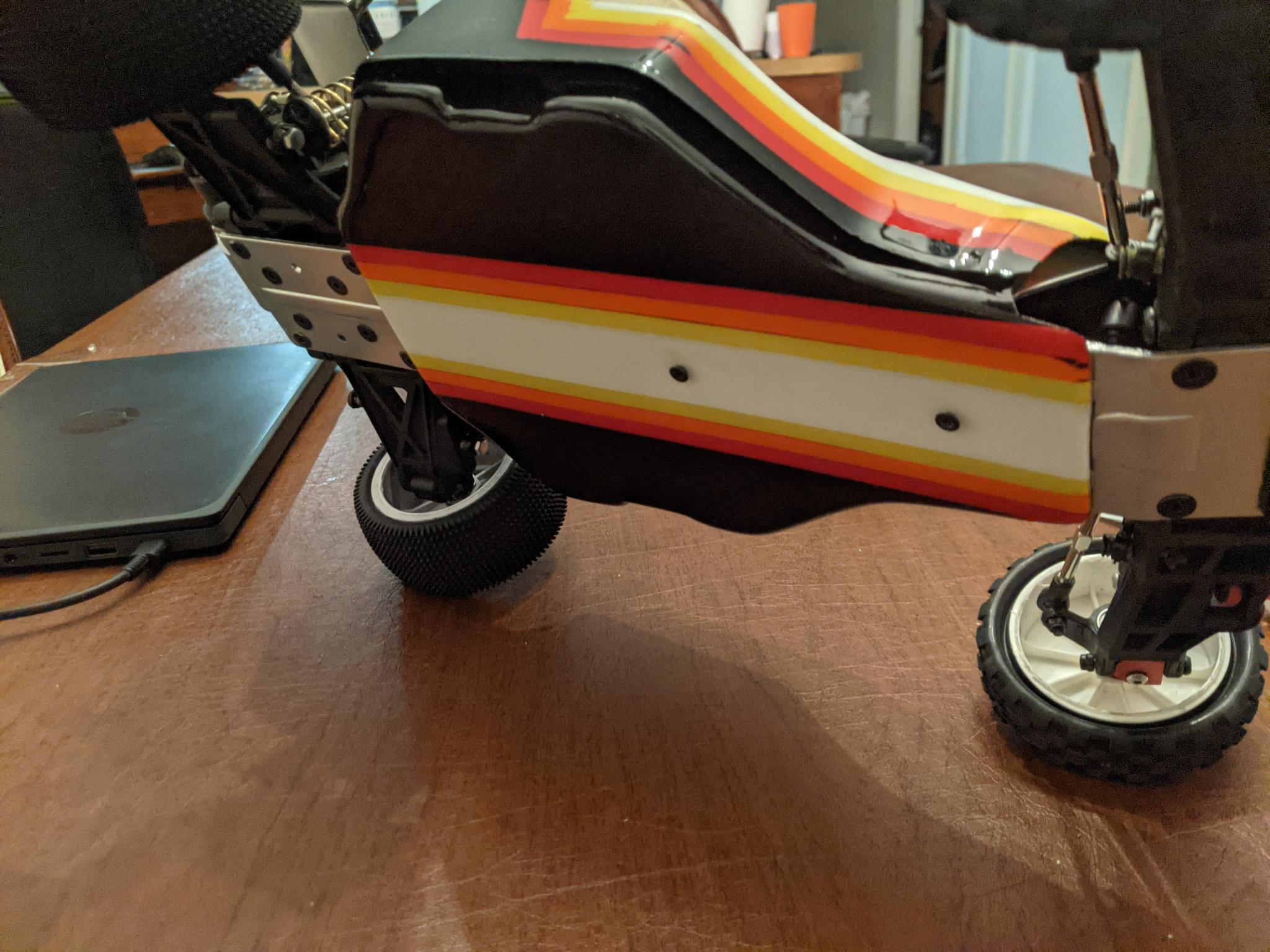

Finally got around to putting a TBG lid on the ultima. Turned out ok. Had a lot of bleed around the pinstripes. Think the tape was pretty old and I was a little impatient. Securing the lid to the chassis was good to. There is three countersunk holes in the bottom of the chassis. Also used clear gorilla tape across the bottom. The battery uses Velcro straps so a couple of pieces of hook tape on the under tray line up to that too.
