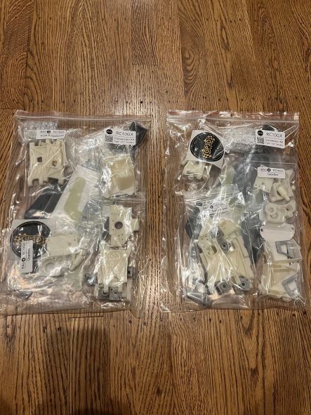

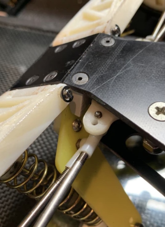

Didn't see a thread started on this yet. Thanks to Andrew Cooke of Grand Prix 3D for making this dream build possible.

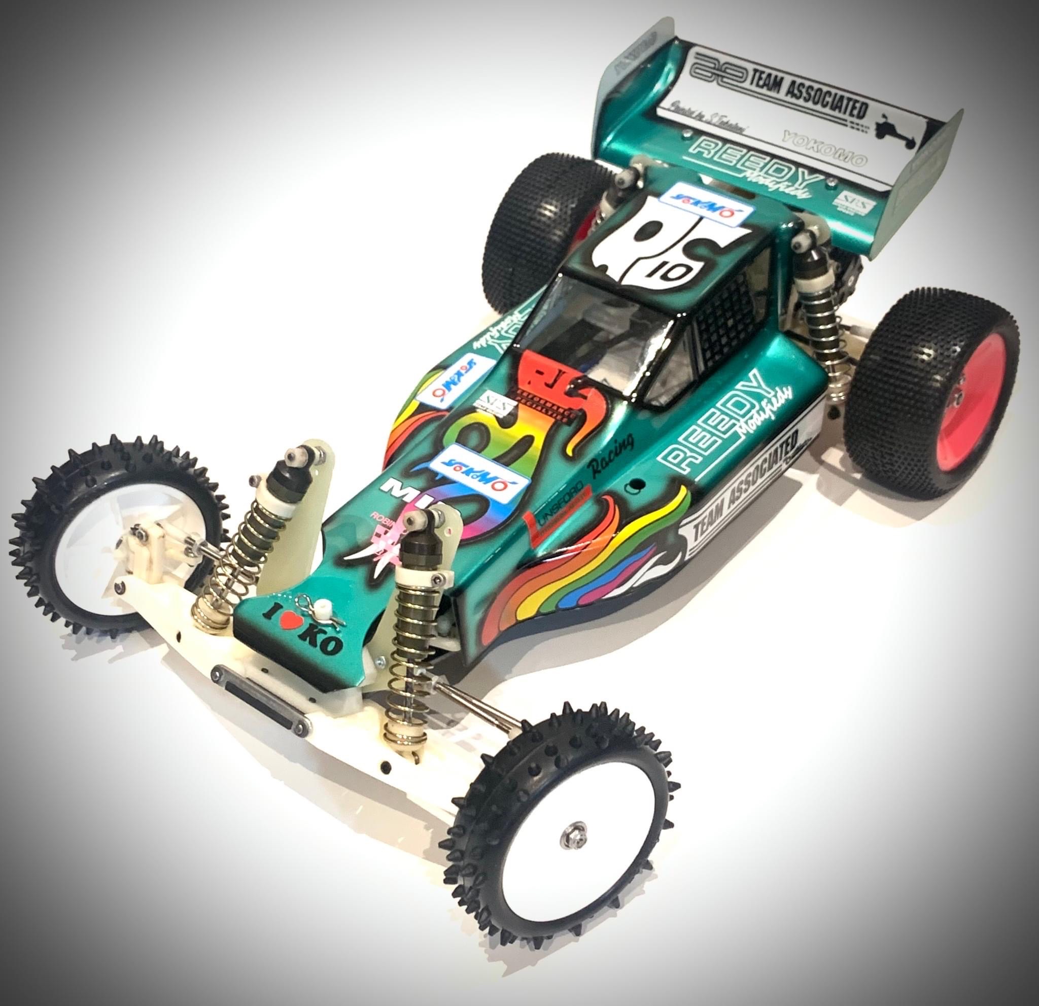

Pic borrowed from his Facebook page.

Got 2 of his first batch of kits. 8)

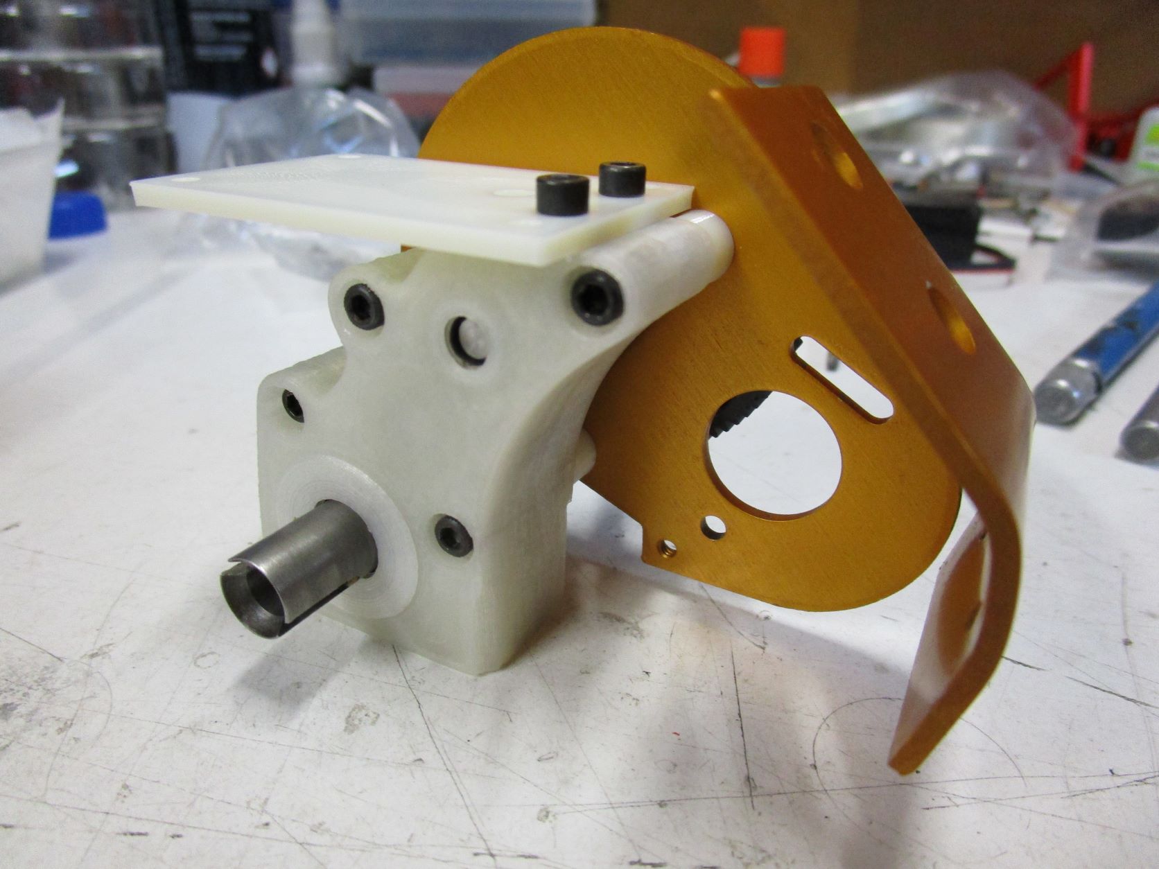

Just built the gearbox for mine perfect alignment spins as good as the original absolute quality product :D

This is exciting. I am not a big enough fan to go all in and build one of these, but it is very interesting and impressive that this build is even possible. So much dedication and effort to bring it to reality.
Have there been advances in 3D printing methods and materials since the '91 Stealth Car campaign? The plastics look more like the injection moulded nylon of the era. That gearbox looks like machined delrin darn near. Amazing. Please continue to develop this thread!

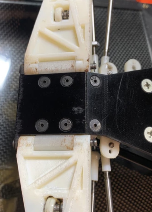

I noticed on the GP3D info page it shows the 30 deg kick-up being stated as “moulded”. On the order page it’s said to be a one piece. Which lower chassis came with your kits ?

MarkyDents wrote: Sun Dec 18, 2022 10:54 am I noticed on the GP3D info page it shows the 30 deg kick-up being stated as “moulded”. On the order page it’s said to be a one piece. Which lower chassis came with your kits ?
It's a 1 piece chassis, the kickup is "molded" in.

Ok that makes sense, here’s where my confusion started. Looking at the pics of the working prototype. I thought when it said molded in it meant the bottom of the bulkhead that the nose piece and chassis were bolted together. So understanding now that the production chassis is all one piece.

The first batch gave you the option of having the built in kick up chassis like I choose or having a separate piece to cut down on costs. Doesn't look like they offer option 2 any more.

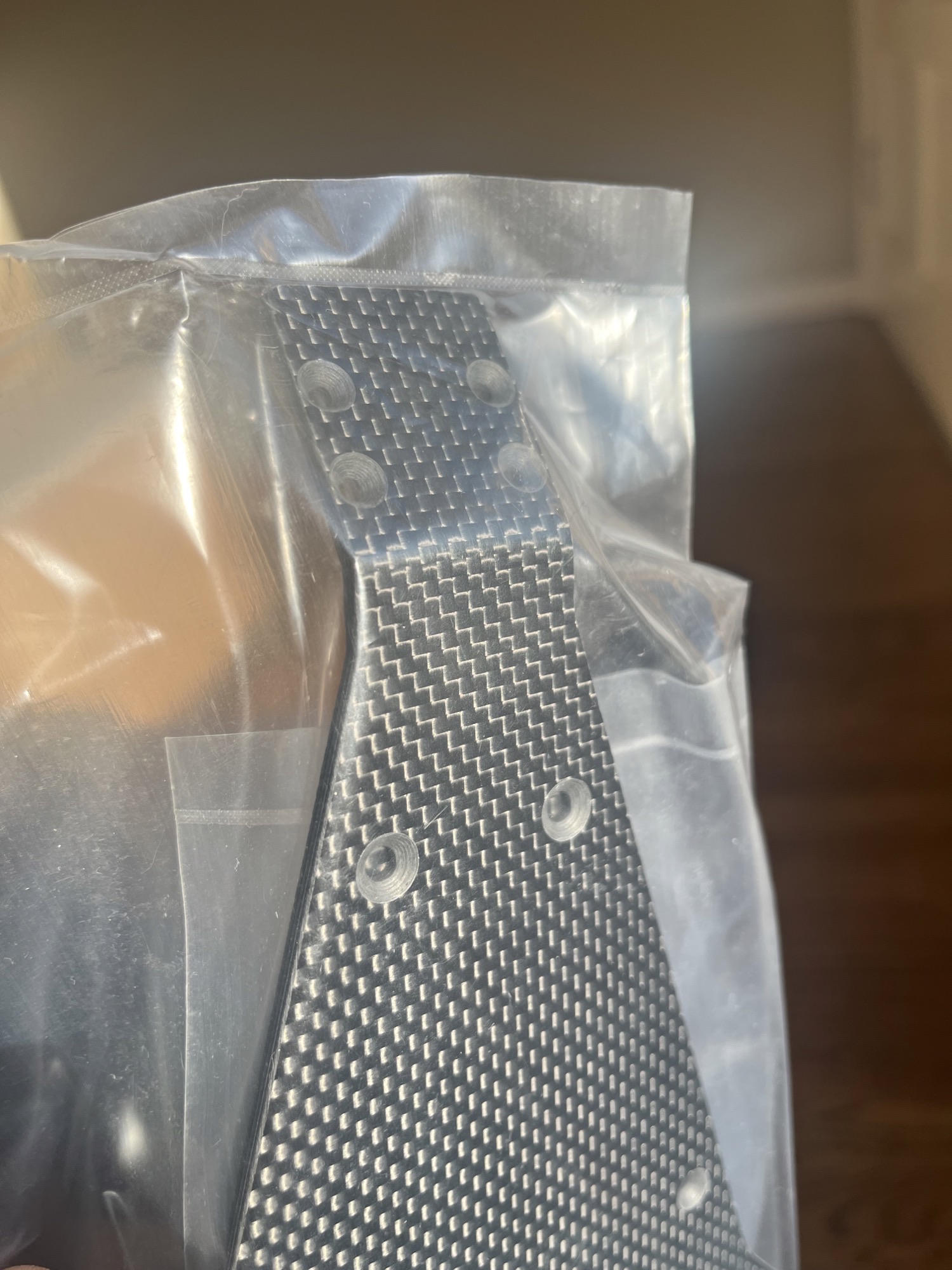

I picked up one of these kits too. I'm really impressed with the chassis.

TRX-1-3 wrote: Sun Dec 18, 2022 12:45 am This is exciting. I am not a big enough fan to go all in and build one of these, but it is very interesting and impressive that this build is even possible. So much dedication and effort to bring it to reality.
Yes, I reckon there has been lots of improved filaments in particular, over the time...
For this project I selected the materials for "look/colour" characteristics as well as for strength and impact performance etc.
The machined white delrin/nylon look was achieved using the MatterHackers NylonG white filament, for the; gearbox, rear arm mounts and front bulkhead
The Associated 'off-white' nylon look was very fortuitous in timing with the amazing Prusa PCBlend filament being released in a 'natural' colour that turns out to be an almost perfect colour match to the original parts, used for the; suspension arms, battery cups, body posts and other peripheral parts
