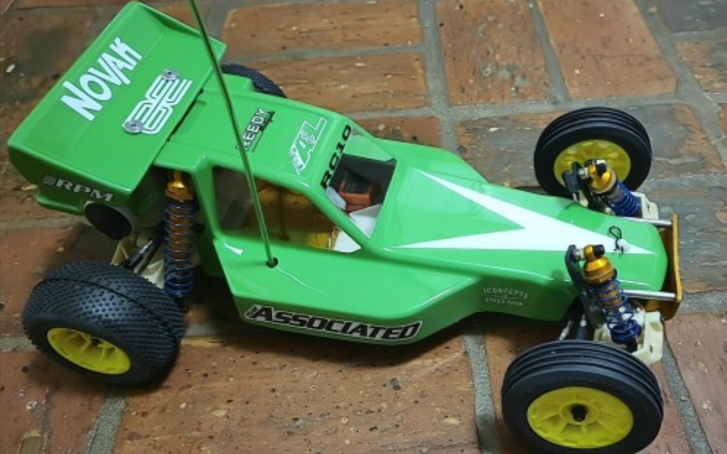

I have six gold pan buggies and all have bodies, but I assume that you are referring to this one (from the "what did you do" thread).tripedaler wrote: ↑Mon Aug 14, 2023 6:55 pm Thanks. Read up on your gp build by the way- looked amazing! Did you ever get to the body? The thread left me hanging.
If it was a different one, let me know.

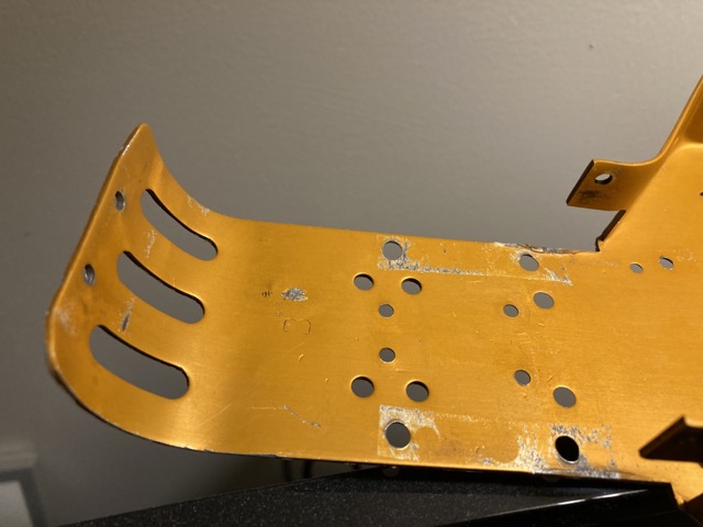

- knixdad
- Posts: 396
- Joined: Thu Jun 06, 2013 3:48 pm
- Location: Califon, New Jersey
- Been thanked: 4 times
Re: RC10 Goldpan ESC advice

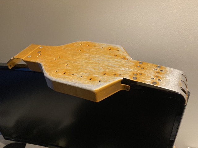

Flip it, we all like seeing the stamp.
I miss brushed motors in that hazy, everything seemed better when I was a kid, kind of way.
Waiting on a bearing kit. Now to commence the rebuild.
The only thing I’m really wondering about is wheels
And tires - any recs?
