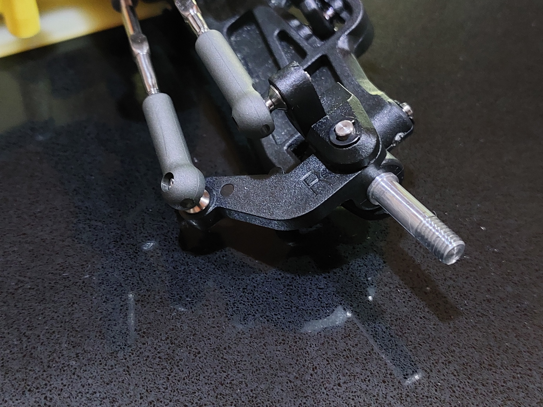

I "think" that the Nitro Rustler, Bandit, and Drag Slash uses the correct outer hinge pins. They share the same front arms, with 1/8" pins.
There should be something lightweight available for the Drag Slash.
The Nitro Rustler also uses the early style caster and steering block arrangement.

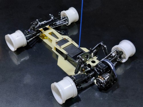

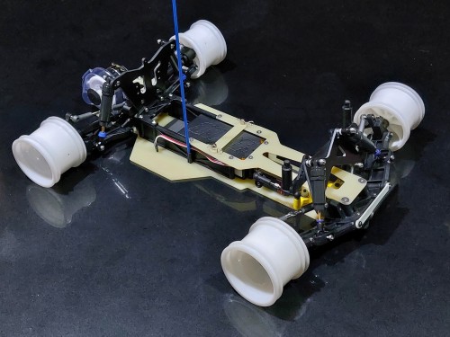

Many many thanks to Chris (1300GT) for machining up a set of aluminum axles for me. They fit much better than the crappy steel ones and shave off 7 grams.
Some pretty high end electronics going into it..... XR10 Pro 17.5 combo with Zombie 6000 Shorty 140c/280c and extra large capacitor. I'm also happy to see "Wet Noodle" is still a thing and Deans is still going, too bad they don't make their solder any more as it was hands down the best
After an epic long delay in shipping I finally have the remaining parts to finish it. It's starting to look pretty good for a Traxxas.

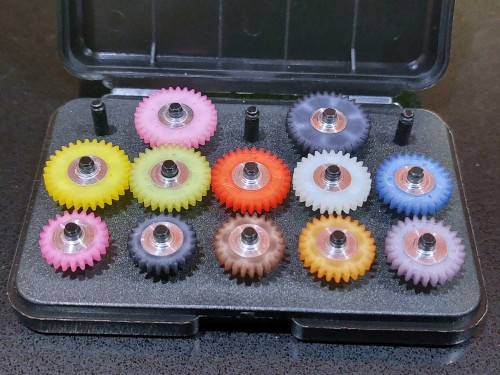

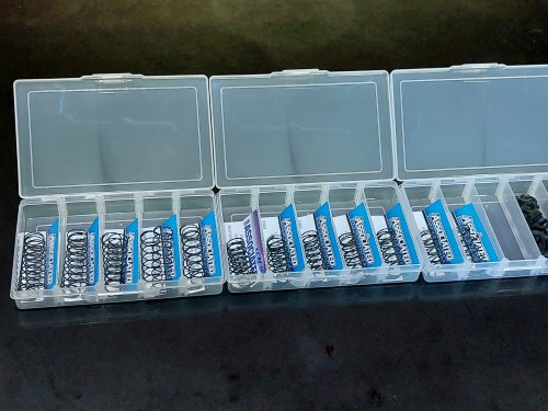

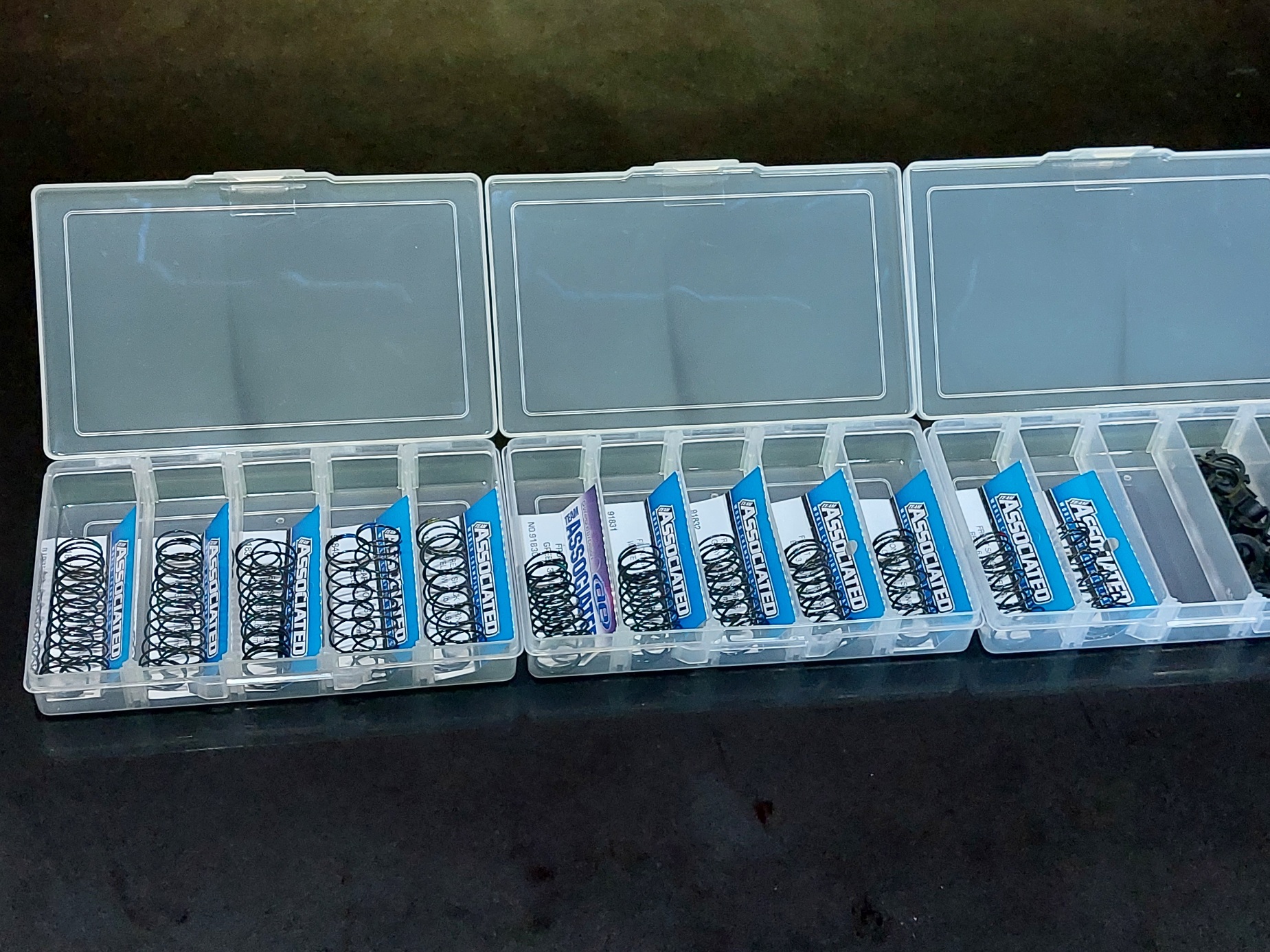

I've organised my springs and pinions, I don't know how well the pinions will hold up but we'll give them a try, they are super thin!

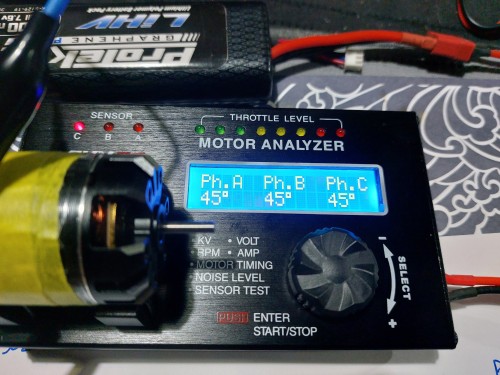

Phase timing on this motor is excellent!!

This really an incredible build. I love the attention to detail, especially all the small changes to save weight. It's amazing how much time and energy are spent to sort all the little details that many folks gloss over.
It's a great looking truck. I hope it runs as good as it looks!

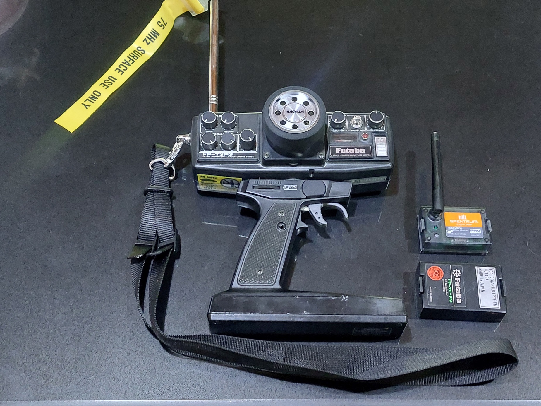

I've tested the radio with the module and everything works great. Unfortunately I doubt I'll have enough time to find an antenna to modify a spare Futaba module so it will just "hang" in the back of the radio for now. Not ideal but it should last a weekend hopefully. A Futaba 3PJ Super would be the period correct radio for this truck but the Magnum Sr. is my favorite

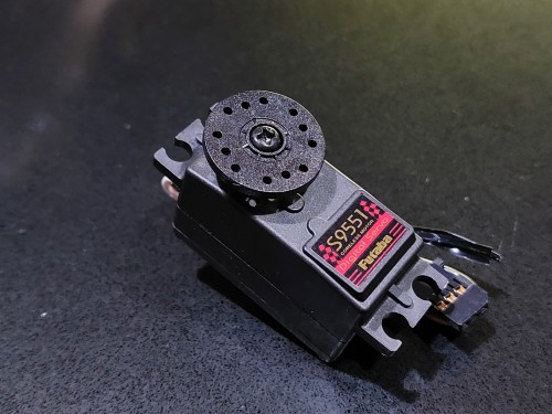

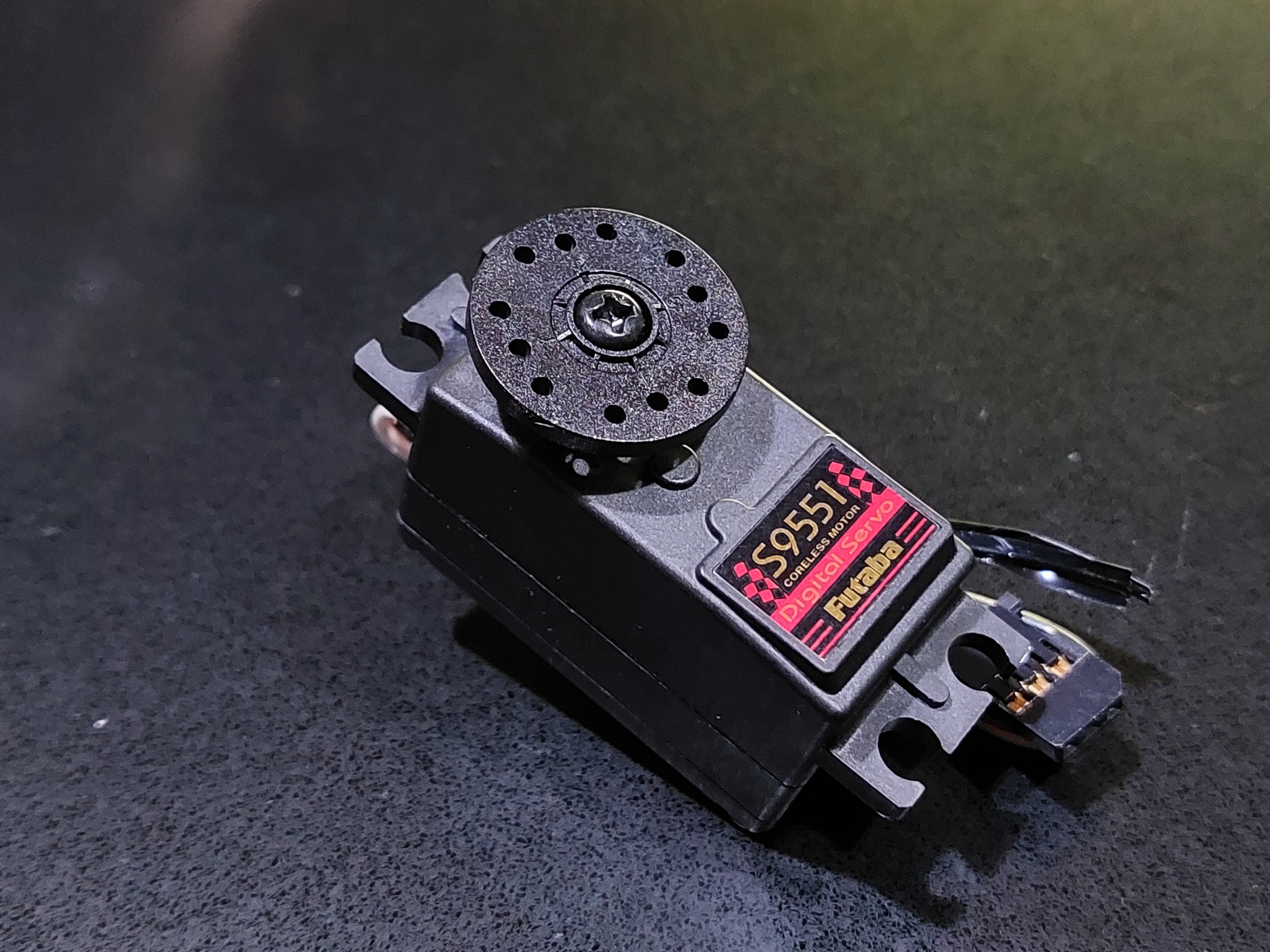

Lastly in keeping with the Futaba theme and keeping it somewhat old school I chose this low profile oldie but goodie. It's really not that old in the grand scheme of things but considering how much servo/brands have changed in the past few years. And surprise surprise, it's light

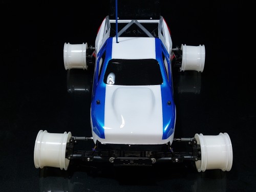

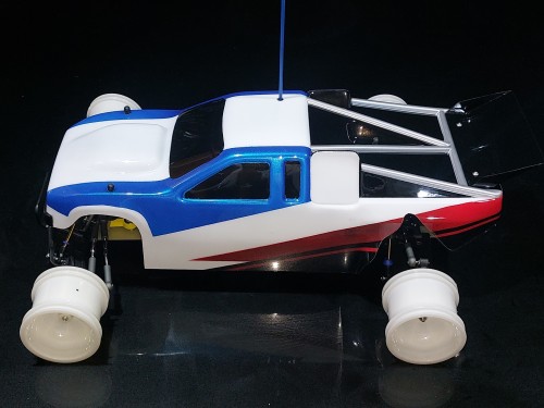

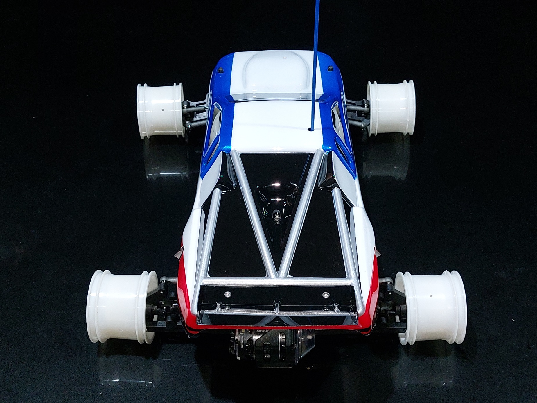

I hate painting bodies as I suck at painting, it's good from far but far from good. I don't know if my Tamiya tape was old or what but I suffered a lot from edge bleed, the tape felt a little different then I remembered it. Maybe it's time to try a different tape. I should learn to use liquid mask but I don't have a steady enough hand.
At least it's presentable and will look great going around the track. I hate the reproduction MCI grill decal but it is what it is, better than nothing.
I still can't believe I'm racing a Traxxas

The futaba 9551 is my favourite servo, great choice
