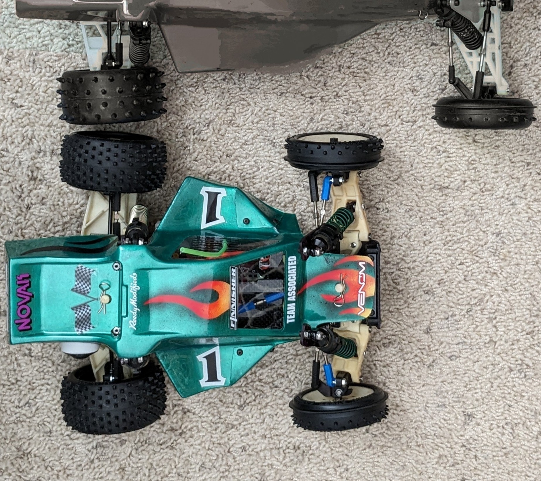

Comical Racer
Thorp 48 pitch gearbox
MiP CVD rear drive axles
Yokomo rear wheels and No Coast adapters
purple graphite front shock tower
bad @$$ front and rear Tamiya Super Gripper tires
build is here:
https://www.rc10talk.com/viewtopic.php?f=35&t=48561

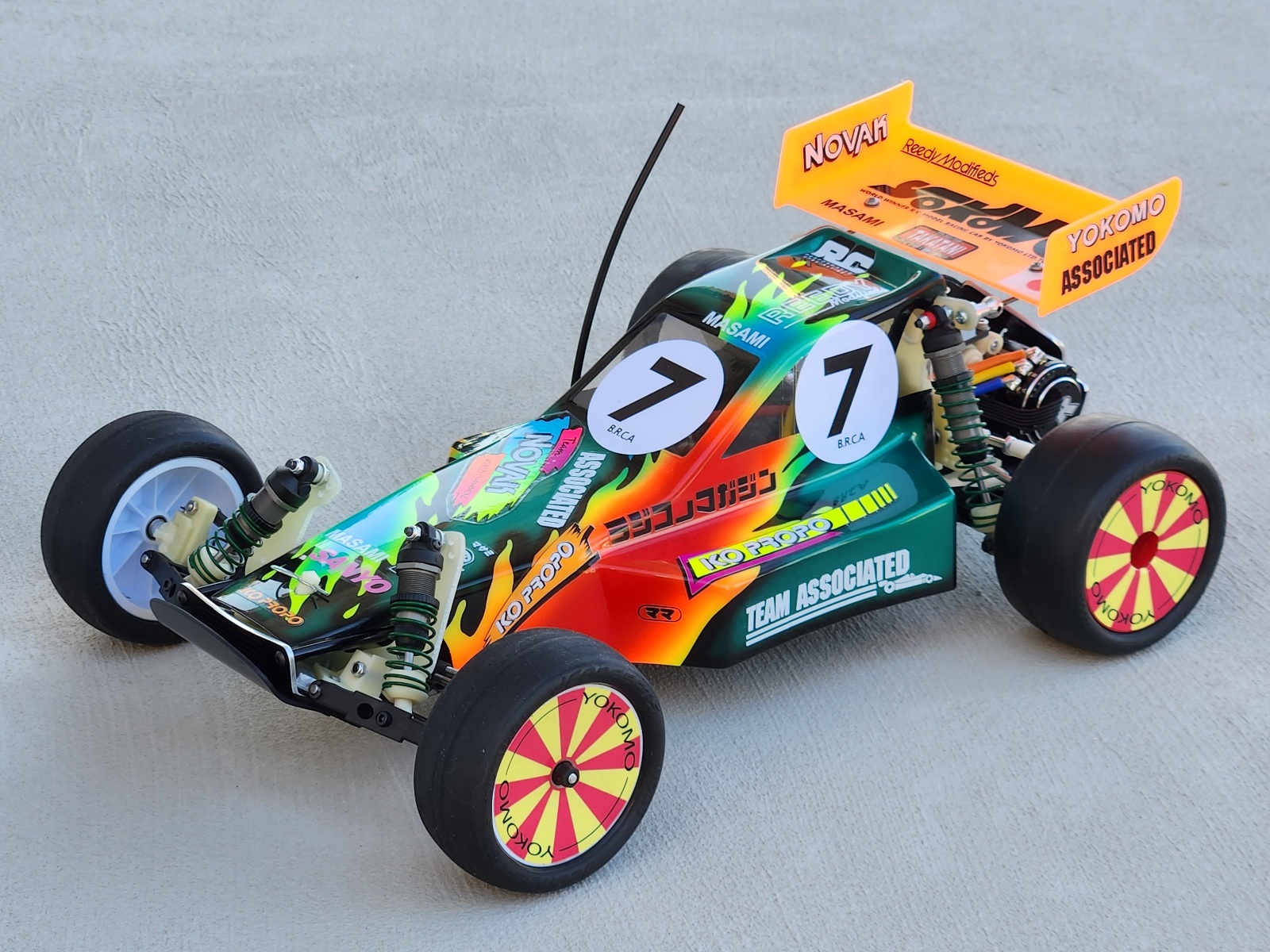

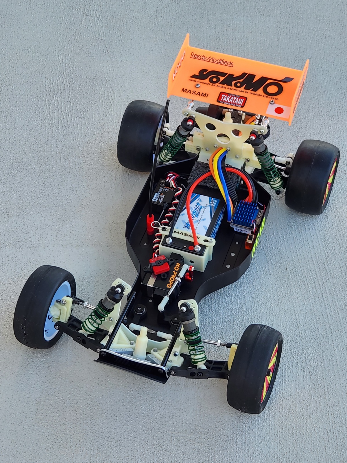

Masami 93 Worlds replica/tribute.

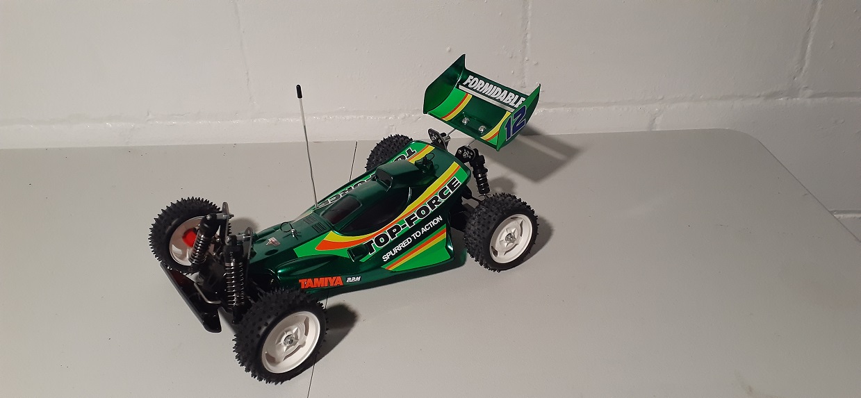

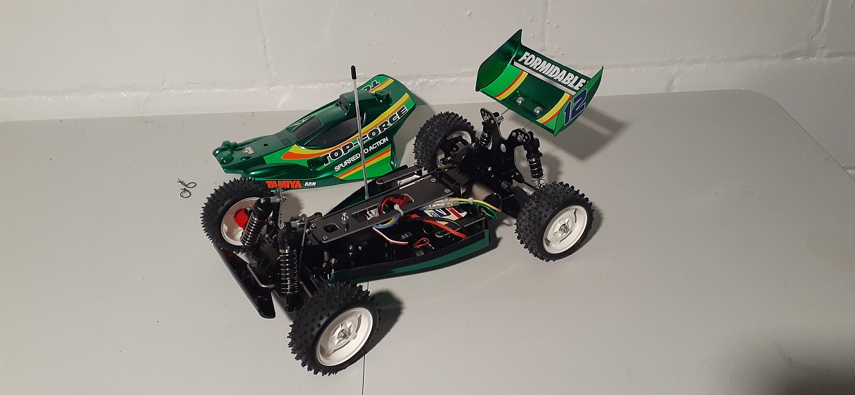

2005 Top Force. Built from NIB kit. Had to replace the right rear axle as that part had come from the factory not threaded.

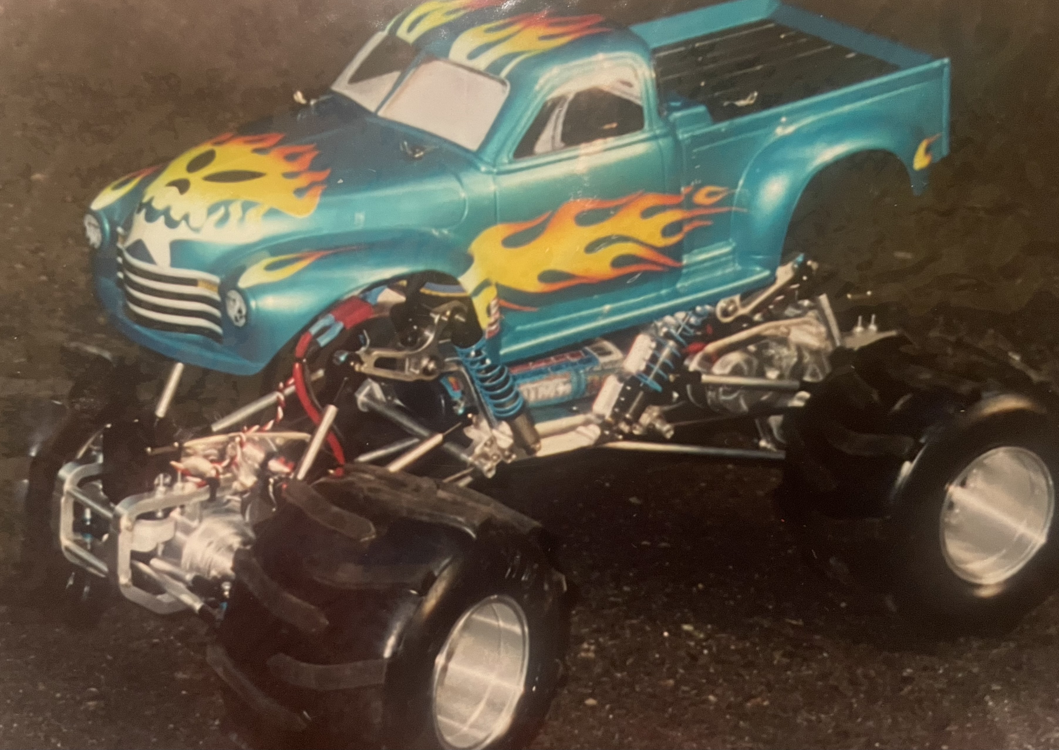

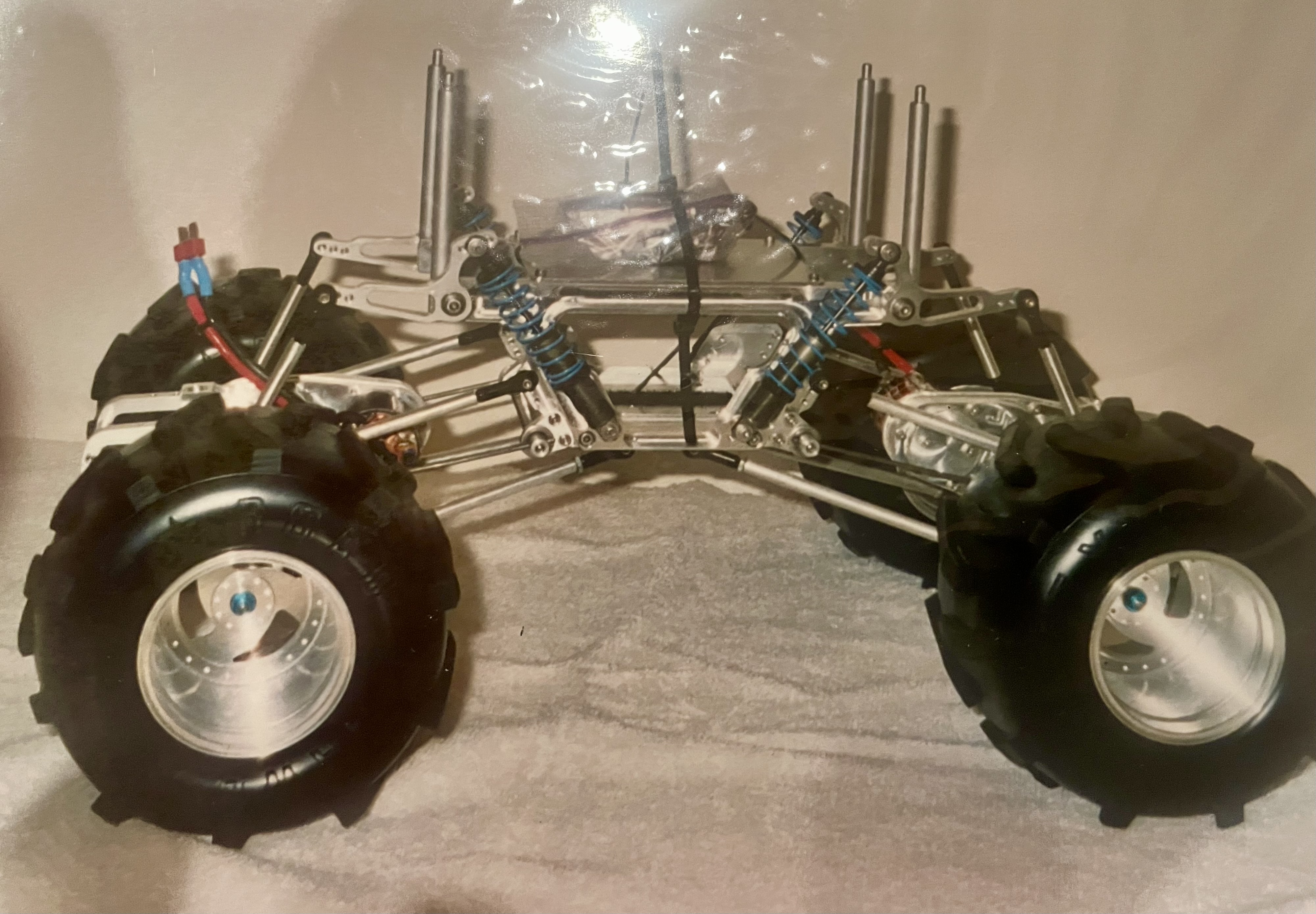

Place holder
Jps Clodbuster, gearbox’s, wheels
Imex tires
Custom Proline body
Fantom 12x2
Superooster esc
Deans plugs
Hitec servo 645mg
Losi threaded shocks
Imex tires
Custom Proline body
Fantom 12x2
Superooster esc
Deans plugs
Hitec servo 645mg

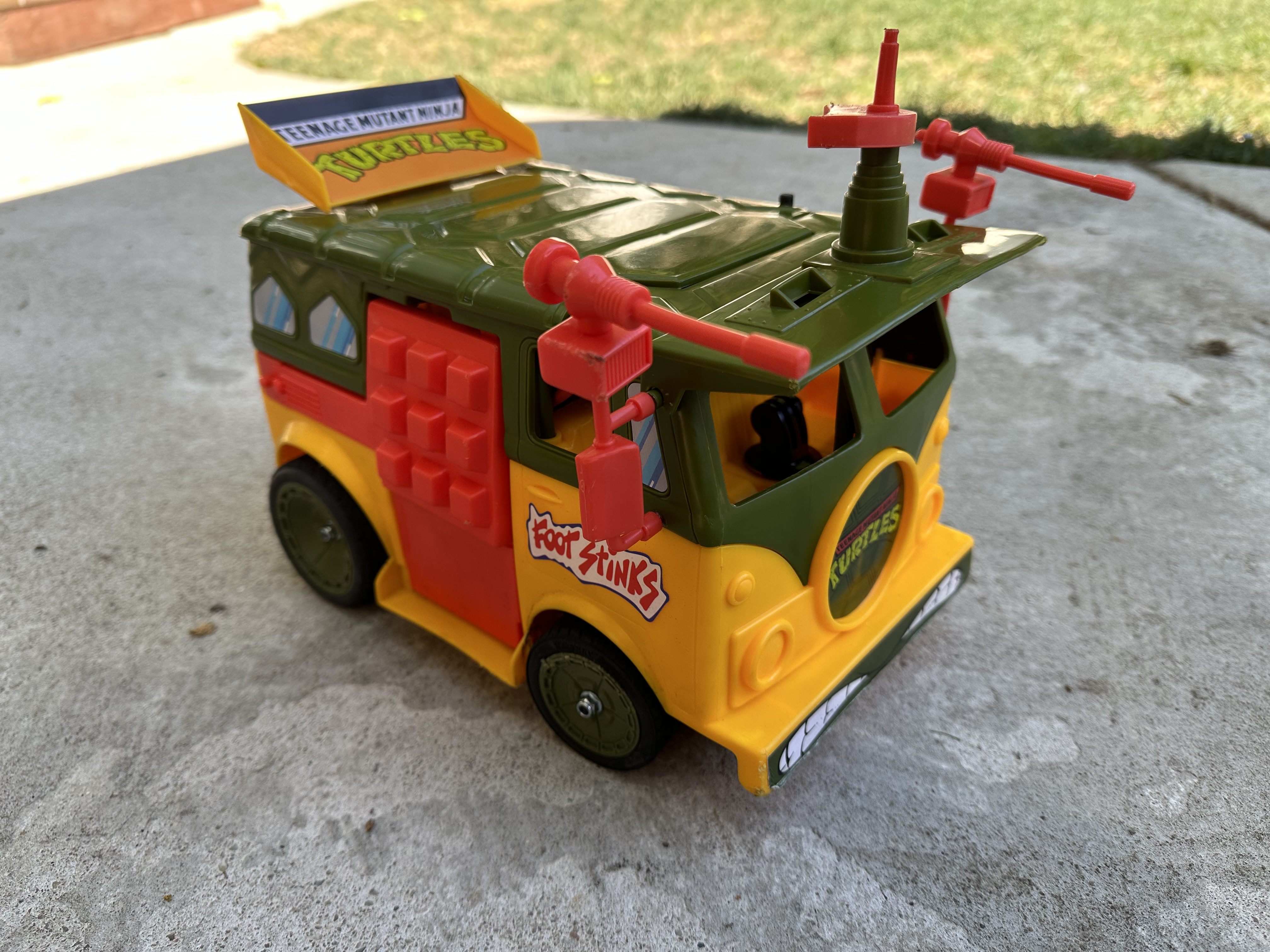

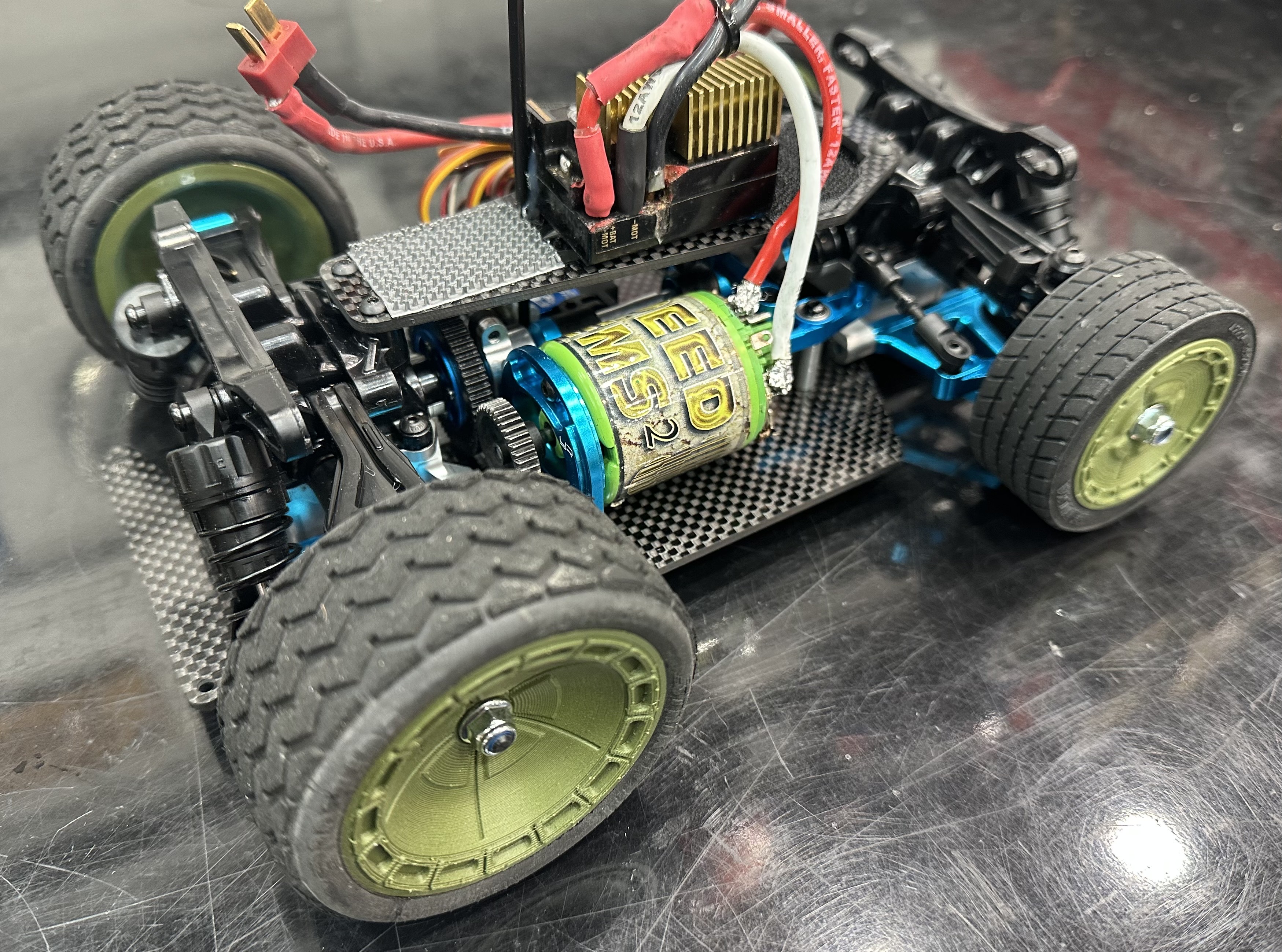

First time submission.
This is my vintage TMNT party wagon that was converted to RC with a custom designed/fabricated Tamiya TT-02 chassis.
The TT-02 chassis seemed like a good fit but it had to be shortened by 4”. I was able to squeeze everything onto the shortened chassis but had to move the steering servo to the left side of the vehicle. Even then, the steering bell ranks were hitting the end bell of the motor and needed a bit of dremel work. The custom bits of the chassis include the following:
- CNC machined upper and lower carbon fiber deck
- Machined aluminum prop shaft
- Custom designed and 3D printed body posts
- Custom designed and 3D printed wheels
- I also had to hack up the toy to fit over the chassis.
For the wheels. I found appropriate front and rear tires that were a close match to the original plastic toy wheels in diameter and width. I then had to design custom wheels that not only looked the part but also had the appropriate offset to set the correct track width (front and rear) when paired to the TT-02 chassis. With the design finished, I 3D printed the wheels.
I am quite happy with the end product it looks good and is fun to drive around.
Here are a couple of running videos
https://youtu.be/BoSSjhG4yWw?si=Tv522HYGX-CdVuG_
https://youtu.be/yMojzqWG6M4?si=qyMFsFAhG3XgrZN_

Turtle Power!!!

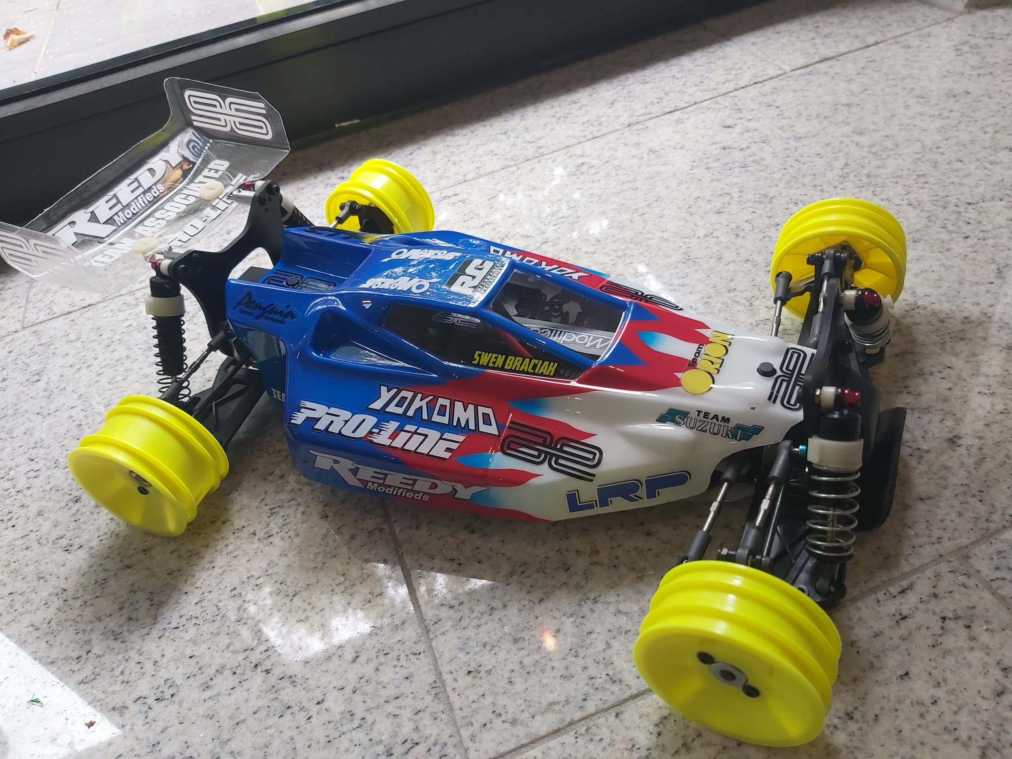

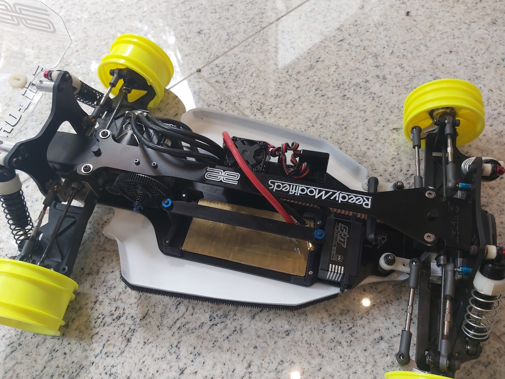

Yokomo Works 91
Pavidis Replica (somewhat)
- Neovintage Chassis Set
- Fan Rc Middleshaft
- Apart of That original arms, shocks, diffs ...
ENJOY
ENJOY
