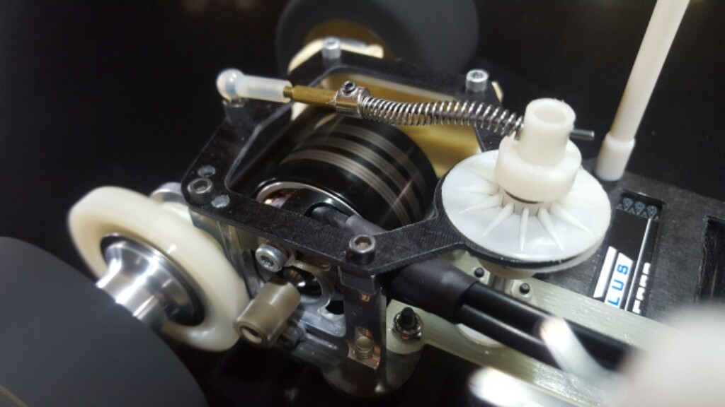

I chose a unique path for mine. I haven’t really run it much but I haven’t forgotten about it either. Finding round LiFe/LiPo/LiOn cells that fit the battery slots have proven challenging.

That's a cool little motor. What is that? Is it sensored or sensorless?

Unfortunately it's a sensorless outrunner, but it seems to work well. Any time the wheels spin the motor can spins for something different, plus it sounds different too.

it's neat looking though! probably helps smooth out throttle response a bit too since it has more rotating mass
