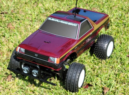

Also keep in mind that lighting effects the color, as seen. Metallic and florescent colors have very noticeable changes.
This is Tamiya Metallic Burgundy, backed in gunmetal.
It shines and sparkles in the sun but looks extremely dark inside.

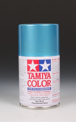

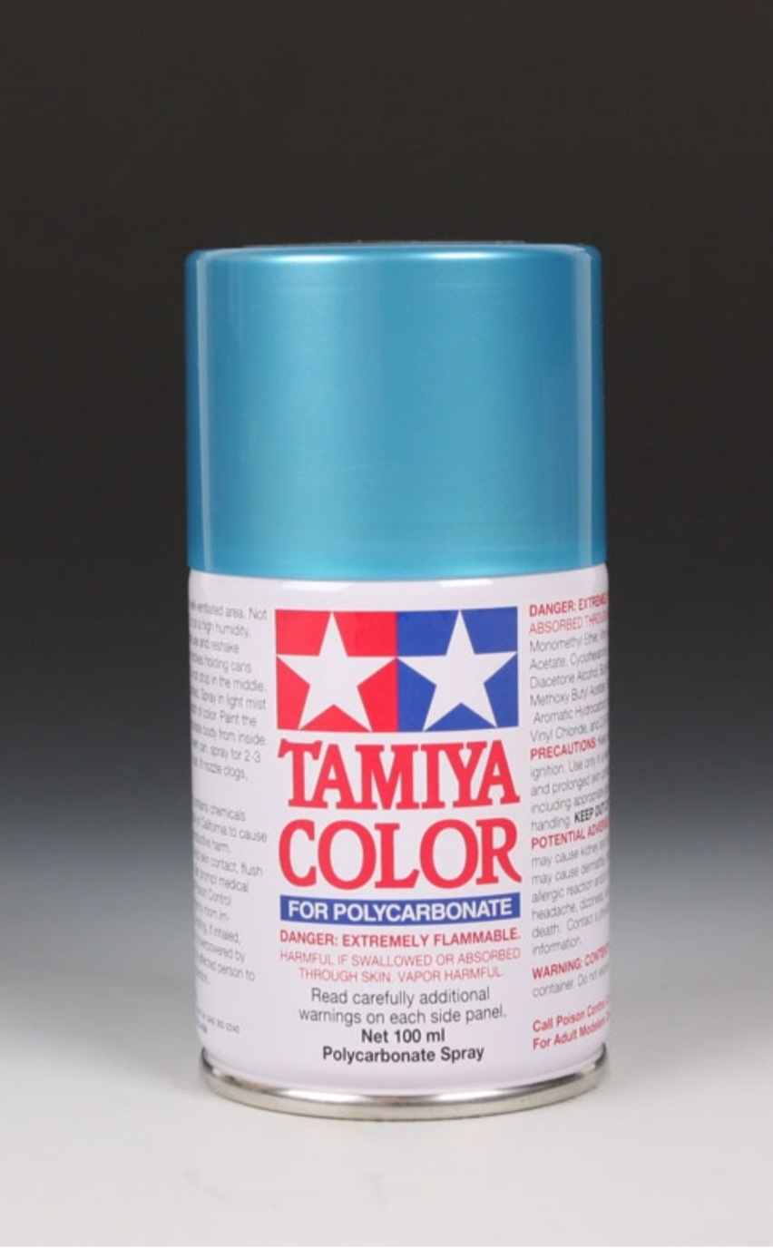

Looks like I picked the wrong base coat to begin with. Should've used this one.
Instead of PS-16:
- in my defense, this was the sample for PS-16:
Had I got the light metallic blue, and then went darker with the backing color, I think I could get closer. Another expensive lesson learned.

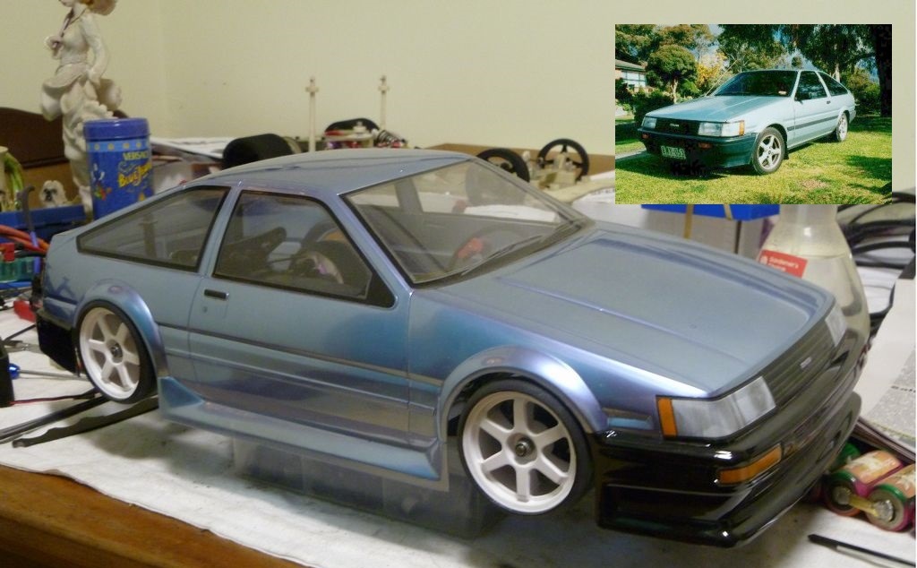

mikea96 wrote: Tue Jan 23, 2024 10:08 pm Maybe this tamiya ps-49
The PS-49 might be a little too silver for the original colouring wanted.... I used this on my AE86, to match my 1:1 version, and this is how it came out:
With how transparent the PS16 is, the white or silver backing may just work...
Look forward to seeing the results :D

Seems a bit more silver blue, than blue.
Anxiously awaiting the silver, hoping that's the key to getting close to Chevy Marina Blue.
