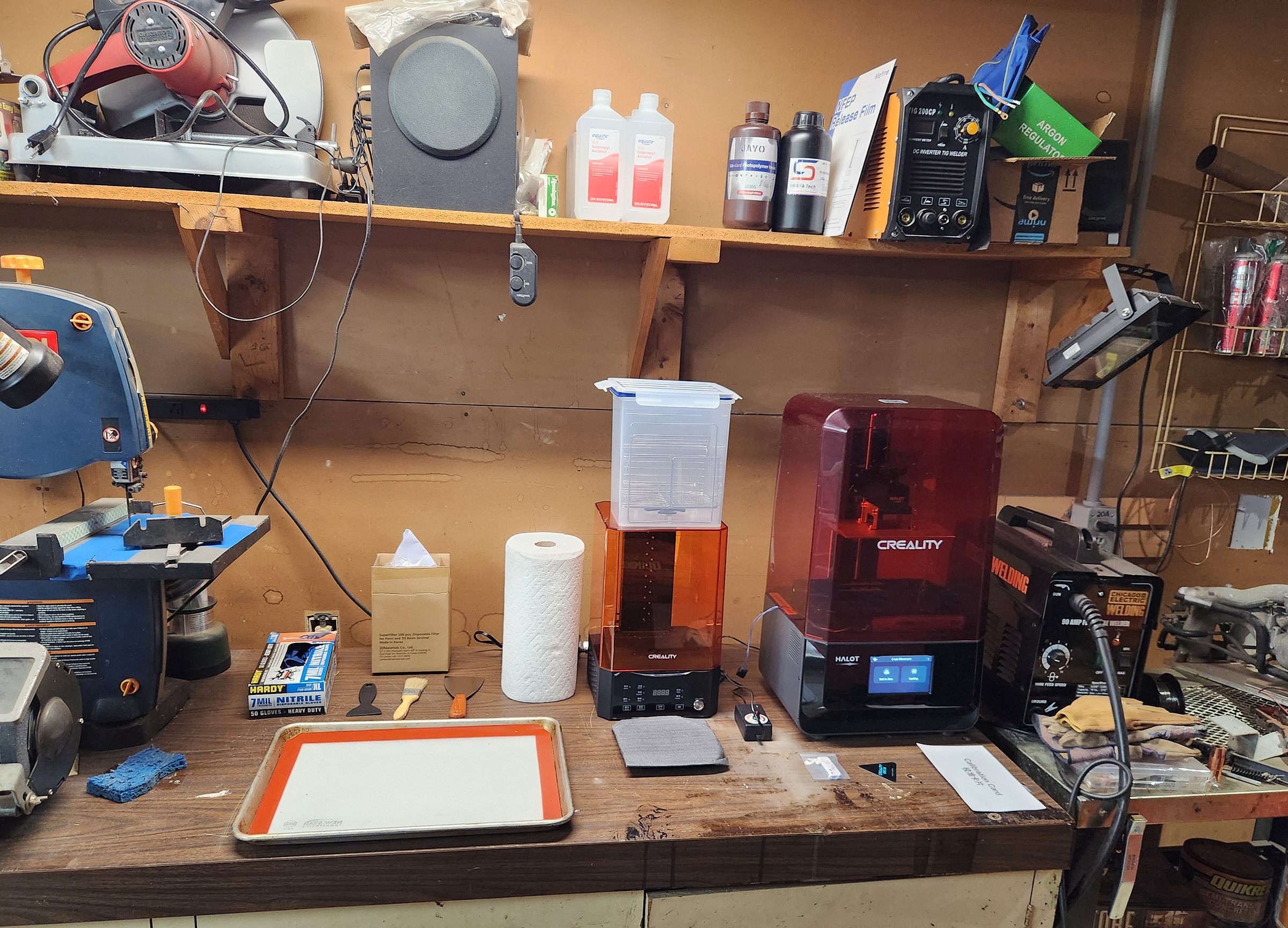

The typical "I don't know what I am doing yet, but I have gathered things" pic. Attending some youtubeniversity classes now. I have the set up in a super leaky 1980 detached garage, so not worried about fumes for the most part. The thermal slab will be an issue during cold months, but I have a ThermalVatBand installed so I think that will be okay. It is located too close to where I cut / grind / weld, so I think I am just going to literally throw a tarp over it all while doing these activities. The local WallyWorld has 91% IPA for $4/qt, so just going that route. It may be too nice this weekend to get into it too deep, but hopefully will be experimenting soon.
