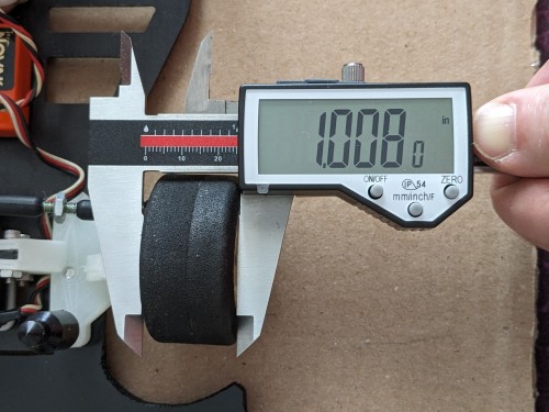

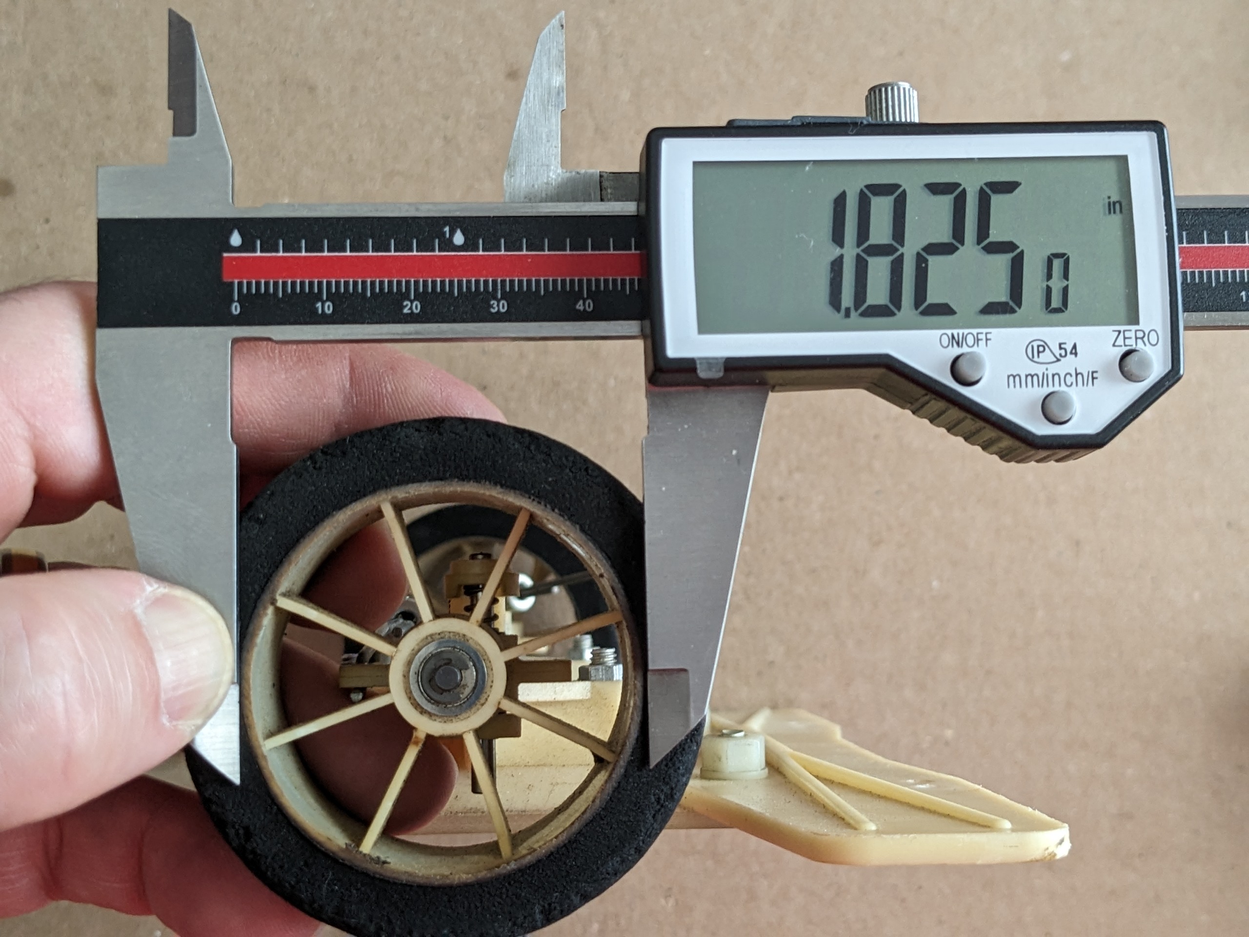

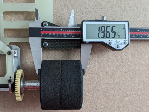

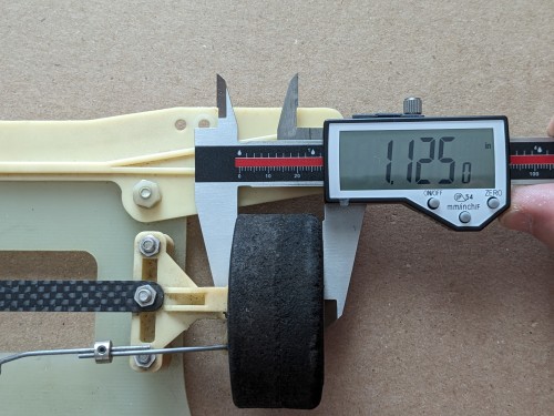

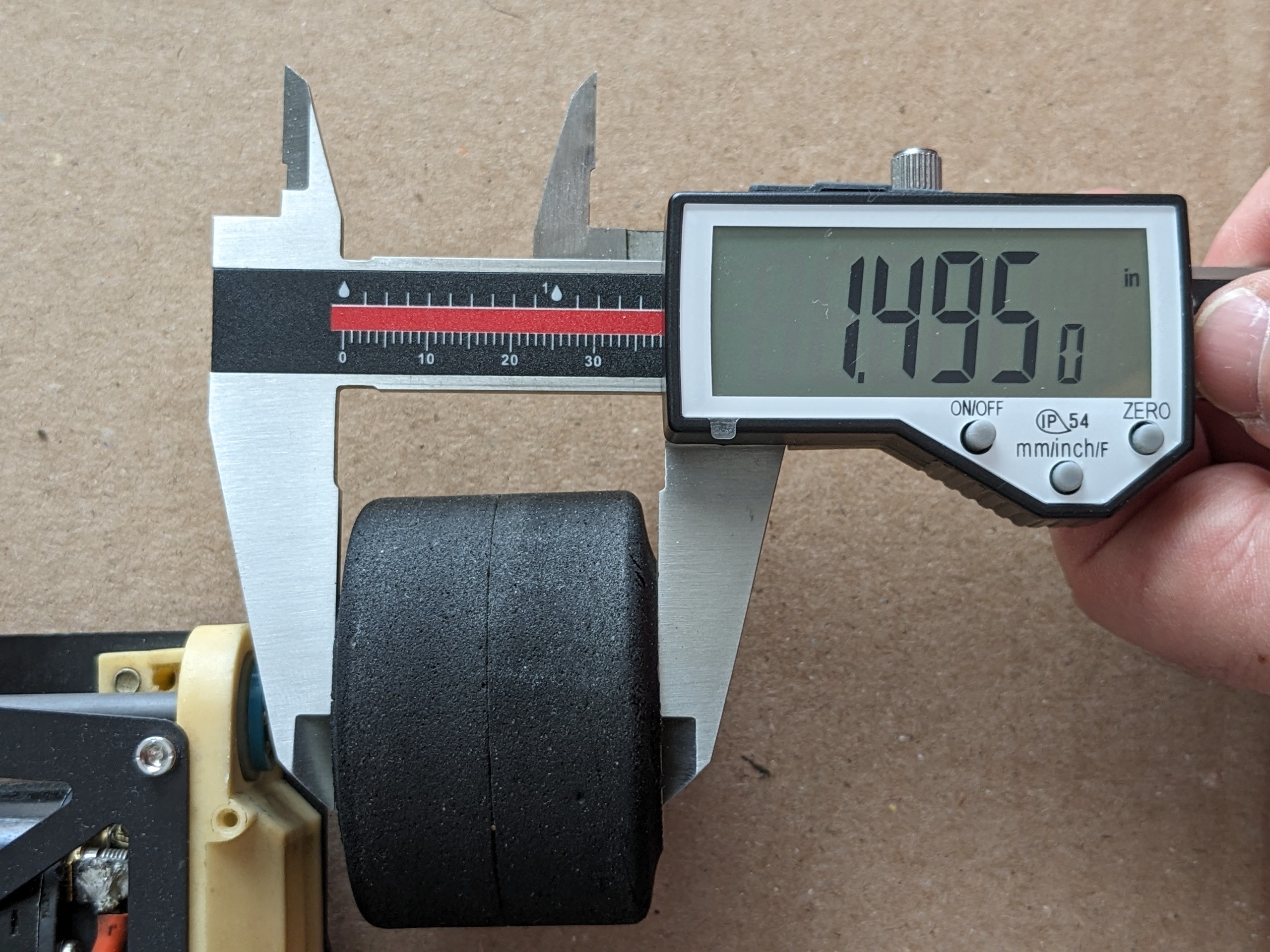

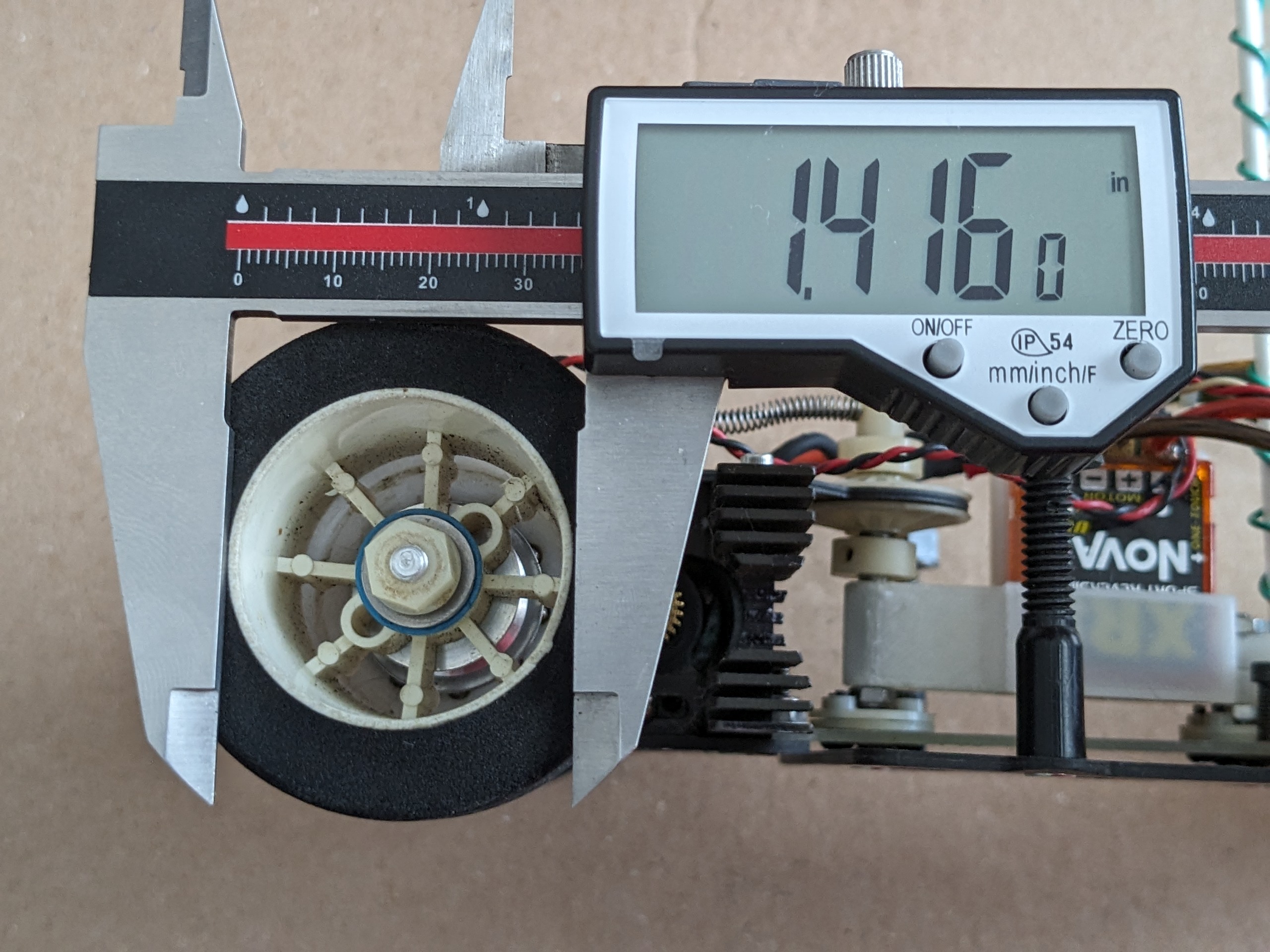

Re: beginner information on 1/12 rc12e/i/l tires
RC10L
RC12L (also RC12i)

The front inner diameter is the same as the rear inner diameter on a chassis, but not the same between the 10L and 12L cars.
