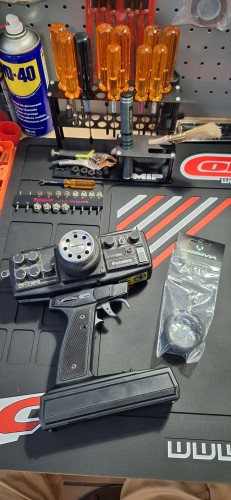

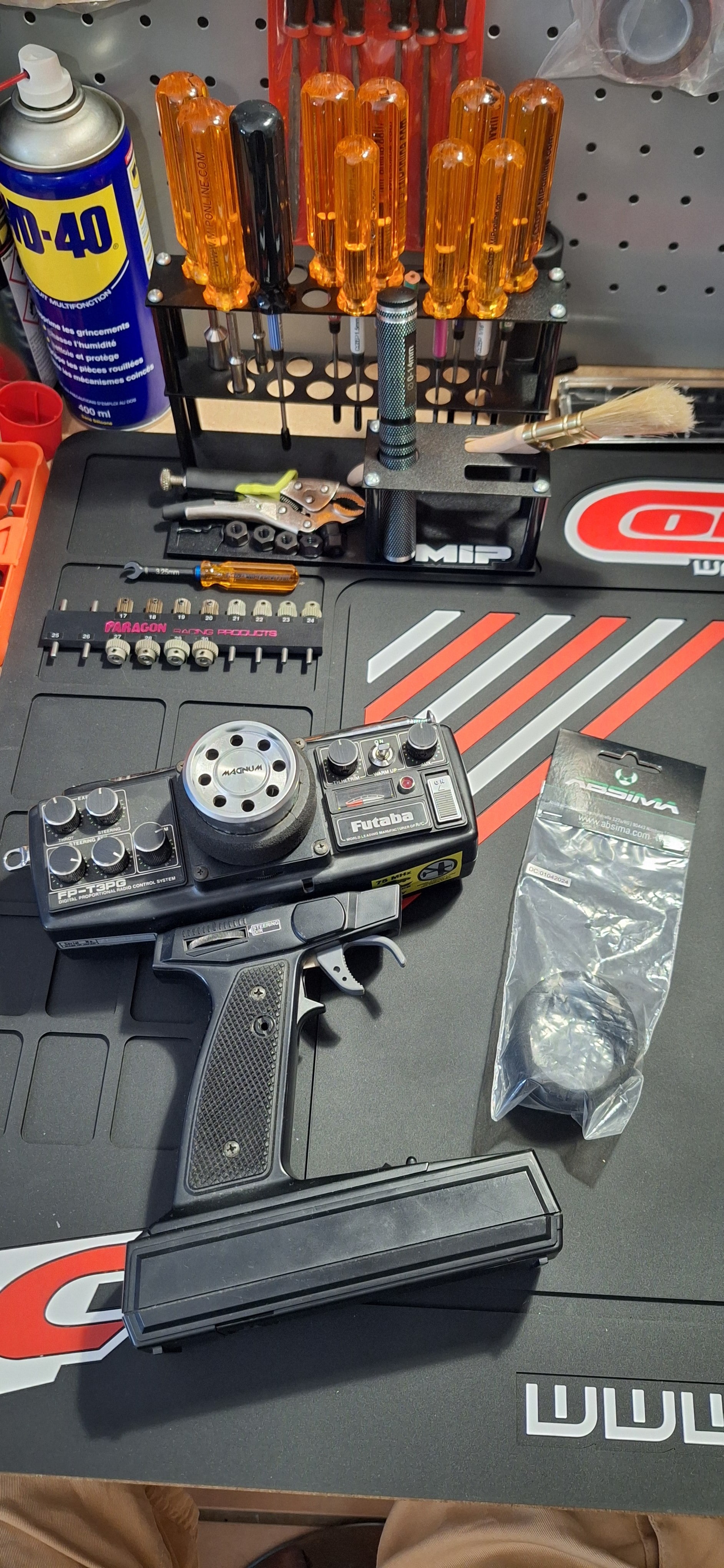

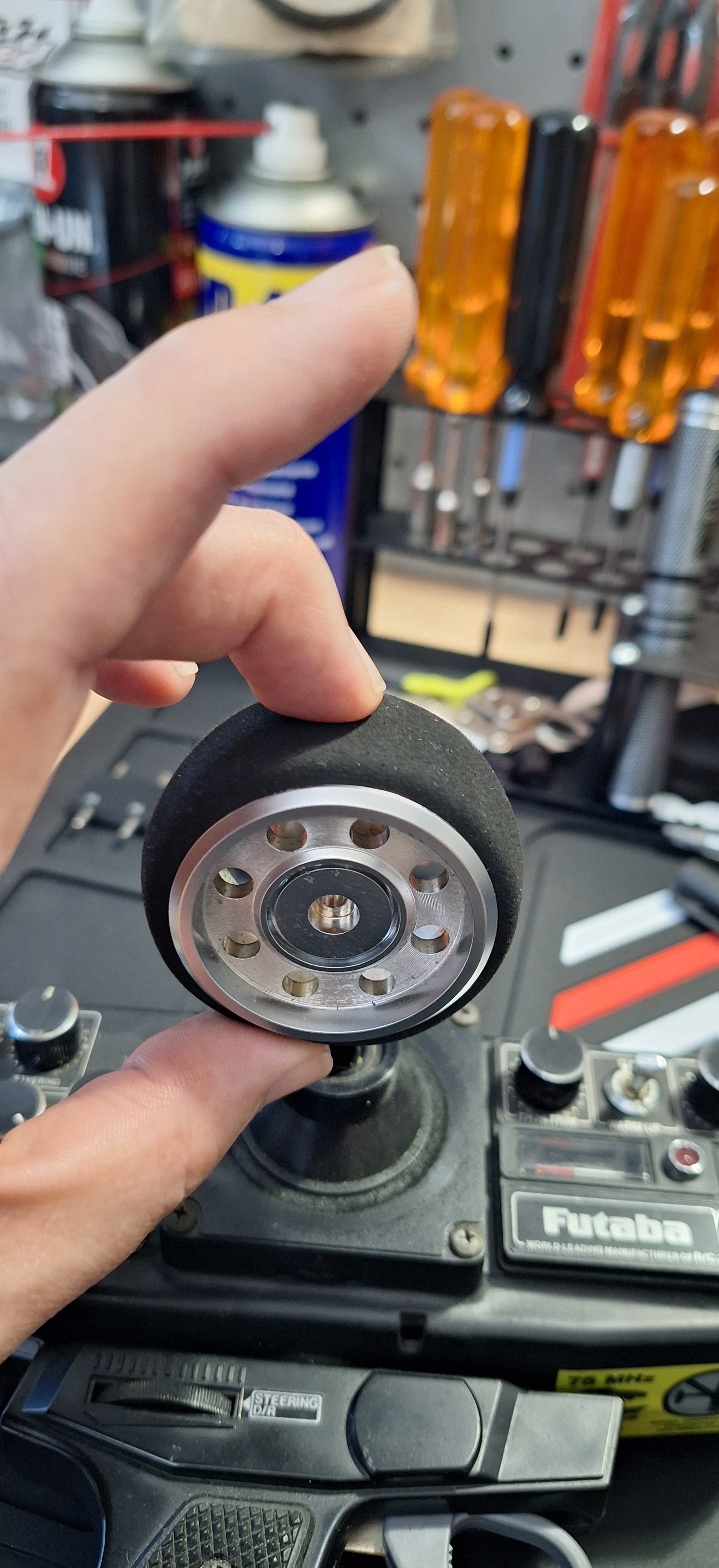

After a lot of research I finally settled on and replaced the foam on the steering wheel of my old Futaba Magnum Sr. (FP-T3PG). Happy with the results and since I didn't find a lot of in depth how to for this online, I thought I'd make a post to help anybody out in the future. Link to the foam I used is here: https://www.absima.shop/RC-ACCESSORIES/Electronic-Nitro-Parts/Radio-Receiver/Universal-Sponge-for-Steering-Wheel.htm?shop=absima_en&SessionId=&a=article&ProdNr=2020010&t=19114&c=19128&p=19128
TravelinTravis
Posts: 293
Has thanked: 987 times
Been thanked: 372 times
Re: Futaba Magnum Sr. Steering Foam Replacement
Post by TravelinTravis »

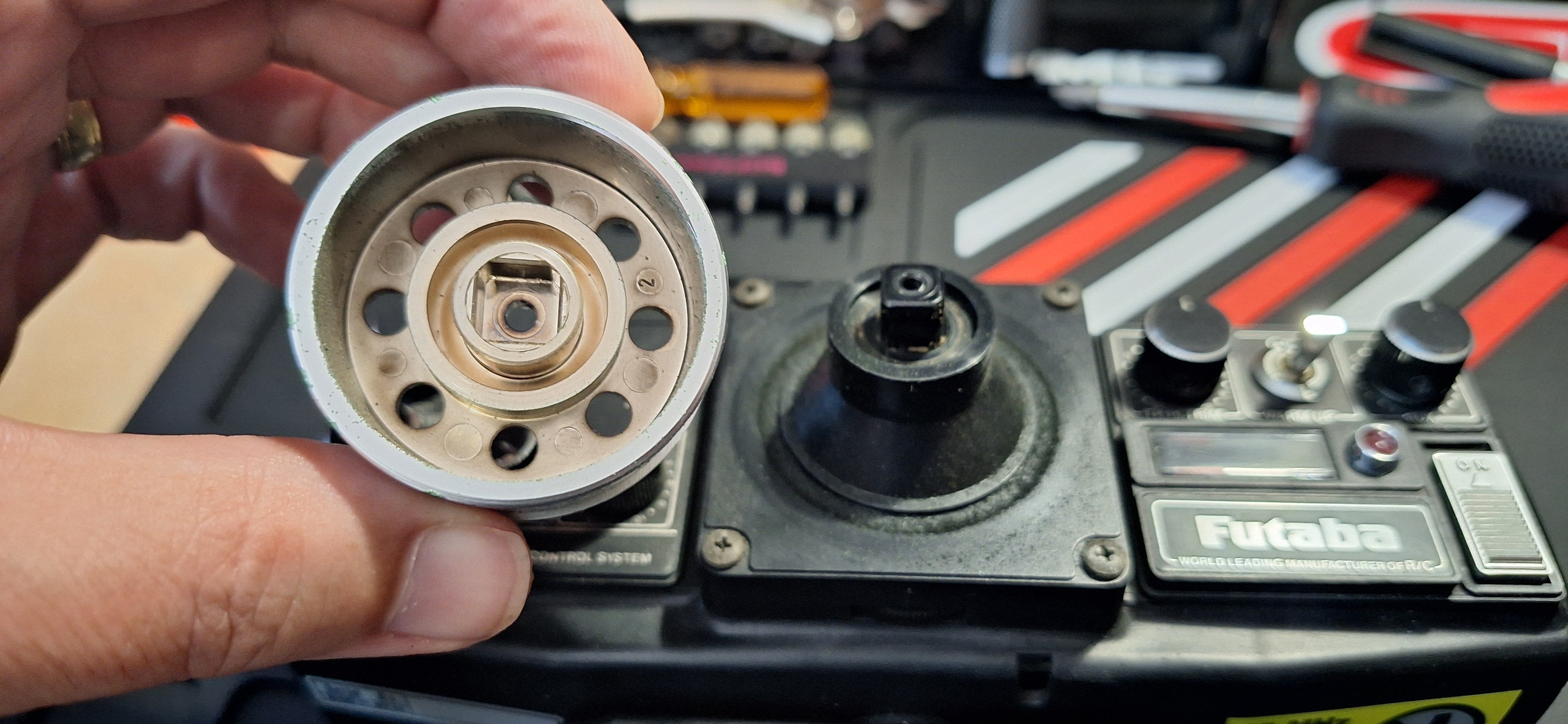

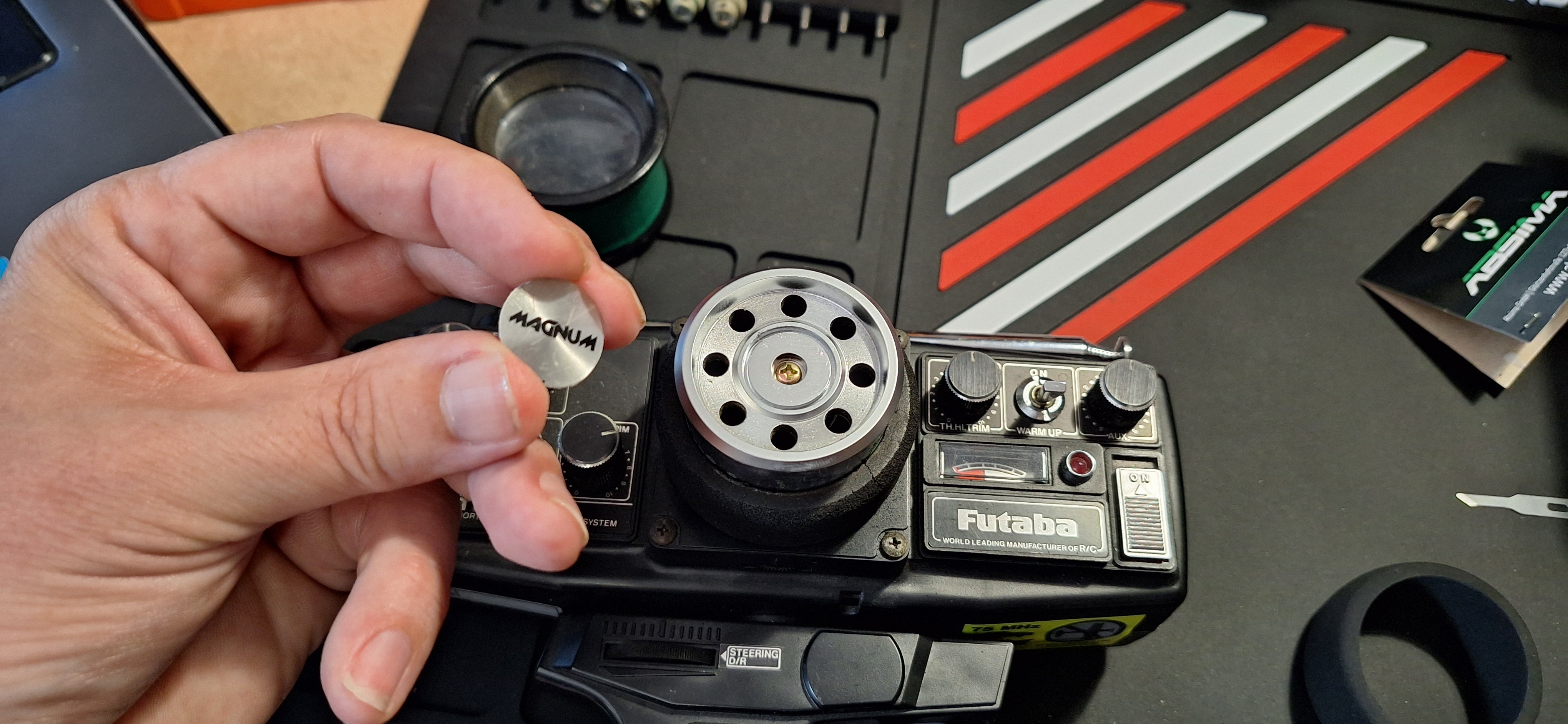

Size of the foam was almost down right perfect....wasn't happy with the off-center cut when I opened the package, but to be honest, after the install, you can't tell at all. Still...would've expected a little more precision from our German friends. The hardest part was getting that center thin metal cover off the wheel to access the screw and get the wheel off. All I can say is, put it under a magnifier, find the edge with a new exacto blade and very gently lift the edge....once up a bit I used a small jeweler's flat head and gently lifted all around till she popped off. Made a couple small scratches but hardly noticeable. If you bend the plate a little getting it off, it's metal, so you can bend her back to flat. Didn't need to bother with glue or double sided tape to put it back on, it was still sticky enough as it was. I marked the orientation of the wheel prior to pulling it off....but it's really not necessary...the metal cover goes back on anyway you want it too and the mate for the wheel is just a square key, not a spline like a servo.

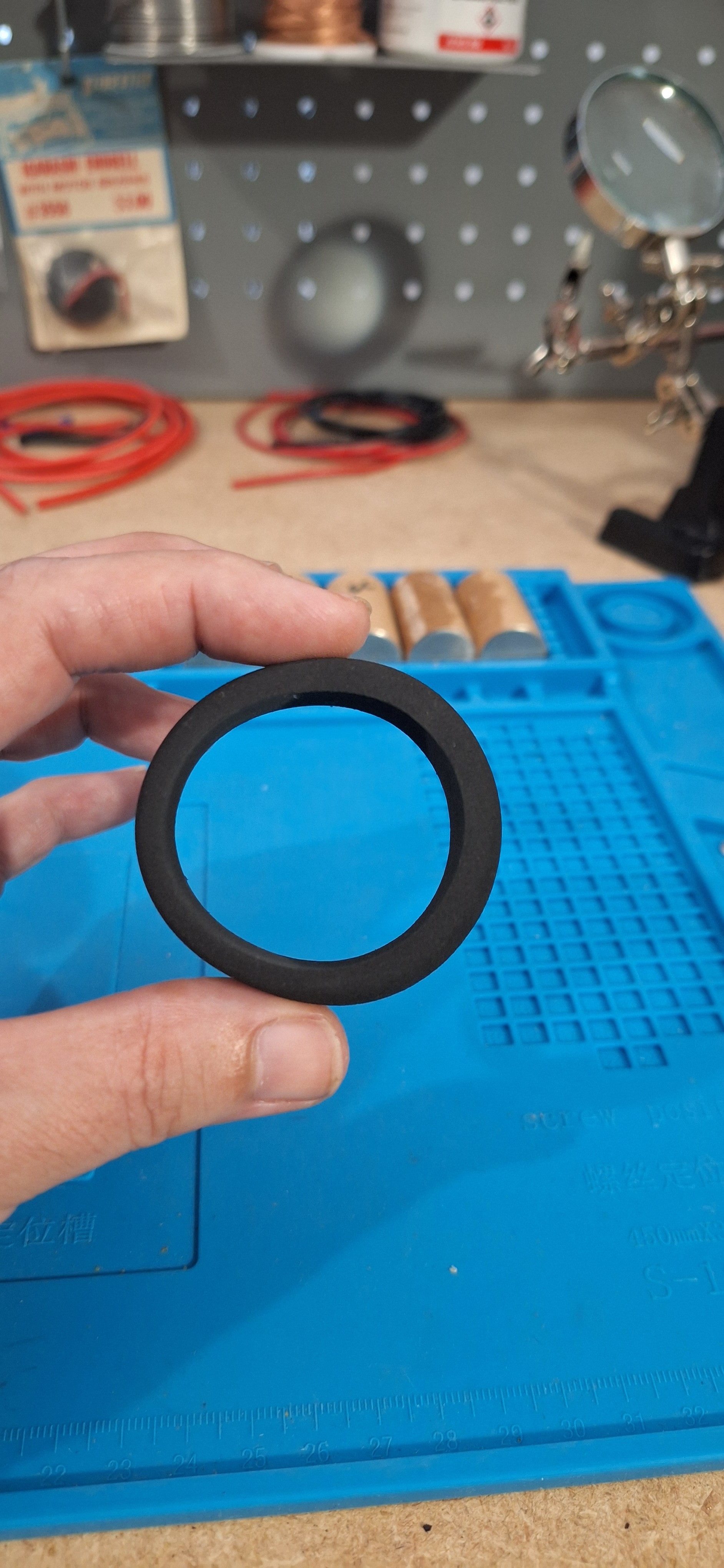

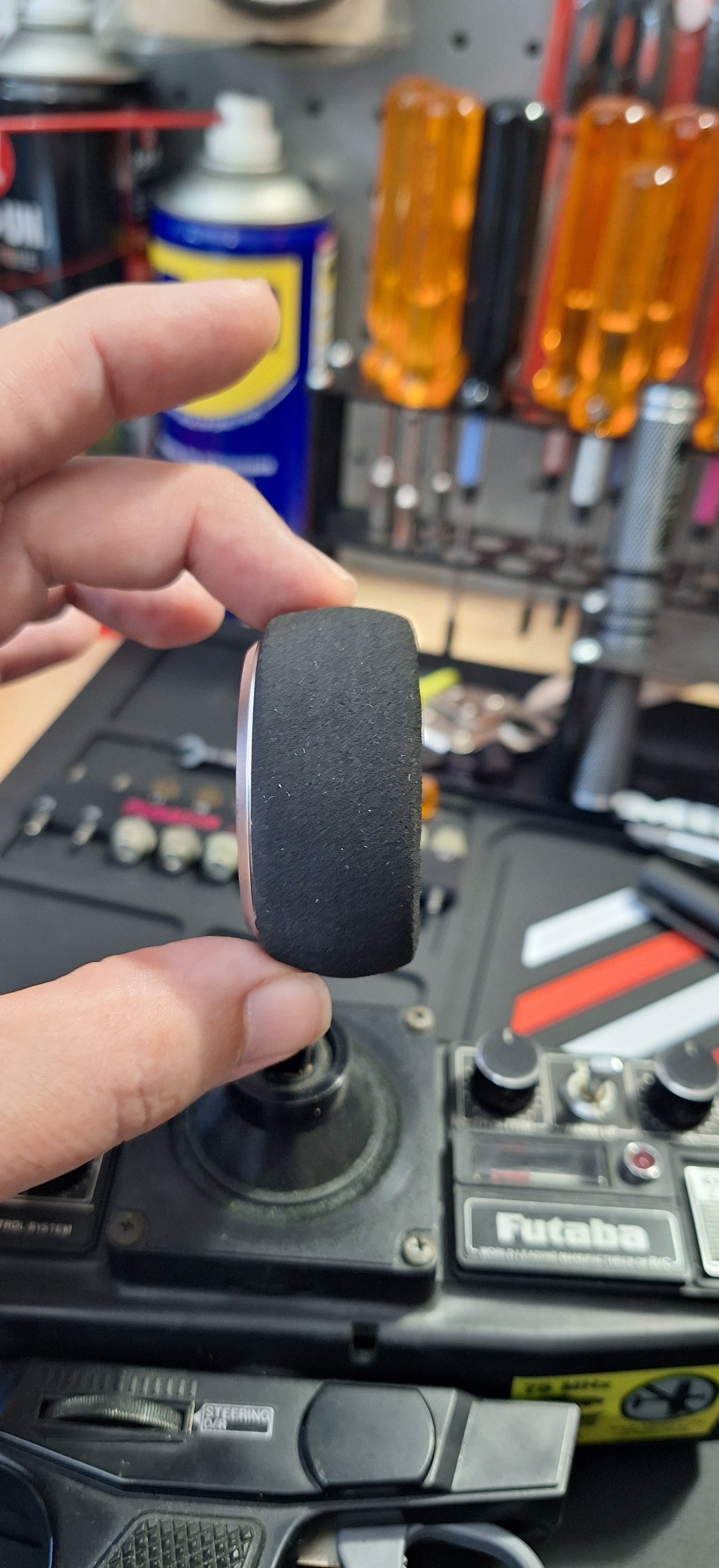

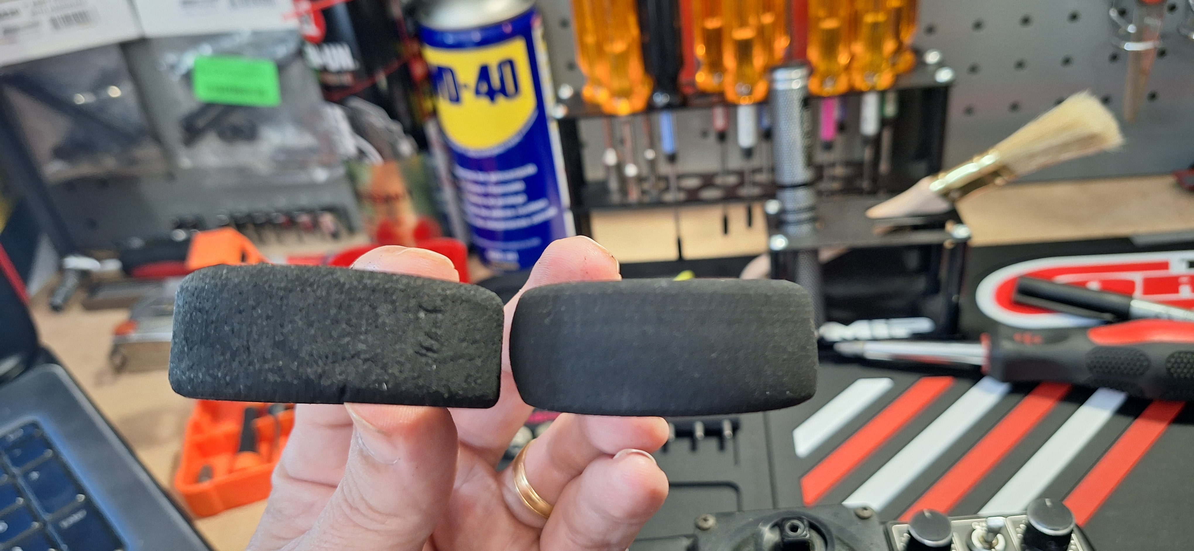

New and old foam side by side.....

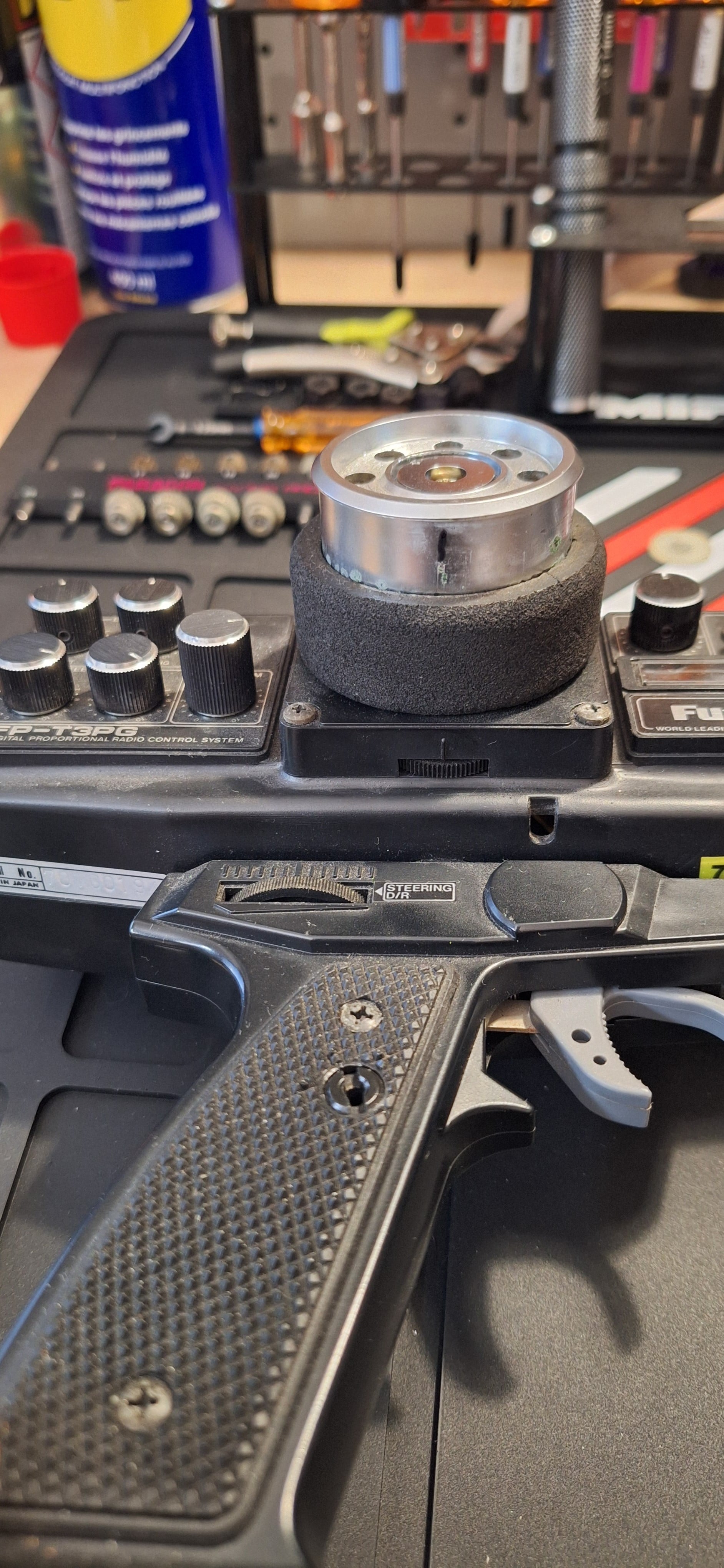

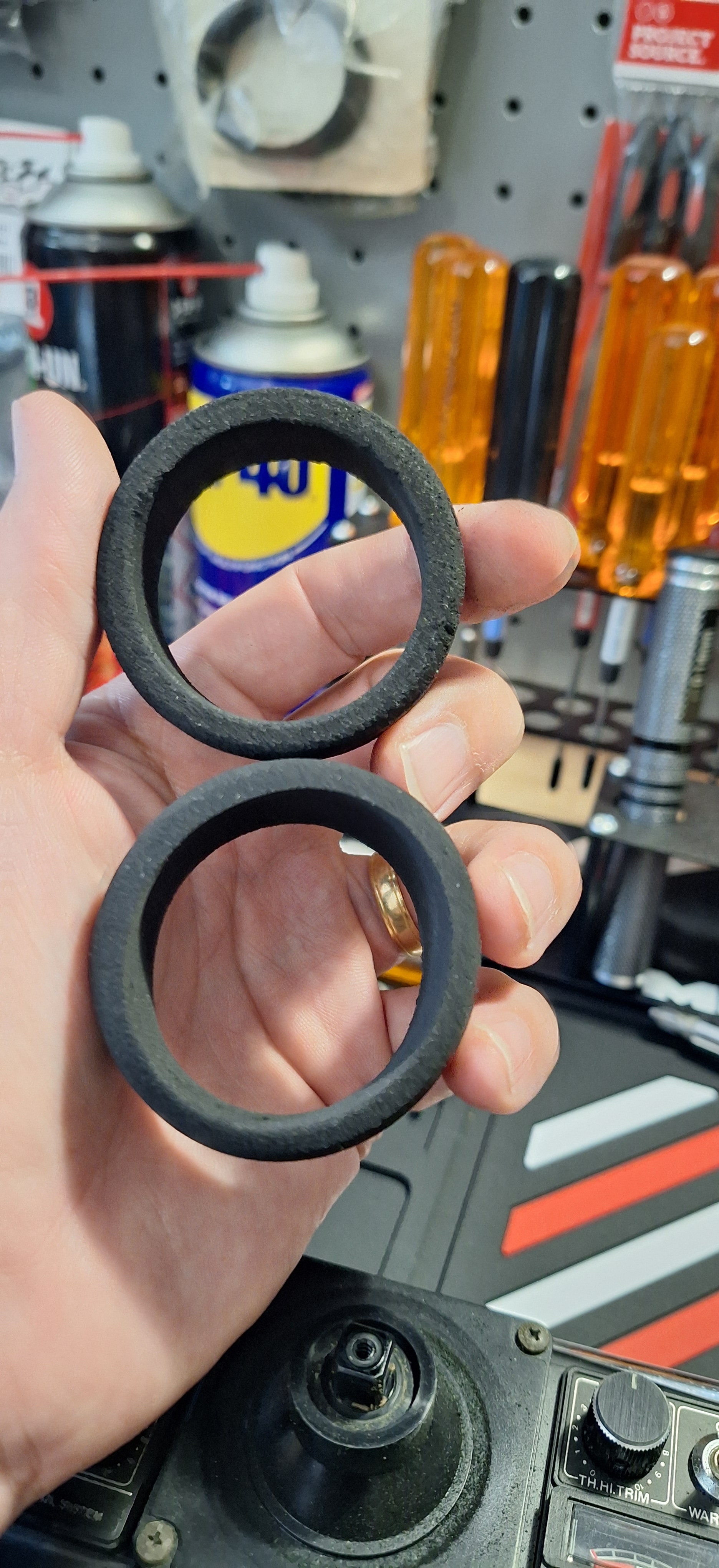

The center cut out is slightly conical....so if you slide it on the wheel one way it's slightly larger than desired and can be easily pushed over the outer lip on the plastic (Futaba) wheel. But if you put the foam on, tight (smaller I.D.) side first, it snugs right up to the edge. Thought it was kind of odd at first.....but actually made it real easy and clean to sneak in and add spots of super glue from the back side. I ordered two of the foams and can confirm they are both this way. I used the jeweler's flat head to raise the foam up a bit at a about 8-10 spots to add the glue all around. It was about the same number of spots visible from the original....so figured that was the way to go.

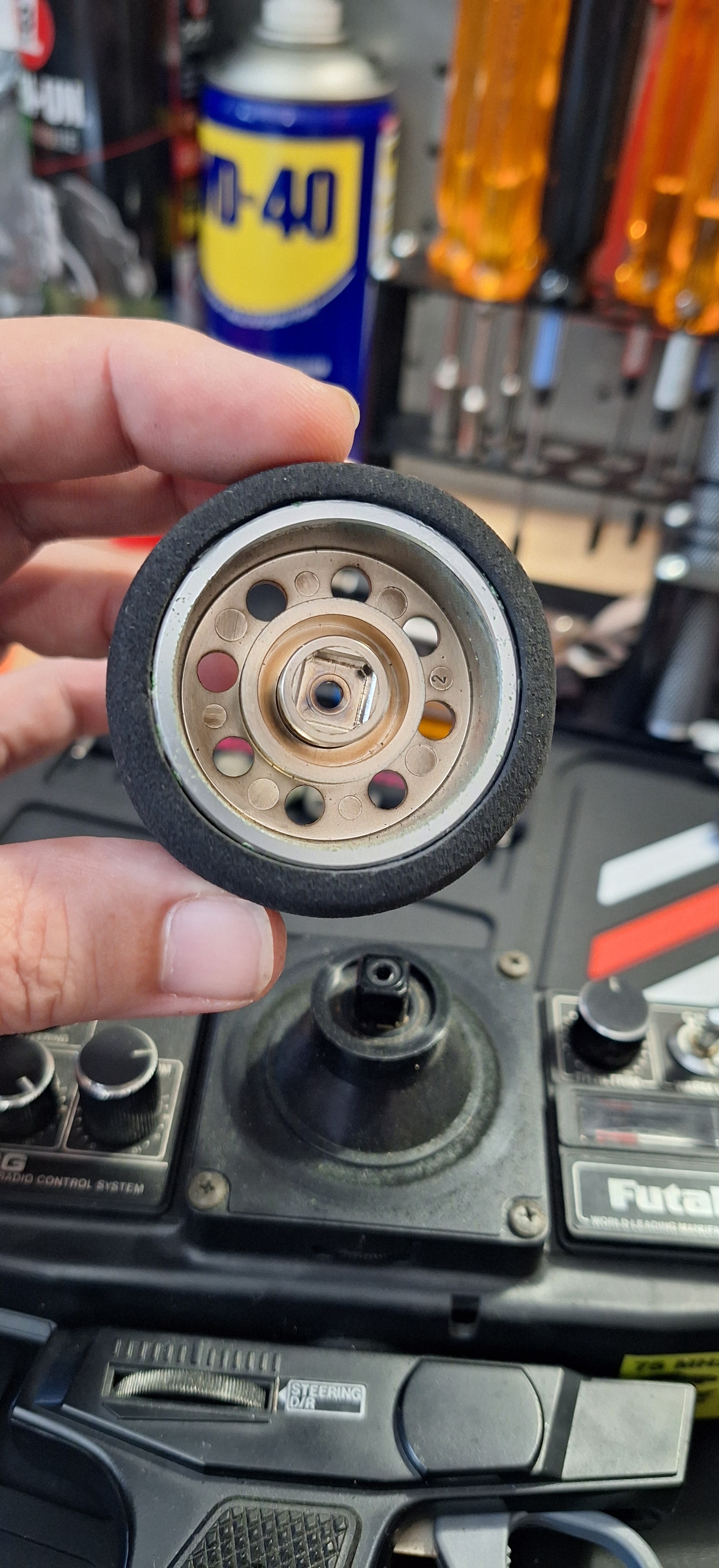

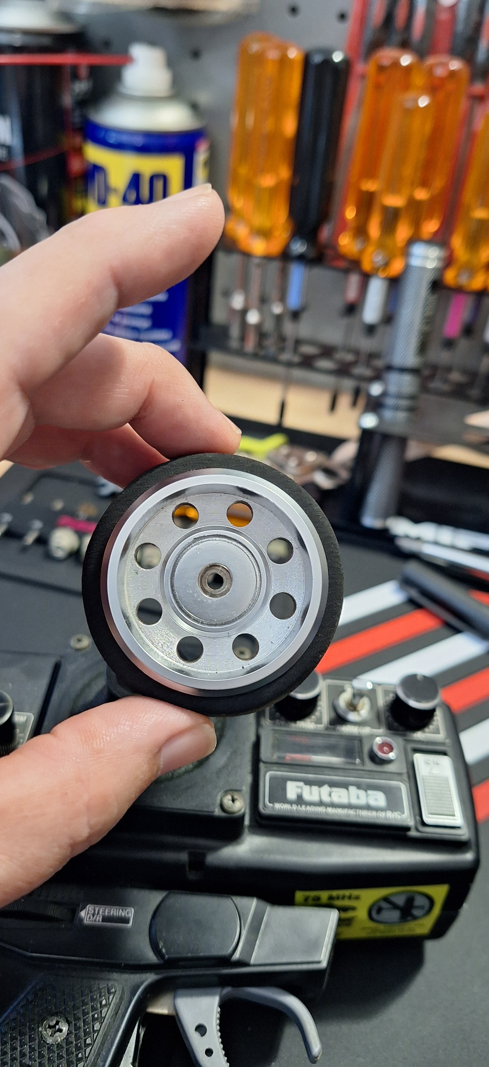

All glued up.........without my fingers getting stuck to it :lol:

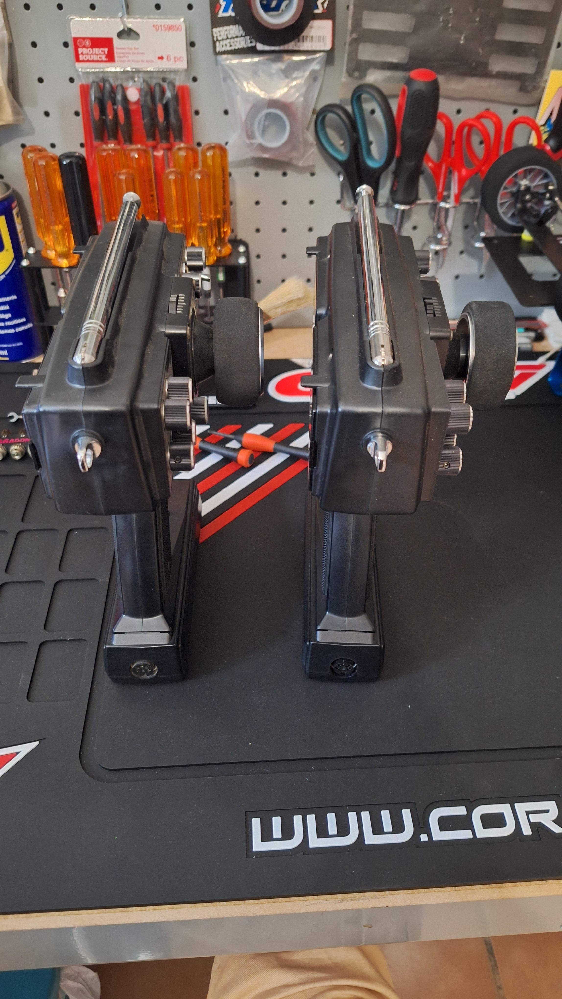

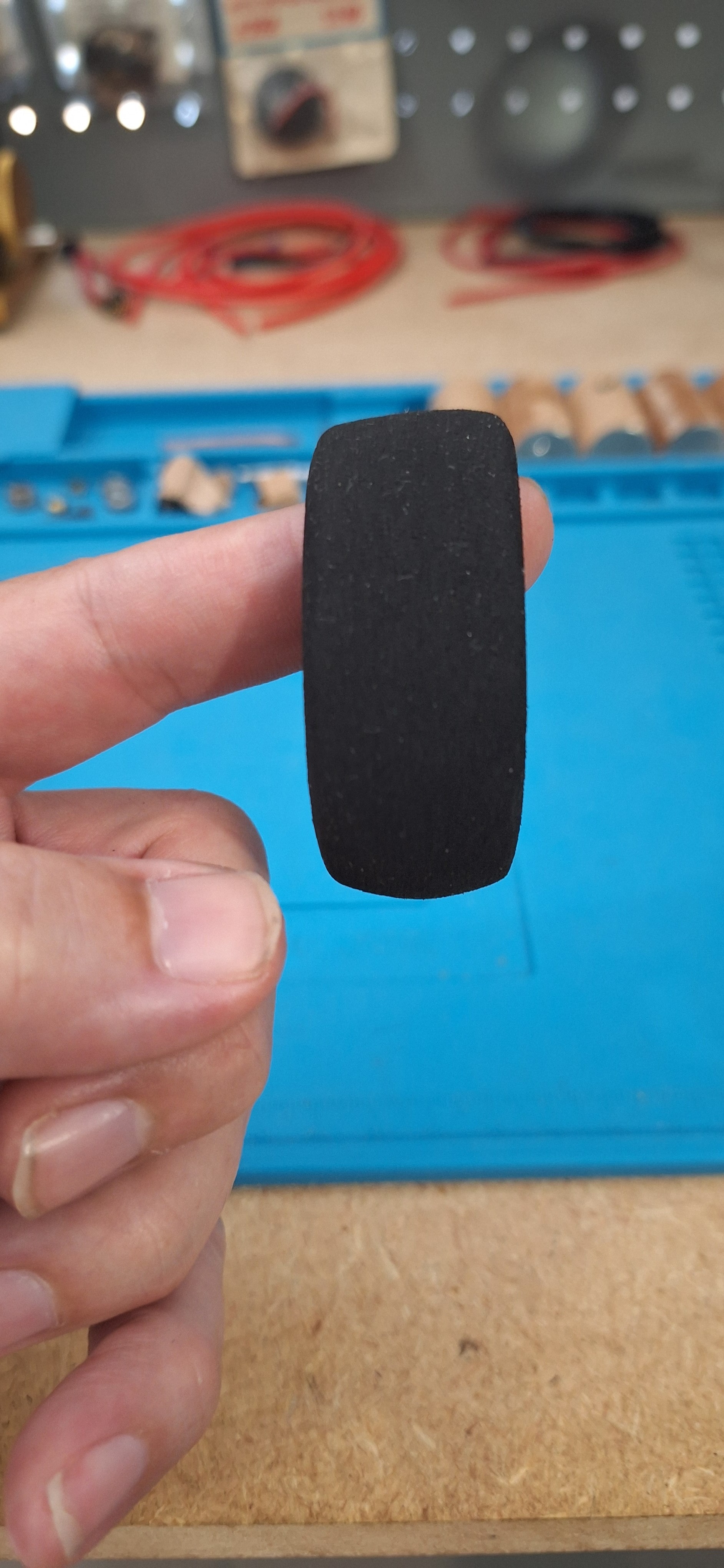

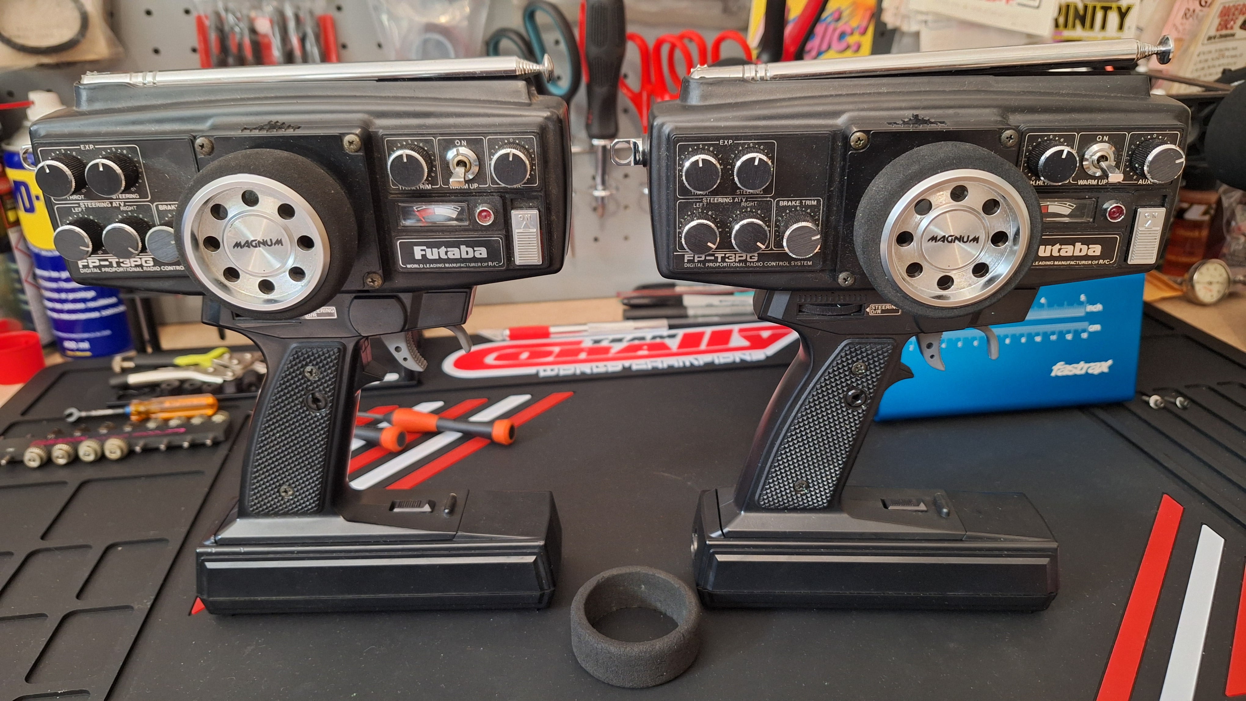

Older transmitter next to one that I got NIB still with the original foam. Replacement foam on the left...original on the right....old foam down in front for reference, on it's way to the trash. The new foam is very slightly wider than the original, but actually fits the full width of the wheel perfectly....the originals left a little sliver of the wheel visible from the backside. New foam is a bit more spongy, less dense than the OG futaba foams and slightly rounded from front to back compared to the OG too. All in all, I'd recommend these if you find yourself in the same boat with an old original Magnum Sr. or Jr.
