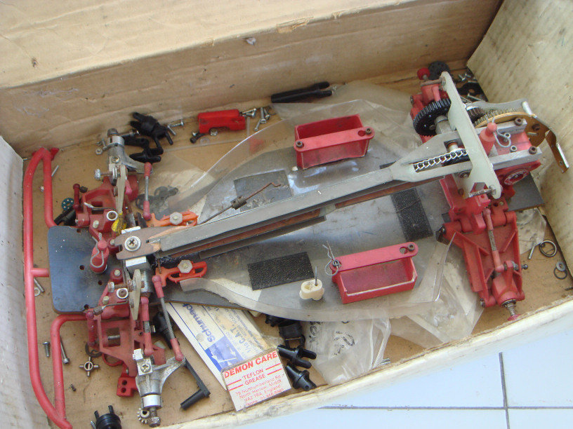

A friend sent me these... He said it was a prototype car? Looks homemade to me but I don't know about many brands of other cars besides associated, does it looks like something pulled from another vehicle? check out the box, suppossedly came straight from Associated, long time ago.

dude, that looks like Roger Curtis's 4wd car that dr. robotnik was asking about.

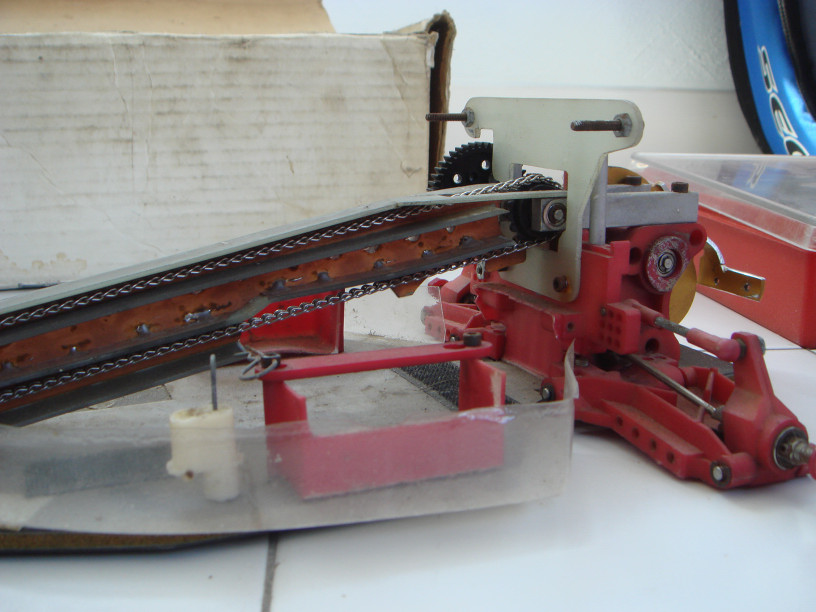

Homemade. The channel made by soldering together copper coated fibreglass isn't something an r/c company would do when they have the ability to machine a channel from nylon or delrin or vacform one in lexan.
Front knuckles are Kyosho Optima which didn't appear until late 85, long after MIP had already had their 4wd conversions on sale, so unless the front uprights have been replaced this was produced later than 85.
This isn't like the Roger Curtis 4wd RC10, which looks like this, although it is obvious it's what this one was based on.

any pics of the geared side of the car?
this thing looks interesting

counter gear stuff looks to be on the wrong side to be the curtis car, but still an interesting car

awesome car! Pitty is its gonna be a pain to clean/ rebuild. Verry unique.

Oh, I just thought/noticed, it's strange that the wheelbase has been shortened on this car especially as it is chain drive and you could theoretically adjust the chain length to fit the wheel base...

way cool, but its more likely the result of somebody with alot of time on his hands and inspiration from that pic in the magazine of the 4wd car.

his brother bought it from a guy from associated 10 + years ago he said, waiting to hear back from him who it was.

By the looks of the welds on that chain guide, it looks like steel? Is it? If so, bet that is heavy (and WAYYYYY overkill).
