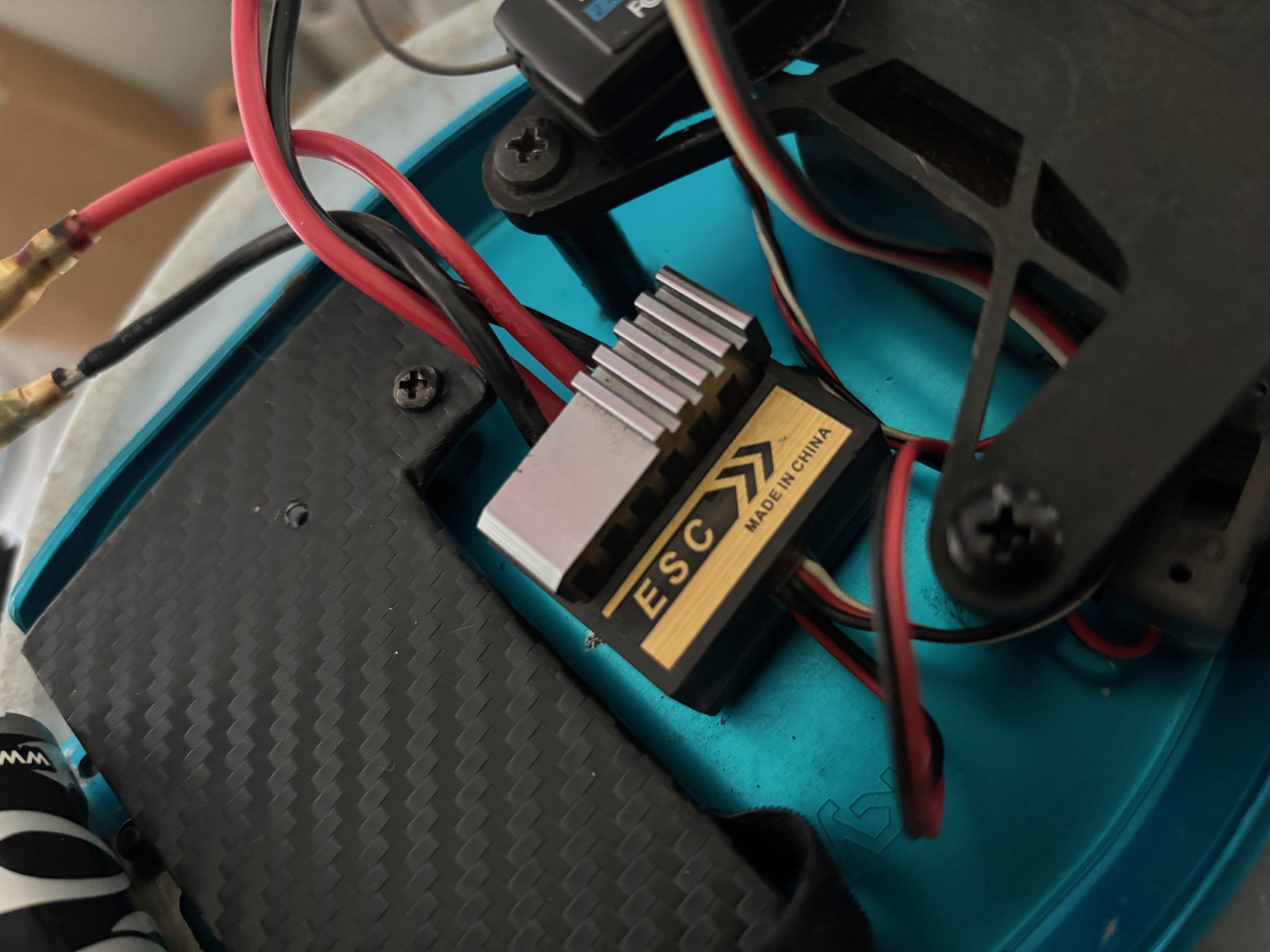

Anyone have experience with these? The motor in the project I took over has a stripped mount hole and needs to be replaced. Current motor is a standard 27t. Will these handle lower turns?

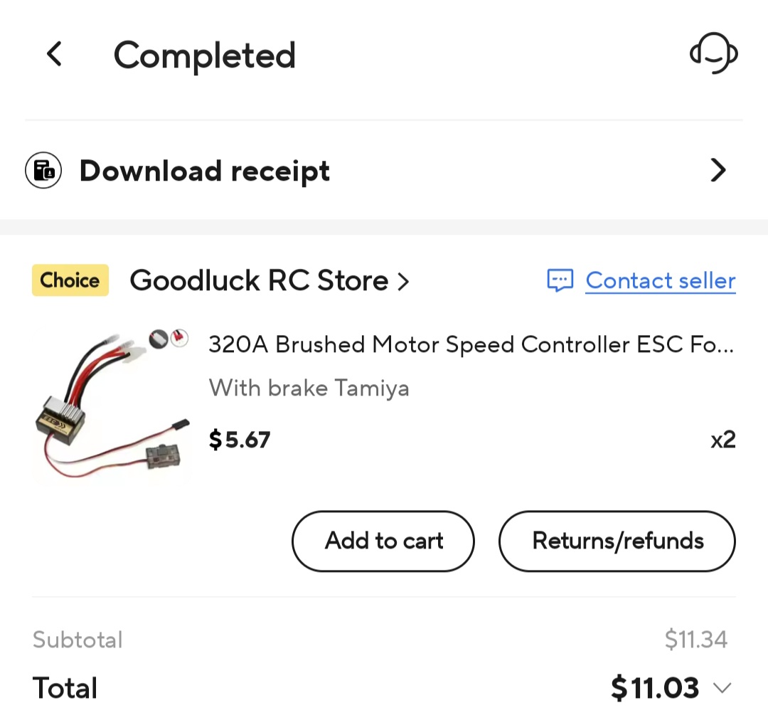

I bought two from AliExpress a year ago. Plugged one in and it smoked, tossed the second one in the garbage before even trying it.

No, 7.2v nicad pack and no motor hooked up. When the first one went I wasn't going to take a risk with the second. The hobbywing speed controls are rock solid reliable and not a lot of money so that's what I use.

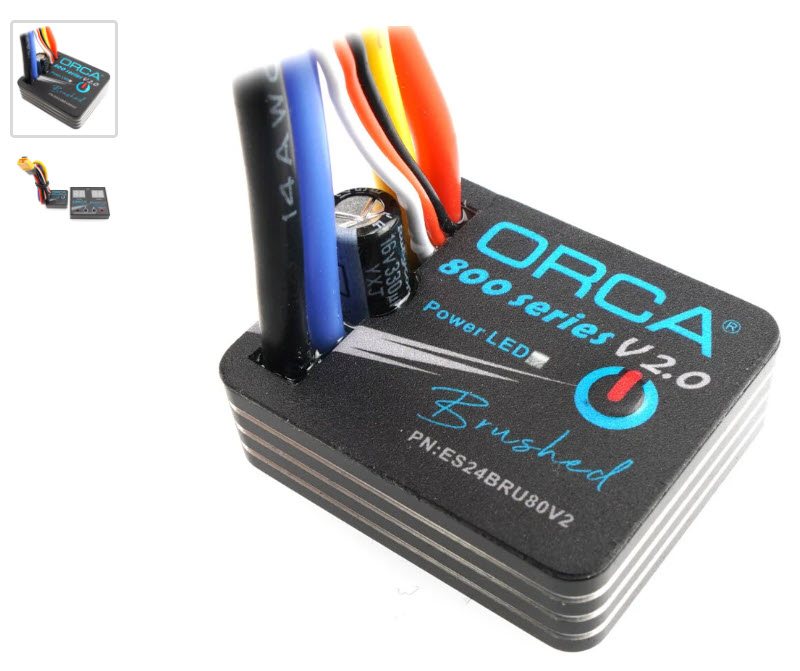

Lot of people here run the 1080 variant? seems a bit more robust. Ive been liking these ORCA 80A brushed esc, theres a V2 now also. Cost a bit more, but still very cheap compared Good on you for getting into it. Have fun.

I've been intrigued by the orca but haven't heard any feedback from people that actually use them. They seem pretty decent in specs and features.

I have dozens of packs through it myself, plus whatever the previous owner did. Seems to be working well. I would probably upgrade to brushless before buying a new brushed esc. However, for now, brushed replacement motors are less than $15. I would also need the harder to find Tamiya connector or would also have to buy an adapter. I will probably just go with another 27t, knowing that it can handle it.

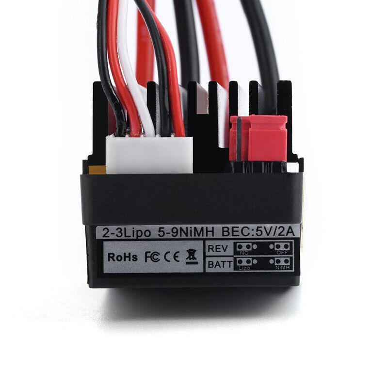

I have had good luck with these. I've only used them with 2s and stock motors. I wouldn't even try 3s. They run cool.
They auto calibrate with pause tap for reverse. Channel reversal might be needed

Just wanted to update this. I found an old website that was selling rebranded versions of my esc advertising they supported down to 13 turns. I ended up going with a Holmes Hobbies Retro Sport 21t. So far so good, and definitely much faster than the previous HPI 27t motor. Based on the specs, the 21t Retro Sport should be similar power to the motor Kyosho recommended for the base electric version of my car, the Le Mans Stock 05.
