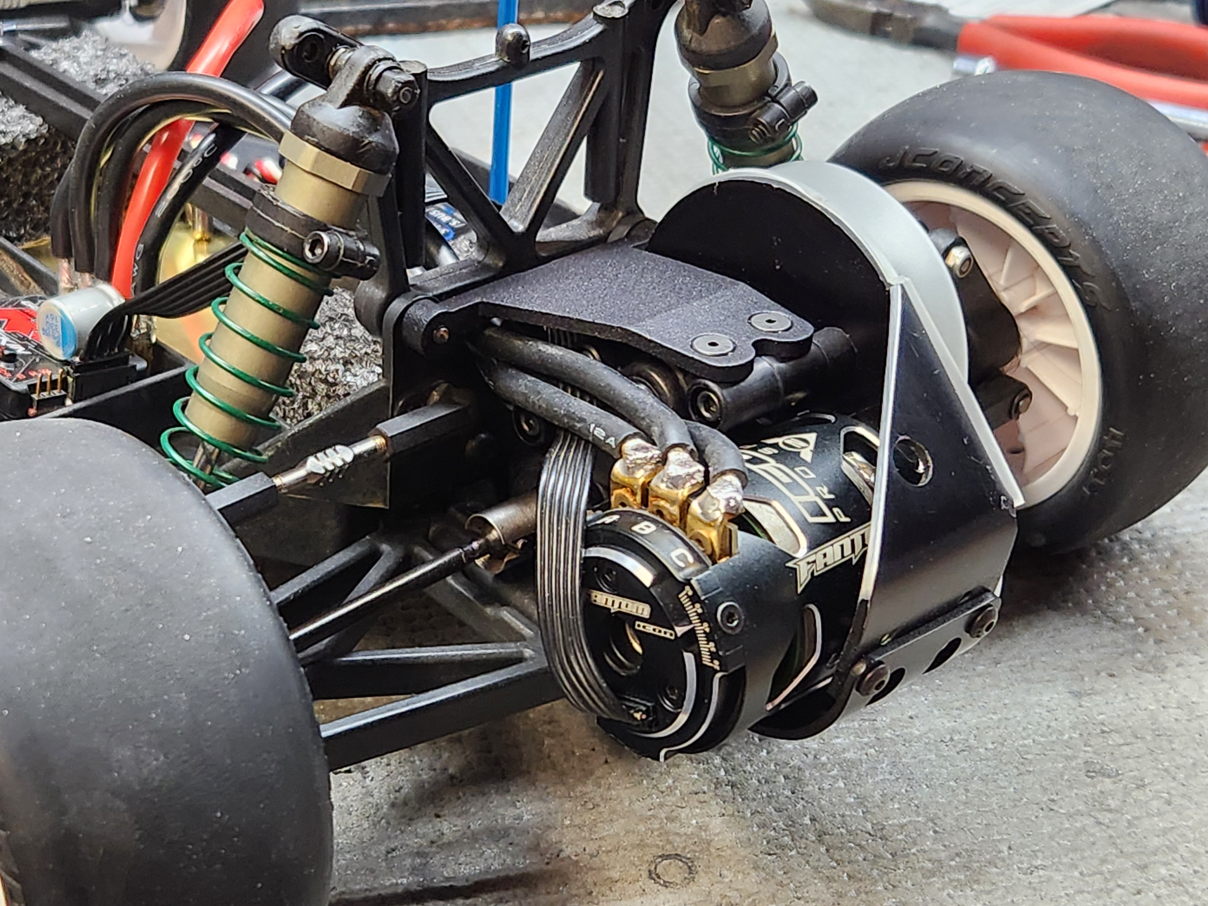

Here’s my B2 with the proto replica kit that I raced at the Vintage Clash of Champions next to Matt Ledger’s original ‘95 worlds B2 prototype (Matt’s is on the left).
It was really cool to be able to compare it with the real thing, especially since Jason and I developed the replica parts almost entirely from photos.

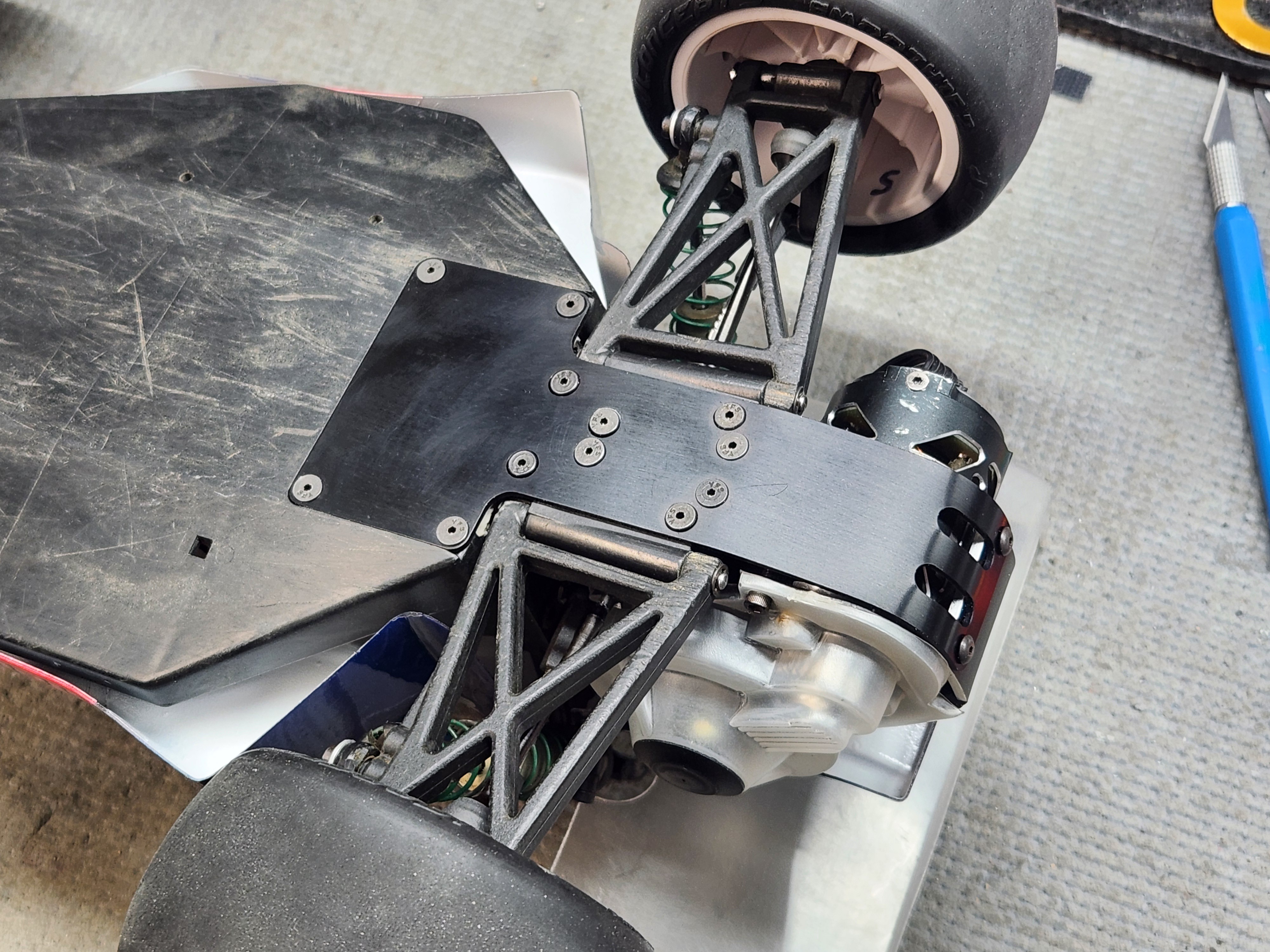

The bottom of the transmission case needs to be narrowed to clear the B2 rear arm mounts, two new bottom mounting screw holes need to be drilled into the case, and a notch needs to be cut into the top front of the case so a tang on the bottom of the transmission brace can interface with one of the 4-40 - 1” socket head screws. I modified my first one with a box cutter, so it’s definitely doable by hand. Now I use a milling attachment on my lathe which is much faster and does a far neater job.
Modified on left, original on right (with areas that need to be trimmed off marked in black). The dots on the modified case needs to be drilled with a #43 (0.089”) or 2.3mm drill bit.
Topside showing notch for the tang on the bottom of the transmission case.
