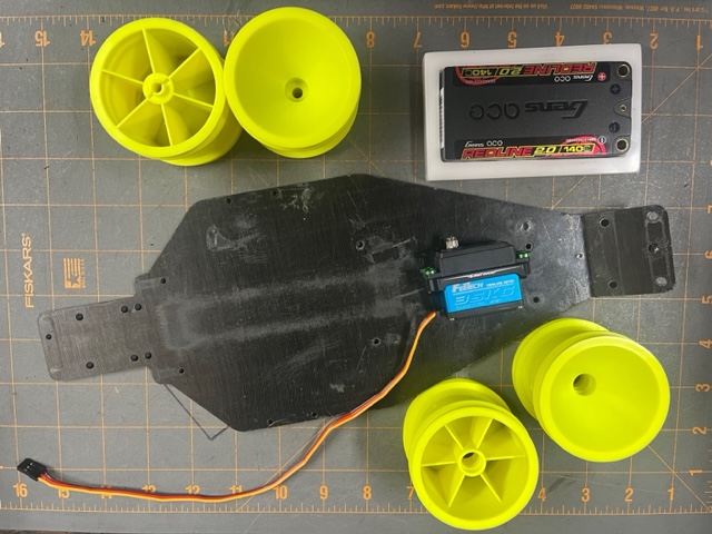

Same boat as you; OE correctness didn't matter to me.
I sourced A&L truck wheels with AE bearing adapters for tamiya sized bearings. (I don't know the AE PN off hand)
The 5mm front axles for JRXT aren't available otherwise that would make it a bolt on without the bearing adapters.

I did the same for my Storm 2000- A&L wheels and non-standard sized bearings to fit the axles.pma1123 wrote: ↑Thu May 15, 2025 9:02 am Same boat as you; OE correctness didn't matter to me.

Ok cool thanks for the replies. What A&L wheels am I looking for . I found some on eBay . I see just a few for the rear that are pin style. Also fronts for the Jrx2.

Good call…I was told about taking a M4 nut and re-tapping to 8-32(whatever axle thread is) to handle that. The recess for the nut isn’t overly spacious.
I don’t have this all together on mine yet but with the AE bearing reducers (6862) in these wheels it allows for the 3/16x5/16 flanged bearing to work; shim to suit.

The rears do require the special nuts. The fronts were a metric bearing wheel and thus require a change either in the axle or the bearing adapter as mentioned above. When doing the axle, some companies made them for Tamiya wheels which are super wide between the bearings. For those, our wheels came with red spacers. If using our own axles, or buggy length Tamiya adapter front axles you don't use the red spacer. If using the stock bearings with AE or rpm wheel bearing adapters, you also don't need the red spacers. Lots of ways to skin that cat. As far as wheels go, we only have blue rears https://factoryworks.com/shop/ols/products/5054b and white fronts https://factoryworks.com/shop/ols/products/5050 left. They will take dye well however.
