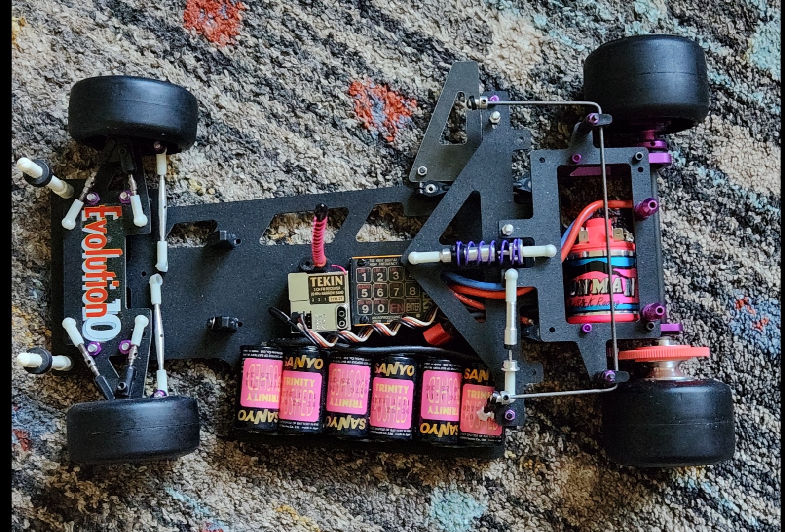

Thank you, it will be a challenge. Mine isn't too far off, other than some detail stuff the LSD sway bar kit seems incredibly impossible to find. I have two Trinity catalogs with every part number for these cars, and I've searched and searched. His later #51 car has a section of the chassis cut out on the RH side too, not sure I want to cut up this new chassis platecartmen34 wrote: ↑Thu May 22, 2025 8:37 pmWow! That thing looks AMAZING just as it is! Mine is in extremely poor shape compared to yours!DSaw78 wrote: ↑Thu May 22, 2025 8:29 am Nice, I look every day on Ebay for Trinity cars and other pan cars so I must've missed this one. I have one myself that I'm trying to restore even though it was already like new almost. I think I discovered lately though that it has the wrong axle in it but I don't see me finding a LSD axle either.
I'm ultimately trying to replicate either one of these, and these are the only photos of each anywhere.
Sorry for the hijack, and good luck with yours. Post some pics of it!
I had the same goal. I wanted to try and replicate exactly the car in those images. I spent hours as a kid just staring at that magazine article. Good luck to you as well!
I meant to post the link to the axle on Ebay but got busy at work and forgot. I ordered one too so we both got one.
Here's how it sits now:

That car looks like a great start! I'll try to dig mine (and some parts) outDSaw78 wrote: ↑Thu May 22, 2025 9:24 pmThank you, it will be a challenge. Mine isn't too far off, other than some detail stuff the LSD sway bar kit seems incredibly impossible to find. I have two Trinity catalogs with every part number for these cars, and I've searched and searched. His later #51 car has a section of the chassis cut out on the RH side too, not sure I want to cut up this new chassis platecartmen34 wrote: ↑Thu May 22, 2025 8:37 pmWow! That thing looks AMAZING just as it is! Mine is in extremely poor shape compared to yours!DSaw78 wrote: ↑Thu May 22, 2025 8:29 am Nice, I look every day on Ebay for Trinity cars and other pan cars so I must've missed this one. I have one myself that I'm trying to restore even though it was already like new almost. I think I discovered lately though that it has the wrong axle in it but I don't see me finding a LSD axle either.
