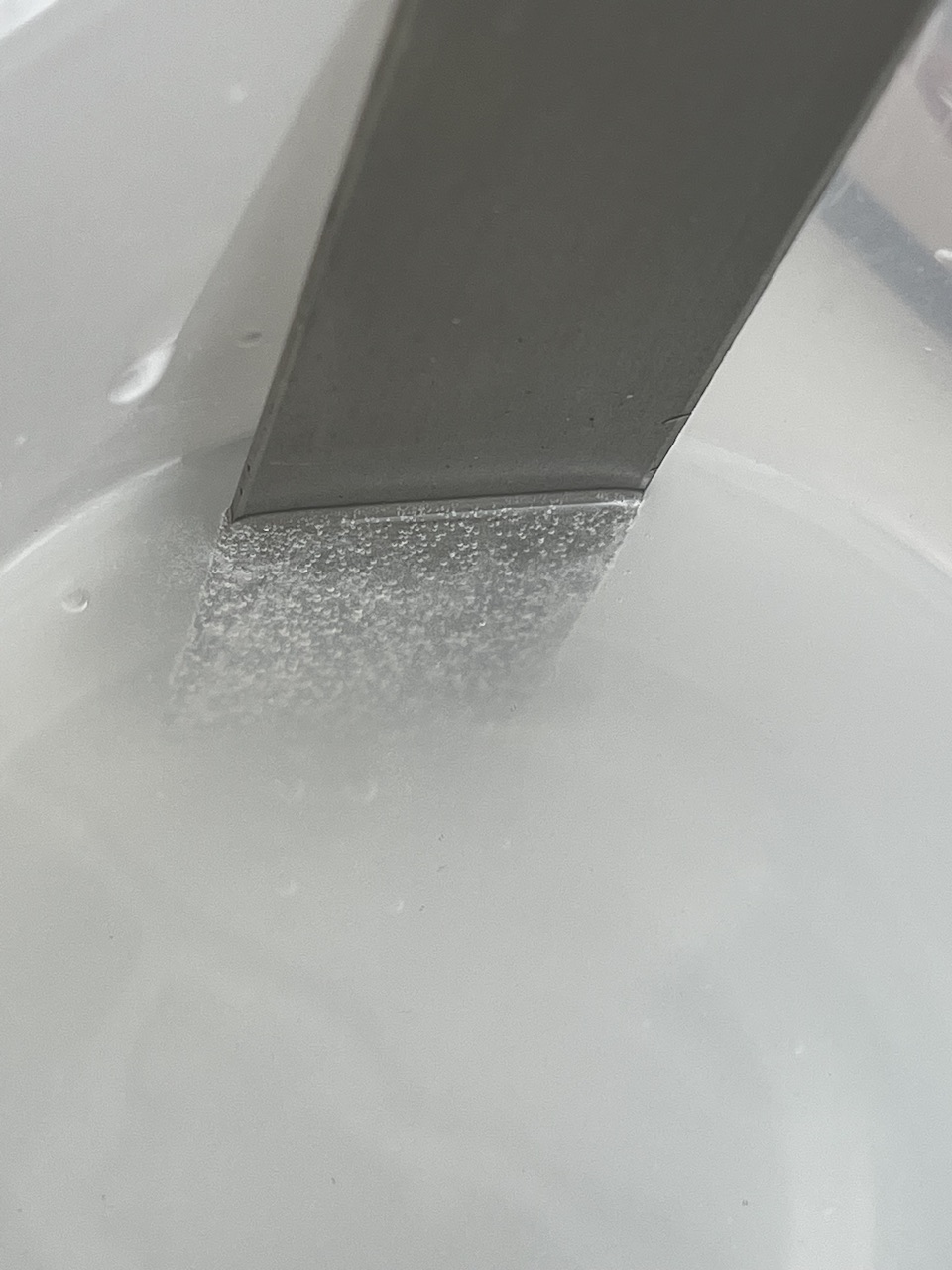

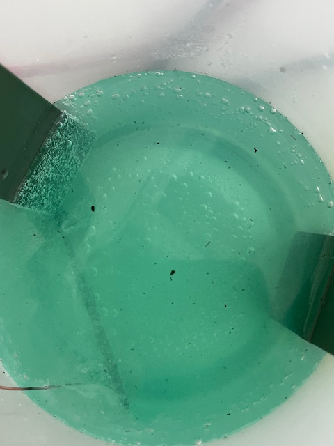

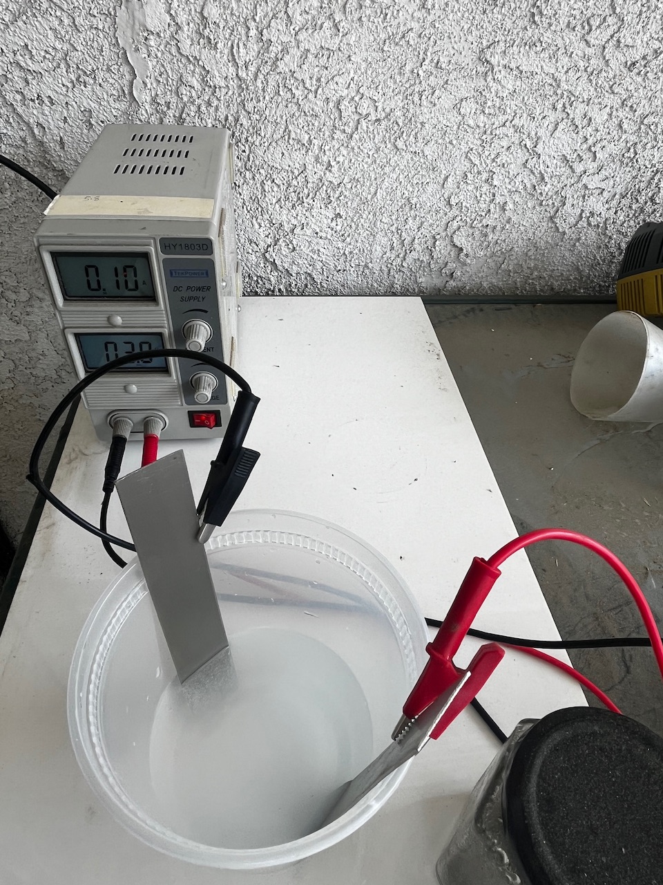

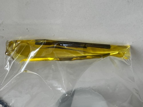

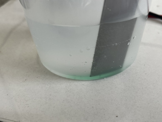

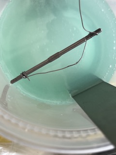

Starting on the process today.
I had less vinegar than I thought so I’m just making a small batch.
It’s supposed to take a few hours for the solution to saturate so I am de-rusting and making the plating solution at the same time.
This is the simple setup. Vinegar with salt added in a plastic tub. I bought 2 nickel strips off Amazon. At 3.0v and .1 amps the process seems to be working

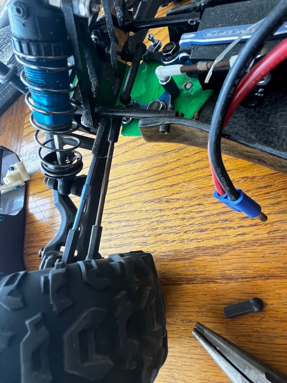

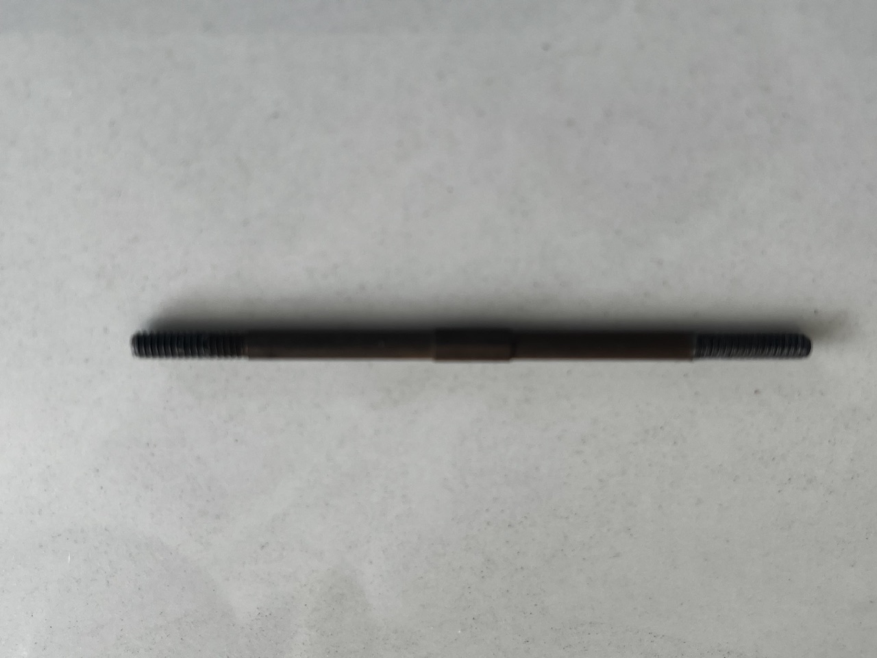

This is what I’m hoping to skip in the future. The titanium turnbuckles are great and the steel are rusty. Here is the turnbuckle removed from the truck. Here it is soaking in a bag of crc rust remover.
After only a few minutes it looks like some of the solution is turning green.

A progress picture
It doesn’t look shiny in the picture but it’s obviously getting plated.
Seems to be working nicely.It doesn’t look shiny in the picture but it’s obviously getting plated.

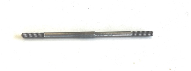

In progress picture. I didn’t clean the thread well enough. Photographs don’t at all capture the in person appearance.

I upped the voltage to around 6 v and noticed some contaminants forming.
Knocked it back down.-
