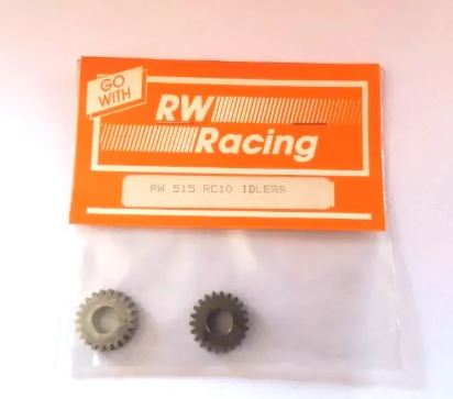

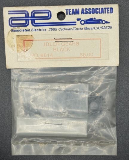

There are a bunch of folks racing 6 gears on carpet, but only you know how hard you are on your cars. Take it to the track on a practice day. Worse case scenario, a pair of 6613 idler gears are only $8, $12 if you need them shipped... cheap insurance.

But there's also 6614 heavy duty Idler gears:
Or RW Racing 515 Steel Idler Gears if you can find them:
At that point I'd look at adding outdrive bearings like Frankentruck mentioned.

Now that the outdrives are in production, it's cheaper to cut them down into new steel idler gears then find vintage sets.Dangeruss wrote: ↑Mon Jun 09, 2025 6:01 pm There are a bunch of folks racing 6 gears on carpet, but only you know how hard you are on your cars. Take it to the track on a practice day. Worse case scenario, a pair of 6613 idler gears are only $8, $12 if you need them shipped... cheap insurance.
