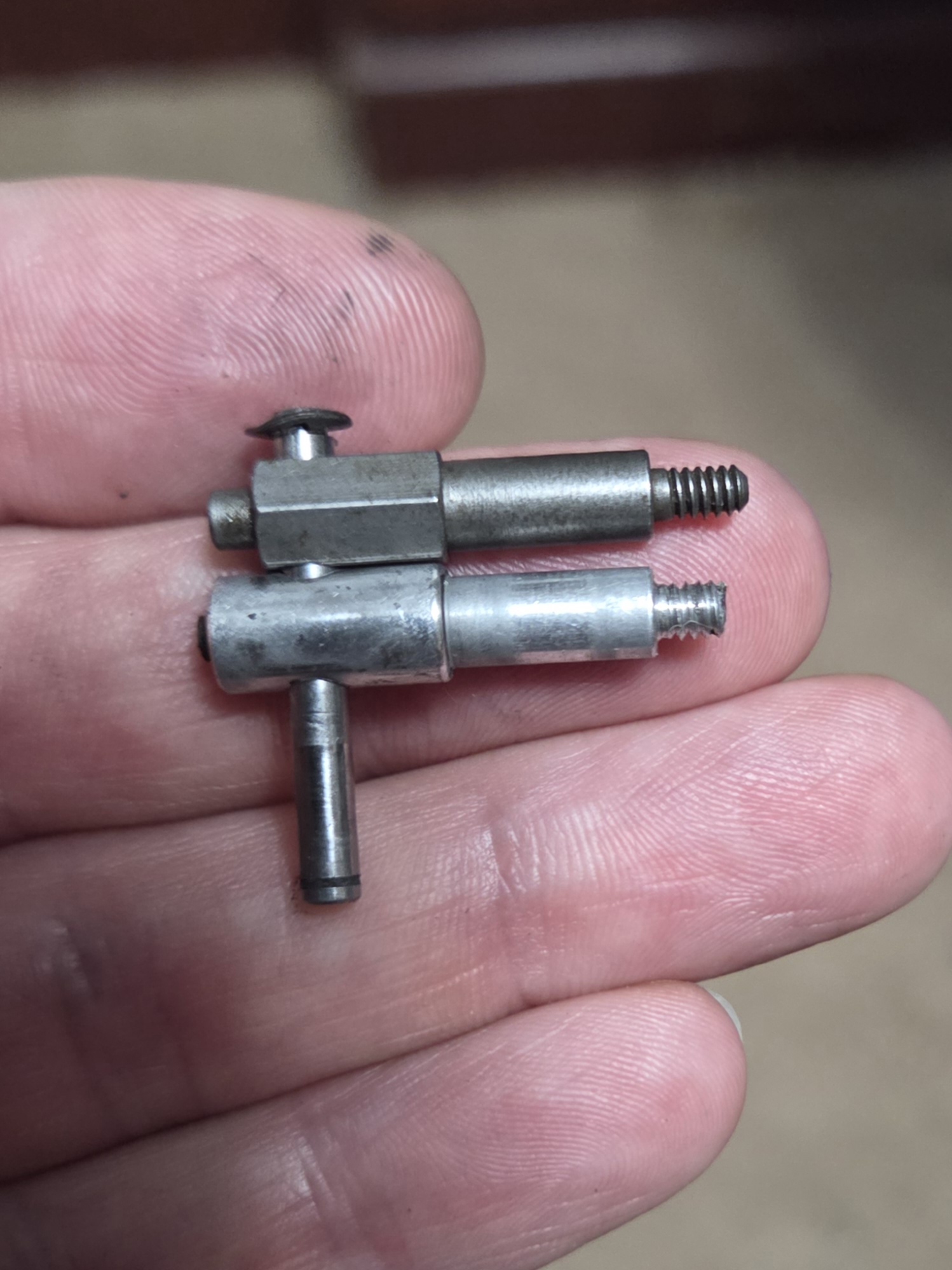

Just for a visual, here are both types of inline axle.
You can see that the threads on the aluminum axle are kinda short. It was common for people to break them.

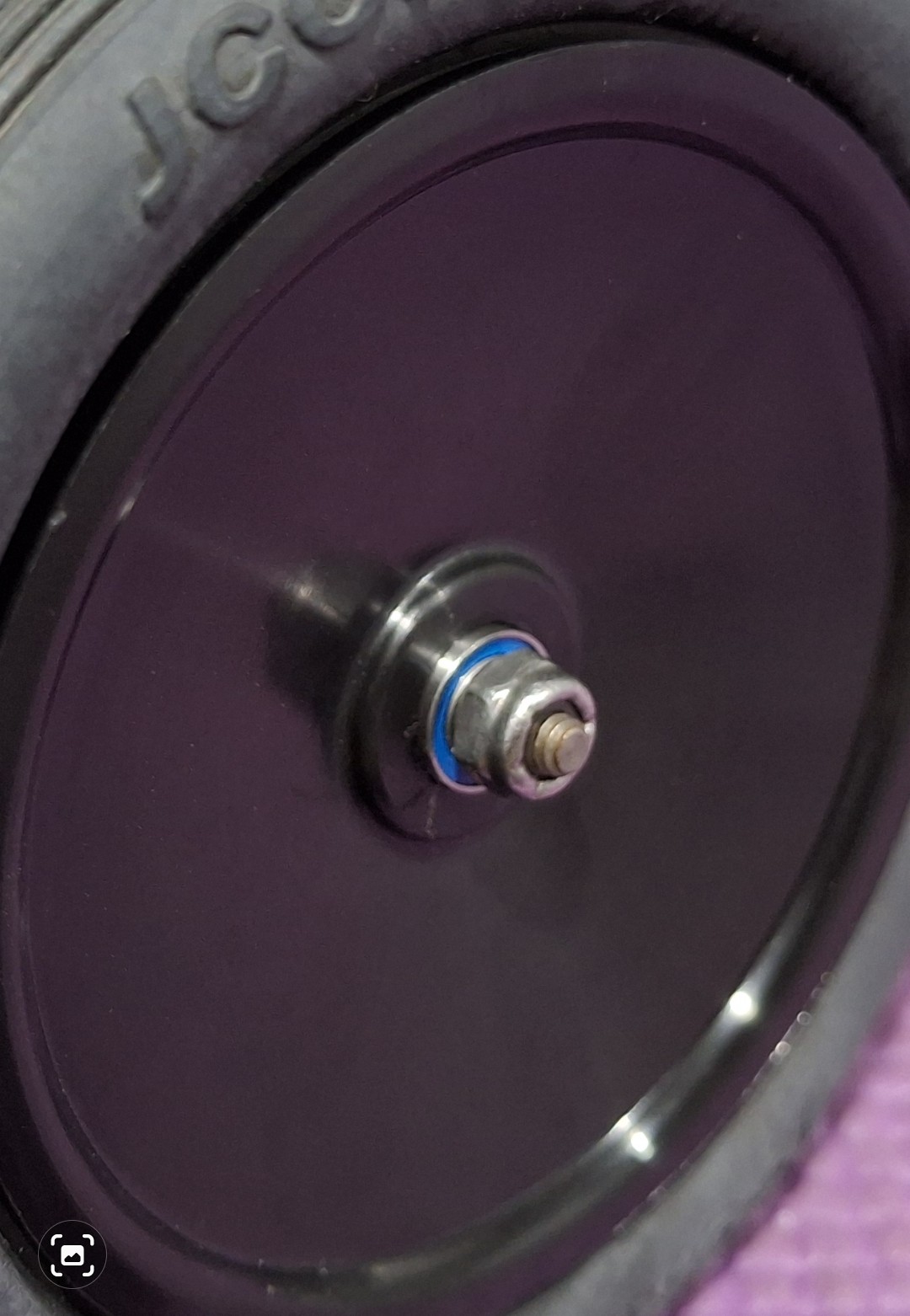

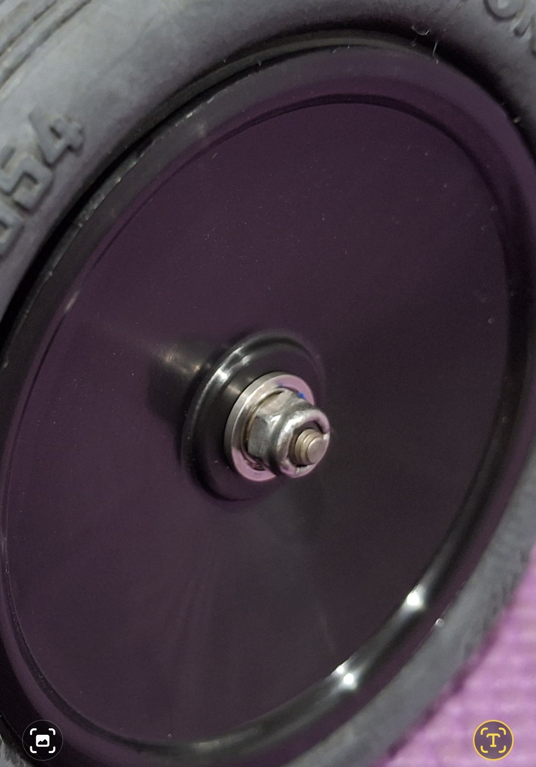

Ty89m wrote: Fri Jun 20, 2025 5:00 pmIt also sounds like finding some non-flanged 3/16 front bearings are a requirement if going with the 2.2" JC wheels as well.
Flanged and non-flanged on JC Racing wheel. There's negligible difference in play. Flanged look better? being "flush"

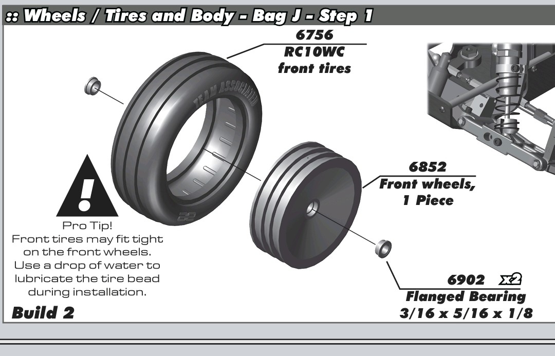

Ty89m wrote: Fri Jun 20, 2025 5:00 pmI'm fairly sure the BK car tires would likely work, and I'm guessing the narrow JC front wheels would be ideal for those.
It mentions the tight fit in the BK manual, that's on a smaller diameter wheel.
The narrow JC wheels are designed for carpet and astro tires. I think the wide wheels would be better for ribs?

juicedcoupe wrote: Fri Jun 20, 2025 9:49 pm Just for a visual, here are both types of inline axle.
Thanks for posting the comparison between the two. I wonder why Jconcepts says the 6220 axle should be used for "original track width" when they're essentially the same in that regard.

Ty89m wrote: Sat Jun 21, 2025 1:23 amI wonder if something like the JConcepts "Rips" would work well?
They're "Rips" on JC wide wheels in the images I posted.

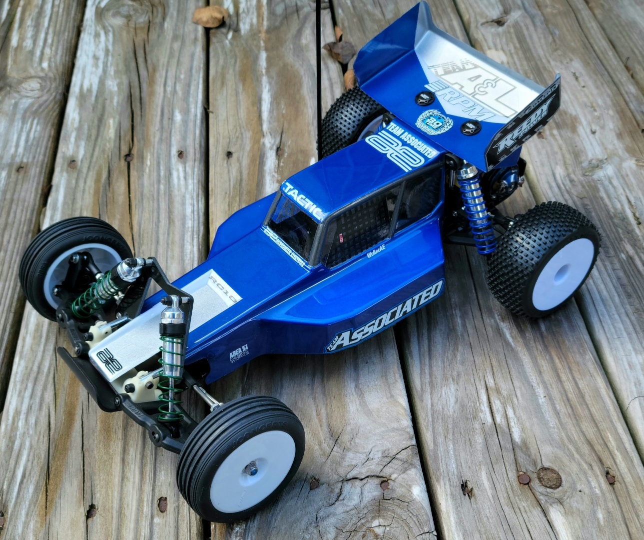

Ty89m wrote: Sat Jun 21, 2025 1:23 am The JC narrows look like they're intended for modern narrow carpet tires. The JC narrows are 21mm in width, and the wide 26mm. I wonder if something like the JConcepts "Rips" would work well?
These are JConcepts Rips on a modern 2.2 (wide) wheel. Those particular front wheels are from Avid but that car uses hex wheels.
