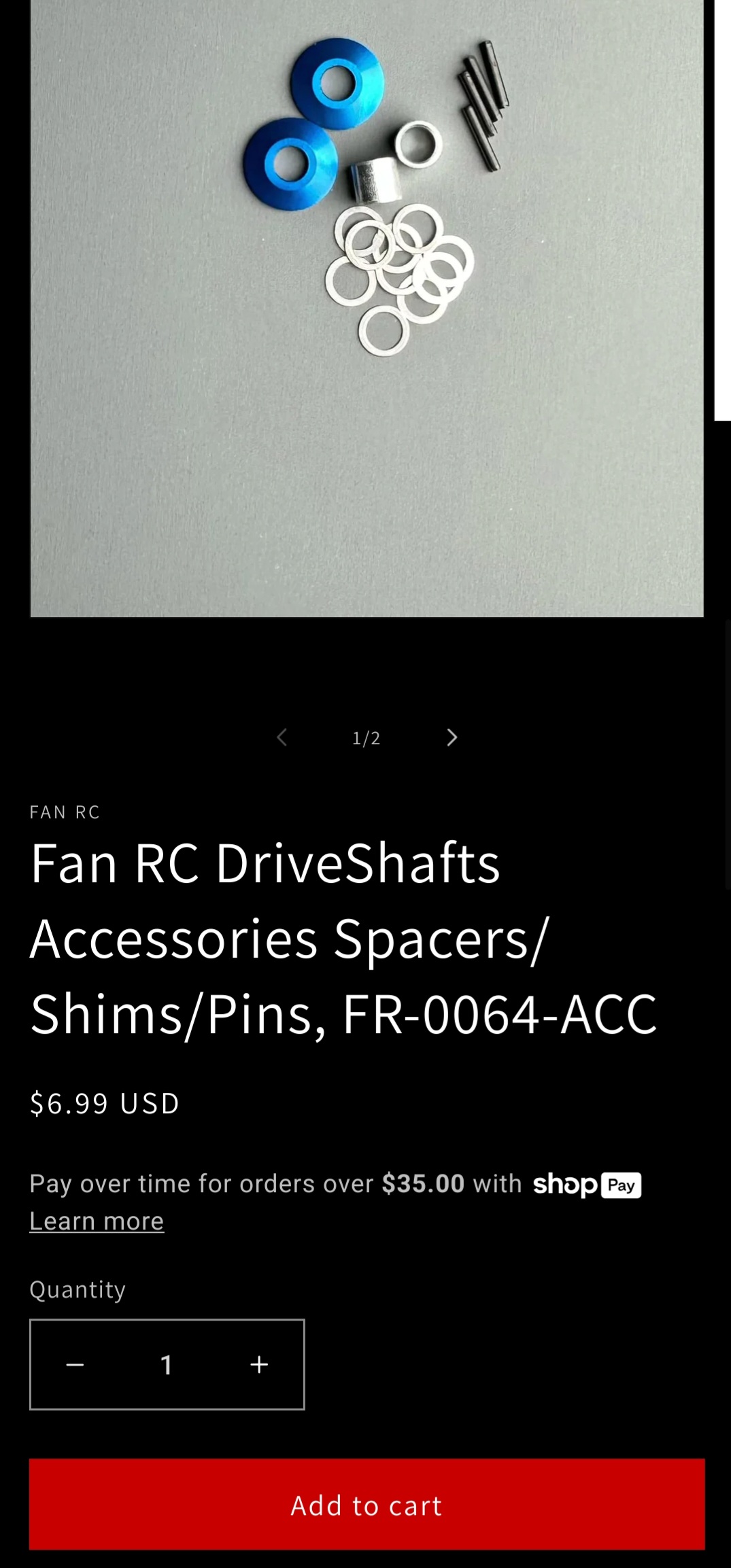

A printed part won't help, you would be just as well off running without it. The printed part will crush way to easily basically not even doing anything.
You can pick up the fan rc spacers quite cheap, depending on your location
*Note: I assume you are building your car with 3/16 axles since you cannot use a bearing spacer with the 1/4". The og world's was 1/4, the rere was 3/16
https://www.gofasthobbies.com/products/fr-0064-acc

It looks like the part you need is part of the Brian Kineald car. You could also just get a piece of tubing and cut it to length.duaneroddy wrote: ↑Wed Jul 02, 2025 11:35 pm Hi, I am building a brand new RC10 World from old and new parts. All I am missing is the ASC7377 – the rear axle bearing spacer, which is hard to find separately.
