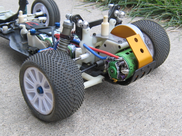

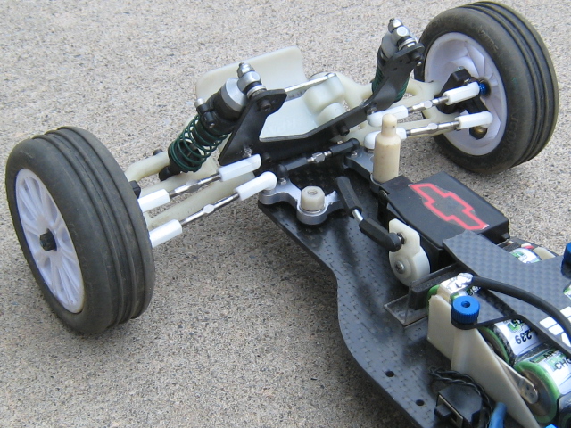

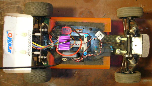

cedric asked in one of the nats threads about getting info on the cars, which i think is a cool idea. so, i thought we could post our stuff up like they would in rcca of the winner's buggy/truck. here's mine...........

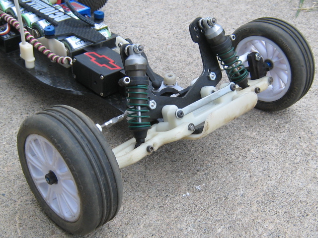

CAR: RC10 Graphite Team Car/RPM Worlds Conversion Hybrid
RADIO: Futaba 3PM 2.4ghz
RECEIVER: Futaba R603FF
SERVO: Futaba S3003
ESC: LRP QC2
MOTOR: Trinity Green Machine 27t / old school non-rebuildable
BATTERIES: Energ 4600's / Promatch & TQ Cells
TRANS: RPM 2.65 Stealth Conversion
SHOCKS: ASC Team Shocks - .71's (front), 1.32's (rear)
TIRES: JConcepts Rounders (front), and JConcepts Double Dee's (rear)
WHEELS: JConcepts / B4
BODY: ASC Protech
MISC: chassis kickup cut to use narrow RPM bulkhead, RPM worlds arms, andy's pro graphite front shock tower, rc10gt wide front axles, losi steering bellcrank, modified 10t rear shock tower, RPM 10t rear bulkhead, HG trans brace, losi rear hub carriers, b44 rear cvd's, b4 ft battery brace, robinson racing lightened b3/t3 slipper clutch, lunsford turnbuckles.

The car looks sweet. How did it handle? Did you customize the chassis to fit the RPM front bulkhead? I would also like to know what shock tower was used on the rear?....I need something like that.
It sounds like fun was had by all at the event. Thanks for the pics.

the car was indeed sweet.matteo wrote:The car looks sweet. How did it handle? Did you customize the chassis to fit the RPM front bulkhead? I would also like to know what shock tower was used on the rear?....I need something like that.
to all those peeps posting rigs, please update your original post with additional info you may provide or be asked for.

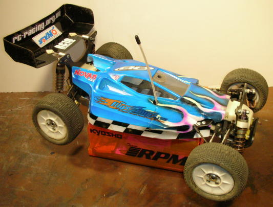

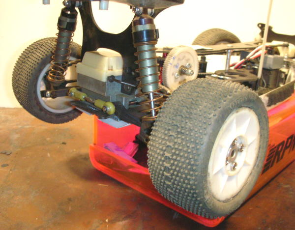

Re: V-Nats Tech Thread....... show your stuff, rc10 or not

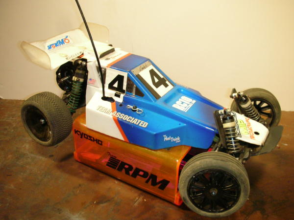

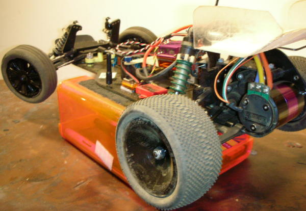

i uhhhh, kinda got my camera wet taking pictures of my wheel while driving home in a storm...
i kinda thought it was a dumb idea...
CAR: ae pink powdercoated tub and nose, trimmed for dynatech 'worlds' arms.
10t rear tower, rpm worlds front with added holes for the longer b4 shocks.
homebrewish steering bellcrank made from a cut rpm upper wishbone and the tall bellcranks from an ultra molded chassis.
rpm worlds front c-hubs and steering arms, rpm rc10gt rear carriers with ae #7935 bearings for 3/16" cvds.
RADIO: spektrum 3.0 dsm
RECEIVER: spektrum sr3000
SERVO: spektrum z590
ESC: novak gtb
MOTOR: novak 17.5 brushless
BATTERIES: maxamps 4000mah 2s lipo
TRANS: rpm 1.95 oval trans. 83t spur/24t pinion, 6.57:1 overall gear ratio
SHOCKS: b4 shocks built to the ftb4 manual, #2's up front, #1's rear, 30wt oil, green springs
TIRES: jconcepts rounders front, double dees rear
WHEELS: duracrack nitro ev's for qualifying, ae b3's for the mains
BODY: ae protech1, ae 5.5 wing
i'll replace the images if my camera isnt messep up and the lense dries out.

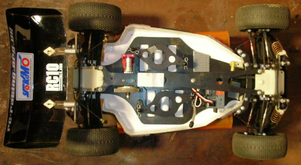

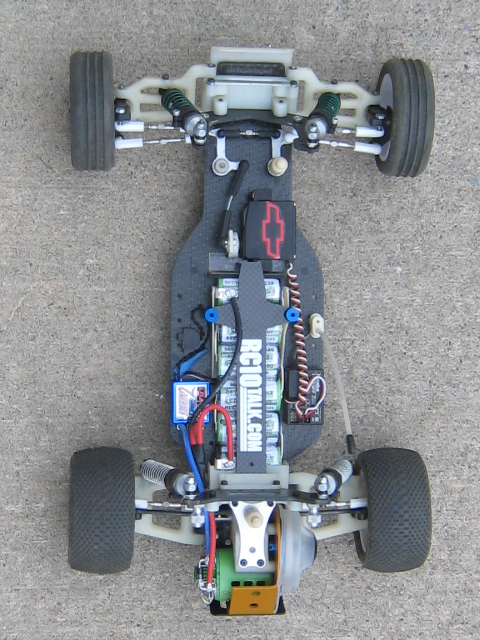

RADIO: Spektrum DX 3.0 2.4ghz
RECEIVER: Spektrum SR3000
SERVO: Futaba S9551
ESC: Novak GTB
MOTOR: Hacker 17.5
BATTERY: Orion 3400 Li-Po
TRANS: Stealth with B4 slipper
TIRES: JConcepts Rounders (front), Proline Evil Twin (rear)
WHEELS: JConcepts (front), Trinity 2.2 (rear)
BODY: Andy's

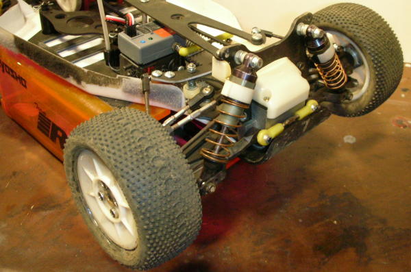

CAR: Yokomo YZ10 '93 Works
SERVO: Futaba S9551
ESC: Novak GTB
MOTOR: Hacker 17.5
BATTERY: Max Amps 4000mAh Saddle
TRANS: Stock Yokomo
TIRES: Losi A7689 (front and rear)
WHEELS: Stock Yokomo
BODY: '95 Pavidis

were any mods done to fit the jconcepts rims? They look pretty good on there.

oh ya. they're definately not a direct fit. refer to this link:RC Chick wrote:were any mods done to fit the jconcepts rims? They look pretty good on there.
http://www.rc10talk.com/viewtopic.php?f=4&t=5483&st=0&sk=t&sd=a

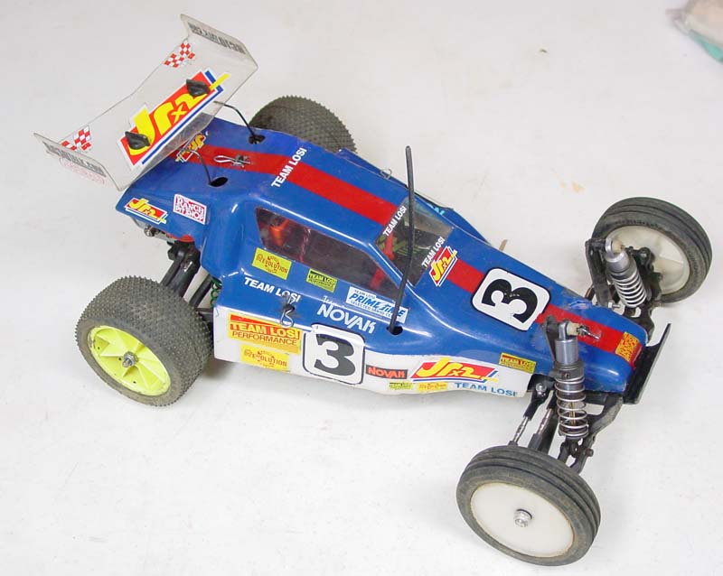

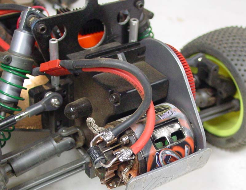

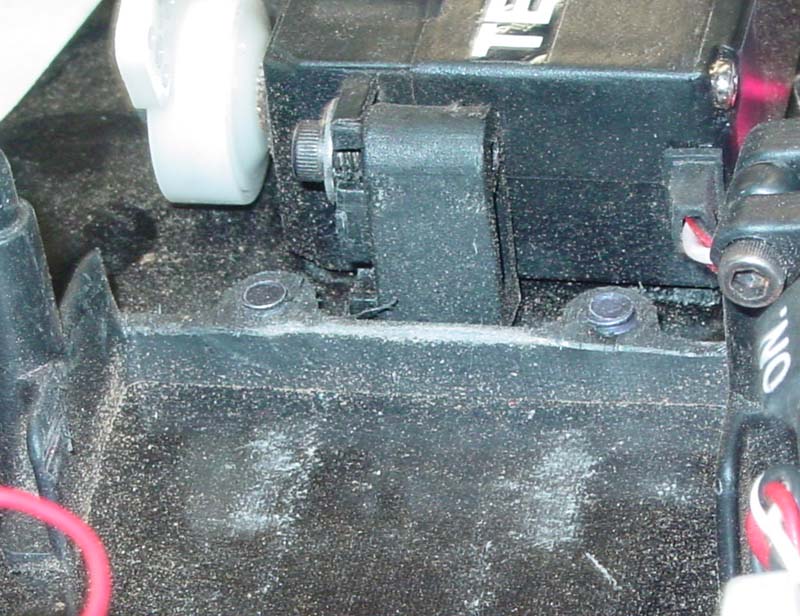

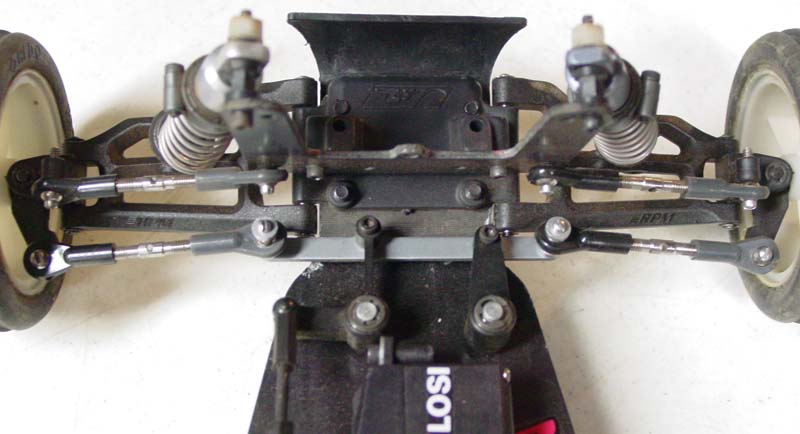

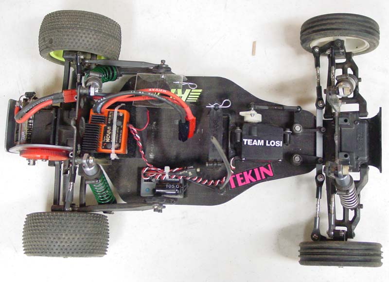

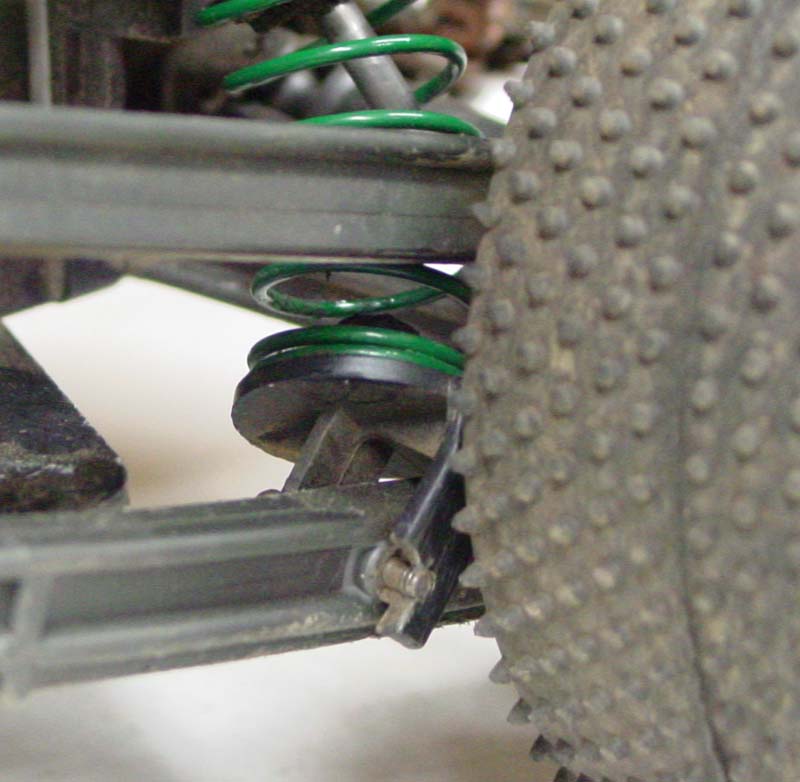

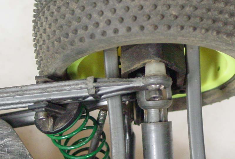

CAR: JRX-2
RADIO: Futaba 3pj-super with spektrum module
RECEIVER: Spektrum sr3000 with spektrum voltage protector(capacitor)
SERVO: Traxxas 2055
ESC: Novak 410m1c
MOTOR: Trinity p2k2 27t
BATTERIES: Energ 4600's:Promatch & team scream 3300's
TRANS: losi LRM
GEARS: losi profiled spur 86t 19t pinion
SHOCKS: Standard losi kit shocks, 30 wt oil and ? pistons
SPRINGS: Modern losi green(r) original losi silver(f)
TIRES: Losi mini pins(r) Proline RED Pro-15
WHEELS: Rear Losi XX Front Proline dish (2.1)
BODY: Original JRX-2 survivor racer. (Reinforced nose section)
MODS: Lower rear link spaced inward with nylon nut and upper link flipped to allow wheel/tire clearance.
Lexan transponder mount on left side bulkhead, Battery box front lower section cut flush with screw holes for modern battery fitment.
UPGRADES: losi ball bearing steeing bellcranks and mini bumper, RPM front arms, Tecnacraft heavy duty turnbuckles and rod ends.
The left lower shock end popped off with 1 minute left in the main

ESC: Novak GTB
MOTOR: Brushless 17.5
BATTERIES: Promatch Racing 4600 nimh, Trinity Reference 3600 for practice.
TRANS: Stealth 2.25
GEARS: Kimborough 87t spur, Robinson 22t pinion
SHOCKS: Team Shocks -- AE 35wt oil all around
SPRINGS: Gold Fronts/Green Rears(not pictured but used at the nationals)
TIRES: JConcepts Double Dee rears/Proline Edge Fronts
WHEELS: Proline rears for 1/4 axles and Proline Fronts
BODY: RC10T2
MODS: RPM front and rear arms, RPM body mount kit, RPM bumper
Qualified 3rd in the A-main and Finished 6th
due to some unnecessary roughness
RADIO: Airtronics M8 with Synth. Module
RECEIVER: Novak Switch Synth. Receiver
SERVO: Airtronics High Speed Servo
ESC: Novak GTB
TRANS: Stealth 2.25
BODY: RC10T2
