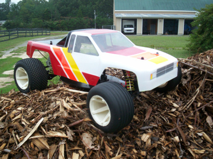

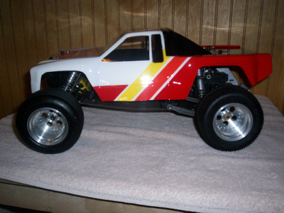

If you use the XX retrofit trans, you can run Brushless and a Lipo. I ran most of this racing season with an old LX-T with that set up. it ran just fine with the T4's, was a little faster but I cant drive anyway. HPI wheels will work just fine on the old Losi's. I run with them on all of my runners. their cheep and easy to find. not like an original set of Jrx-t wheels. here is a picture of one of my JrxT's with McAllister body and HPI wheels. the McAllister bodys are nice cheep around 25 shipped
Top truck McAllister Body See's wheels ( PM bngiles for those )
Bottom Truck McAllister body Hpi wheels
McAllister body
100_3423 (2).JPG (68.25 KiB) Viewed 1801 times
McAllister body
McAllister body
McAllister body HPI wheels
100_3326 (2).JPG (99.68 KiB) Viewed 1801 times
