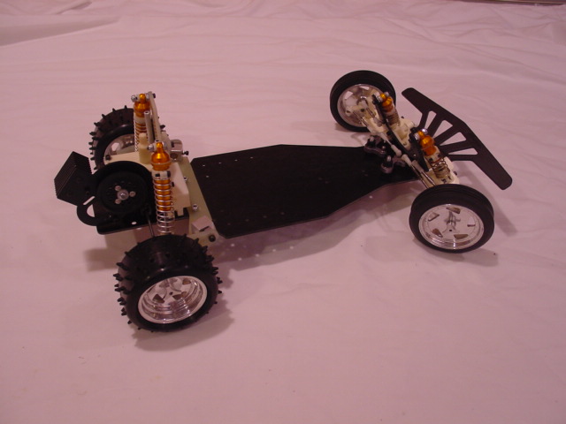

Here is a project that I am in the middle of...Image
I am not sure who made this chassis but I preferred it to cutting a tub...
nice wheels and knockoffs, pretty clean parts all over...
The Trailing Arm mechanics are very cool, though the directions are not perfect for the build.

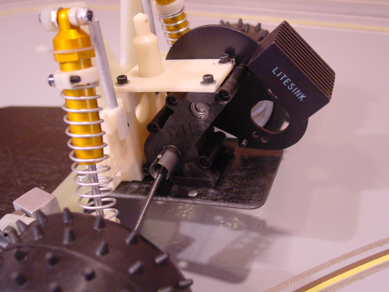

Has a NIP SP-1 transmission with slipper shaft (I used a stock solid shaft). The transmission went together pretty well, I used the supplied MIP diff grease as instructed but it seemed a little goopy....loosened up after a lil time
So now, I'm looking for recco's on a neat front end that would work well with this build...
Not sure I will have the parts recommended but I enjoy the hunt!
Feedback welcome!! Thanks

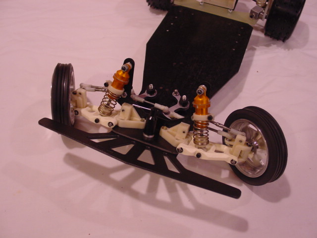

Another pic...

nice build
i say go black MIP steering (i may have some)
Andy's Single one peice front bulkhead
MIP Shock tower front
White arms/bulkhead
Mr. ED

why do you have 3 screws all on one side of the spur? usually those screws are put in different patterns to keep the spur from wobbling.
PS: going from the picture showing the black-white-black sandwhiched layers I think it's composite craft chassis.

i'd go with andy's white front arms, along with the standard rc10 white suspension pieces. an original 2 hole fiberglass shock tower would look good on it, too. mike's idea of an mip steering bellcrank would fit the build well, just make sure it's the old style. :wink:
cool build so far. :)

MikeDealer, I had a set of alloy cranks that I used which offset the trailing arm blocks nicely....I would be interested in the MIP set up if you have a spare to trade or sell--not sure of the difference between old version and new version though. For the shock tower, I used a Parma Graphite piece...I am also on the lookout for an MIP fr shock tower now too...Image
Mr Ed, I fixed the screws on the gear---overlooked that, rushing...
Scr8p: had a set of the Andys fronts and some Tecna ti rods so there we go, lookin for better white ball cups and .......suggestions for a body on this rig????
Todd, thanks for the props on the slot car track, thats a hand routed 4 lane HO track I've had for about 5 years now...One of my other interests are the brass chassis HO slot cars from the early 70's... visit my website http://www.riggenho.com
