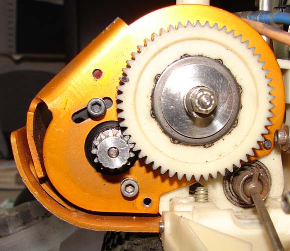

The gearing is the kit supplied 54 tooth spur gear, with a 13 tooth pinion.
I also have , but havn't tried yet, a 78 toothed spur & 12,18 & 19 pinion gears. They are of a different pitch.
What am I doing wrong?

it doesnt' get any easier does it? Installed the 74 tooth spur but the smaller diametor, coupled with the small pinion, they can't reach each other. The motor has no more room to slide up as it hits the white gearbox.
Any ideas mate?
Jak
Any ideas mate?
Jak

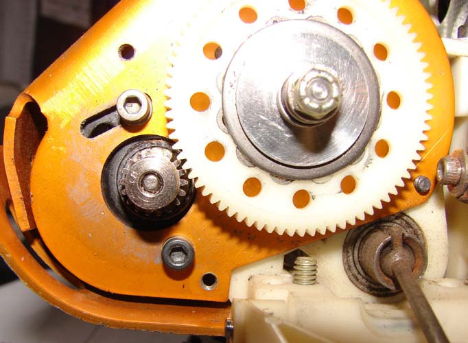

Might have to just get a bigger spur to give you the best range of pinion options and be possible to mesh them, I run 90t which is the biggest you can fit dunno if it'll fit inside a standard gear cover, 84 or 87 would probably be alright.

Yeah, most spur gears come with all the ball holes in them except if they're made for a B4 so it shouldn't be too hard to find one here, they're usually 12 holes instead of the original 8 though so you need the 12 balls. Liquid RC has them with $1 shipping if you can't find any around here.

I had a similar prob, mine was gearing. I was using a truck so I stayed with the 87 spur and had to get a 21t pinion to get it right. Ive heard you should use the same numbered pinion as the turns in the motor for a starting point. Try this link though
