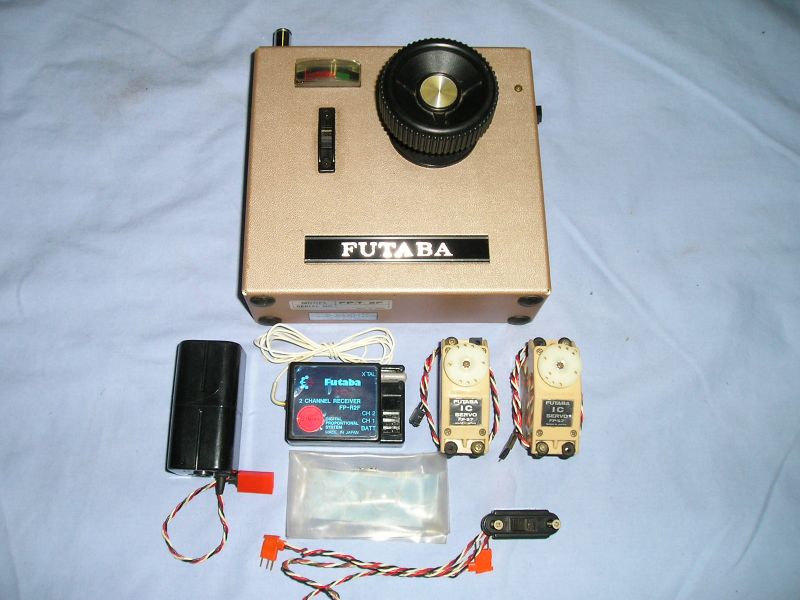

It also appears to have a small servo radio tray, Futaba FP-S20 would be correct, they're tiny.
Here's a similar setup to mine, the servos are large S7's (about the size of an S148) so you'd need to hack the tray.
http://cgi.ebay.com/FUTABA-FP-2F-RADIO-VINTAGE-R-C-COLLECTORS_W0QQitemZ180315807958
Not thinking $40 is that great of a deal on that though. Just an example of the period correct gear.

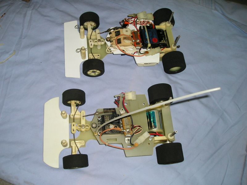

The little 1/12th gem arrived and I must say I love it even though it's the very first 1/12th scale car I own, never been a huge fan of carpet racing... Nothing is missing inside the box, it even came with the French translation of the manual and price tag! Body has been partially trimmed and is in superb condition as well. Even the tires are still in very good shape after all those years, boy I was 3 years old when this car was firstly released
More pics as promised:

I noticed that right after looking at the pictures. Unfortunately I only had time to rapidly take some pictures of it and put it back in the box. I'll have to take some shots with the body on but it needs to be trimmed a bit further.templeofspeed wrote:Super nice, David! Get those front wheels right side out...
I was wondering when the fiberglass radio tray came out and if it was ever included in the kits or just available as a hop-up?

Re: - RC12E with original box and uncut body -
I'm pretty sure the fglass radio tray was available as a hop-up from the beginning. I have one of the last 12E kits (from about 1986) which came with the 'glass tray (S32 sized) and also the "wedge" chassis, wide rear brace and 12i front arms. It's a funny thing...I was wondering when the fiberglass radio tray came out and if it was ever included in the kits or just available as a hop-up?

I'm also interested in finding the electronics that are on the bo art car, what kind of servo/radio combo should I look for and will I have to hack the radio plate to make those servos fit?
Cheers guys!

The radio gear shown is standard FP-T2F; S6 (or S7) servos, R2F Rx. You will have to open up the radio tray for those servos. Your car is new enough that the S20 micro servos were available, and they drop right in. Or split the difference and use S32H servos, with minor cutting. Or find one of the larger cutout radio trays...I think Darryn might have one or two.

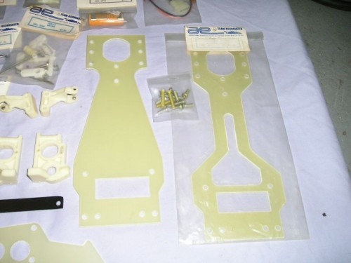

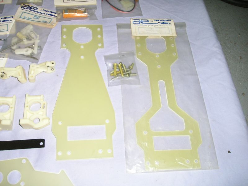

Just so you know what to look for:
