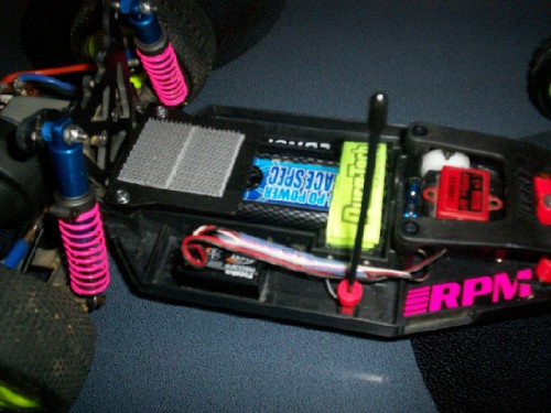

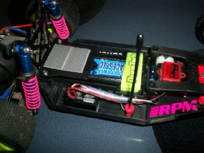

In My Pro se I just removed the battery holdown completely and used a Pure Teck strap see pic. in My LX-T I removed the battery stop under the bulkhead and used a foam block insted sold truck so no pic's. in My XX it fits fine stock.
