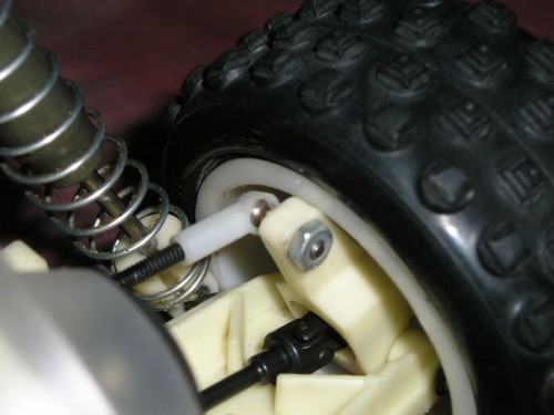

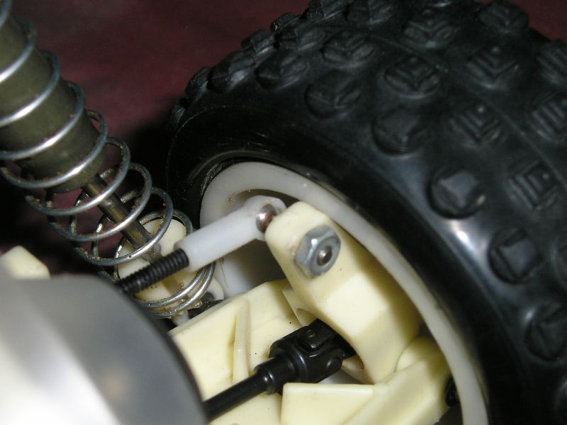

Offset is too far back for STOCK RC10 axle width, hitting the upright and the shock cup:

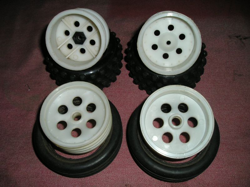

Look for optima mid, turbo optima, salute, turbo ultima, ultima pro, maxxum FF... wheels.
They are 2.0, 12mm and have the large offset compared to 2.2 kyosho wheels
