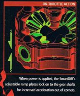

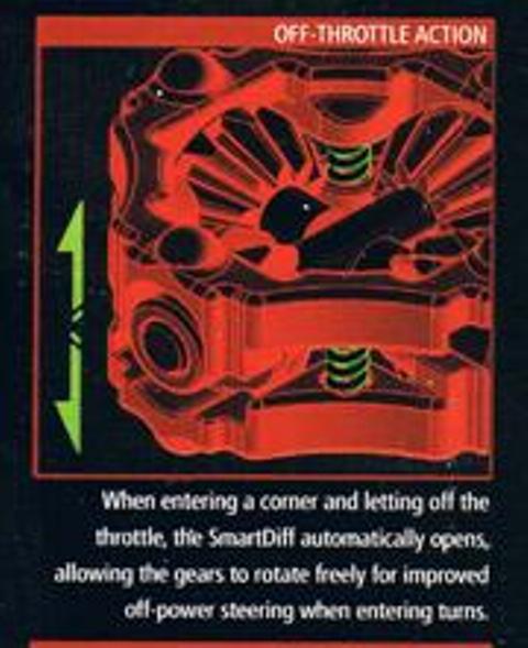

I was thinking about a modern equivalent of a HydraDrive,or some other sort of traction aiding device,when I saw Losi' new 'SmartDiff'.
Here's a quote from Losi..Well,Horizon Hobby 8)
"Losi engineers have designed a patent pending differential that knows exactly how to respond to track conditions and throttle input,offering the ultimate combination of precise steering and immediate acceleration".
"The new SmartDiff is the ultimate racers' upgrade for the new 8IGHT 2.0,capatalizing on it's already incredible acceleration.
It makes an easy,drop in hop-up for every 8IGHT platform vehicle.
The SmartDiff.Only from Losi".
I wonder how long until we see this diff,or an adaption of it in 1/10th vehicles?
Looks plenty cool to me and a great idea.
Here's a scan,courtesy of the Feb '09 RCCA,showing the SmartDiff under 'on throttle' action and 'off throttle' action:

Different design, but functionally that’s sorta like a Torsen differential.
Hydra Drive equates to an automatic tranny Torque Converter, with lockup even.

Right on,it is like a Torsen. :wink:
