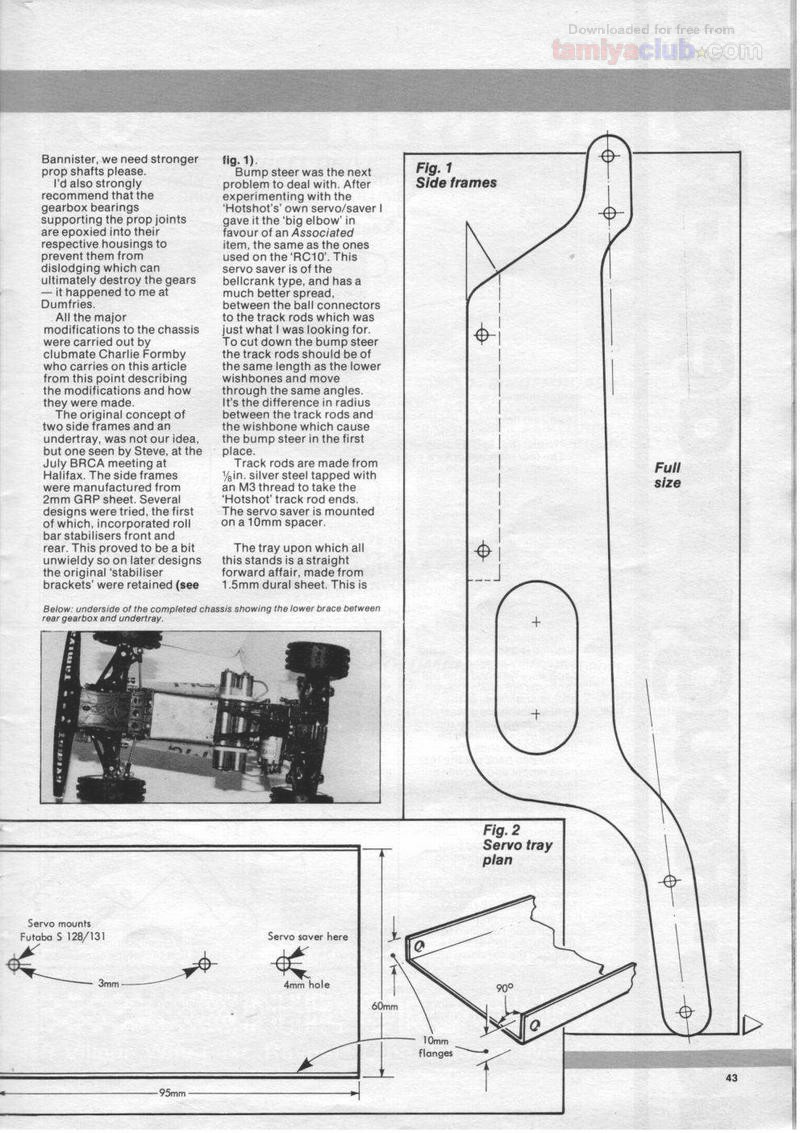

Started in on the hotshot. Not sure I'm good with the magazine version but I wanted to try it first
This is just the mock up so far

Re: Hotting up a Hotshot
Enough of that....now its my turn ....
Lipo friendly and interlocking top and bottom chassis, front of cage bolts down and so far....everything lines up perfectly

RC104ever wrote:I just started my build and its stock for now but I have some Supershot parts but have no idea how to mod the shocks to fit the Hotshot. I was curious about lipo as well - but haven't gotten that far yet.
This looks interesting - will be watching this thread.
supershot has some funky brackets that slide onto the arms and some bent metal towers. I found a manual and looked up the pieces, they dont look very tough. I have the CRP mono shock mounts and the CRP rear dual shock mounts that come off the roll cage that I have duplicated and will be using them. I plan to mod the front for duals also at some point
Had to add a little more rigidity. Not shown, but the newest drawing adds small wings to the lower so you can strap the battery in. I have an associated bellcrank in it, and minimal bumpsteer (without shimming it yet)
