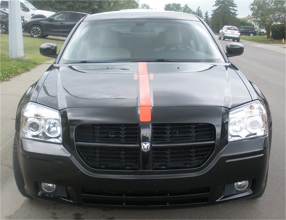

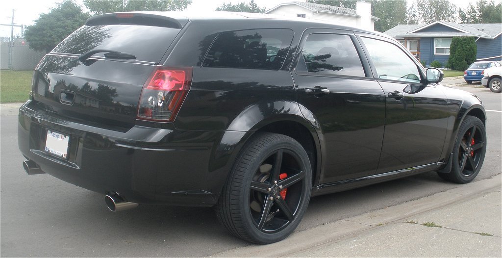

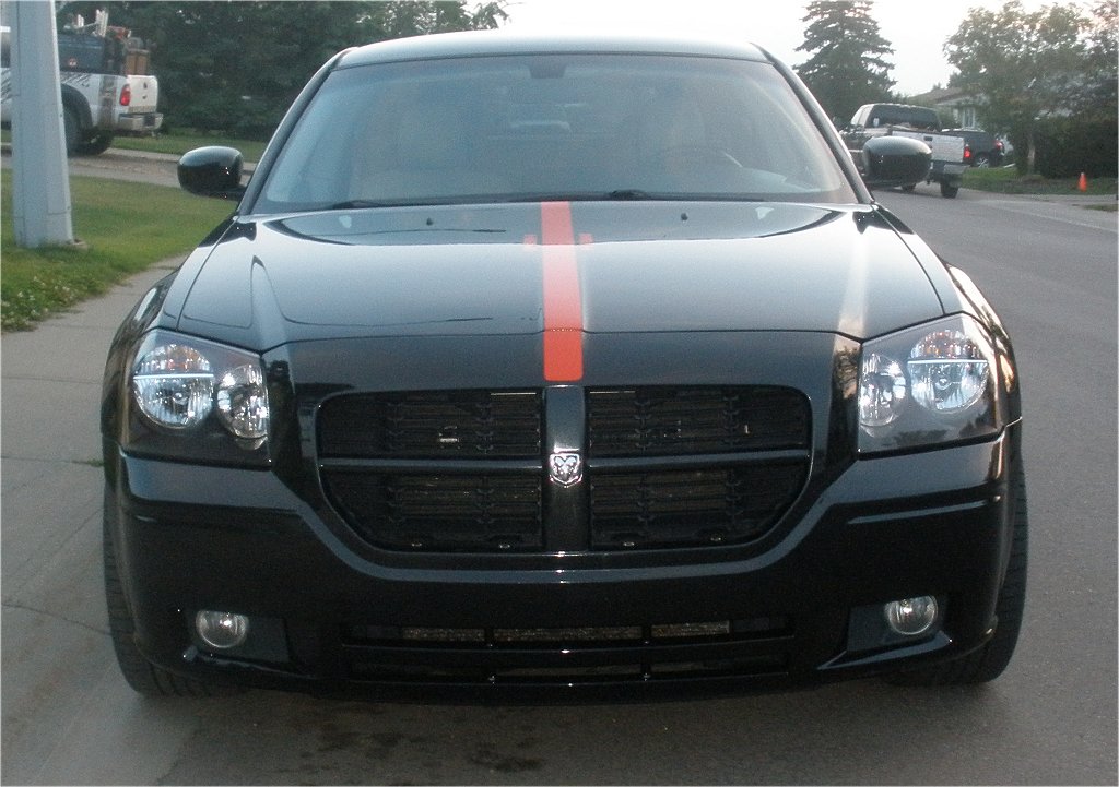

After my 2008 Pontiac Torrent GXP got totaled, I decided to buy a car I'd always wanted--a Dodge Magnum. I bought this 2005 RT AWD in pretty nice condition and have some fun plans for how I want to "make it mine". Here's the transformation progress.

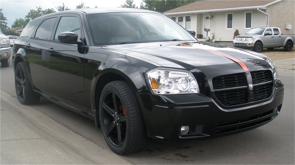

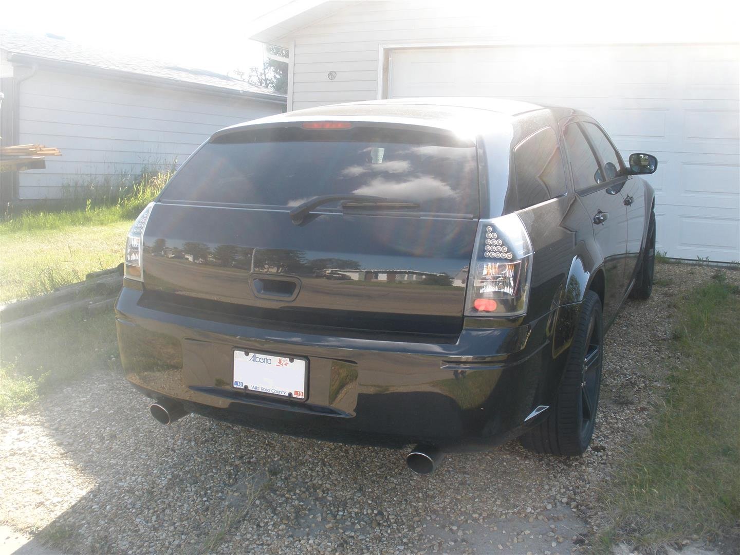

I'll eventually get around to repainting the hood and front fascia to get rid of the orange stripe, but I started with replacing the Spyder LED taillights and chrome projector headlights with Altezza taillights that have black housings and more red lenses than the stock taillights...and I don't like LED lights because when some LEDs invariably burn out, they look like ass. I replaced the front headlights with VipMotoZ Infinity Black headlights with black frames and clear lenses. The LEDs with projectors gave the car a googly-eyed look. I like the new look much better. So at least the facelift has begun.
My wheels will hopefully arrive this week, I'm excited to see them on the car! I also have a Danko Reproductions shaker hood kit on order but I'll be lucky if that arrives early enough to get it done before the end of summer.
Taillights before:
Altezza taillights after:
Headlights before:
VipMotoZ headlights after:

Taillights before:
Headlights before:

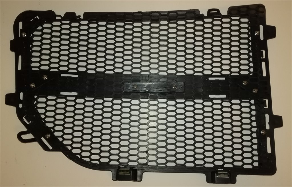

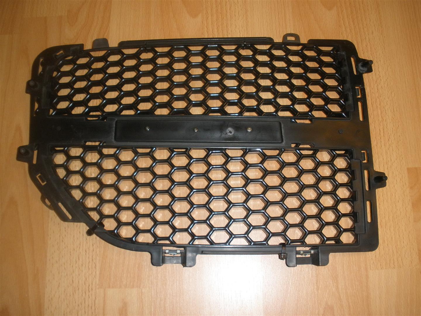

After I removed the el-cheapo billet grille overlays practically the day after I bought the car, I saw why they were installed in the first place: someone had a go at spray-painting the original stainless shiny stock grille inserts that pop into the outer black plastic frames. It was a terrible job and flaking all over the place, and only half of it came off with a good deal of work. I popped the badly-painted stainless horizontal grille inserts out from the plastic frame. I found some nicely-made hex grille replacements on the 'net, my favorite being this Danko Reproductions style, but at $400 USD (hex mesh inserts extra cost), it was out of the budget.

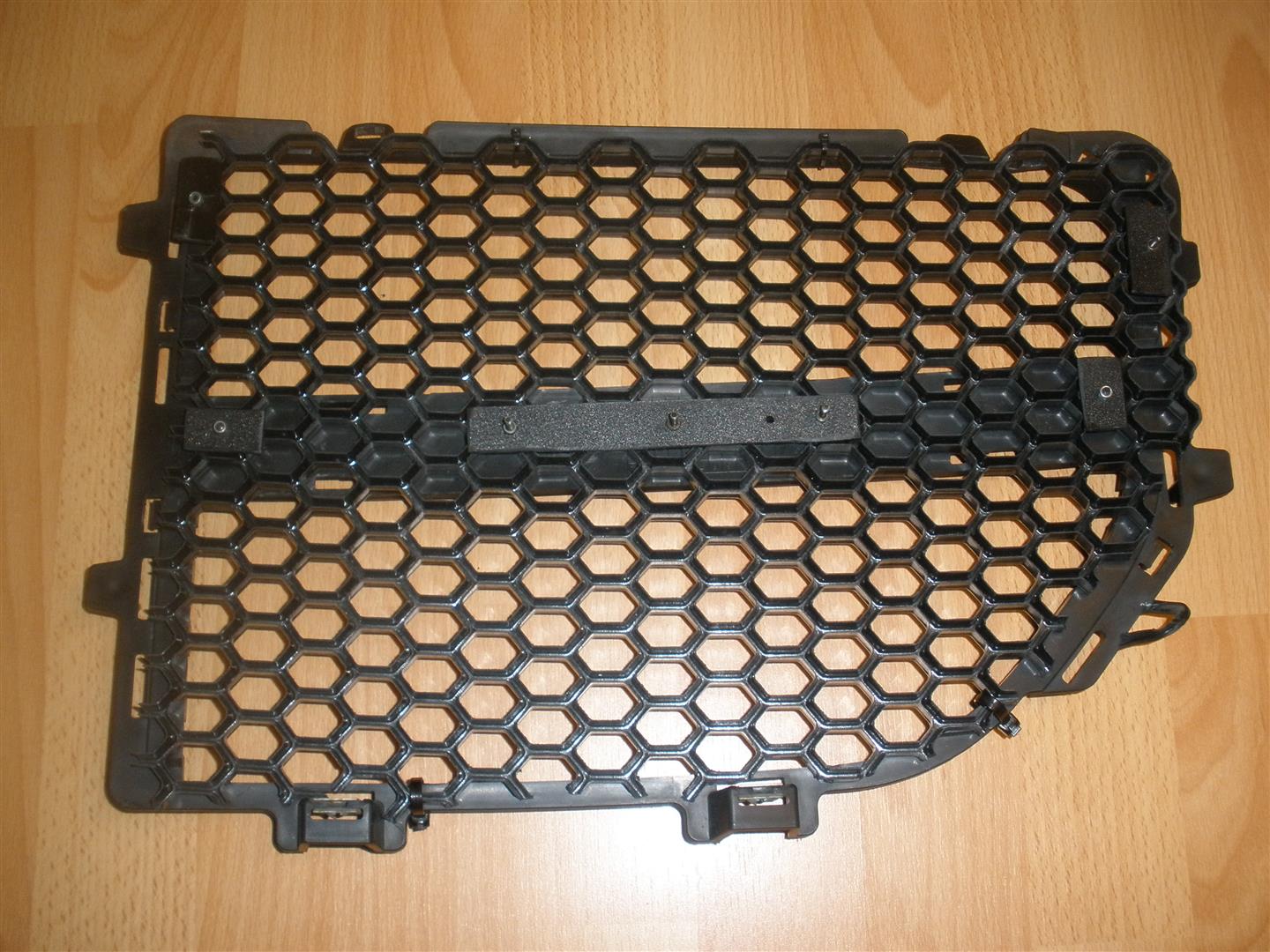

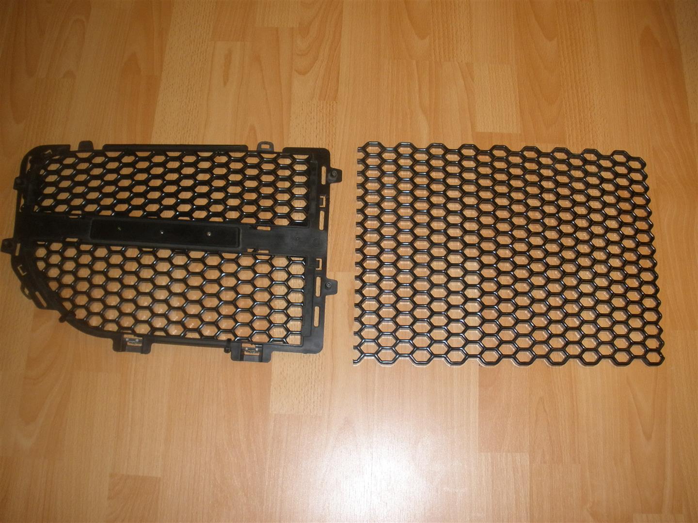

I decided to mod the stock grille myself after seeing someone do something similar, but he just attached the hex mesh to the plastic frame with zip-ties, and some suggestions to glue it with epoxy. I didn't want to make a gluey mess with epoxy and didn't want only zip-ties as it's not sturdy enough, so here's what I came up with. I removed the 2 inside sections of the plastic grille frame with a Dremel, then placed the section of plastic hex mesh behind it with an overlap on all sides, and secured it to the center horizontal bar with 3mm screws, locknuts and a piece of sturdy plastic I cut from a 6 x 9" speaker cover I had lying around. Once the hex was lined up the way I liked, I further secured the hex mesh with 4 zip-ties and 4 additional sections of plastic, bolted to the frame. It's very sturdy now and won't deflect inwards when you press it, i.e. when you need to wash the bugs off after a road trip. I think it looks pretty good. I got the hex grille mesh from some eBay seller from Latvia for $20 per piece, each piece being the perfect size to cover each grille frame.
https://www.ebay.ca/itm/UNIVERSAL-BLACK-ABS-30cm-x-45cm-HONEYCOMB-GRILLE-GRILL-MESH-VENT-RR-VOGUE-Gitter/132636480938
Grille before, after removing the cheap billet overlays and stock stainless inserts from the plastic frames; looks rather naked and ghetto:
Grille mod under construction; the screws and backing plastic sections won't be visible when installed as they'll be hidden by the existing crosshair section of the front fascia:

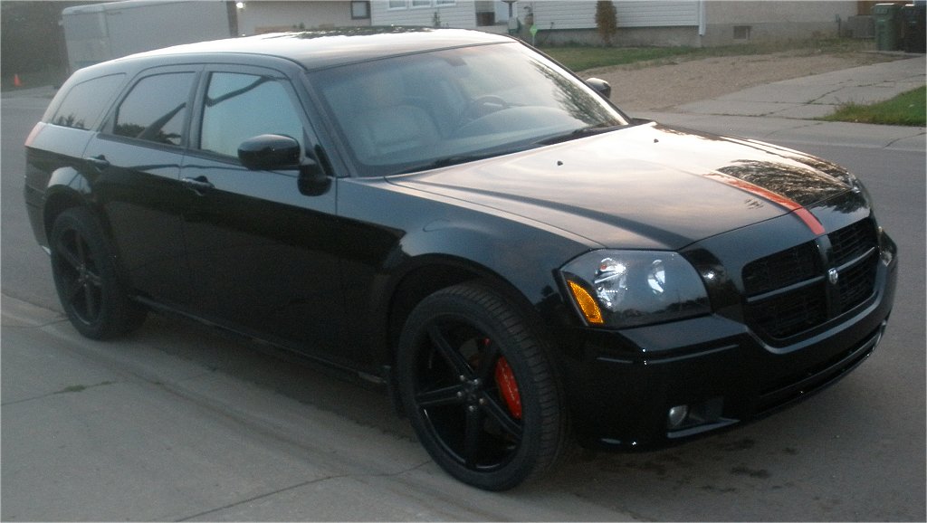

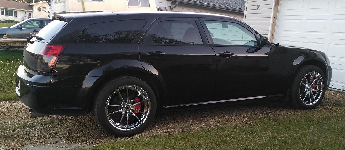

A pic with the new wheels I chose for the car, I think they look much better than black-on-black. The tires I put on are also slightly larger than stock (255-45-20's instead of 245-45-20's). I bought a DiabloSport InTune i3 programmer and one of the features is to calibrate for non-stock tire sizes, so the speedometer will read correctly. Also added an aFe Stage 2 Pro 5R intake, replaced the stock too-hot 203* thermostat with a 180* t-stat and put in a 91 octane CAI tune, decreasing all the fan set-points by 20 degrees to coincide with the new t-stat. Now the car finally breathes in as well as out; it already had a Flowmaster stainless exhaust when I bought it, but strangely no intake improvements.

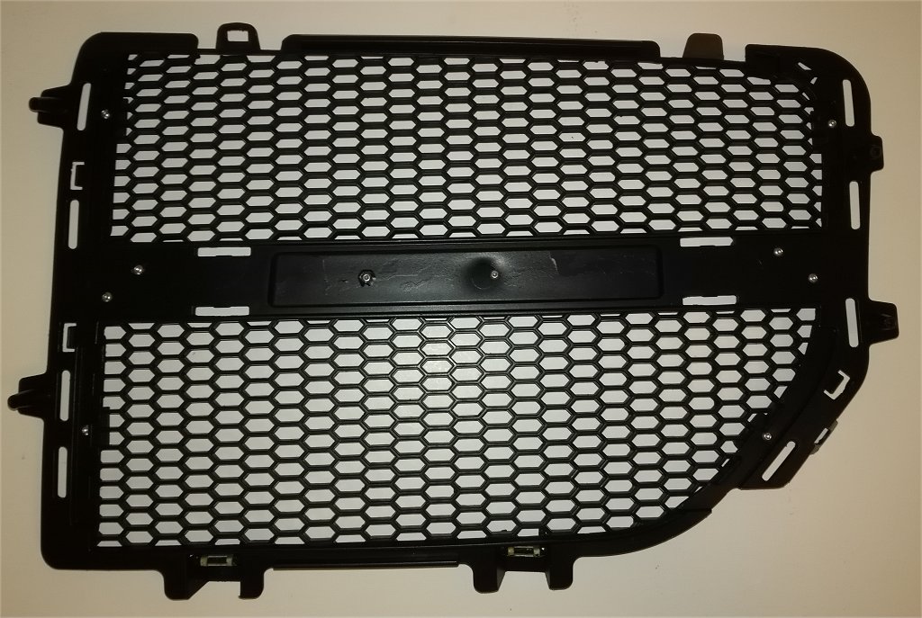

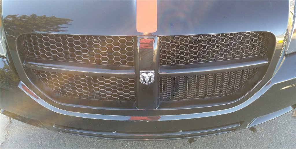

I bought a different kind of ABS plastic hex mesh from eBay that's solid plastic rather than having a stackable U-shaped cross-section...it's thinner and has smaller hex holes so it was easier to cut to size and fit better in front of the bumper crash pad on the bottom. I made it the same way I made the previous one. I wanted to see how they both looked and go with the one I liked more. I think with the easier trimming, the second one will be the keeper and I'll make a matching one for the passenger side grille.

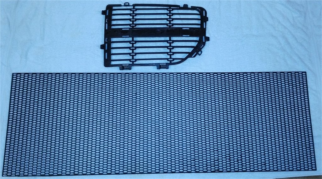

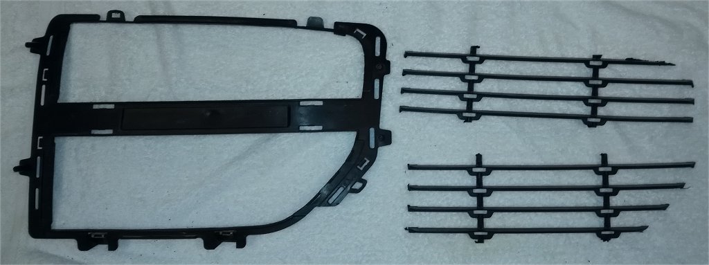

Here's a pic of the original grille after removing the el-cheapo billet overlays and original horizontal steel fins...basically just the plastic grille remaining.
And a pic showing both versions of custom-made grille inserts. I actually think the left side with larger plastic hex mesh looks better, but it's a bigger pain to make and it'll be less durable. I'll make another to match the right side.
