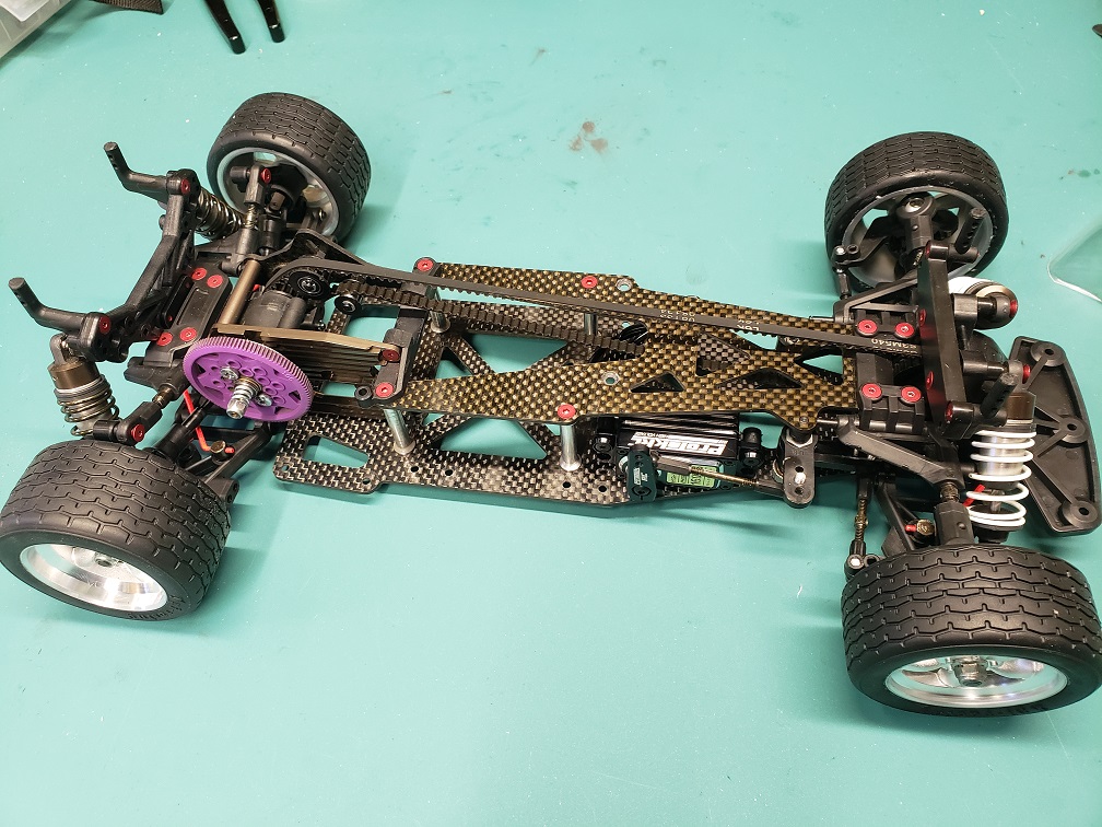

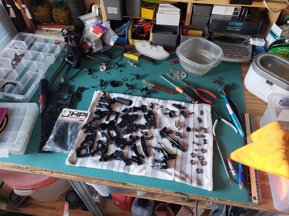

Huzzah! I finally looked into uploading photos and I wasn't aware they could be uploaded directly. Awesome!
So here's the full tear down, after ultrasonic cleaning in my wife's jewelry cleaner.
It collected dust for a few months then finally got to re-assembling it

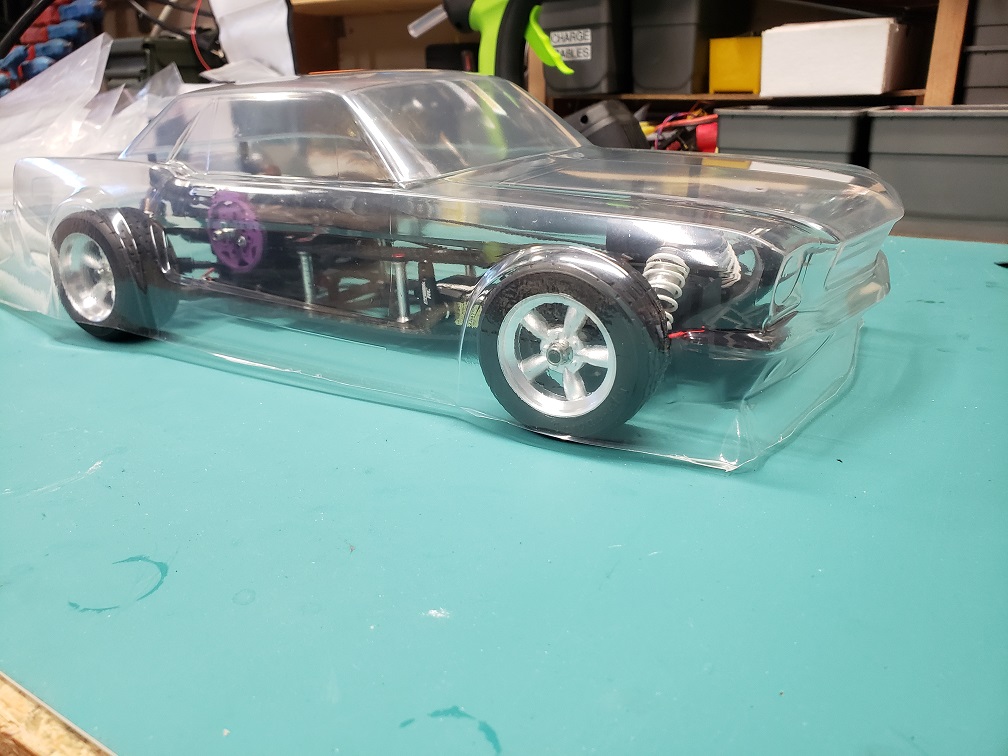

And here it is with HPI Racing 104926 '66 Ford Mustang GT Coupe body set in place.
Trying to wrap it up before Xmas this year if I can.

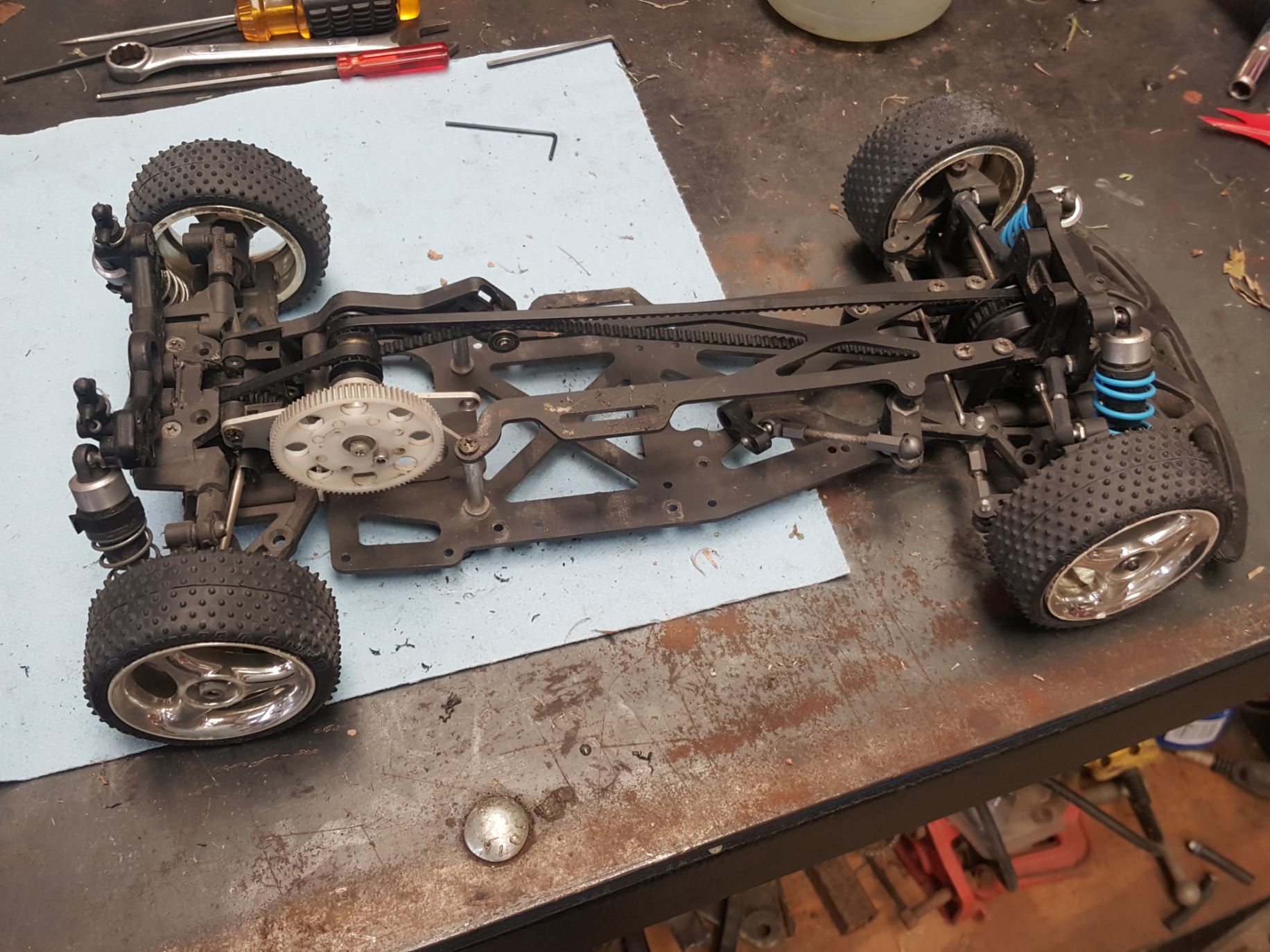

That looks great! I did just finish a body for mine and will post pictures when I can get to it. I did notice your main gear is set up like mine but I don't have the added spring and nut on the end like so many setups on my other cars, losi, traxxas, associated. So apperently I don't have the parts to make this a slipper clutch car. I did put the battery box you built in it and after a bit of maneuvering I did git it to fit pretty good! A lipo box would be interesting along with a brushless motor. I don't know how much torque the gear box can take but with my 27 turn brush (mild) motor and 3400 nicad battery, it was a blast. Never would brake the tires loose under full accel. I was on a pretty flat asphalt parking lot and never used all the battery.
I did notice that my long belt tensioner tightens from the top, again, will send some pics. It presses down from above and the straight part of the bels gets very close to the motor and that chassis support. Yours is underneath which keeps it off the motor and above the chassis where there is a groove. I know there is a way to loosen the ball bearings internally for the transmission but it isn't really a slipper clutch. So yeah, see what you have in that area but I guess most just learn how to use the throttle smoothly and don't use a clutch but newer rc cars/truck are so mush stronger and better built than the early days.

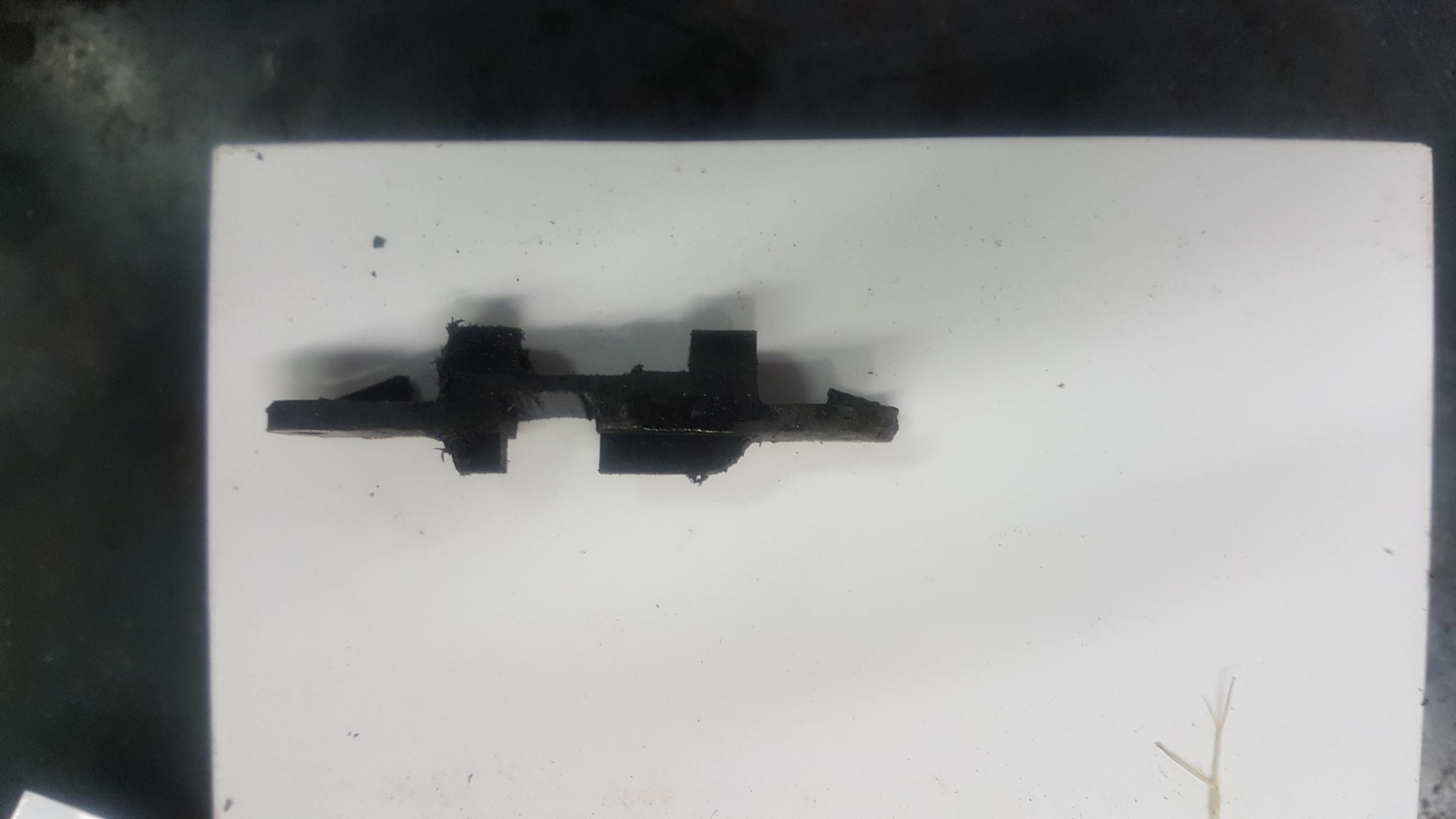

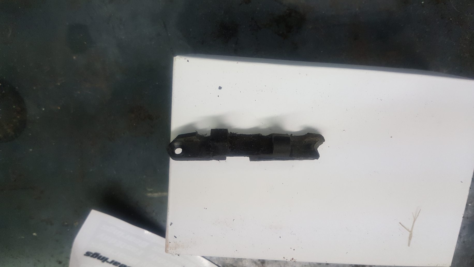

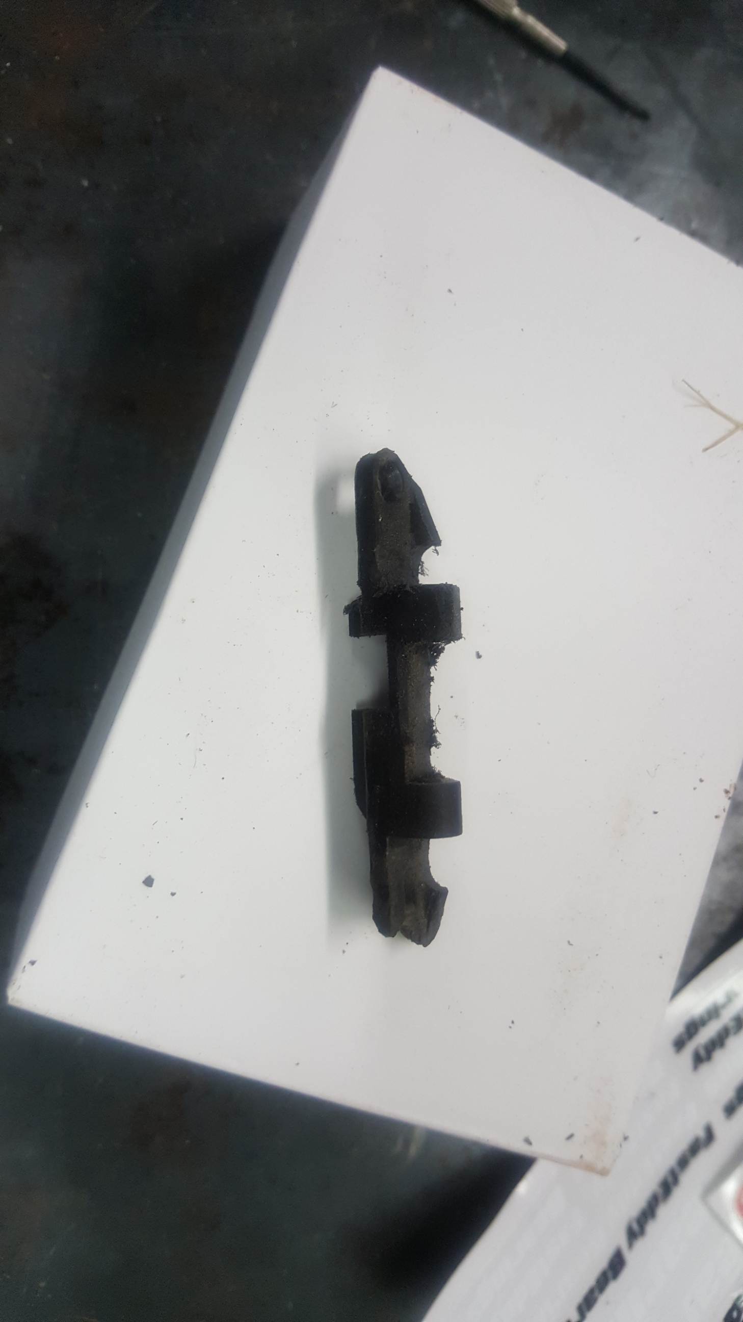

A few pictures of the cross brace the belt on yours runs over. On mine I ran the belt under that piece. I was wondering if you knew the number of belt to order for replacement, front and back? Also wondering if that part is something you can print out. Just curious but if so, I would like to have one.

My belt setup looks different from yours too but the same

Of course now I see the differences between yours and mine. I have 2 belts and you have one. Mine seems much more basic too. Yours looks like double a-arms up front. I ordered a pair of belts for mine and notice the front nerf,crash bumper is broken on mine just under and forward of the transfer gear. Why do I keep trying lol. It's cobbled but it was free many years ago so I tinker. Not quite the pile of parts you have on your table, well not even close. There was one of my type car for sale on ebay, 69 bucks, almost worth it for the spares. It has a carbon fiber frame like yours too.

Russ, your RS4 is the sport (1). Kracken’s is an original RS4 which has several differences. The RS4 sport is more closely related to the RS4 Pro (1). Your dual belt design is more efficient than the transmission and one belt. It can also take about any brushed motor setup. I used to run 7 turn motors and 7 cell batteries in my Pro2 chassis.
