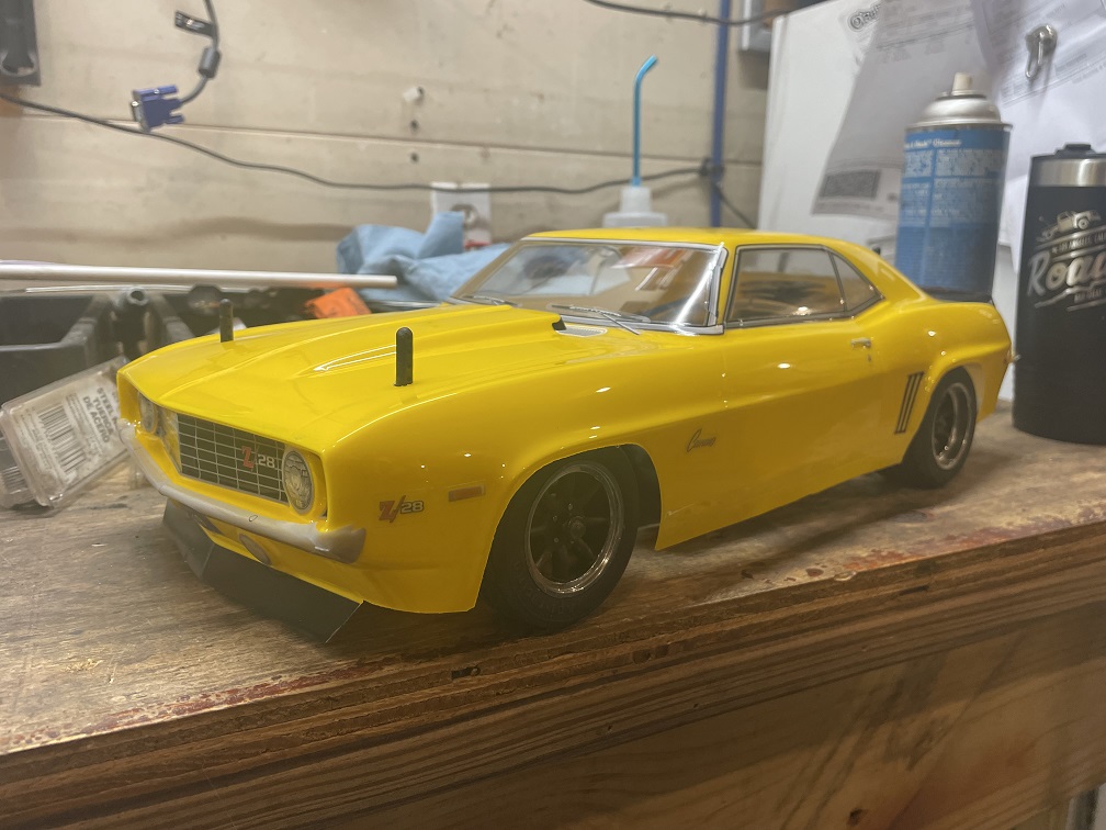

Anyway, decals aren't done and I have a different set of wheels yet but the car in question...

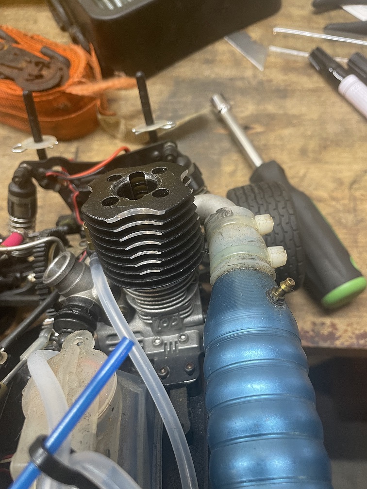

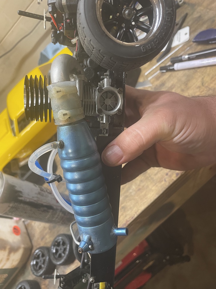

Here are a few pics of the engine, it does say TOP on the block as well... I took a glance at ebay and didn't see anything for it, but i haven't looked hard. I also haven't gotten around to messing with the starter box more yet either.

well, was happy to see the TOP as a Novarossi motor but that doesn't help you since all of mine are still non-pull start.
While Rusti's was in clinton I didn't have anything electric that I wanted to run. I wish I would've had my 10t up to specs to run with you guys but most of my time and effort went into my gt. I pry watched from the sidelines waiting for the batteries to die . My driving wasn't up to par on the narrow infield offroad so you're welcome . When we started the track in Fulton, the tri-oval was great for speed. The offroad when it was going in Fulton was nice but alot of work. Guess thats why its gone now. Delb jumps back and forth in is hobby stages and he just got too tired of it all.
Your DS looks great. I'm thinkin your best bet would be to work with your bump starters. I was thinking from your first post that it was a pullstart motor already. By the time you get the crank, backplate, bearings, pullstart you'll have more $ than buying a new motor with pullstart. Just my opinion though so take that with a grain of salt . What setup did you use for the hex conversion on your DS?

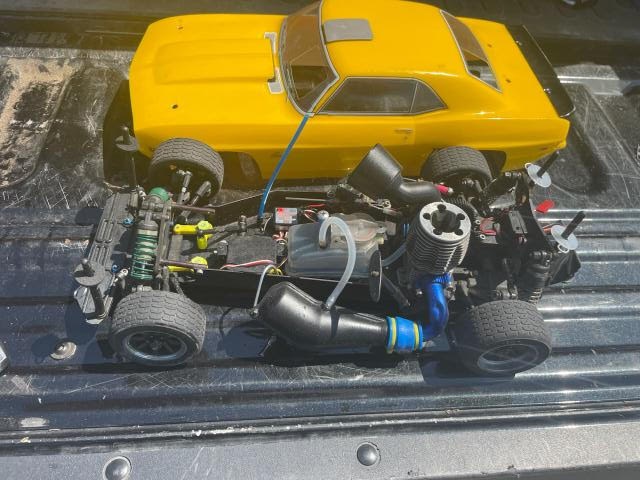

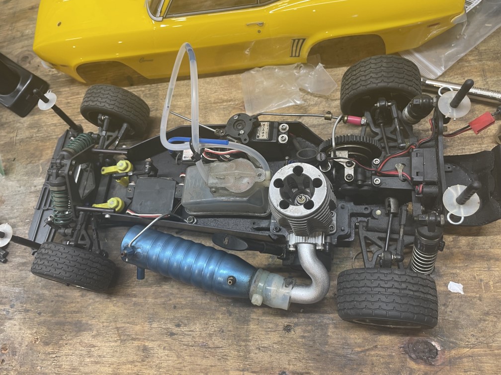

This project isn't dead, just adult life in the way as usual. Anyway, a friend had a traxxas 2.5 laying around so I have it in the car. Still working out the exhaust situation but getting there, this pic shows it with a Jato header which is all the way against the body.. I have a Rustler header coming for it that looks like it will tuck better, otherwise I will modify as needed. I do have an easy start sitting here as well and I honestly think it could work with a little rearranging of the fuel tank and receiver position but I'm just going with the pull start for now.
Re: Nitro RC10ds engine questions
This is the final setup. Rustler pipe and header, the exhaust blows under the chassis to the center.
The car is an animal to drive on the HPI Vintage tires, the Traxxas 2.5 is way to much for it, geared 24/58 and I feel like it is on par or faster than my Slayer Pro.
I have a set of normal low profile touring car tires I'm going to try on it, maybe then I can control it and stay in the throttle long enough to see how fast it is..
