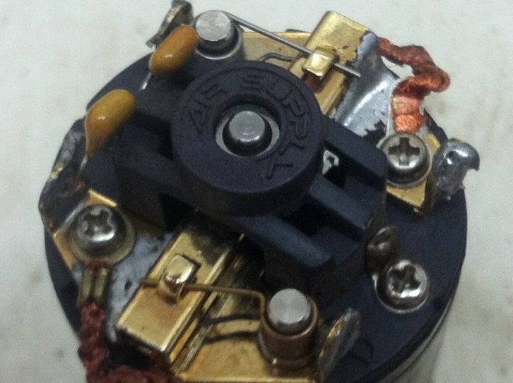

ok here are two motors are should i say one, and a cangomachv wrote:Didn't they have some endbells for slot car size brushes as well as full size? Or was it just a different hood with the same endbell?
And to clarify the composite endbells- they sold them with their oem motors to other "builders" to put their labels on? But did any "checkpoint" branded motors have a composite endbell or were all the true checkpoints aluminum? Last, did the composite endbells have any writing on them?
I think that covers farmers questions and my own too
as you can see the one on the right looks like reggies except no endbell or arm
on the left is the one i got off ebay
and you can see the difference, im assuming that this would have been a later model maybe the last batch before checkpoint went to the new brush style, or it was a hodgepodge of parts that where being used at the time
fazing out old stuff
the can on the new one does not have the texture on the can like the older can
the end bell is a composite
i wouldnt say that it is not a true checkpoint,such to say the early CE 10's where not do to the early mix match of left over parts
but a transition motor
the arm looks rite from all the Google search's i have done
well here are some pics
farmer

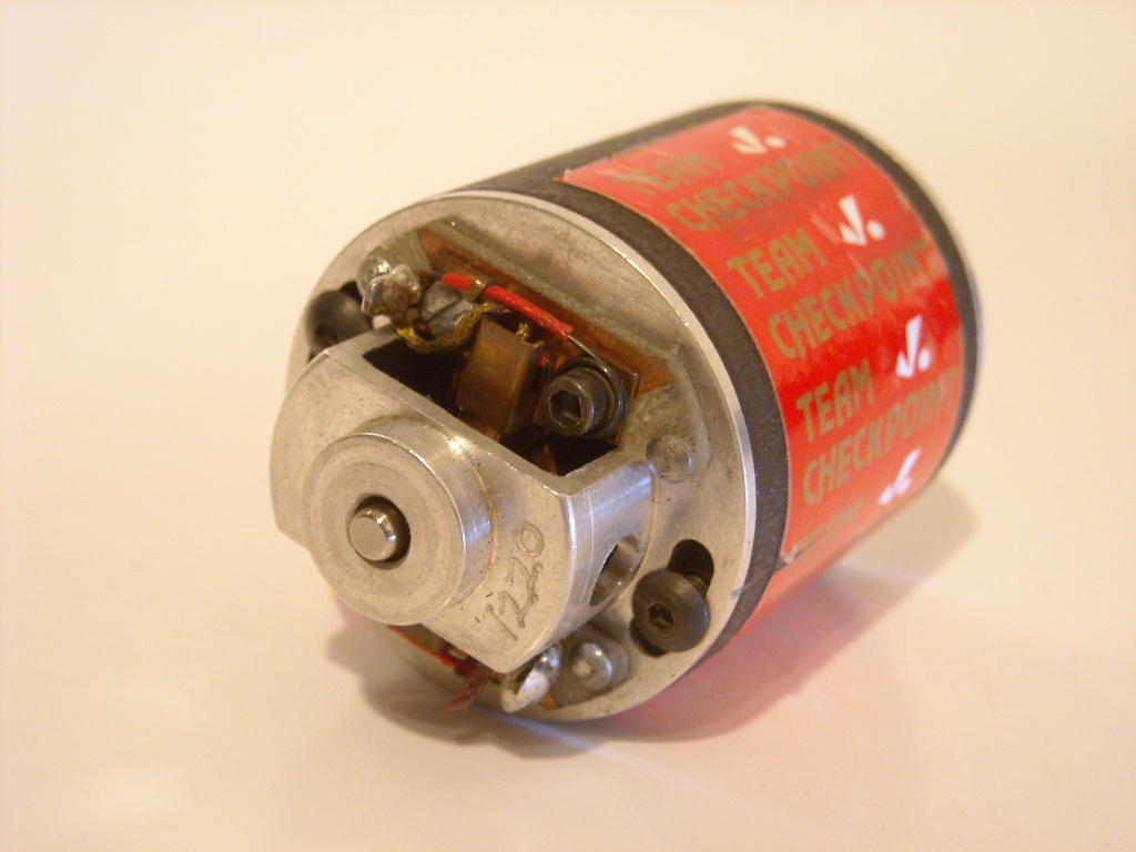

Talking about modified motors there had been roughly two lines of Checkpoint motors. The Platinum series motors using Big Jim´s own design can and aluminium endbell (as pictures checkpoint 004 or 008) and older motors using Igarashi or Yokomo cans (as picture checkpoint 005 or 006). Platinum motors were the only ones using aluminium endbell.
It is not the aluminium endbell but the small slot type brushes what is typical for Checkpoint motors. There had been also a few Checkpoint motors using standard brush assembly but most of them had been in the beginning of Checkpoint RC motors.
Motors with Platinum can but using standard brush assembly (as pictures checkpoint 011 or 012) are no real Checkpoint motors. Some of the Platinum cans were sold to Fantom for their top of the line motors but these were using standard brushes then, slot brushes were exclusively to Checkpoint.

Here's a late PII with silver vein or silver-vane finish on the can. Was the Vintage Electronics forum not around 10 years ago?
