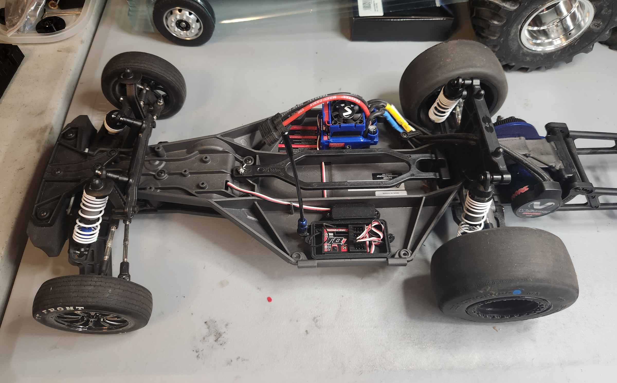

My meet on Saturday got rained out, so I couldn't be nosey in the pits. I am getting the front design (well, the first draft) figured out, and have some parts printing.
The rear is where I am all over the place. Belts aren't going to work on the smaller "gears" as I can't get small sprockets for the belt size that I think I am going to need. Just not enough teeth on the sprocket. So, I am going to have to use gears or chains, at least on the motor pinion. I am also looking at planetary setups to see if anything that I could use. There is a Dewalt drill in my shop that I have a feeling is going to be in pieces soon. Heck, I don't even know if I want to go direct drive, or some sort of diff. I have a contact with loads of Traxxas stuff, and he is going to send me a Sledge complete rear assembly, and I am going to see if I think that will work.
But the main problem I have is that I still have no idea where I want to be FDR or rollout wise. From just looking at pics, the direct drive setups seem to be in the 20-90-20-90 ballpark, so I am just randomly shooting for around 20:1 now. But again, that is a pure guess.
I did get an old school Parma body, so got that covered.
Looking at the frame more, I think the SWB semi frame is too short, so I got to looking at my unfinished Grand Hauler. I painted the chassis and a bunch of plastic on that a color that I ended up regretting, and I just stopped working on it because I hated the color so much. Well, this was my excuse to finally tear it down and start over. I ordered some new rails, and am going to use the old ones on the puller. They are too long, but I will cut to length at the end.
