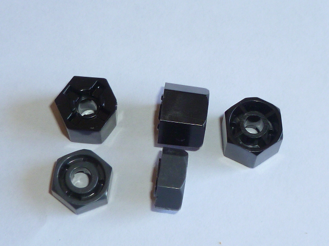

If it helps, most Tamiya TT01 kits come with an extra pair of wide plastic hexes, used for wide axles in the rear of some cars. The hex is about 10mm long / wide. Pics attached..... I have heaps, shame you're over there rather than hereCoelacanth wrote:The next minor challenge is to find a hex that's thick enough to reach from the cross-pins nearly to the end of the shaft where the threads start--approximately 10mm or more--before mounting a wheel, as that thick hex is needed to push out wheels enough that they won't rub on the chassis shock mount-plates.
