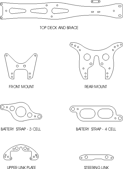

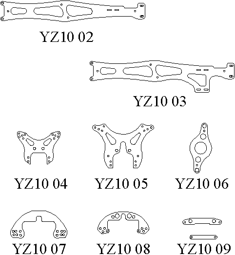

First thing I want to get are a new upper deck and left side battery hold retainer from Fiber Lyte. I'm pretty sure I know the parts I need, but hope someone can confirm I'm looking at the right parts.
This upper deck "Top Deck and Brace"
And this retainer "YZ10 06"
Can anyone with a Pavidis chassis confirm this for me? I'm Reasonably sure this is the top deck I need since its the only one with two of the central holes in the right orientation to match the Pavidis chassis. Mine came with the "YZ10 03" upper brace in the second image, but only one hole lined up. It also came with the "YZ10 04" and "YZ10 05" front and rear shock towers vs the correct towers in the first image, but I'm not terribly concerned with that right now.

The upper deck mounting are different for the YZ 10 and later Pavidis hence they don't line up. The fibrelyte parts are the correct parts for the Pavidis, the carbon is not an exact match to the Yokomo carbon but the quality is excellent. I think you can also get the towers made in 3mm if you intent to run her.
