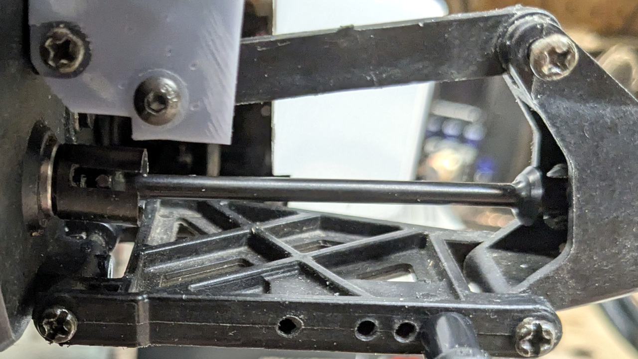

I have a few parts for my "Super Rocky" project and, recently, got a 3D printer of my own, so I was able to model and print the LA245 length axle and test fit them to a UM522-02 wheel shaft. I also printed a 1mm spacer. You can see, next to the gold universal, there's extra length:
https://drive.google.com/file/d/18Sis17pTcge4bn-Dc2Q6sVztbZMXhdGm/view?usp=sharing
Test fitting in the Rocky with an LAW30GM wheel hex, and you can see that there's interference. The rear will bolt together but bend the shaft when the suspension is compressed. The front won't even bolt together. *EDIT* BTW, on the rear I found a set of Tamiya outdrives that are VERY close to the Rocky/Raider outdrives. They're just a hair too long and will lock the rear. When I get further into this, I'll see if I can do some grinding to make sure they stay free.
https://drive.google.com/file/d/14lFsysaYU2o-E8mDlaNupuX43GTG2ohI/view?usp=sharing
https://drive.google.com/file/d/1i6cFF2Bfa02p2Yfa0ZcvnHBh67PPqI2-/view?usp=sharing
https://drive.google.com/file/d/12uD2D7-sKXceDQKWaTOJXtzCzSszqB54/view?usp=sharing
This picture doesn't really show it, but the center axle is printed in the 60.5mm LA258 length. It lets the front bolt together and move through the suspension stroke like the gold axle.
https://drive.google.com/file/d/1f7ho42kka3kzv1sisUO89LwcQi_floSe/view?usp=sharing
https://drive.google.com/file/d/13_HQmnxkQ-Y4dqO2CVjX5Yos1XGDyWYz/view?usp=sharing
https://drive.google.com/file/d/1DtfmZs0FmH-S50H02izEEKl68YV1Q1m3/view?usp=sharing

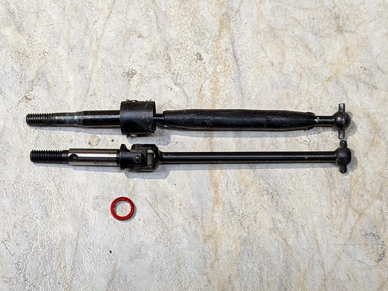

Here's the LA258 CV. I managed to get a couple from Japan on eBay, which wasn't the cheapest, unfortunately. But they've not been added to a kit in a while. I think I saw some for sale on Kyosho's Japan website, but that sells to Japan only, I believe. Next to the gold universal, you can see the difference in length is in the wheel shaft.
https://drive.google.com/file/d/1TxmTMVlZOkXmzSMqQsKf1Uv4snPWha7h/view?usp=sharing
https://drive.google.com/file/d/1Xv8XY9pbcIZwLiNcxCU6qFfoO7WMwjKy/view?usp=sharing

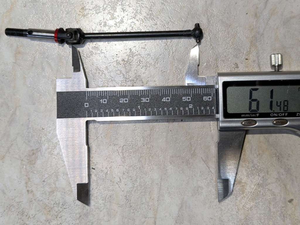

I assembled two of the axles with the UM522-02 wheel shaft and the 1mm spacer. Added to the front and rear they fit similarly and allow the suspension to fully compress
https://drive.google.com/file/d/1Fie-q5_j8NQh6dDAR2HPDDwotc8OfWoe/view?usp=sharing
https://drive.google.com/file/d/1iEFEbgzMEfGz3c0poPjrfNEctSqsp7oX/view?usp=sharing
https://drive.google.com/file/d/1EGoB713RUziA6u4wFsQoU1EwUQZhiwAh/view?usp=sharing

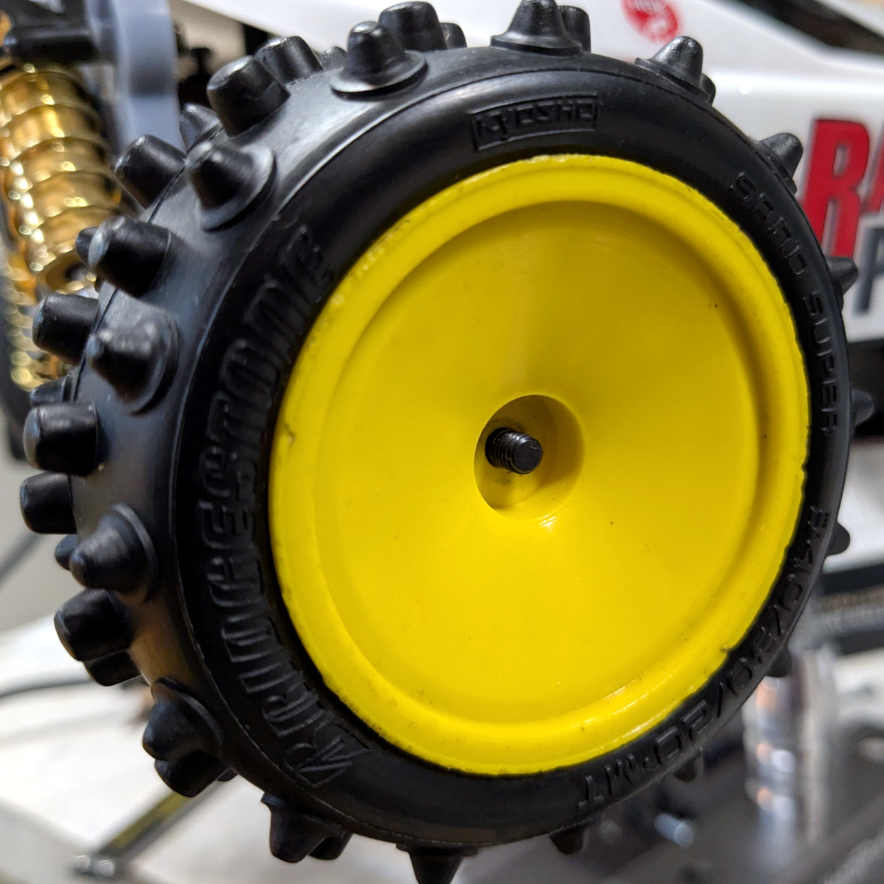

The drawback to using this is the wheel shaft is too short for the original Rocky wheel, which has a thicker hub. I'm using an old set of HPI wheels that have a much thinner hub and will leave room for a locking nut. I tried using a TTFW113 wheel hub, which is .5mm narrower than the LAW30, but that didn't give enough thread to get a locking nut full on with the Rocky wheels.
https://drive.google.com/file/d/15hWSgO7TREwUxN8O_eRGaE-Okv9yWD5P/view?usp=sharing
https://drive.google.com/file/d/1IODDi3nVaQWBuk0KMmXdBMpvRgU2DhxI/view?usp=sharing

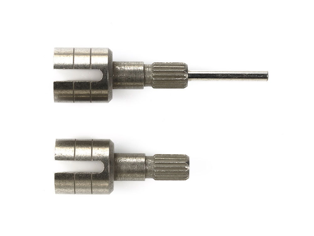

Found an easier solution for the rocky, ran the 3racing universals for the optima ( very reasonably priced) and swapped out the M10 x 5 x4 mm bearings for M10x5x3mm, gives 2mm of wiggle room and they fitted nice with some shimming.
Also the Tamiya hard outdrives splines fit right up to the factory diffs and easy to source

As cas22 mentioned above and verified: the Tamiya outdrives, part number OP-218, can be substituted for the RK-21 outdrives.
When I first put mine together before making the CV post, I noticed a slight binding as it felt like a spline would catch something, but it's not an issue now. I've done some running and they seem like they MIGHT be more durable than the RK-21's. What's also nice is the center shaft is pressed into one side so you won't lose it if a dogbone pops out, and they're substantially cheaper than what people were last asking for the RK-21. The downside is they're for a discontinued kit so I'm not sure what the supply is like out there.
Thanks, cas, for taking the risk and verifying that.

Has anyone noticed that "universal" swing shaft OTW125C for the rere Optima kits practically drop right into the Raider? Sorry for the cross post, but I thought it might be relevant here.
You have to leave the red shim out, as it is slightly too thick. A small about of shimming is needed/available to dial-in the engagement. This is what I get with it shimmed on the outside of the bearings:
With the Optima hex adapters, there is just enough shaft to accommodate the stock Raider Pro rims:

Is this the same application that the 3Racing part Cas22 found also fill?
I think the 3Racing part isn't available anymore, so that universal is probably the only readily available option.
Any chance you're able to measure the length of the axle section from pin to pin?
