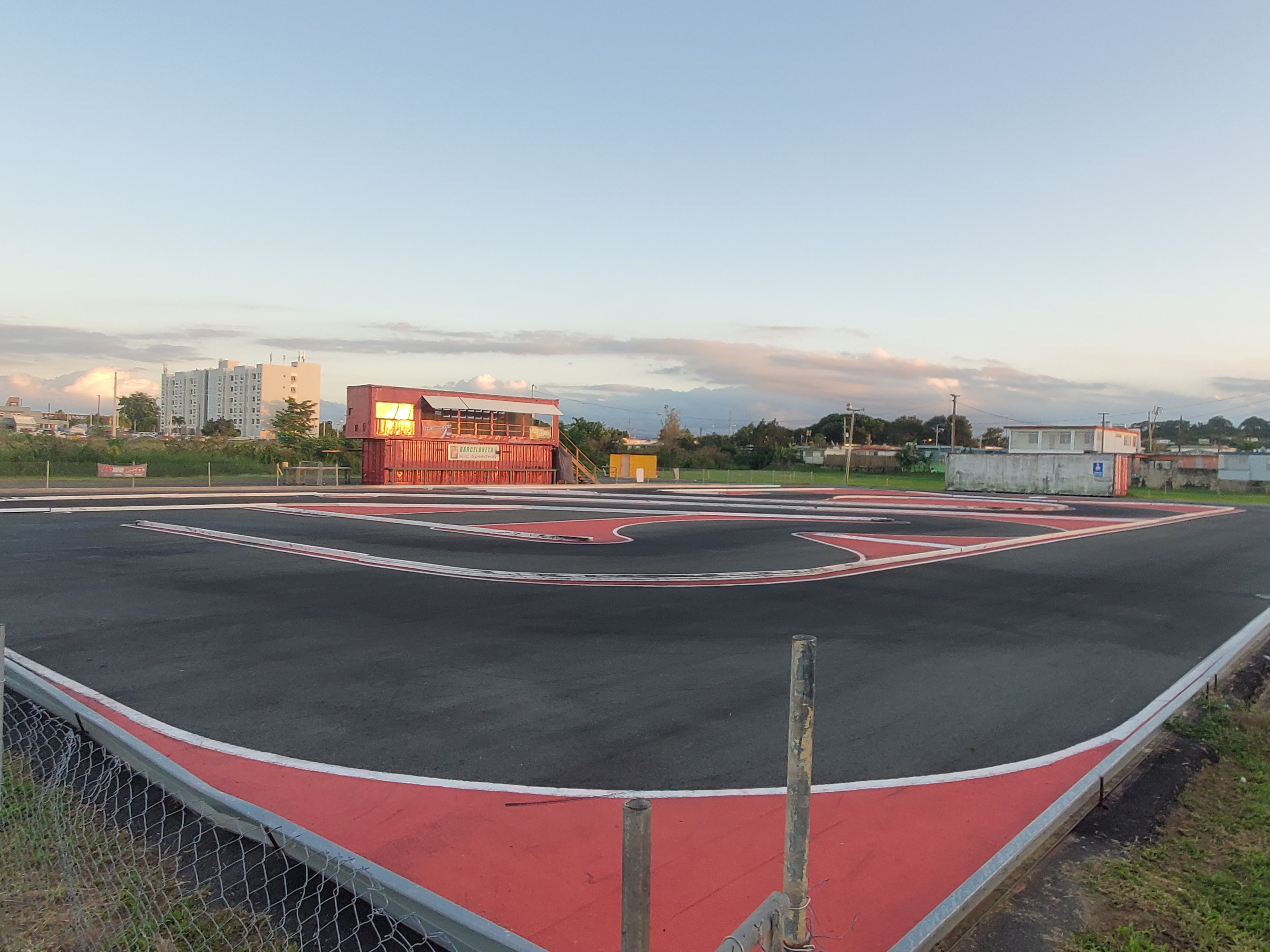

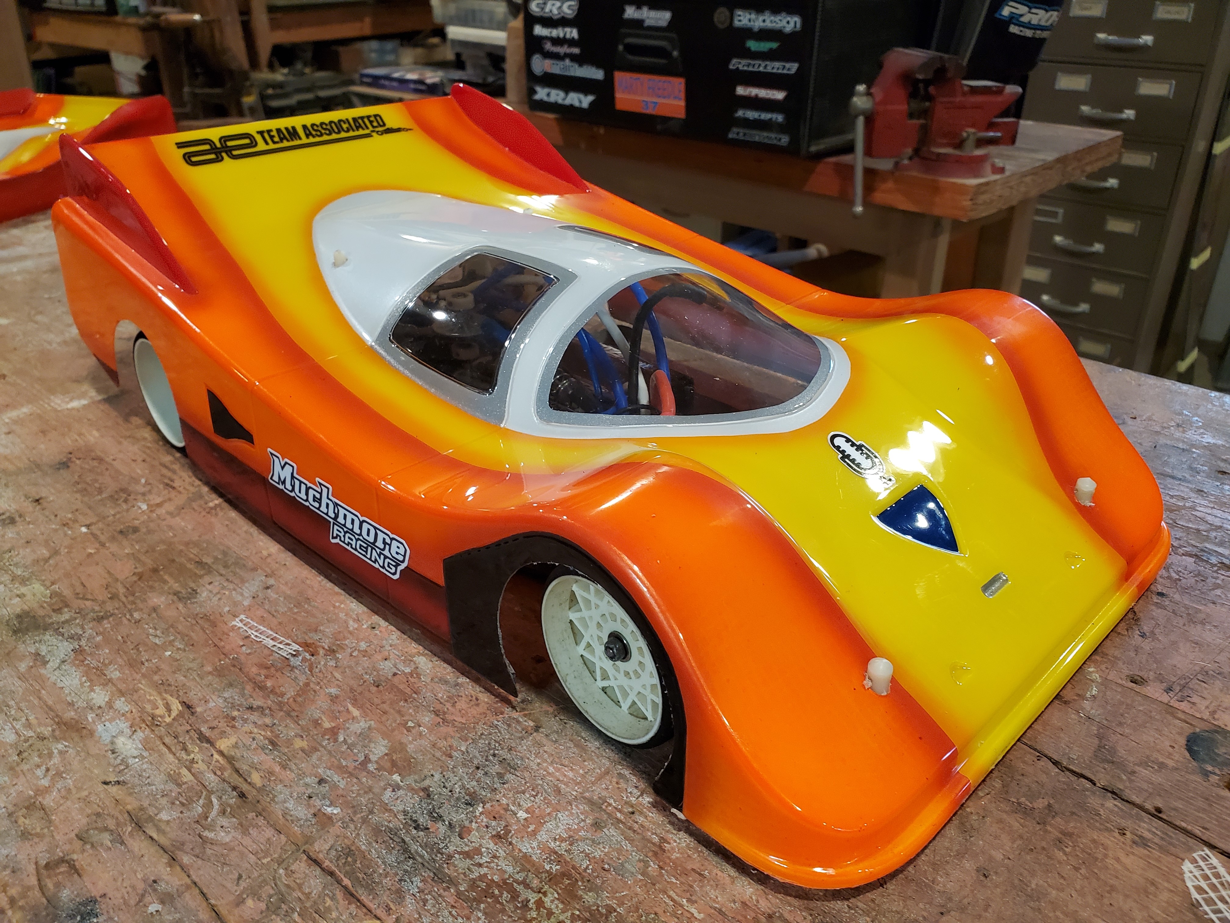

well, a dream finally came true-- got to race a my 10LS. Since I first saw pancars in Competition Plus BITD, I have always dreamed of running one of these.
Picked up a re-pop Bolink(?) body, slapped in a 10.5, 2S setup, and bought some BSR tires for it.

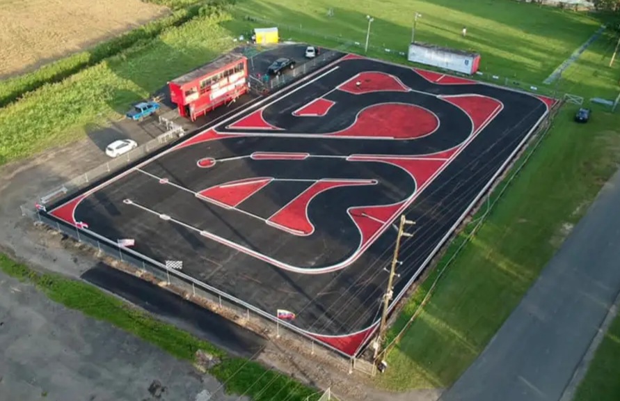

This was at Barceloneta RC Complex in Barceloneta, PR. It is a beautiful track-- get there if you can!
This thing was fast and fun. I was able to do the same laptimes as the 200mm Nitro Sedans.
I took some time to set it up-- using what I have learned from 12th scale carpet racing. IT was great from the first lap. Rand BSR pinks in the rear and Purples in the front

Barceloneta (BRCC)
200 x 125

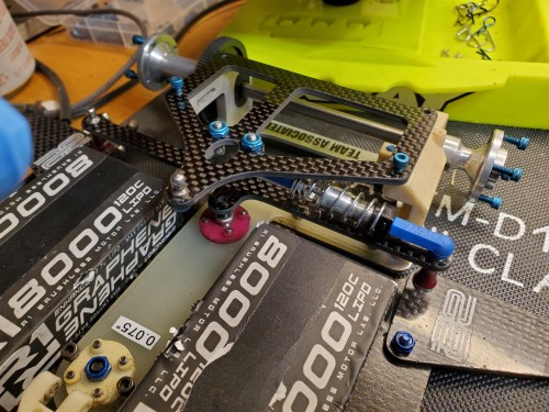

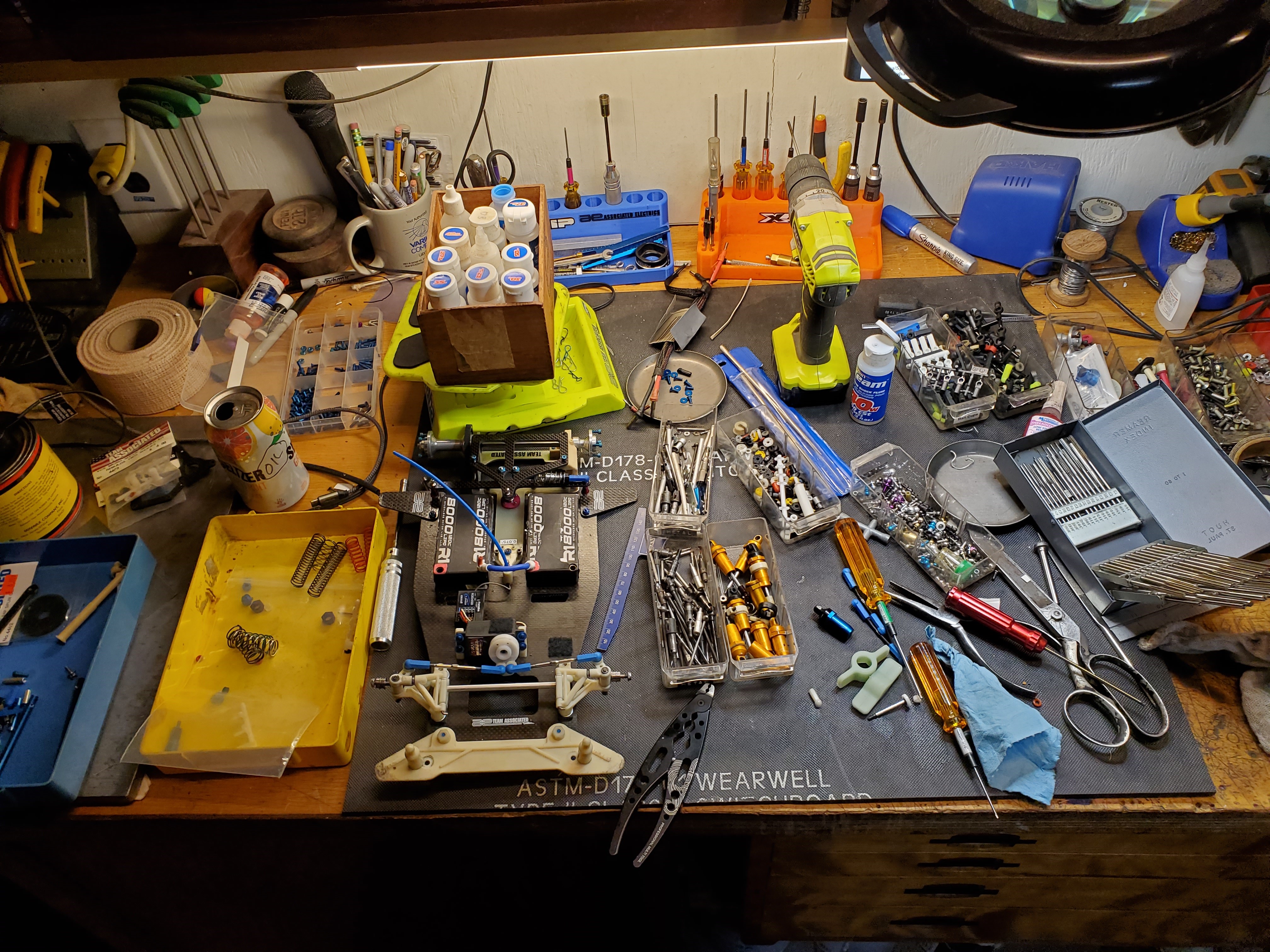

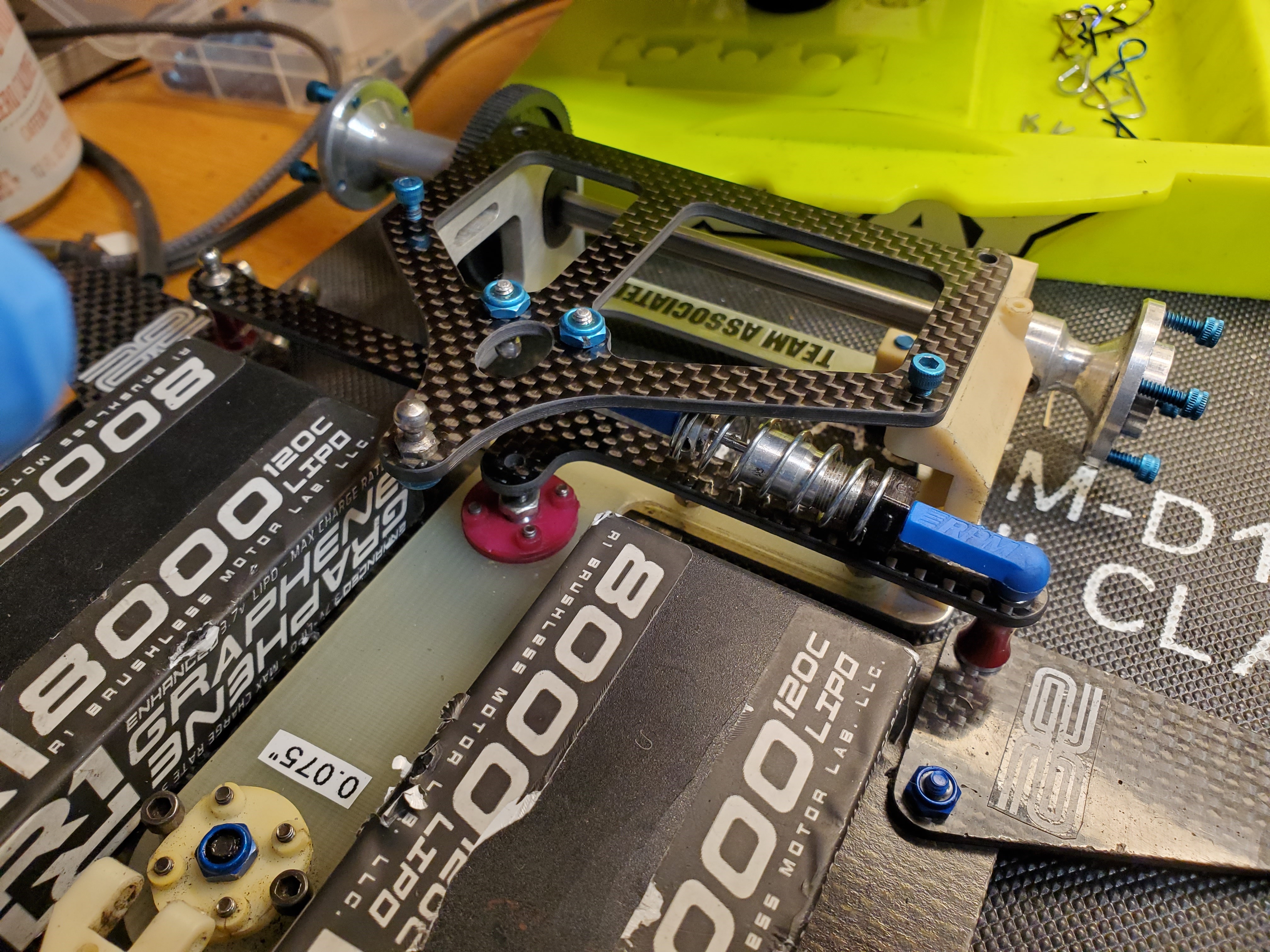

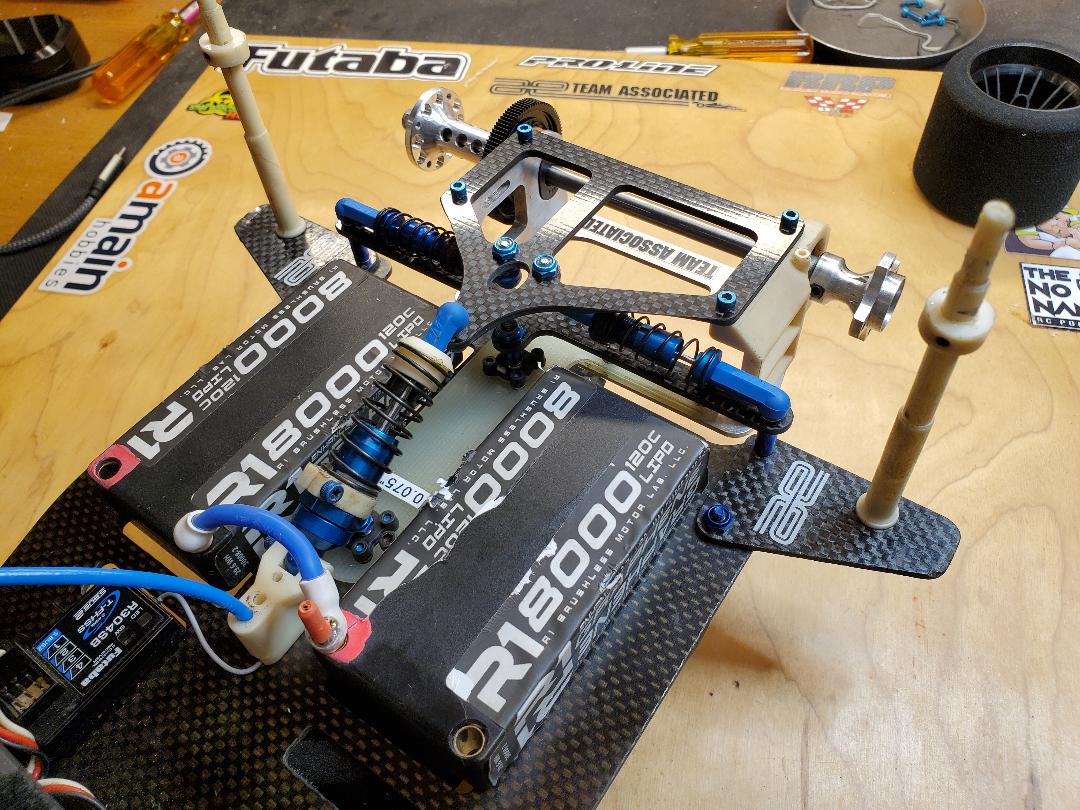

going full Pro10 with this-- adding AE Macro side shocks and a TC center shock.
Drew up a new pod plate and Factory Works had it to me in two days! Check them out for OEM replacement parts they stock or a good price on your own custom designs.
Gotta love the mess.
gonna run 1S saddle packs and a Hobbywing Justock 10.5 combo

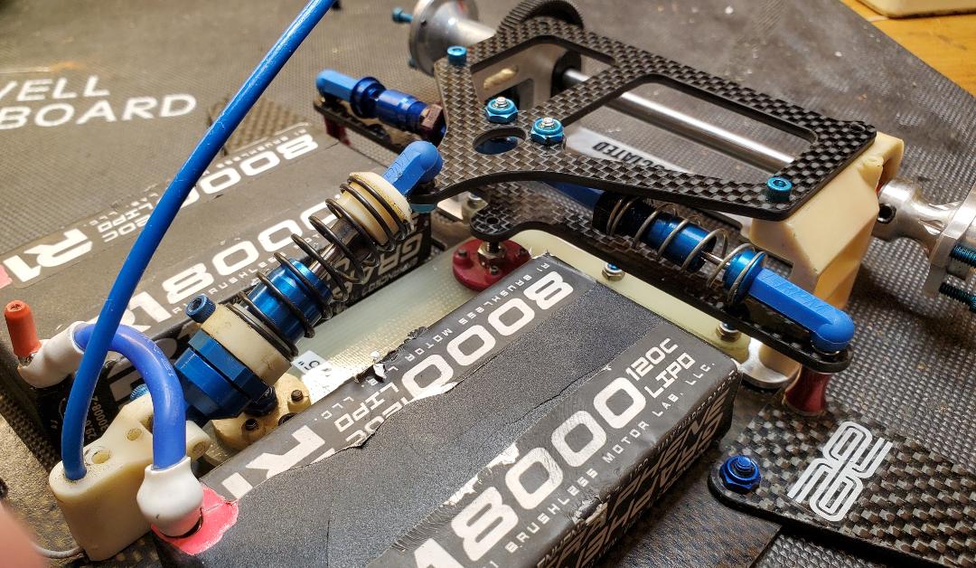

furthering my blue anno obsession, I found a TC3 shock and blue VCS for the sides. Waiting on springs
10l pod w side shocks

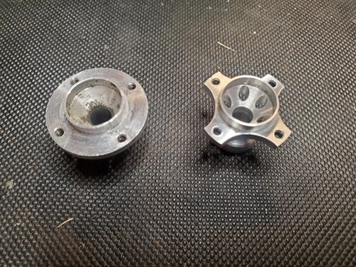

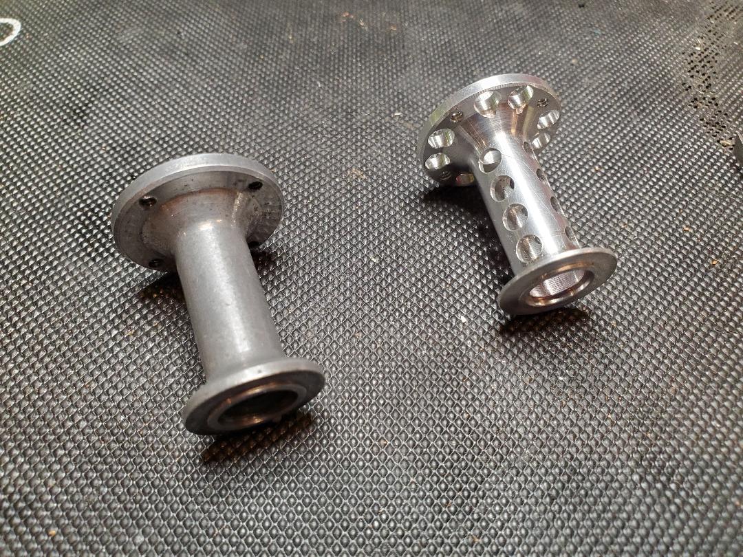

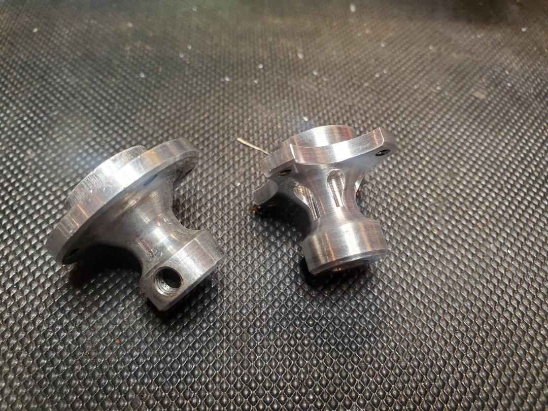

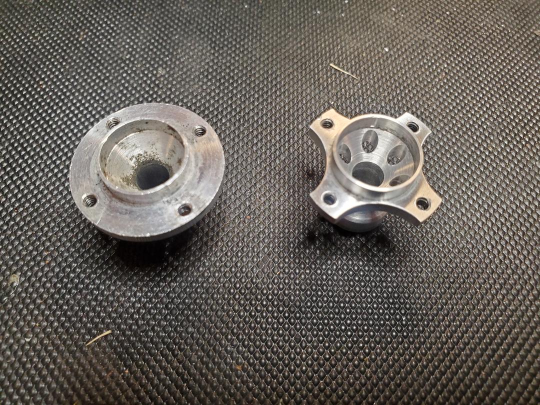

looking to loose a little of the weight being added, I took about 3g out of a spare left rear hub. I have a lightened diff hub on the way that I plan to do the same to.

lightened diff hub
lightened diff hub
Got a lightened diff hub on Ebay-- (there are a few left!) The seller told me this is a Factory Team (before FT was a brand) piece that was given out to Team drives BITD.
It shaves off about 4G

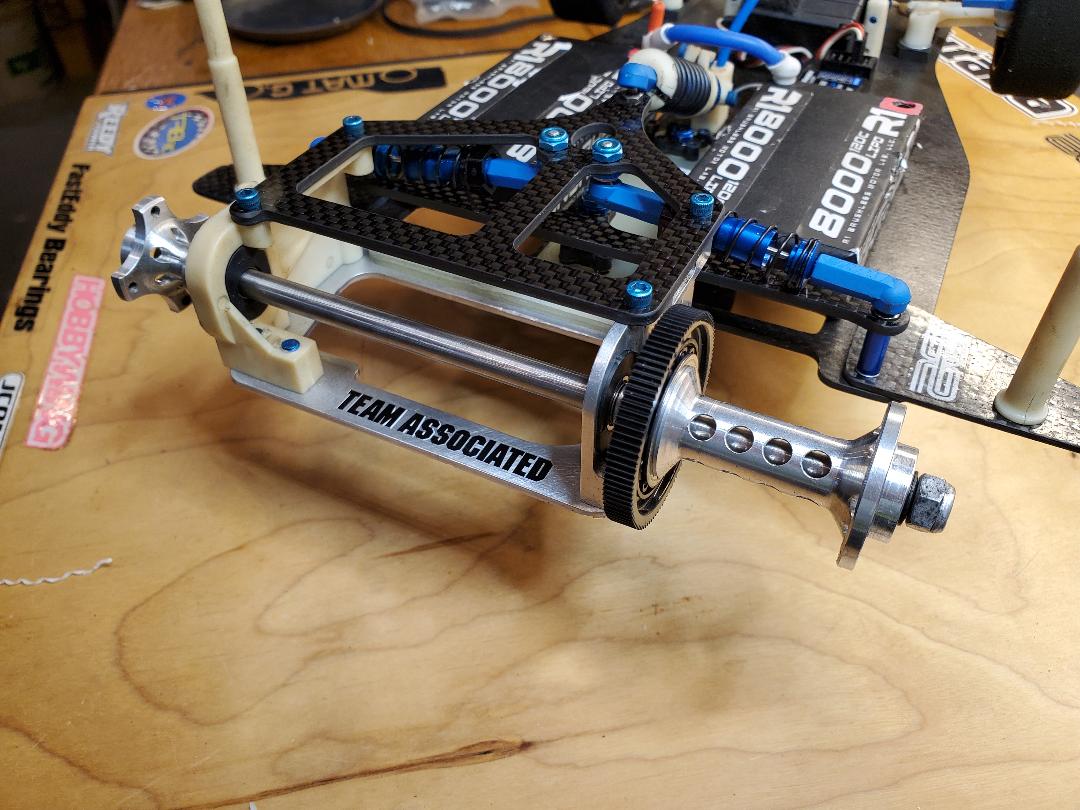

titanium axle with lightened hubs and new Kimbrough gear with ceramic balls-- wow are those things smooth!
rear axle in
rear axle in
picked up a set of Teflon pivot balls and new retainers from Lefthander Racing -- looking clean
Had to relocate the rear body mounts -- thankfully I had these tall ones in the parts bin

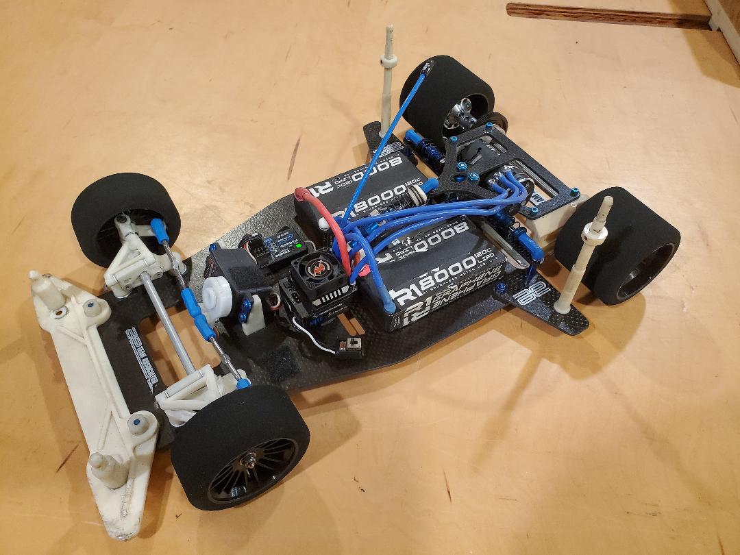

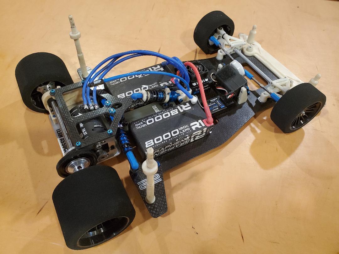

The Newest Hobbywing Justock 10.5 combo came in last week--
Got it all together and ready for some track time this weekend.
The 14ga motor leads got warm from a few runs up & down the street-- have some 12ga on the way.
