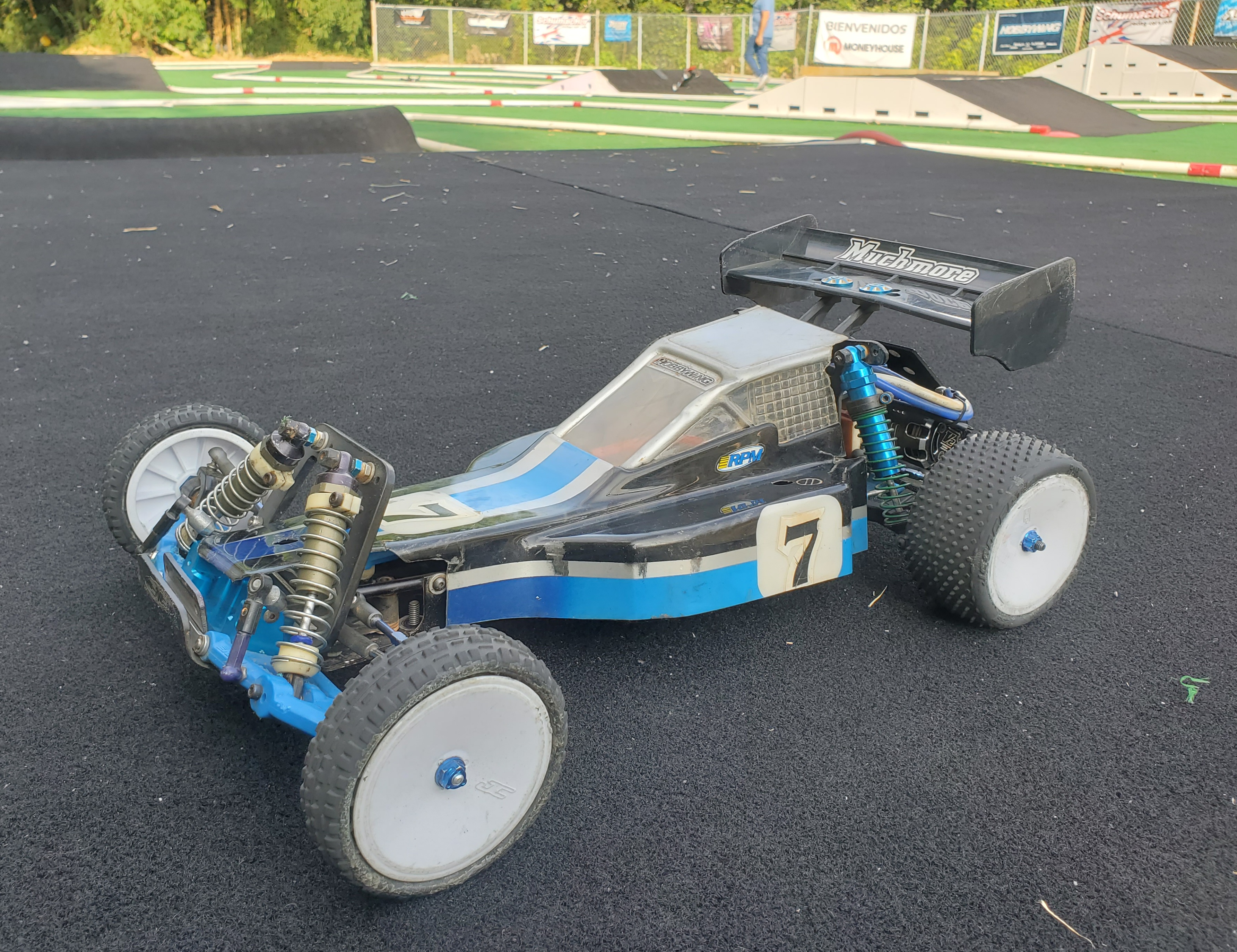

Took it racing this past weekend. TQ'd the 2nd quali, started 2nd in the main , but ran out of tires and talent. My podium mates drove impeccably, to boot.
Had a blast racing it, for the first time.
Need to build some adjustability into the suspension.

If using the GT/DS servo saver with the nose plate in the long wheelbase configuration, you should attach the bellcranks/servo saver to the front holes (you might have to tap them, 8-32). Then use 1/4" (100*) screws to attach the nose plate to the chassis.

juicedcoupe wrote: Thu Sep 05, 2024 11:18 am If using the GT/DS servo saver with the nose plate in the long wheelbase configuration, you should attach the bellcranks/servo saver to the front holes (you might have to tap them, 8-32). Then use 1/4" (100*) screws to attach the nose plate to the chassis.
ahhh-- this will probably improve the steering geometry significantly. thank you!

Had this buggy and the B44.3 out at a friend's backyard clay track this weekend. Making the triple was not possible with this car, but the double was doable, sometimes. Had a blast.
The 8T motor is playing havoc with the ball diff- my slipper must be too tight or I just haven't set the diff correctly. It's all kinds of gritty, with new ceramic balls.

The factory nylon front block was not able to retain the shock tower screws.
Went with the blue aluminum DHawk front block to support the 4mm front shock tower.

Tore the diff down - the new ceramic balls and rings were trashed. Honed the rings smooth & flat and installed some new AE carbide balls I happened to have.
Now, I have been running these cars for over 30 years, but I am embarrassed to admit I never really knew how to properly set up a ball diff. Usually just tightened it down and sent it.
Just watched Spencer Rivkin's videos on ball diff and slipper setup - made a huge improvement and took the guesswork out of the process.

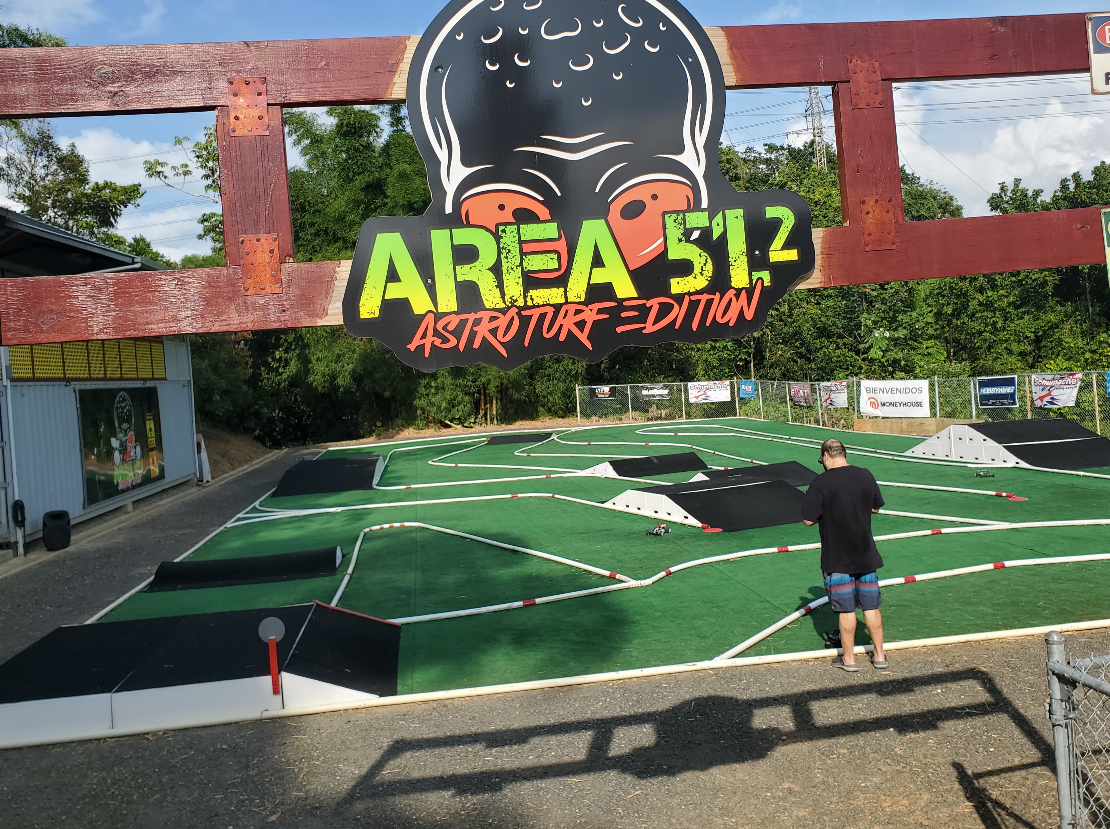

Took it with me to Cidra, Puerto Rico and attended the new layout practice-day at Area 51.2- Outdoor turf track. What an amazing facility!
Threw on a set of Schumacher carpet tires and it did surprisingly well. Put alteast 6 packs through it.
Video of the facility:
https://youtube.com/shorts/bLmkfRwi8h4?si=i8FRPVp2LnU51PKF
