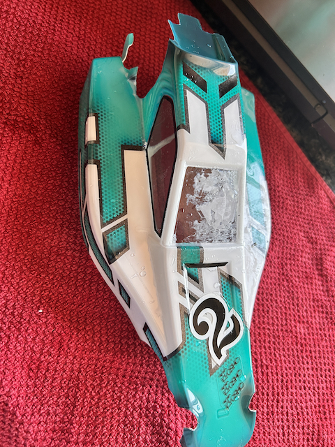

Since I got so much help here last time, I'm going to ask for just a little more...
Since this debacle, the build has gotten a lot better ... actually almost finished (yeah, I know, my average build-time is probably 3-4 months ... I think my ADD gets me & I do just a little at a time, which is clearly not the right way to do it. Anyway, I got the body painted by a pro, and it came out great. Unfortunately due to a miscommunication about the decals, I wound up trying to remove them. I used the wrong type of Goo-Gone, and ruined it. He graciously offered to paint me another one gratis, and I'm shopping around for a replacement.
Before I spend the $50, I was wondering if anyone had some tips on how to get this residue off, if it's even possible. I've tried brake fluid, lighter fluid, dish soap...only seems to be getting worse. Any other ideas?
Thanks.
Thanks.

Cool paint job!
Is the residue sticky? Sometimes a piece of sticky tape on top of adhesive can be used to remove adhesive. A little bit of vegetable oil on a paper towel can also break up some adhesives.

Hmm..I'll try those ... I worry it might actually be damage to the lexan & not even adhesive anymore; the decals intended were removed .. thanksFrankentruck wrote: ↑Tue Oct 08, 2024 4:45 pm Cool paint job!

If it's lexan damage and it's on the outside, maybe some light wet sanding with 1000 grit sandpaper and then wax/polish?

That won't work out well... I've tried sanding bodies like that & just made it much worse. I ordered a new body. I think it'll just be a spare. Maybe I can paint the front window black & cover that part.

I've buffed sanded plexiglass before and it came out nice and glossy, but there wasn't a painted area near it.

If it's just sticker residue, I've always used WD-40 to remove that stuff; just wet it down with WD-40 and let it sit a few minutes, then wipe. It may need a few applications but won't harm paint or Lexan.
That residue however almost looks like silicone or caulk. If that's the case, good luck trying to remove it without damaging the Lexan...
