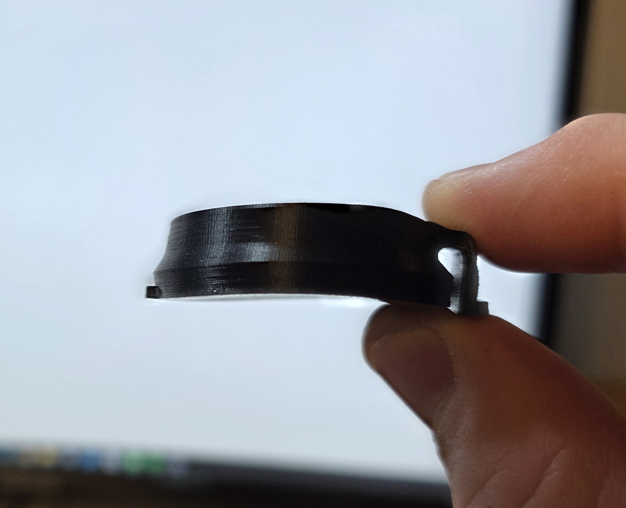

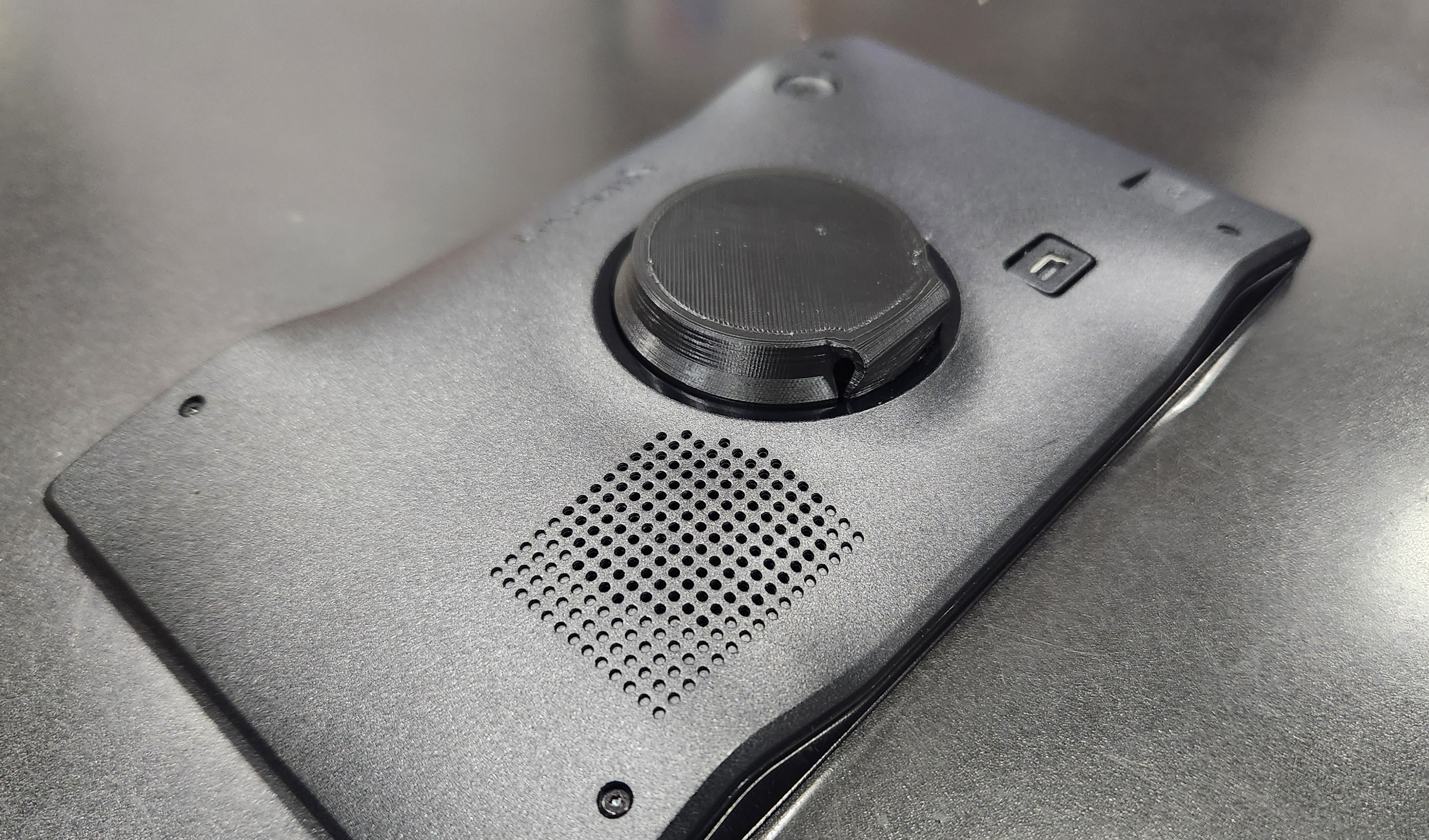

I have never had an issue with PLA reacting to heat as so many others claim to have had. I have plenty of PLA parts on my RCs, and just random other things in life that exist in a world usually under 100*F, and haven't had any issues. But with highs in the 97-99*F range the past few days, the interior of a car is apparently hot enough to majorly distort PLA. :? This a mount adapter I had on my GPS, and it was perfectly flat a few days ago. Post and pre pic.
