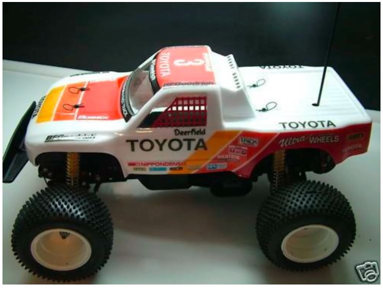

Re: Outlaw Ultima truck purchase – my very first ST
Looking at sandkil's truck, it looks like the body sits really high on these. So your options are probably pretty open for bodies.
https://www.rc10talk.com/viewtopic.php?t=31302
It looks like Team Bluegroove has replacement bodies and MCI has the decals and window masks. You can also do a combined shipping deal with them.

Yeah, I think you’re right about that. Just about any brand ST body will probably set atop those shock towers and look okay.juicedcoupe wrote: ↑Fri Jul 30, 2021 6:04 pm Looking at sandkil's truck, it looks like the body sits really high on these. So your options are probably pretty open for bodies.
As you know from my posts on your Stadium Blitzer build, I was considering that truck’s body for this build however I’ve found the issue with it and other ST brands is the wheelbase. I hadn’t noticed this before but most, if not all of Tamiya’s ST’s are around 250mm wheelbase while this version of the Ultima is 270mm. Sometimes when mounting the body, you can fudge a little each way and disguise a mismatched wb but 20mm’s is probably too much to hide. I could fabricate a shorter chassis for the Ultima to match the Tamiya body but I think we’re drifting too far away from the original truck. Also, reducing the wb will affect handling and I just don’t want to go there. It’s a Kyosho Outlaw Ultima after all, and I should be content with that – and I am.
So, the plan now is to rebuild the chassis, refurbish the body to make it acceptable and then just go out and have fun with the truck. That’s what they’re for, right? I really don’t want this truck to become another shelfer so I probably won’t order a new body – at least not anytime soon. Meanwhile, I’ll be looking for a suitable Stadium Blitzer project to buy and that will become my second stadium truck.
Regarding the TBG/MCI combo shipping. I have two Optima Mid bodies and decal sets currently in the post coming from TBG/MCI and I did take advantage of their new combined shipping. In the end, I think it saved me around 70 cents in total. The reason the savings were so little is they charged me sales tax for the decal order going from MCI to TBG and ultimately this was around 70 cents less than if MCI had sent the decals direct to me. After placing the order, I tried entering the same order except without combo shipping and noted that apparently, they don’t charge sales tax for orders shipped to the US. I hadn’t noticed this before. Also, TBG charges one dollar for the combo shipping service. Anyway, I’m not sure if I will use the combo shipping again but I very much appreciate that they are trying to save their customers money and I hope others will take advantage of this feature if it does in fact save them some coin.

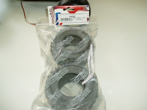

Thanks again for the tire recommendation.
I've found these tires for the best price at Dollar Hobbyz so I have a pair on order.
Curiously, Schumacher and their retailers list this tire (U6502) as a "front tire" but I reckon it's the same dimensions as other rear tires so it should work just fine on the back.
Anyway, they should arrive in a few days.

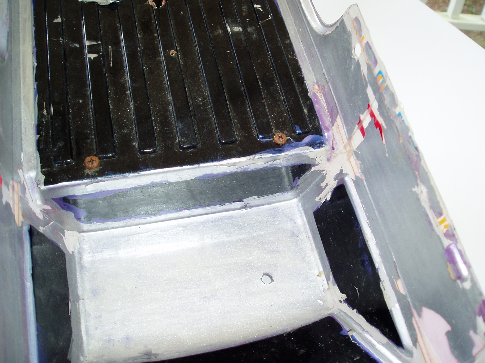

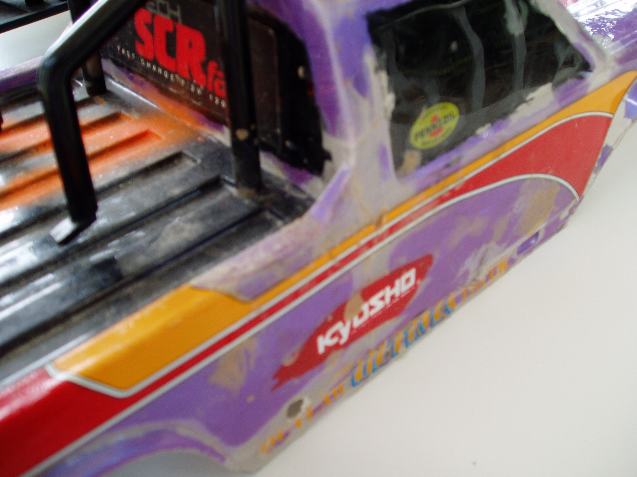

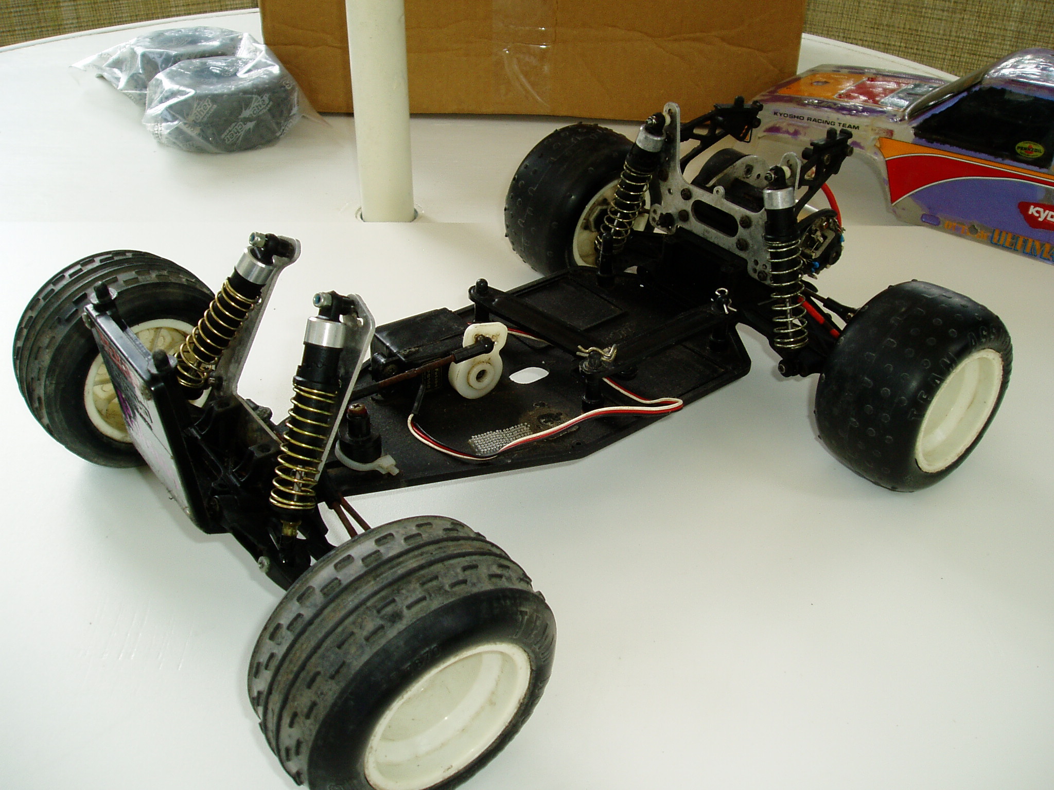

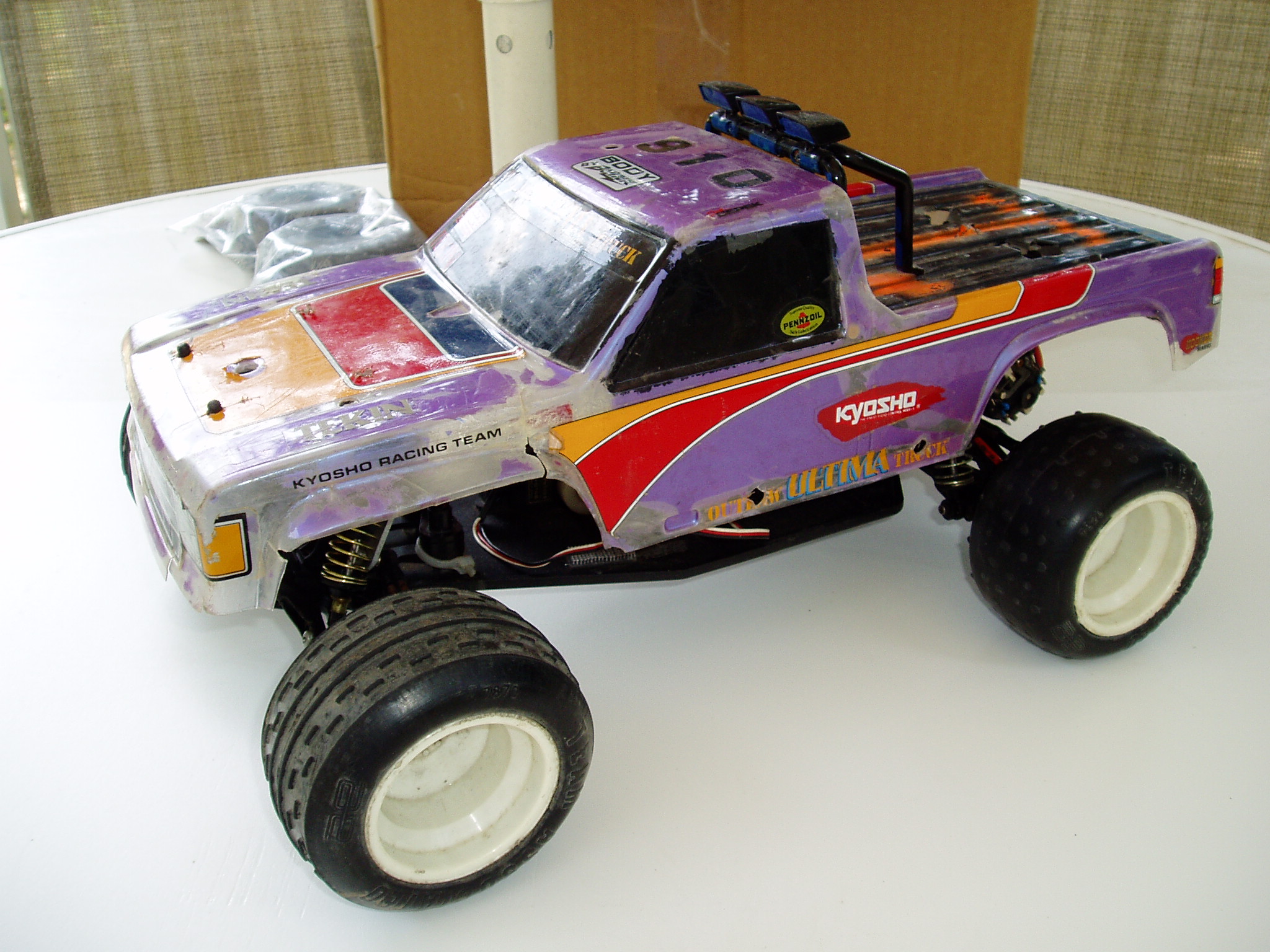

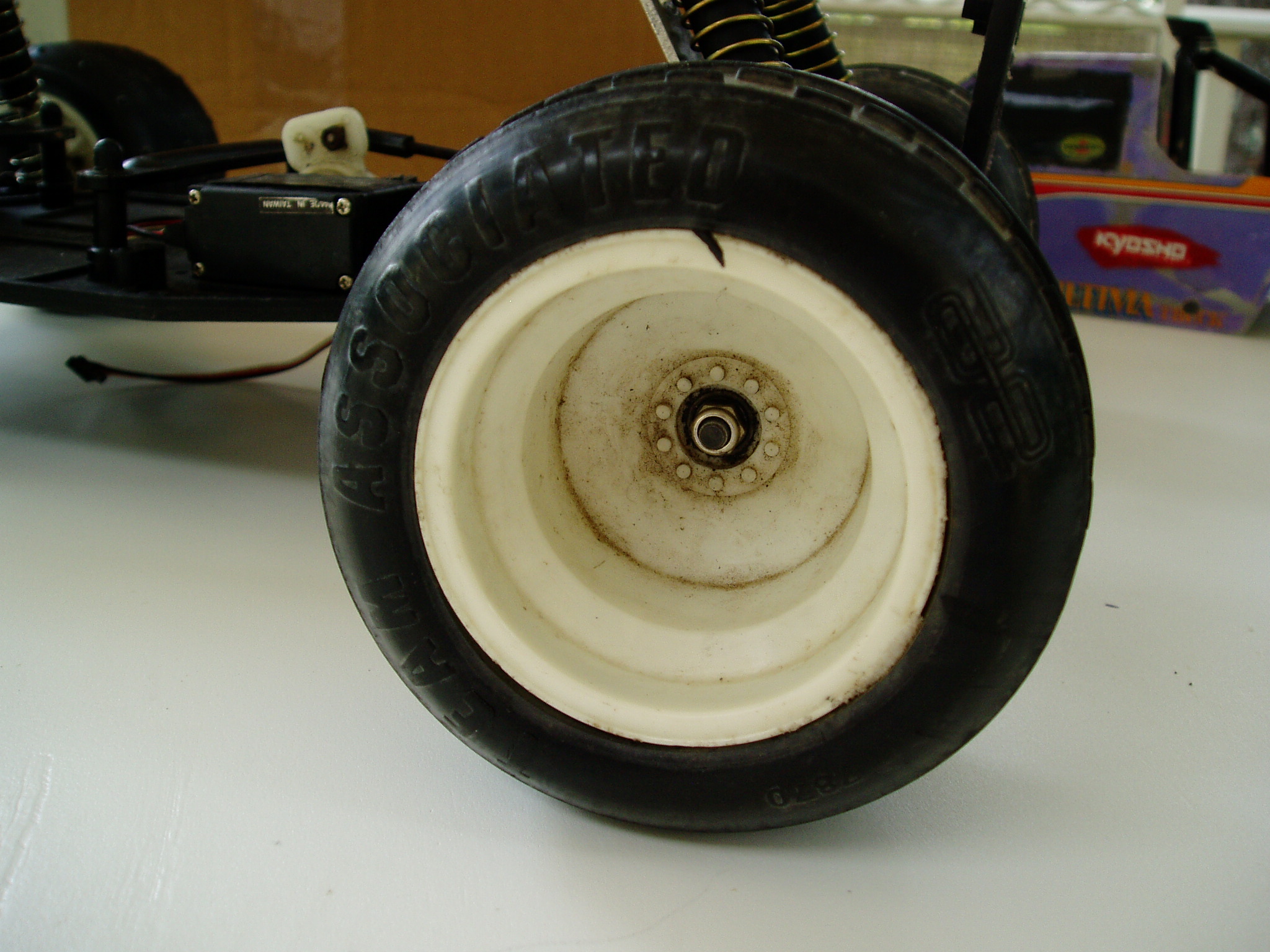

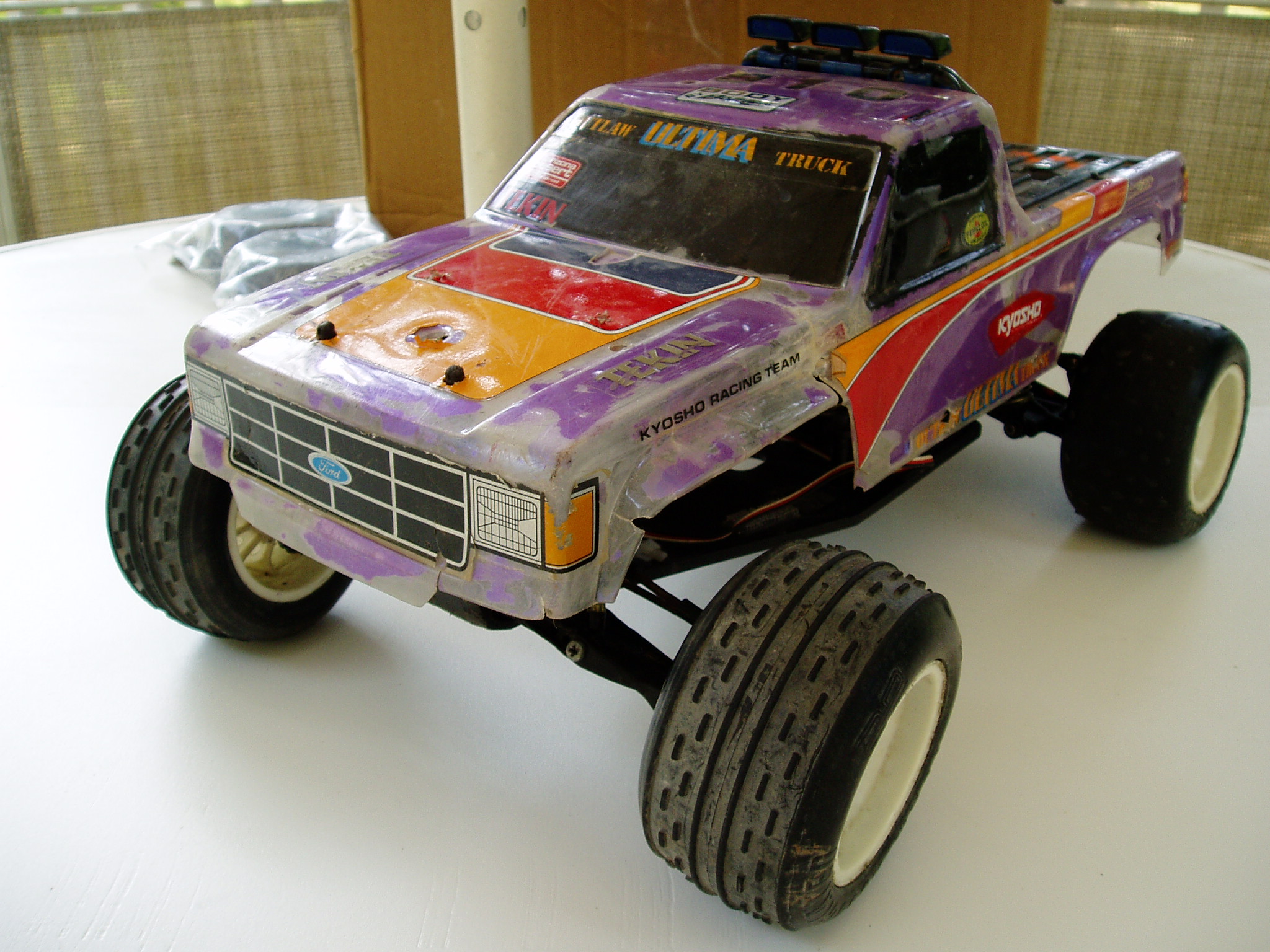

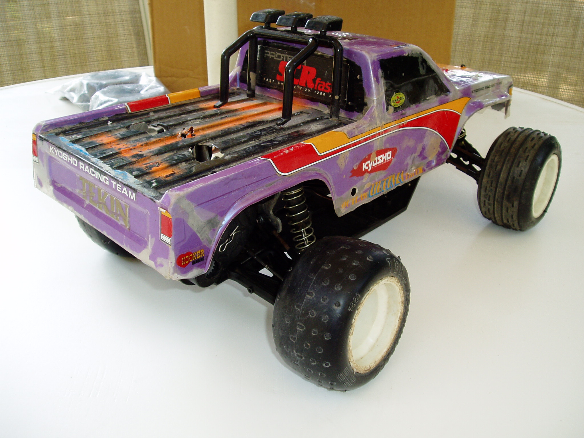

The truck just arrived and here are some photos straight out of the box.
Believe it or not, in these photos, the truck appears to be in better shape than it actually is.

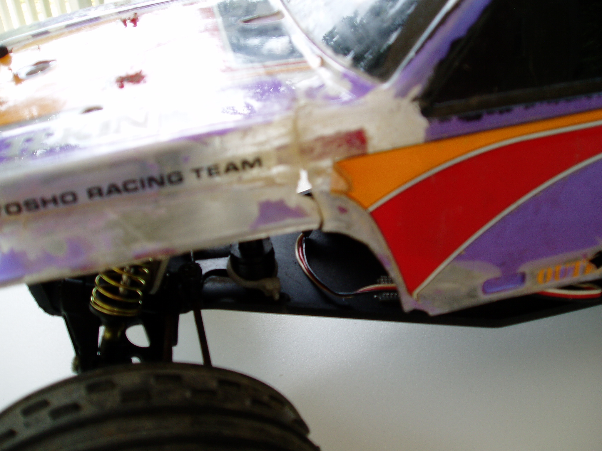

I guess we'll start with the body - it's very bad. I'll use drywall tape and shoe-goo to reinforce the breaks and patch the holes, then mask most of the decals before repainting it on the outside. Many of the decals with text will need to be removed before painting and I won't be replacing those. Some might be happy to learn that I'm not going back to purple.

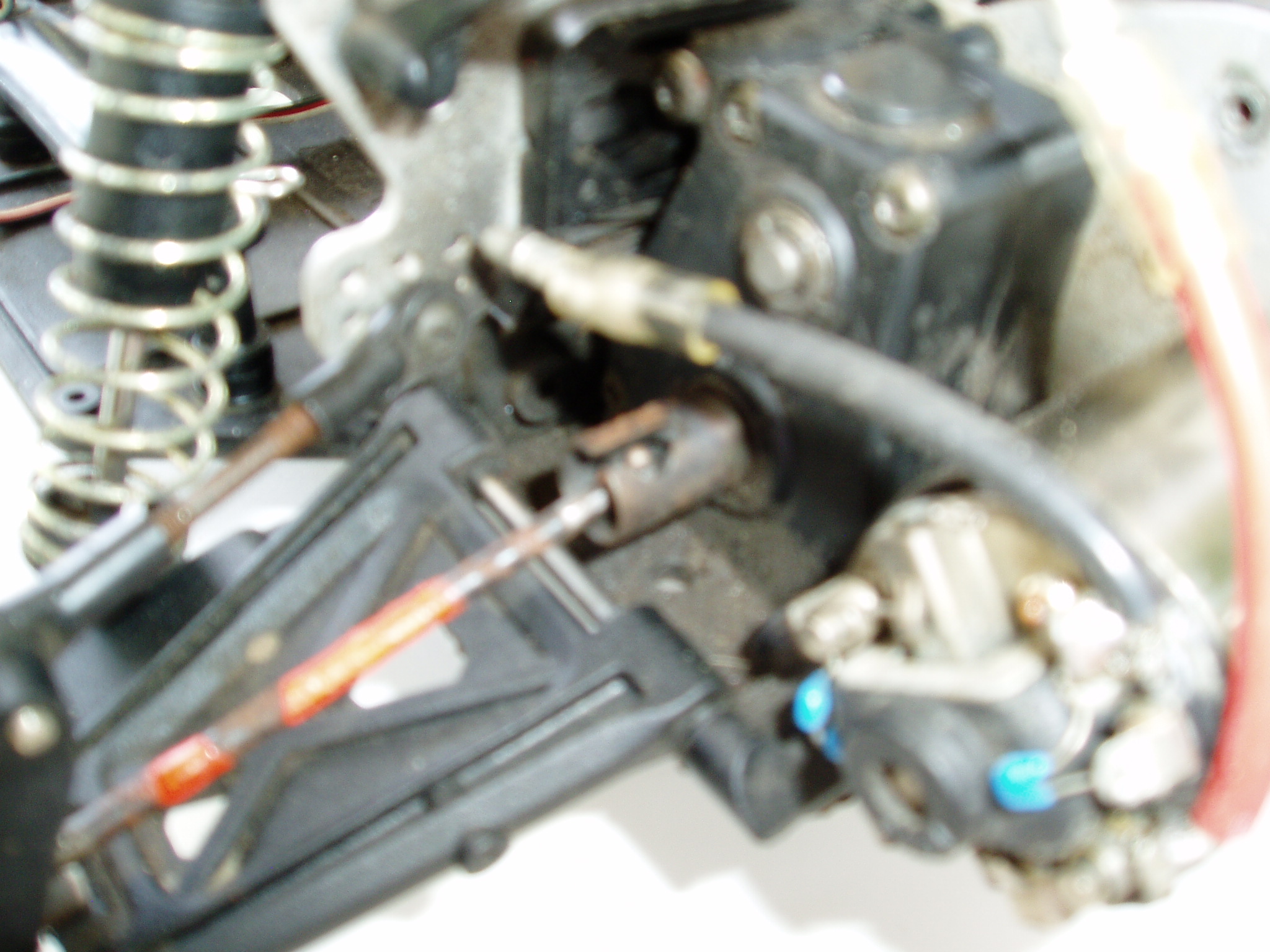

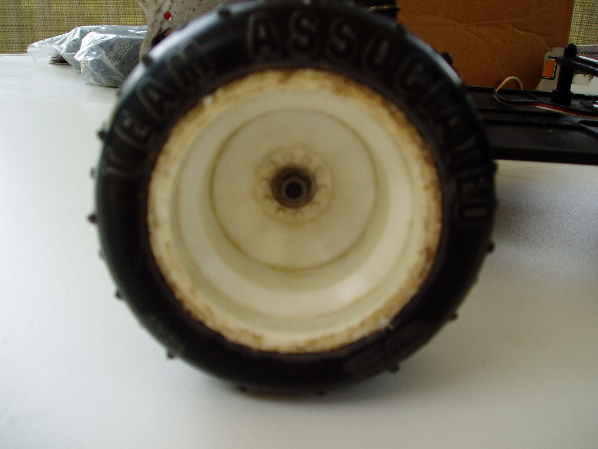

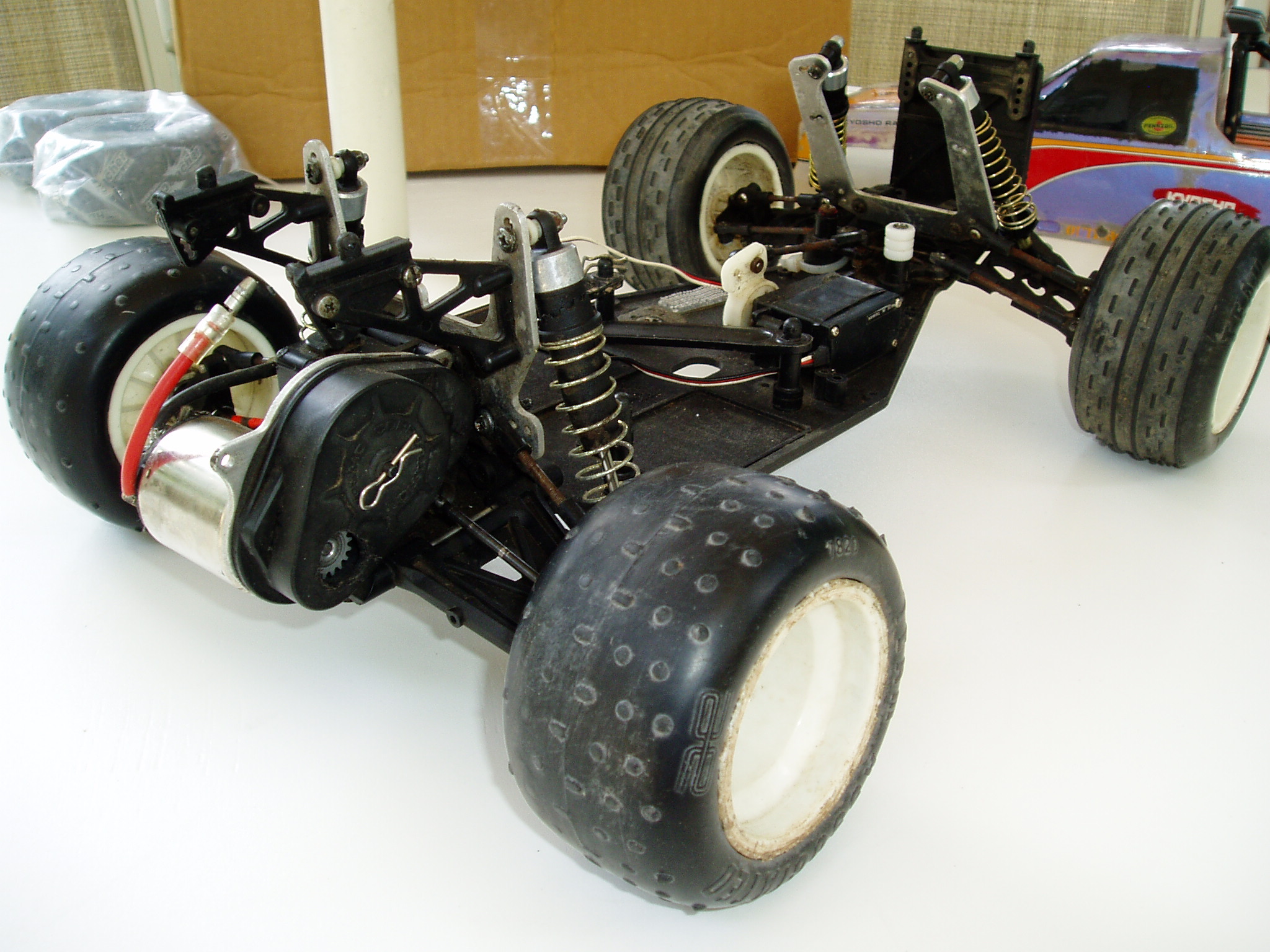

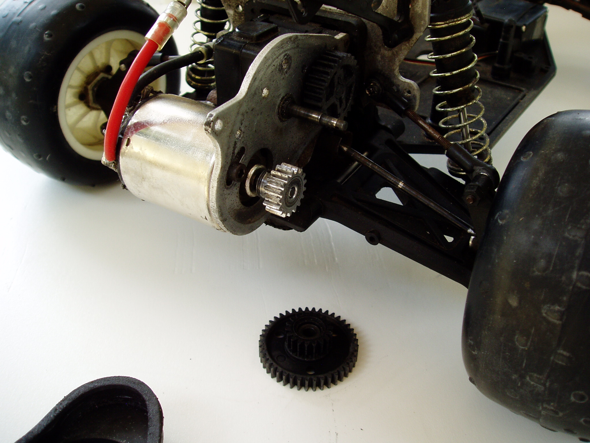

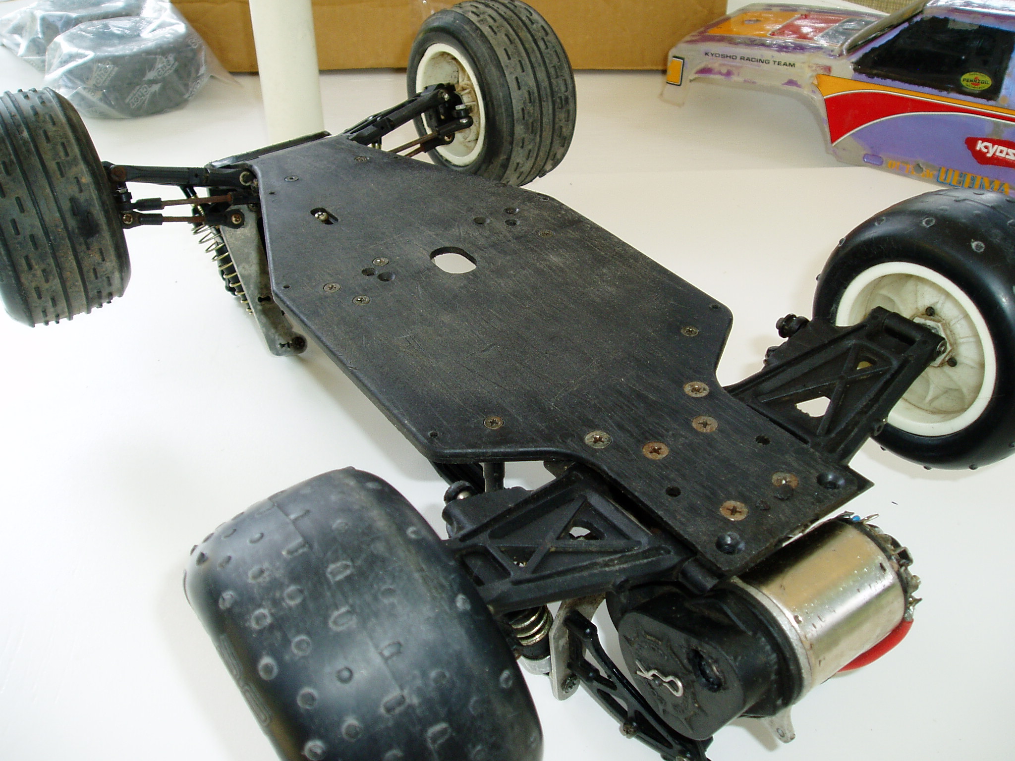

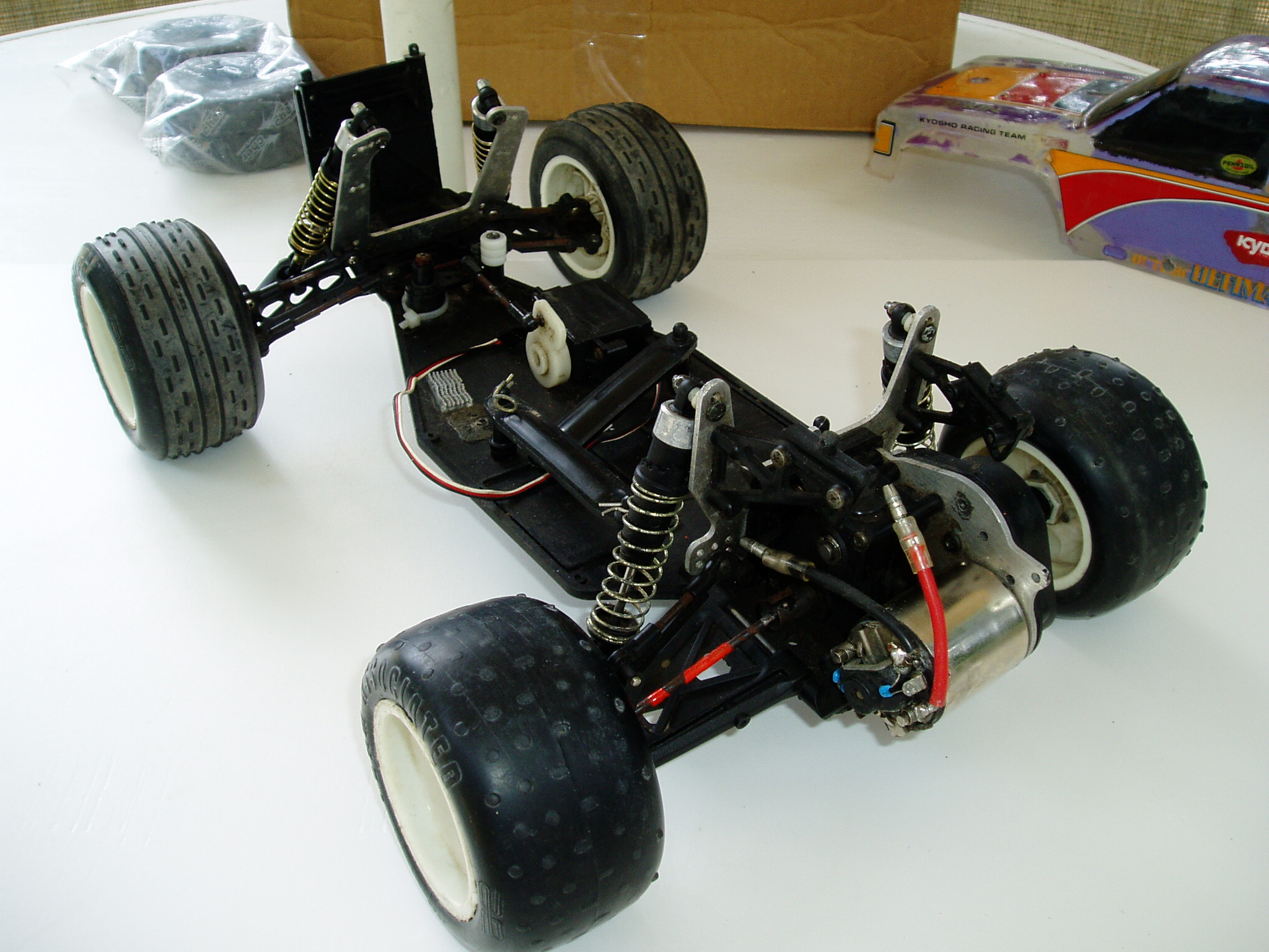

The chassis is missing the top deck but I would have replace it anyway since I prefer to run the battery longitudinally and the stock part is designed for saddle packs. Springs on the front shocks appear to be RC10 golds. Anyway, they're wrong for the truck and will be replaced.
Drive cups are shot but I have spares.
Gears look okay. I'm surprised since it has an aluminum pinion and there is a gaping hole in the gear cover.
I'll check the servo - I hope it works.
Front tires are okay, back ones are obviously bald.
Speaking of tires, the new ones arrived today as well with no inserts!
Granted, it's been many years since I bought Schumacher tires but shouldn't they include inserts??
Other brands I've gotten always package inserts with the tires.
