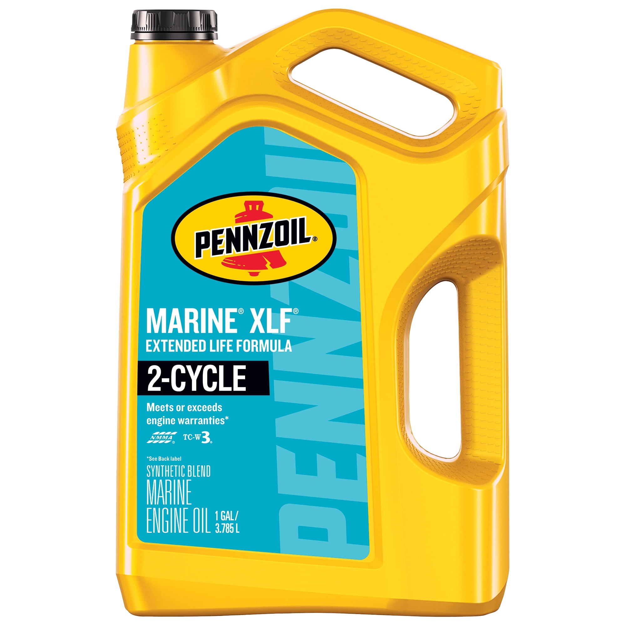

Case Tumbler/Vibratory Bowl:
www.amazon.com/Frankford-Arsenal-Quick-N-EZ-Vibratory-Polishing/dp/B001MYGLJC
Cheapest oil you can find:
www.walmart.com/ip/Pennzoil-Marine-XLF-Extended-Life-Formula-Boat-Engine-Oil-1-Gallon/140425852
And a bucket:
https://www.lowes.com/pd/United-Solutions-Lowe-s-2-Gallon-General-Bucket/1000421393
Into the vibrator until clean, into the bucket and covered with oil to keep them from rusting until they're ready for use. Though the money spent would go a long way towards just buying new hardware.
