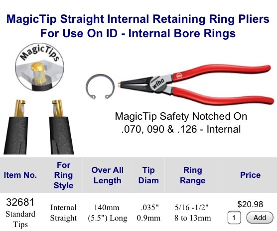

Just found that Wiha makes some with a .035 tip. That's the size of the tiny Allen for the 6 gear idler screws. I think this is the one.
Factory Works website

McMaster Carr 57805A32, fits shock and 6-gear snap rings perfect
Gonna leave this here on this old thread, 'cause it popped up when I googled for rc10 snap ring plires
